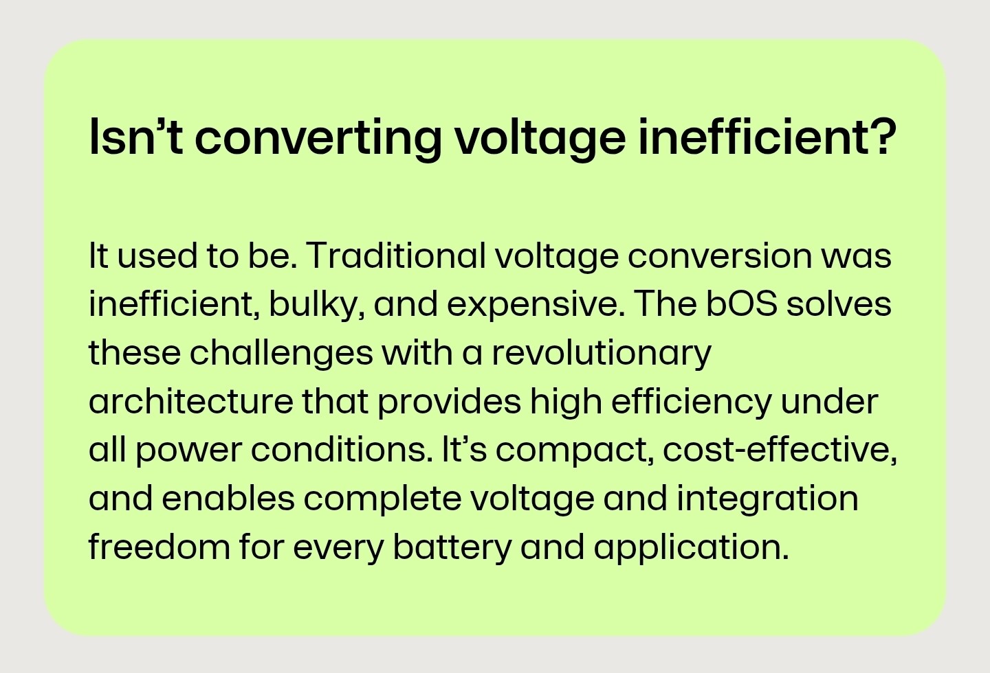

Sorry to rain on the techno-optimist parade, but isnt this just a buck/boost converter with slick marketing? Thats not new tech. From their FAQ section:
The only “new” thing they’re claiming is improved efficiency over existing buck/boost devices. Which, sure, maybe. That could be good for some things. But I dont see how that would help us at all.
They’re marketing this as a retrofit/adapter solution to plug new battery chemistry into existing devices without needing to redesign that device for a new voltage range. But we dont care about that in DIY esk8, because we’re constantly redesigning our boards, oftentimes for new voltage ranges. Right?

A highly efficient buck boost converter than can handle dynamic loads well, is interesting. But what is their idea of highly efficient, 94%?
