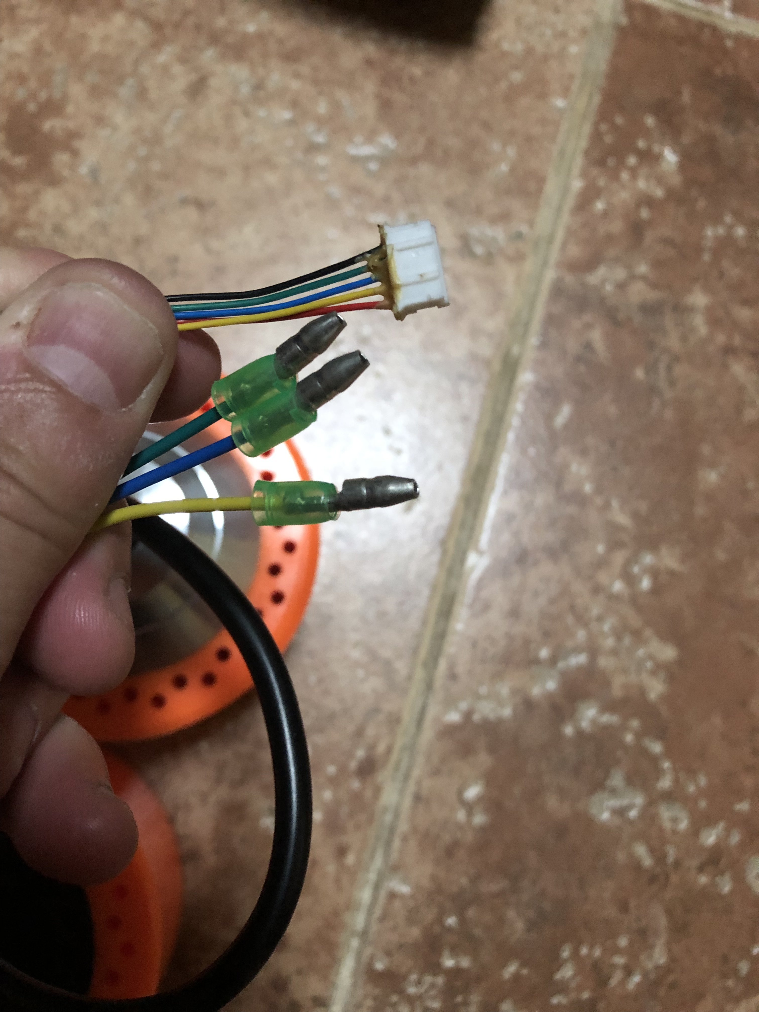

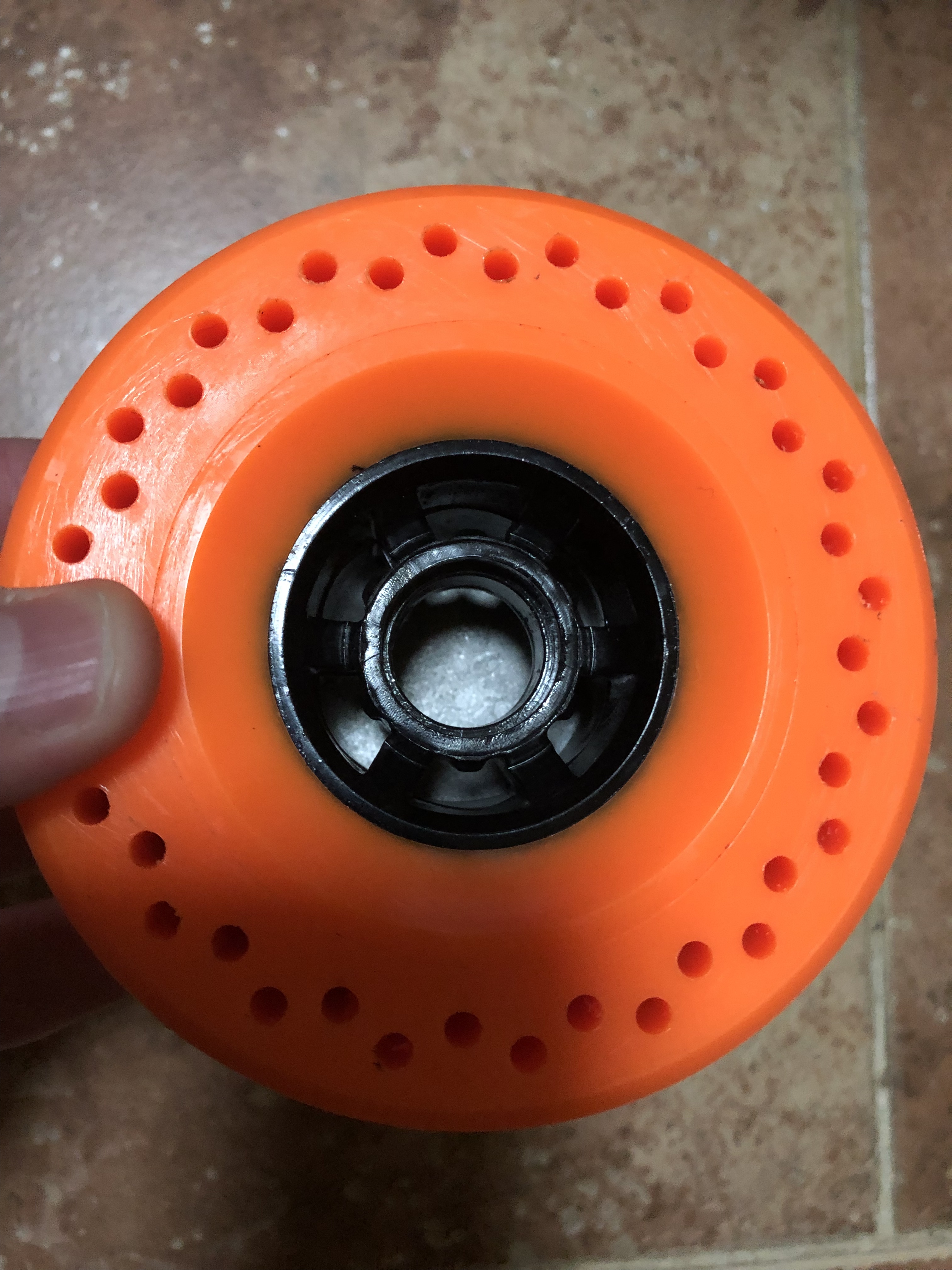

Wheels got here today, but no trucks. I don’t have this style of motor truck sitting around, either. I’ll have to wait to try them out. In the meantime, pictures!
Next to TB110 for comparison 5-pin sensor connector, no temp

the airless thane looks better than the black “105mm rubber wheels” hubs though
Don’t get me wrong, they could have easily made some changes that make them better. The tires for one look better being airless.

At the end of the day, I agree with you about these motors, and so far, this company is looking/acting/talking just like every other bad one out there, but what I’m particularly interested in is seeing what effect having holes in the thane wheels has on the ride. These wheels being 105mm diameter is just a bonus.
Personally, I’m looking for wheels/motors to stick on a deck that is as stiff at they get, and so I need something that eats up vibrations. Hummie’s hubs may do that well enough on a deck that has a tiny amount of flex, but I won’t know until either I come across a used set I get lucky and am able to buy, or wait until the Kickstarter comes to fruition. The airless 105mm hubs/wheels accomplished that for me, but turned out I was quite lucky to even get 2 motors out of the 4 I bought that were balanced. Of the 4 wheels I bought, only 2 of them were decent enough to be able to be balanced with lead tape. And I had to rewind the motors myself in order to make them efficient. What this all equates to is that if/when something fails/breaks, I might not be able to find a replacement for it. Add to that not wanting to have to rewind motors either.
You guys already have the best motor design, but haven’t explored yet big wheels, much less having holes in them to make them squishier. Maybe it works?
holes in the wheels I think would make them inefficient. wouldn’t roll as well. maybe softer. rather just do a 91mm tire and will get that done as soon as financially possible.

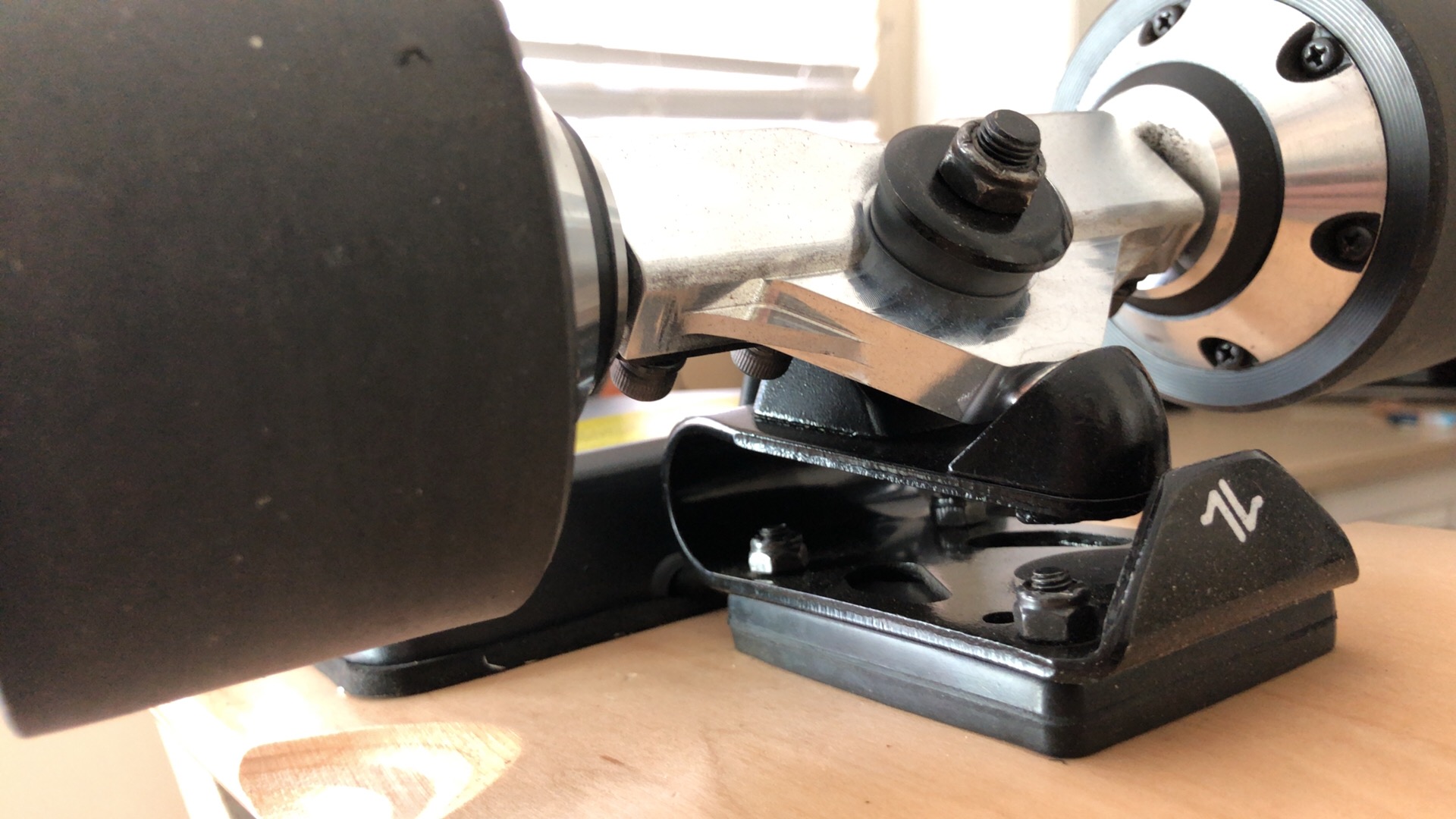

I chatted with @donta42 when I was experimenting with rewinding the 105mm wheels. Unfortunately for me, I don’t have a way to make a custom hangar for the 105’s with a square interface for the hubs that would fit on the avenue trucks, and the hangar the hubs come with probably won’t interface properly with the Avenue trucks. I’m guessing thats why you custom made the hangar shown?

I’m curious about the wheels. Don’t get me wrong. Think the will feel better than the solid wheels since they usually don’t use expensive urethane blends. So to make up for it, they have to use a higher duro. Which results in rock hard wheels. So it will probably be better than the wheels most use on these motors.
I would suspect worse efficient, but so far, we are not ones to critic efficiency lol.
