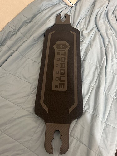

I got you bro, selling all this for 700
Complete new belt drive and deck and enclosure, with esc
That’s pretty tempting :sweat_smile:, a little nicer (read pricey) than what I’m trying you do, but I might still be convinced.
That whole undercarriage is supposed to hold the battery right? Unfortunately I’m trying to reuse some more of those 6s 10aH lipos since I have 8 of them just sitting around.
Although as you can see I’m not opposed to some custom 3D printed enclosures.
