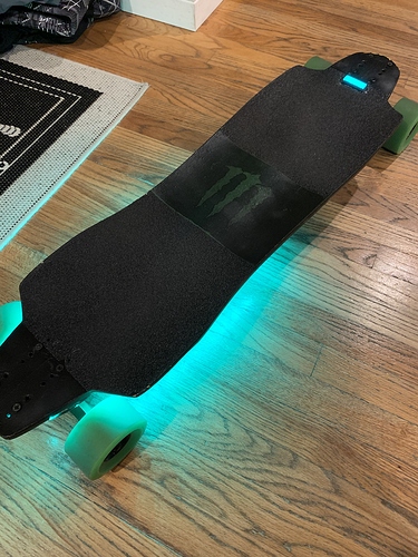

Rebuild of my old board (V2)
V1 first build:
Most of these plans described below have been scrapped, but I will keep them here to reflect cause the build has changed so much and it’s cool to look back on
V2 build:

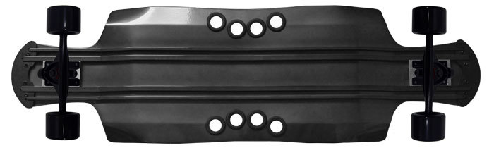

:wave: Hey guys, I’m trying to figure out what to do for the enclosure on my aluminum deck… It has a built in ‘rail’ system and I’m planning to utilize the rails rather than drill into the deck and I wanted to know what materials and enclosures/battery building techniques you guys might use on a deck with a little bit of flex… seeing as most of you have much more building and testing experience under your belts… I was thinking of using kydex or a similar mold-able plastic to make my enclosure but none-the-less I need some ideas
DECK ^
Its a 42" drop deck… so the enclosure would need to be low profile and offer flex to accompany the deck. I don’t have a big battery at all, so extra space is not a very big worry…
I don’t have a welder or a setup to braze aluminum, but I do have a 3d-printer for specialty parts. I would like to avoid making the whole enclosure 3d printed, due to its lackluster durability and overall cost, but it is available as one of the few tools I do own to make brackets or inserts of kinds, and maybe even hinges… but I’m getting off tasks.

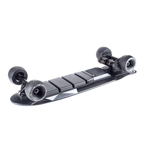

As I was saying, a plastic enclosure, possibly molded like that of one of the slick revolution boards
Or maybe a hybrid metal/plastic or rubber flexible membrane between the battery compartments.

Okay, lots of info to unpack here, so I’m gonna skim and throw out suggestions for each point you raised, more or less in order.
  • rails. Great idea, possibly problematic implementation. (Never encountered them, so limited info.)
  • 3D printer. Also great, especially combined with Kydex for larger areas. My first idea is to make a “standard” Kydex thermoformed enclosure, and a 3d printed “adapter ring” that goes between the Kydex and the deck, and fastens to the rails by whatever means.
  • flexible battery - The P groups themselves can be solid, only the series connections really need to be able to flex. I’d recommend either one of the 3d printed systems (NESE or whatever), and using either wire or flat copper braid for flexible series connections.
  • no BMS - Why?! I don’t recommend going BMS-less unless you have a very, very good reason to do so. It’s just not worth inviting trouble. A good BMS is not that large or expensive. Certainly cheaper than a board-turned-fireball.
  • padding - For insulation, fishpaper is the gold standard - It’s heat and abrasion resistant. For gap filling and vibration dampening, closed cell neoprene foam is my go-to - It’s available in verying thicknesses and widths, and adhesive backed for easy installation. Silicone goop of various flavors is also a favorite, just make sure it’s neutral-cure 100% silicone.
  • fans/intakes are a crutch IMO - They ruin the water/dust/dirt resistance of the final product, and with good careful design can be avoided fairly easy - Especially with an aluminum board to act as a heat sink.
