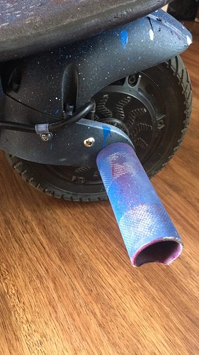

And yes it’s a hub motor

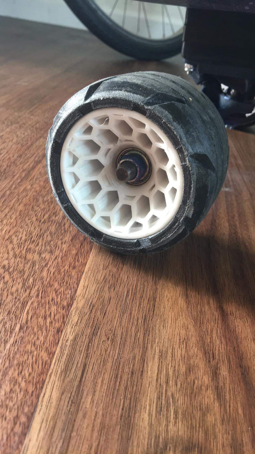

There is also and exterior for the where I’m printing for My next board at a larger size that’s more for dirt
That’s an interesting setup. The hub pushes? How many miles have u gotten out of those printed wheels?

Ya still shutting off havnt had time to adjust setting I’m good with wires not so much computer stuf put about two miles on wheels Are used to have longboard wheels on it tried making this once before With cheap esc and battery but now using vesc and dope battery

It rides like a boat but it’s fun as hell at speeds
And what do u meen the hub pushes like do I go fast or have power
The hub is in the rear right? It pushes you.
Doesn’t matter for your issues, just curious.
That pack might be limited at 50a discharge max, maybe. 10s5p LG m26 and LG MH1 would be capable of 50a continuous on paper.
If that battery was originally paired with that hub, I bet the internal BMS is limiting to 20-40a.
A single vesc might pull more than that bms will give and it will cut power and restore it in a little bit.
