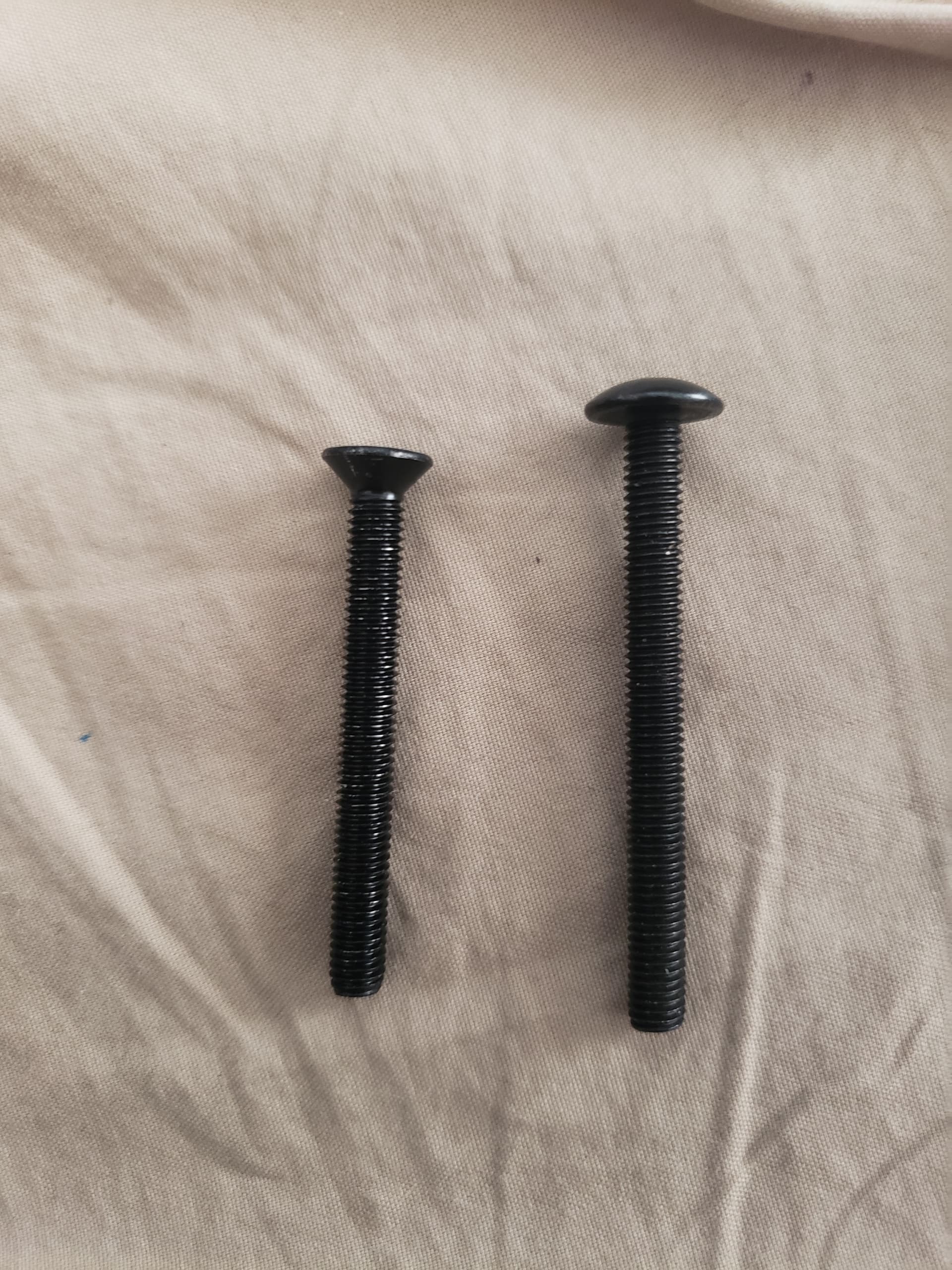

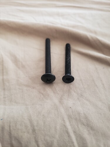

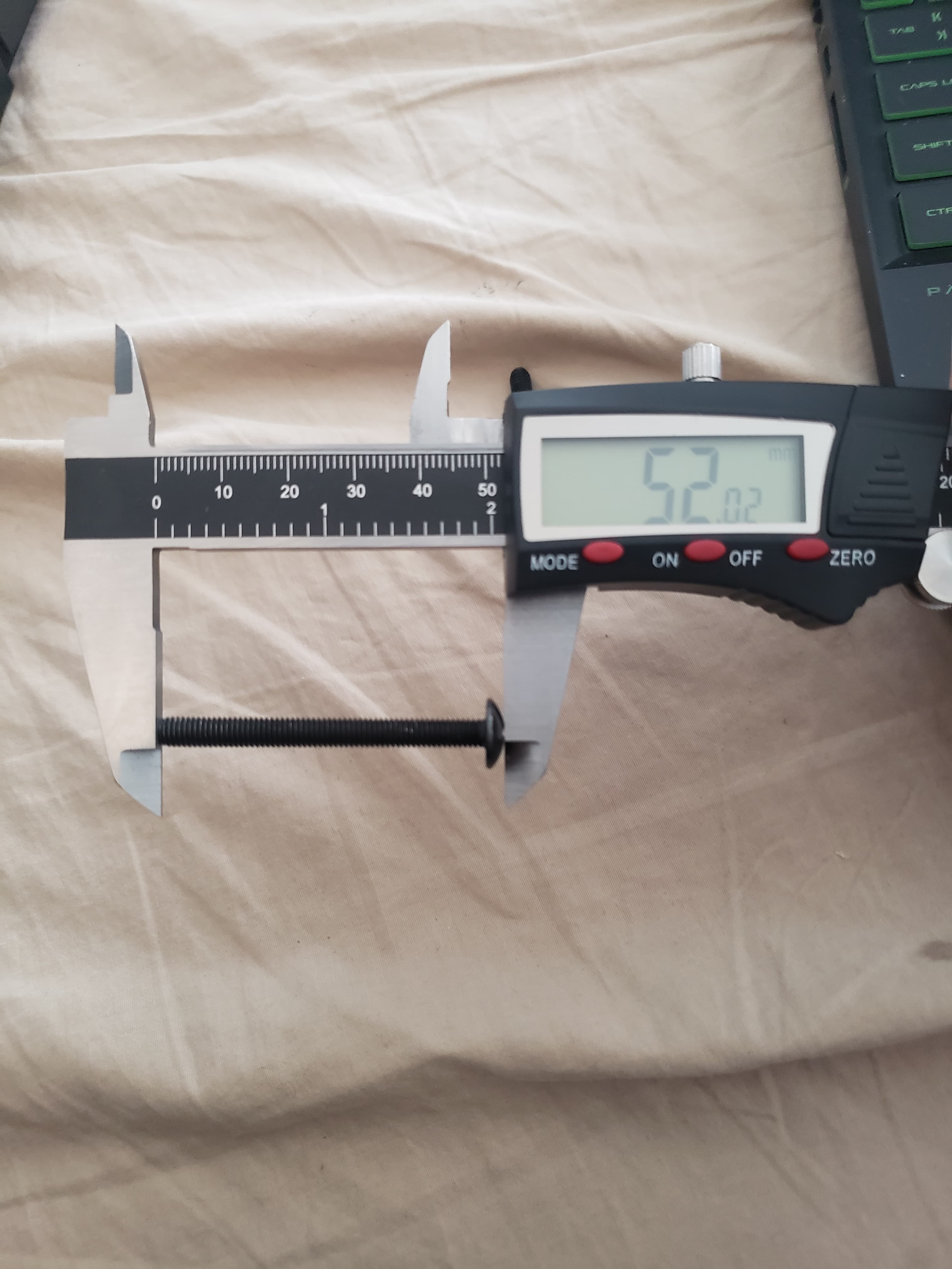

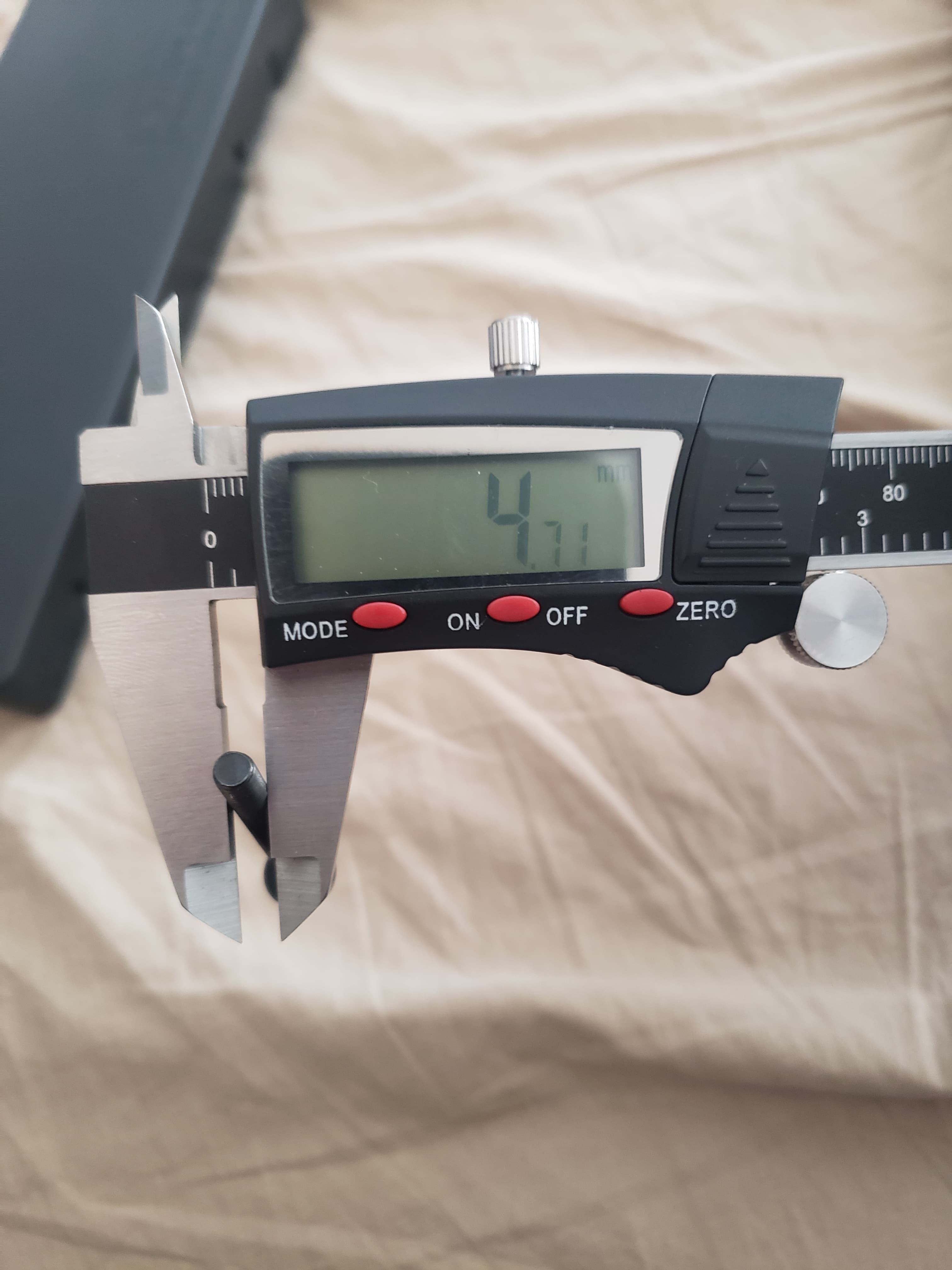

Hello I need hardware for my build. I need the flat Allen style. I’m not sure what size I need or where to buy. I bought some on Amazon but they seem to be to skinny and not long enough with my riser pads. I have the size I need that came with my riser pads but they do not have the flat Allen heads on them. The heads on them do not go into fit into my antitank plates like the flat heads do. Here are some pictures with measurements. Thanks : )

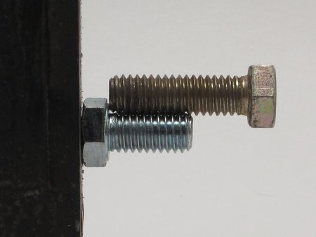

Personally I like the hands on approach at hardware stores so I can browse through options. You can match thread by either trying to thread into a nut or by lining up the threads.
Same thread
Different thread

second the m5’s. measure to see what length you need, but generally somewhere in the 1-2.5 inch range.

You can use either m5 x.8 flatheads 50mm long or 10-32 (Imperial) flatheads 2" long.
10-32 screws have a diameter of 4.7mm, and an 82 degree head vs 90 degree head for metric.
Your antisink plates have a 90 degree chamfer for m5, but 10-32, 82 degree works perfectly fine.
Only use screws that take allen wrenches, (not slotted or phillips for screwdrivers)

(It looks like you have 10-24 there)
