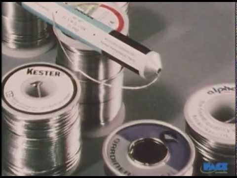

This is hands down the best soldering video series

It’s hard to get anything from the video. I can’t see what’s going on at the wire.

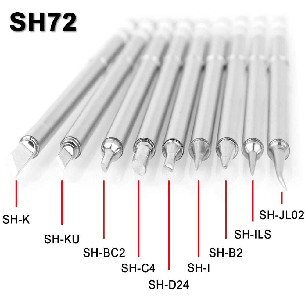

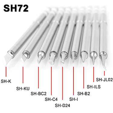

Maybe I missed this but how many watts is the iron? Also, with wire that thick, a larger tip on your iron will transfer heat much better. I almost exclusively use the SH-K shape below when doing larger gauge wires

got thinner tips, the one in the videos is the biggest
