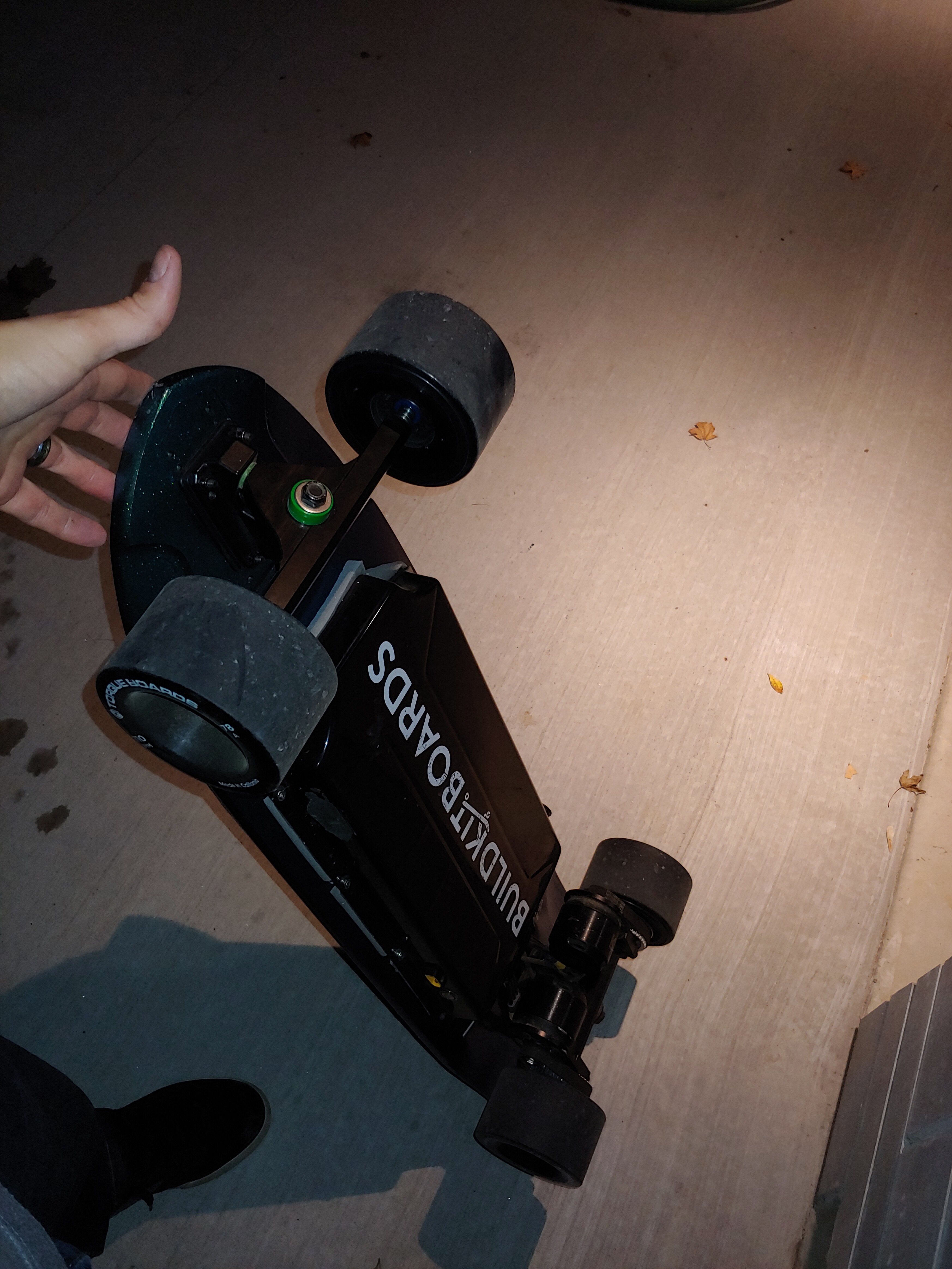

Although this is my first build thread, this is my second build. My first ‘from the ground up’ build was completed last summer and I’ve got about 100 km’s on it and it’s still going strong :slight_smile: It’s affectionally known as “Baby Dirtball” after a friend of mine growing up. This guy, much like my board, wasn’t much to look at but when shit was going down you could always count on this dude to tear it up with the best of 'em. This wasn’t a technically a full build as I did not have to run motor detection or program an ESC this having been done by @BuildKitBoards Jared with my dual tato kit, several parts of which were coopted for this build. But I did successfully build everything else including the pack and I’m damn proud of that… soooo I’m counting it.

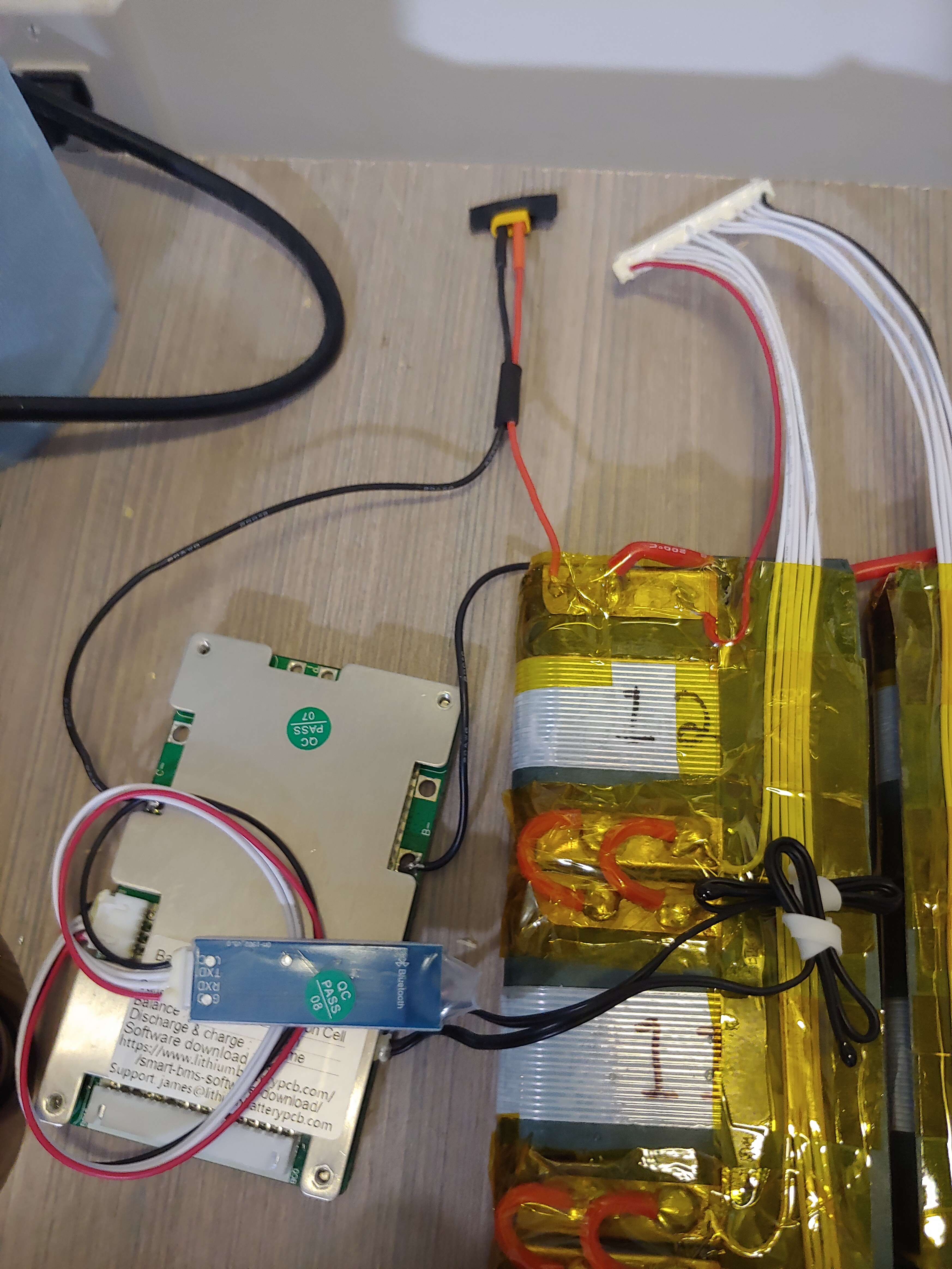

Pack is finished. BOOM
Actually, no booms to speak of. No sparks even… I was mildly disappointed bc I could use some excitement in my life ya know?
Hot pics
It all went swimmingly until I tried to shrink the gosh darn thing and realized my wrap was too small. 85mm was ordered and advertised for 4p 18650. 105 would have been perfect. I have some on the way but it’s def gonna delay the completion of this build which def enrages me.

I have some BIG sad news to report on this build After months of delays, other projects distracting me (see diy guitar pics) and several stalled efforts to finish the board, I finally got back on track and was about 90% done this build. Took much needed trip and upon my arrival back hm, I stupidly left my workshop (garage) door open. Some rando POS stole Baby Dirtball (see above) and my unfinished build.

This is as far as I got on the build. The thieves didnt even know enough to take the remote nor the loop key so both skates likely just got tossed in a dumpster when they realized they were basically just paper weights. RIP Namaskate :cry:
