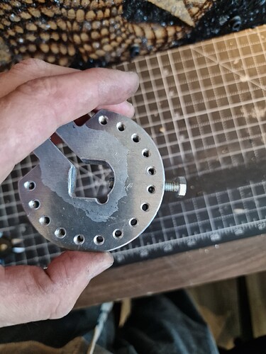

With the enclosure on, I took Nagini for a test ride yesterday despite the dodgy motor mount clamps.
Where I switched over to BN hangars, my clamps are now too loose. I have a friend machining me some new ones, but in the meantime I figured if I just shove a couple of washers in the gaps and pray it will do the trick.
One of the mounts fell off mid ride (luckily just as I was slowing down after testing top speed…) and I lugged her home to inspect the damage.
As suspected the washer vibrated loose. I figured I could drill a hole in the clamp, tap it, and use a shitty grub screw style adjustment to temporarily use the motor mount.
It went well, but I know it won’t last long.
The other mount was holding up just fine, but that washer wasn’t exaclty inspiring any confidence so I decided to do the same.
I lost focus while counterboring the hole with a 6mm drill and accidentally went through the full depth. Fuck. I don’t have any M7 screws I can use. I decided to try drilling a hole from a different direction. The drill bit snapped and is now stuck in the clamp…
Despite my best efforts to drill it out, all I ended up achieving was blunting my drill bits so they’re now totally unusable.
I then had a brand new sharp idea. Why don’t I just use gorilla glue and stick an M6 screw into the 6mm hole? If I secure it just past where it needs to be, I can file it down to acheive the right length once it’s in place, then use the proper clamping mechanism to secure the clamp to the hangar.
This is the only M6 screw I have. This is a total shit show destined for disaster but my own morbid curiosity is keen to see if this works…

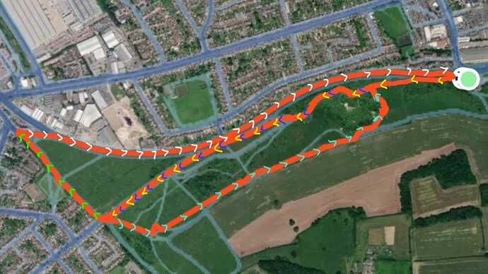

Logged a small portion of my commute this morning in Strava.
Hit a top speed of approx 25mph which I’m very pleased with! I was riding very conservatively because it was wet out, enclosure hasnt been fully waterproofed, my 3D printed 60T pulley is starting to wear, and I have less than ideal confidence in the motor mounts…
My commute consists of this section, an hour and a half on the bus, then another shorter but more hilly stretch. I’m going to start posting my stats after each ride to see if things change over time.
Typically if I get the bus, this stretch takes about 10-15 mins. Usually I skate it, and it takes 15-20 mins. So already seeing some time saved!

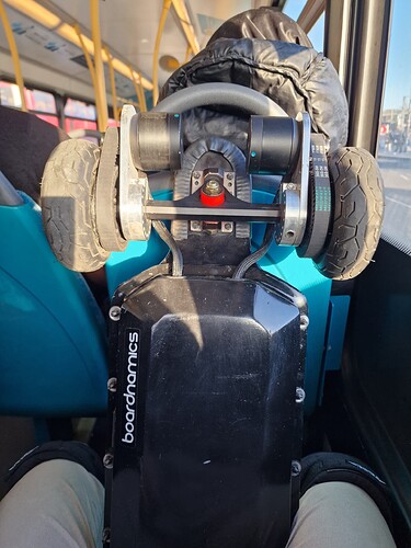

I’ve realsied I can’t break suddenly without hearing/feeling a knocking sound. It sounds like the belts, but I couldn’t see anything while riding. I’m probably getting some slippage due to the small motor pulley, large wheel pulley, and small centre distance. In my next revision of the motor mounts I will be including an idler mounting hole in case it’s required.

Ya, this sounds very much like belt slipping to me. Too large a ratio could def be the culprit as the pinion would not have enough teeth on the belt at any given time and hard braking would cause slipping. This would be exacerbated by a short center–>center distance. You could move to a slightly larger pinion or, if your mounts allow for it, utilize an idler to bring more teeth into contact with the belt. It could also be that you’re running your belts too loose. What ratio are you on?
Edit
Just noticed this:
This is likely causing the slipping. Get yourself an alu pulley.
Know of anyone selling alu pulleys for bergmeister wheels?
I was going to try my hand at Nylon or some form of composite material.
Pulleys are 16T and 60T
Glass filled nylon would be much more robust and has been used with success in past iirc. Berg pulleys are a tough one to find but I’m almost positive I saw some in the parts market not too long ago. Do a search and see what’s around? Alternatively, if you wanted to upgrade to gear drives I have a new set of Berg adapters dor BN M1s that I’m almost certainly not going to use…
Don’t tempt me like that…
Will see what I can do about the pulley but if all else fails I might go for the gear drive.

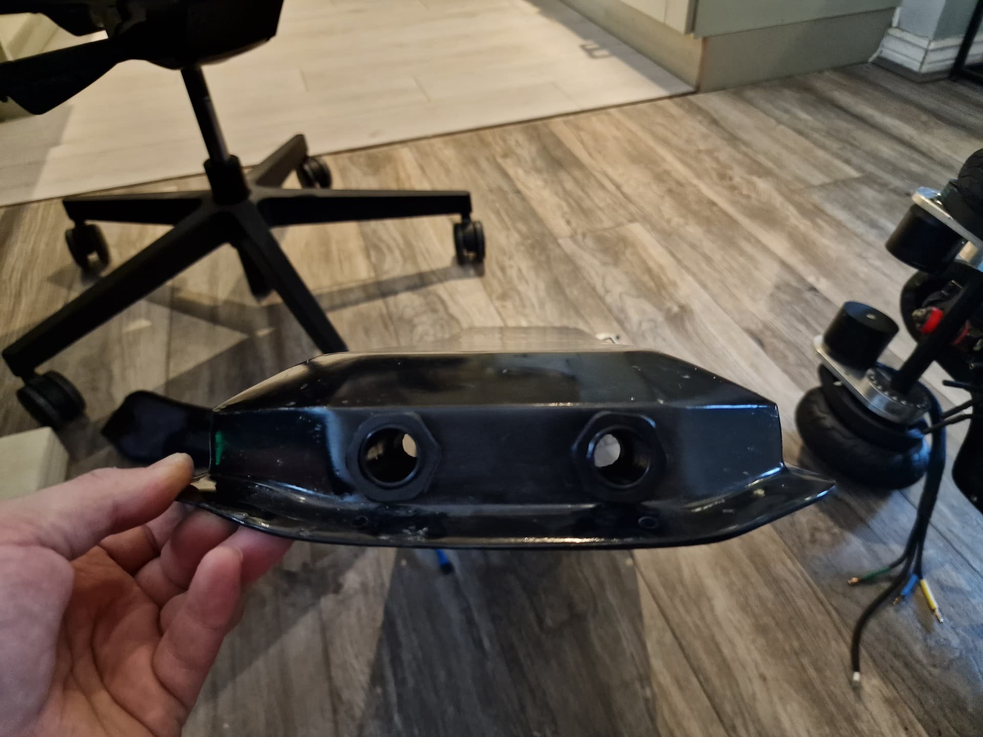

Cable glands in, to provide better waterproofing.
Currently fighting with butyl tape. This stuff is a bitch.
