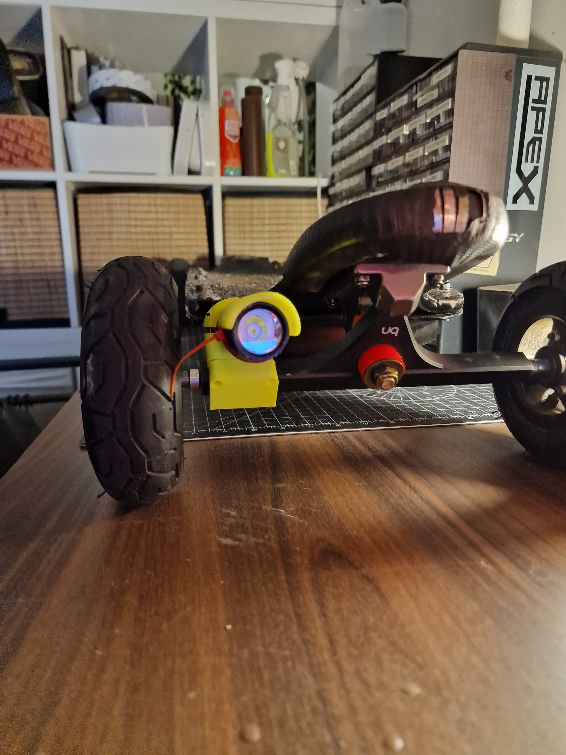

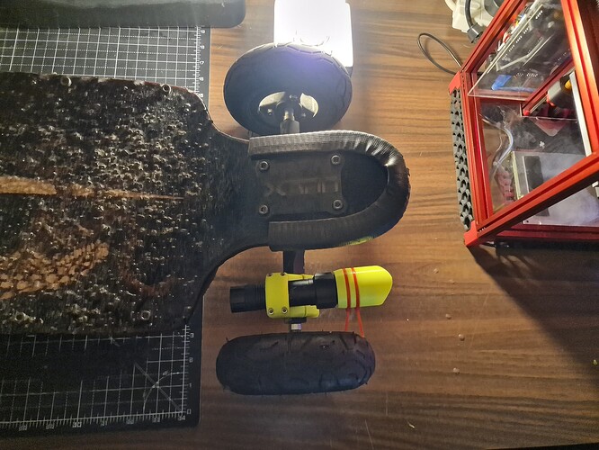

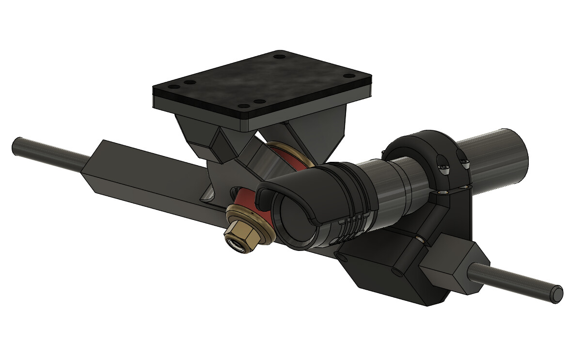

Did a bit more work on the light mounting solution. When I had the flashlights precariously zip tied to the trucks I noticed the upwards scattering light was harming my vision more than it was helping it, so I need some sort of solution to reduce the amount shining in my face. I decided to go with a shroud that zip ties onto the lights:
3D printed a quick prototype. Looks great right?
Wrong. There are, as always, a few issues with this design. My tolerances are perfect though which is a first…
  1. I assumed I would want the lights mounted as far back as possible so they didn’t stick out the front of the board. Unfortunately that would mean wheel bite which is a no go.
  2. I’m not comfortable with the lack of vibration damming on the flashlights if they’re mounted directly to the trucks. Either mounting them to the deck or adding some rubber strips will fix this.
  3. It looks too bulky and bolted on. I want it to look more integrated.
  4. When towing the board, those lights are going to get more banged up than your local council estate girls.
So instead, I think I’ll mount the lights to the deck and integrate them into a riser pad. This will be slightly awkward due to the upwards angle at the front of my deck but will prevent wheel bite, and also enable me to clamp more along the length of each flashlight so they’re more secure, and potentially integrate the shroud so it isn’t a separate piece.
While I’m here, I have a few thoughts around my motor mounts.

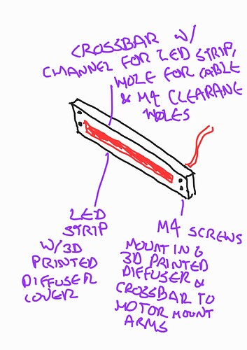

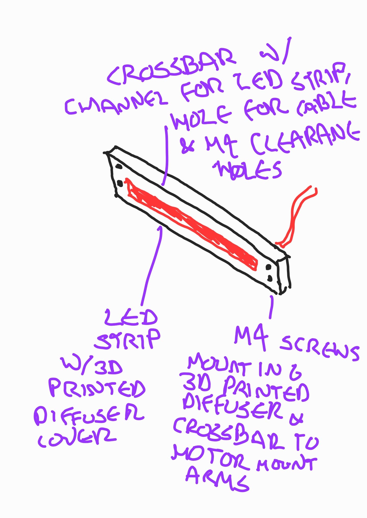

The fact that I want to integrate a carry handle and rear light into the cross bar may not be feasible without it becoming a bulky mess. I think I’ll design a handle which is integrated into the rear riser pad, and just use the crossbar for lighting.
Crossbar light idea:
Carry handle idea:

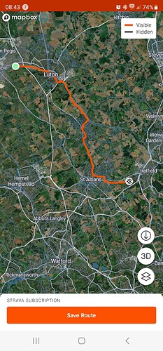

The route:
