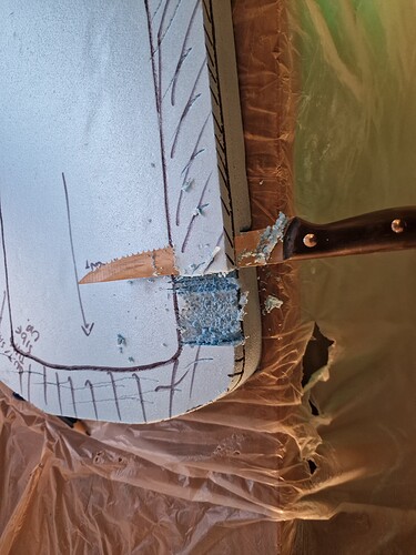

I began by laying out the battery, ESC and wiring on top of some blue high density foam, on top of my deck. This enabled me to cut out the bounding box of the enclosure mould and stick the foam blocks together with double sided tape. I also made sure there would be enough clearance on the flange which will host the deck mounting holes for some neoprene backed domed washers I brought which will help waterproof the enclosure.
Then with a contour gauge, I traced the curvature between the platform of the deck and the truck mounting holes. I cut the excess with a utility blade.
I wanted to add a nice chamfer around the edge, so with my crappy plastic geometry compass I marked 3cm all around the top surface and approximately 1.5cm around the sides. I tried using a handheld sander to shape the foam before but it gummed up the discs and dust collection so quickly, and made a huge mess, so this time I opted to use a steak knife. I was going to use a bread knife originally, but it was too long and imprecise. Im hindsight i don’t know why I didn’t consider using a coping saw… but this worked perfectly. I sanded the chamfer by hand to make it smooth:
Once I was happy with the finish and shape, I applied sellotape to the deck, then double sided tape on top. This would prevent the double sided tape from ripping more epoxy from my gorgeous deck. I still need to fix that…
I carefully positioned the mould, and painstakingly applied overlapping layers of double sided tape to the mould and deck. This took a while as I didn’t have any filleting wax for the transition, so the tape had to sit perfectly betwen the foam and the deck.
I couldnt be fucked with taping each end, but they still needed protecting, so I used some plastic gloves. Some duct tape was also applied to even out the transition between mould and deck, and prevent any polyester resin leaking through gaps in the tape.

I demoulded it the next day which was incredibly difficult. But once it released from the tape I was extremely glad to see that there was no immediate damage. The heat during curing has deformed the edges of the foam mould so that can’t be used again, but apart from that, everything was in working order.
