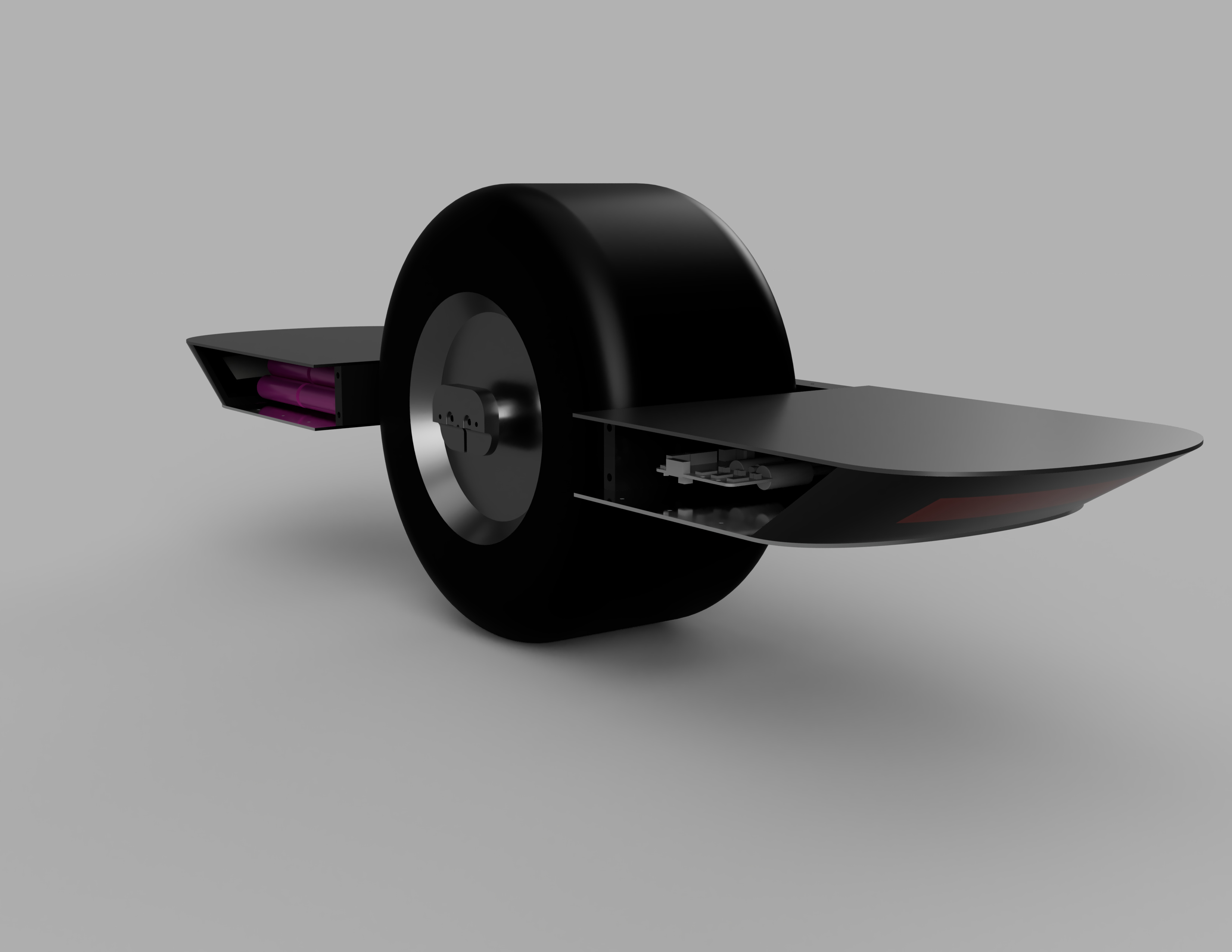

So I have a electric mountain board and a urban board already, naturally next project needs to be something weird…
I’m thinking a one wheel, that is going to be built in a two steep process… I got an original XR motor, and initially I’ll run it with 12S and a VESC 6. But my plan is upgrade it to have a 15S battery and VESC 100/250.
I’m also adding a bunch of WS2812 LED’s under the board, and in front and back of the board, they will be connected to a Adafruit Feather nRF52840.
I’m finishing an iPhone app that will connect to the feather and get some Vesc data and control the LED’s. Feather will of course be connected to VESC using UART. My plan is to CNC the rails on my hackrrspace.
For now I designed a daft model of what I wanted to build… most of the dimensions of the motor are wrong because It still on the mail, but the design has all dimensions parametric, so I can just update the real dimensions and it should recalculate the final version.

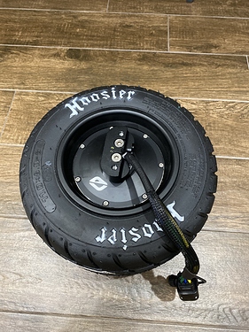

Got the motor today, took some measurements, updated the model, and printed some parts to ensure that I had my measurements correct. After some teaks I think I got it…
I’m going on my hackrrspace tomorrow laser cut the same part, to test fit screws, and just double check my measurements again, laser cutters are way more precise than my 3d printer… If everything fits I’m gonna CNC my rails…
They are going to be a little bit complex to make, I want to have a channel underneath the rail to mount some ws2812 led’s. I spend most Sunday changing Vesc firmware to allow break lights and animations with the LED’s.

Machined all the main parts, and they are looking great! I think I should remove more material to make the board lighter! those aluminum bars are heavy!
I still need to thread all the roles, and I also bought bigger screws that don’t fit to screw in the motor, so I’ll be ordering more screws this week.
The frame has a small grove to add a gasket to make it watertight… I’m only using ip68 rated connectors…
The bottom has a groove for neopixels, I’m finishing a firmware that can handle effects and breaking lights, but that is gonna be another post!
