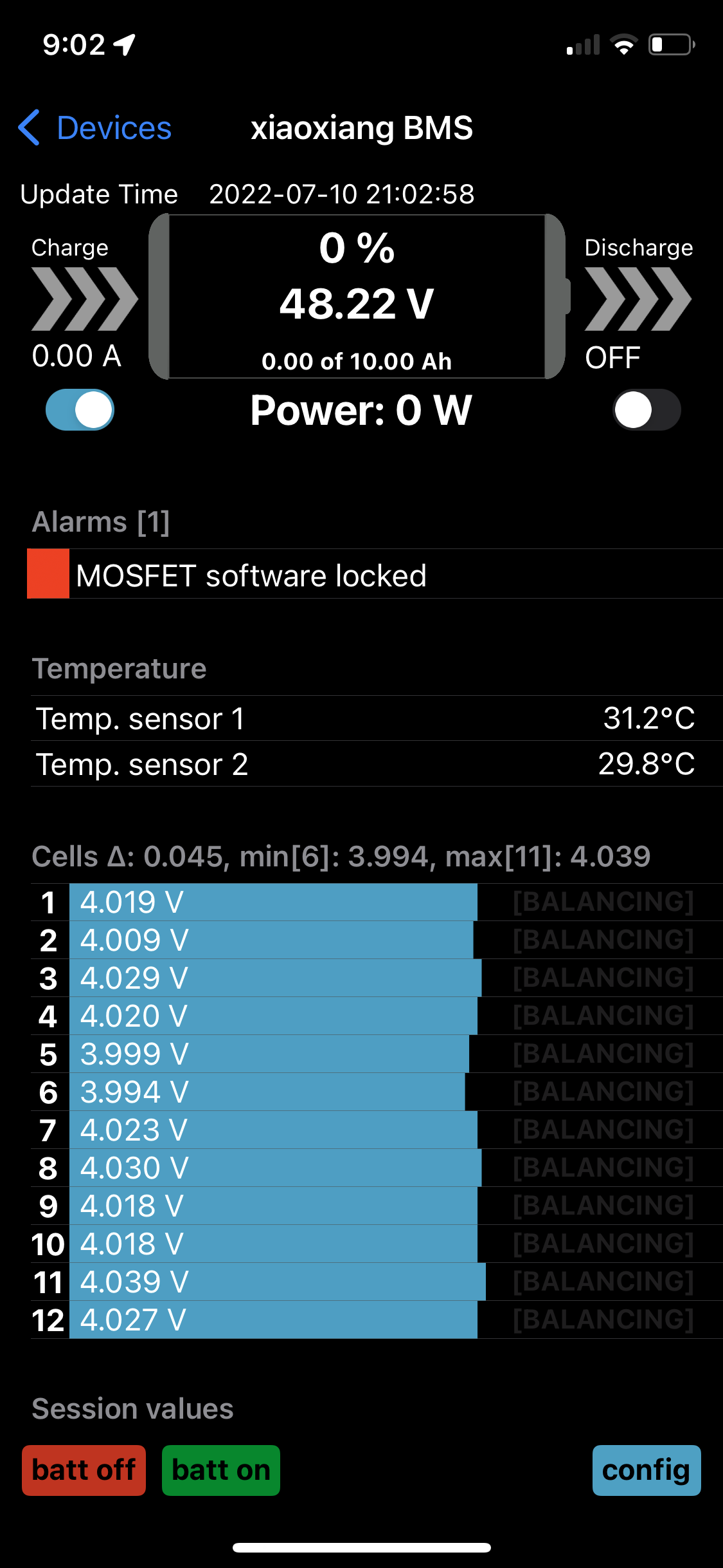

After fully charging and sitting for a few minutes, the pack is sitting at 49.5v. Maybe not perfect, but seems ok. I’ll keep a close eye on it.
Not gonna lie this does not look like a healthy battery. I’d advise returning it or having a new pack built.
He’s still in denial. Let him at least have these moments of hope. :joy:
@Evwan Fuck… for real? What should the delta be between p groups on a healthy pack?
@BillGordon man i had my 30 minutes of happiness riding. Please give it to me straight - is this pack effed?

my LS pack is always between 0.008 - 0.015 difference
My other pack is always around 0.015v delta.

The delta isn’t the main factor here, it’s how all of the groups recharged and are behaving. 45mv isn’t too high of a Delta, but a healthy pack of that size shouldn’t go above 20mV.
Plus, this isn’t what you paid for. You paid for a good condition jaws. This is a poor condition jaws. I’d either send it back and buy a Barrell or get a new battery paid for by the seller. My opinion is that this jaws is worth considerably less than what you paid for it as its seemingly been neglected, was defective, or both.

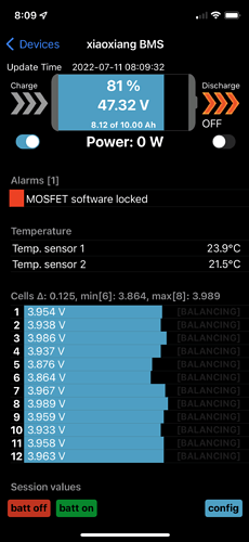

I set the BMS to “balance when not charging”, left it overnight overnight and now the pack looks like this:
I set it back to the “balance while charging” amd plugged it in, and the cells are about 50mv delta again.
