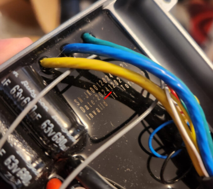

1. Board arrived DOA (Dead on Arrival)
When the board arrived, it simply wouldn’t turn on. The remote powered up, but the ESC was completely unresponsive. I spent days sending videos, dismantling the battery enclosure, checking voltages, verifying the charger, power button, etc.
Acedeck eventually said they’d never seen this before and sent a replacement ESC + charger. It took weeks due to warehouse issues and holidays.
Once I installed the new ESC myself, the board finally powered on.

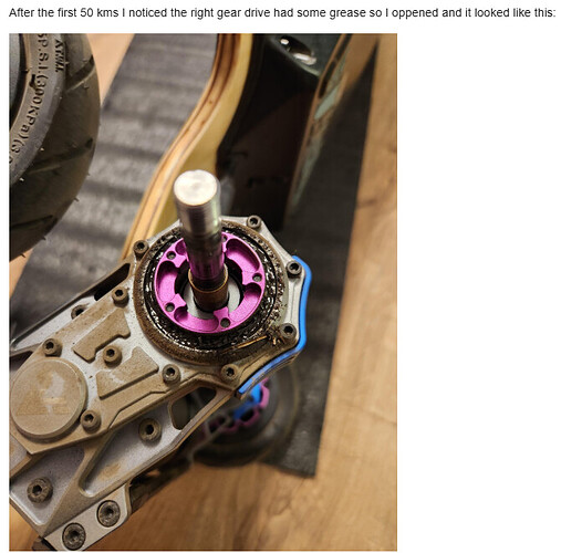

2. Grease leaks & abnormal friction from the start

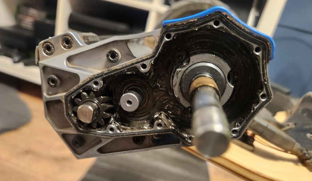

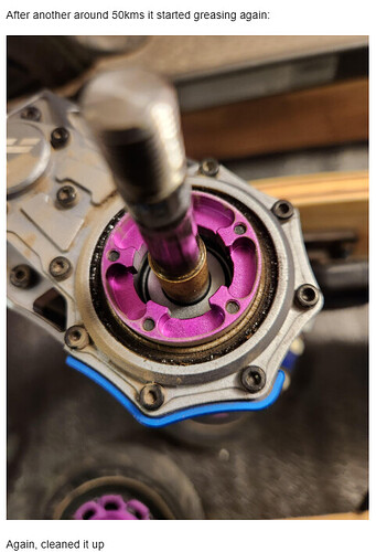

After the first 50 km, I noticed grease leaking from the right gear drive. After every ~50–70 km, the same issue came back. The right drivetrain always had more rolling resistance than the left, which caused instability at higher speeds.
Support just told me to clean it and “keep riding so the grease spreads evenly.”
The resistance never went away.

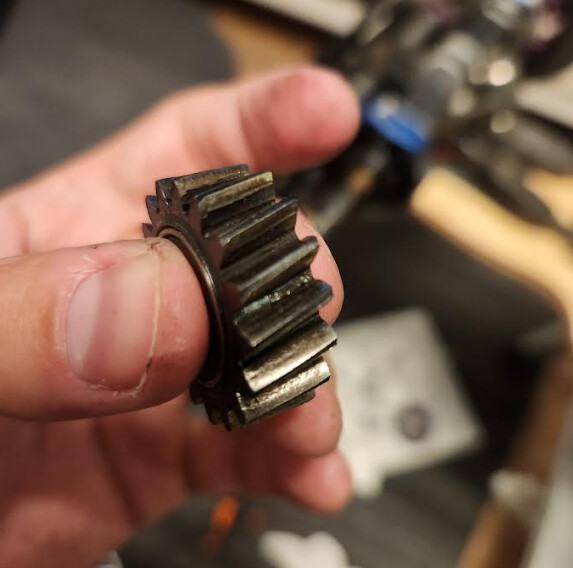

3. Factory misalignment discovered months later
Months into ownership, Acedeck sent replacement gears and spacers.
Only then did I realize the source of all the friction:
The motors and gears had been misaligned from the factory.
The right motor axle was pushing outward, stressing the bearings and gears.
After installing the new spacers, the drivetrain finally rolled correctly — but by then, damage had likely already been done.

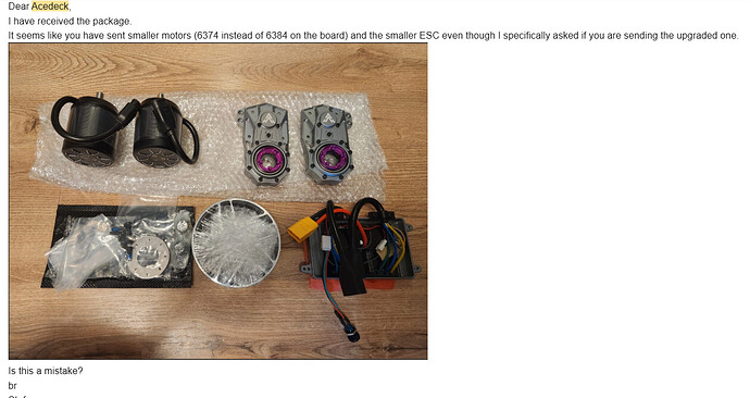

Their support team was responsive but repeatedly minimized the severity, ignored the safety implications, and never properly investigated the root cause, not even now, after the injury, even though I explicitly asked for this.
Finally, they have sent replacement parts that are downgrades, which made me lose my last benefit of the doubt that this would be managed fairly by them.

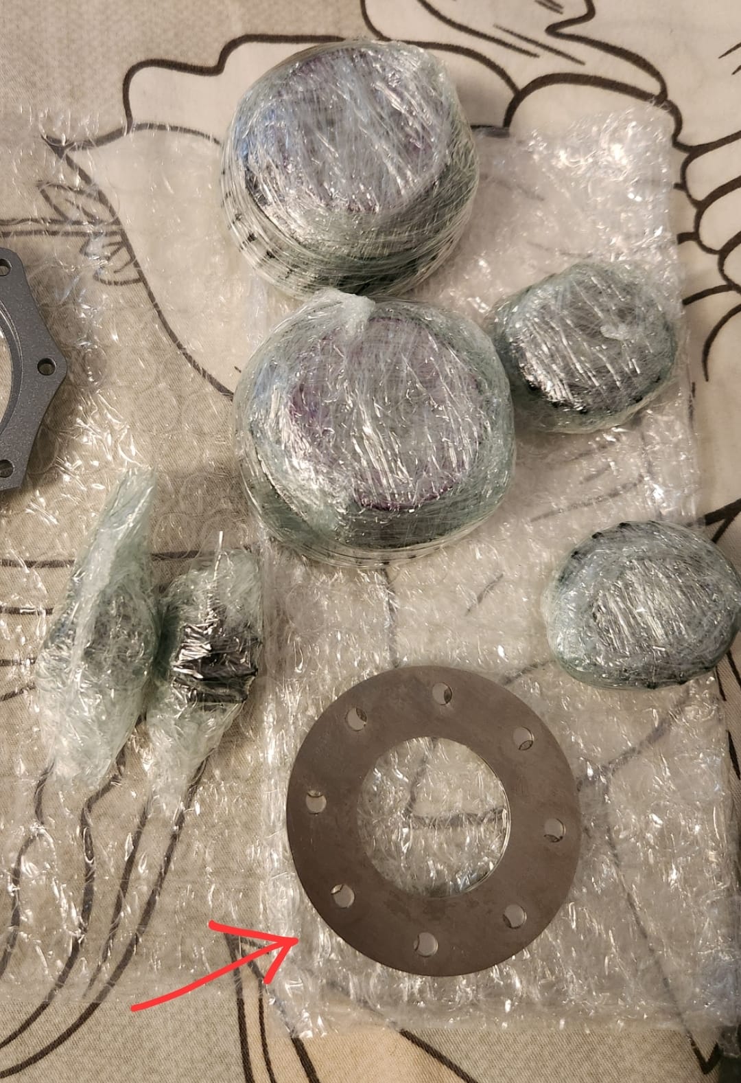

Do you mind posting the full resolution versions of the photos attached in the email chain you posted?
I’m glad your injuries are recoverable, I’m wishing you a fast healing process.
Sure.
This is the spacers they sent me in August. These are fitted sandwiched between the motor and gearbox (like a shim) which basically pushes the motor axle+small gear 1-2mm outside. Without this, the helical gears are in constant tension. This seems to be a common defect, as more people on the FB page have posted pictures with these spacers - these are not shipped from start, so it’s a known issue by Acedeck. I haven’t heard of it though… All the reviewers, all the instagram posts, all the forums. Why aren’t we talking about the defects in 1500$ products that put our lives in danger?

I feel like all this could have been avoided if we stopped using helical gears and just stuck with straight cut steel pinions.
Agree on the helical, I believe you need very high tolerance for them to work properly and also I don’t think the electric motors they put on the boards were designed with the axial force generated by helical gears.

Also i really don’t like how the helical gears naturally push away from each other.
