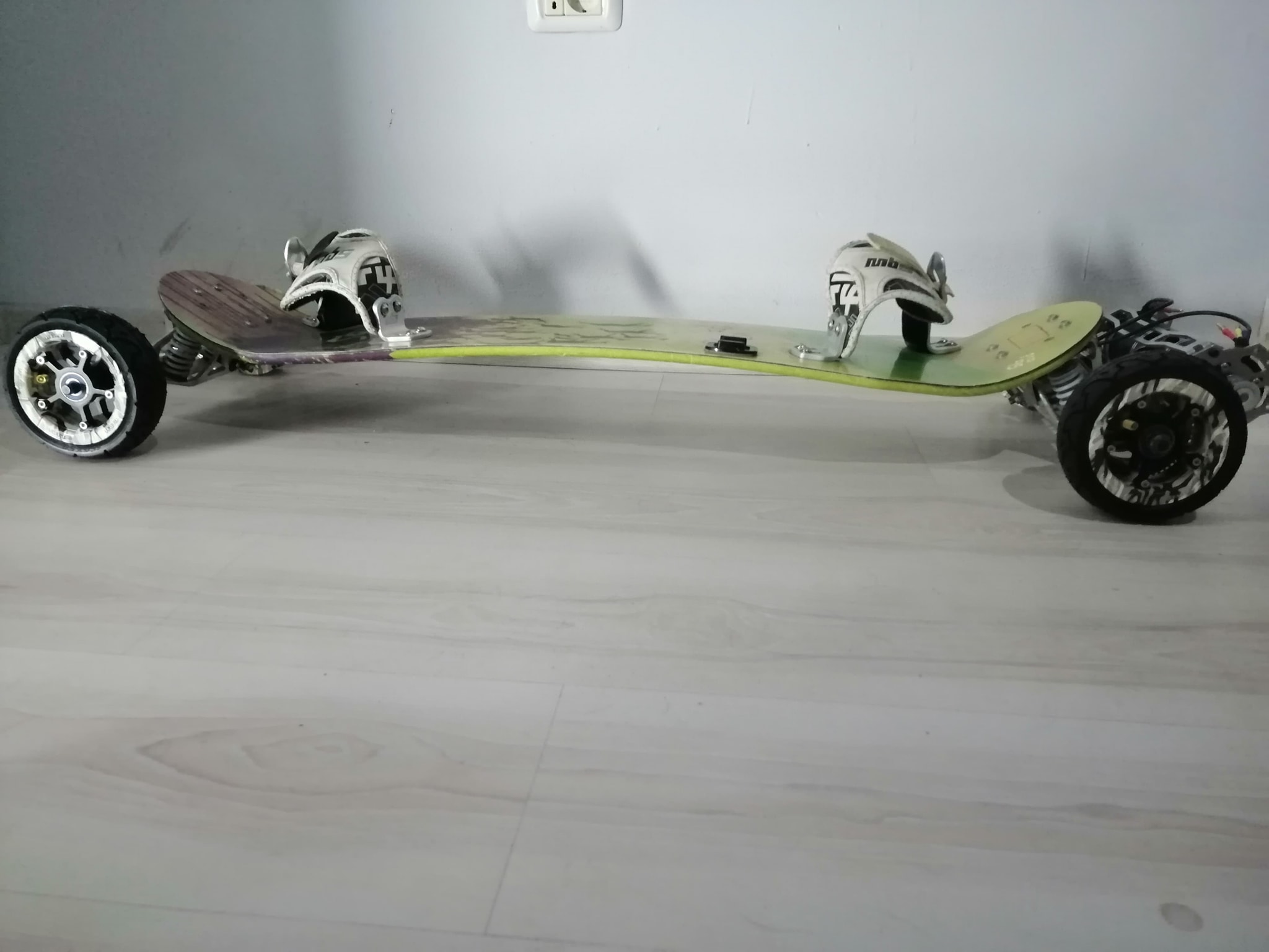

Hi all Esc8 Builders . i’m Samy . i live in Romania about one years ago , i fall in love with this electric skateboard , to day i want to show my first build . hope you like it :slight_smile:
specify
Deck ,with truck’s MBS 95 Pro .
Trampa superstar wheels ,
Evolve tire 150 mm
Motor mount v4.5 @IDEA with, motor pulley 15T and Hubs pulley 60t and belt with a width of 20mm
Turnigy SK8 6374-192KV Sensored Brushless Motor (14P)

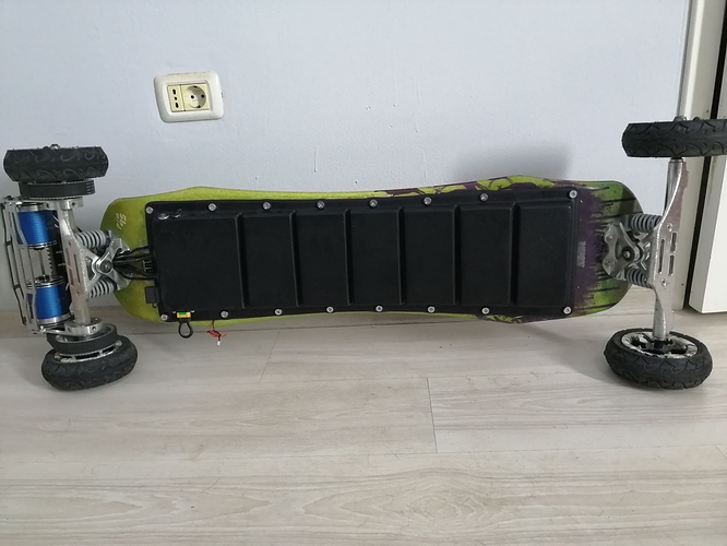

Enclosure Trampa HS11/HolyPro 35 @eBoosted
Bms bestech d140 , only charge
Vesc Fsesc 6.6 plus
Remote flipsky vx1
Battery samsung 30 Q
To continue to the rest of the parts , i buy new stuff

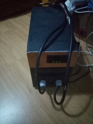

i make the loop key like this , And sorry for the picture , is not so clear , but i hope to understand :slight_smile:
And also i make a fuse to the charge port
And of all is done

Great job! Super solid build and I am impressed by your battery construction

Love the build! Question, how the hell did you get your deck those colors?

If I may suggest something would be to add fish paper between the pgroups and between the balance wires and cells

Is The original color. But i think The Light make The color like this
Every pack îs cover în fish paper. I think îs enought
She îs not mine. It’s frome a friend
