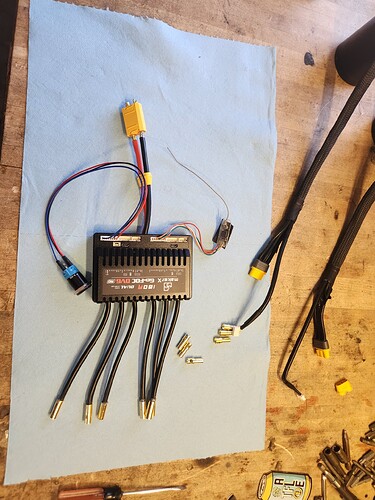

New ESC.
Kinda different.
Had not had to think about how to hook stuff up for a long time.
Here is hoping the Flipsky Bluetooth works.

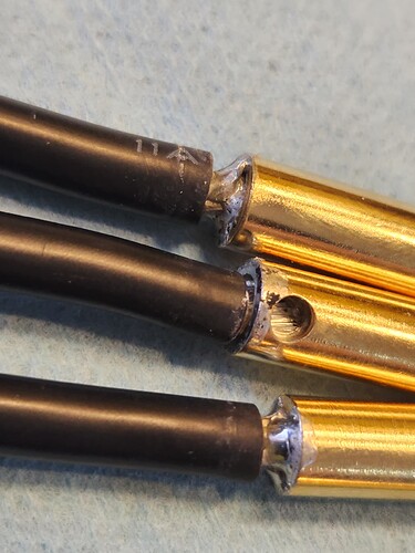

The solder on the bullets look ok.
I will still touch it up.
One half of the xt90 really didn’t look that good.
I’m going to go with the 5mm bullets here.

So I did have a rollercoaster of a time last night setting up the DV6P.
It looked to have 6.0 installed on it and I tried to run the wizard from the lastest version of the App on my android phone.
And holy shit all kinds of weird shit happened.
Ran detection ok, and sometimes not on one half
Thenbit would not set up control ok.
Then it seemed to set up ok and it would forgeet it in 30 seconds.
Weird weird cogging…
I was starting to freak out.
Seems I got it working at this very moment.
Uses the PC to upload the special firmware for 5.03
Then the PC tool crashed.
Went over to the phone.
Ran detection ok.
Set up the ppm remote ok.
Set up the power to shut off after 5 minutes.
Which makes the button work.
I have everything plugged into the right side.
These Flipsky motors are screaming when let loose…
Cool.

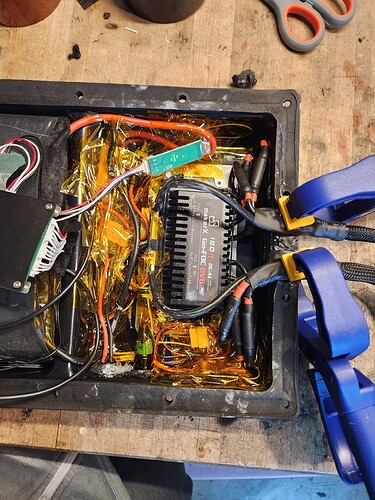

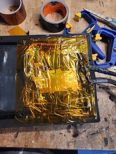

I got the Flux taped up and the enclosure back on last night.
I have no clue how some folks manage to make this part neat.
Always a rats nest for me.
But hopefully nothing is going to move…
