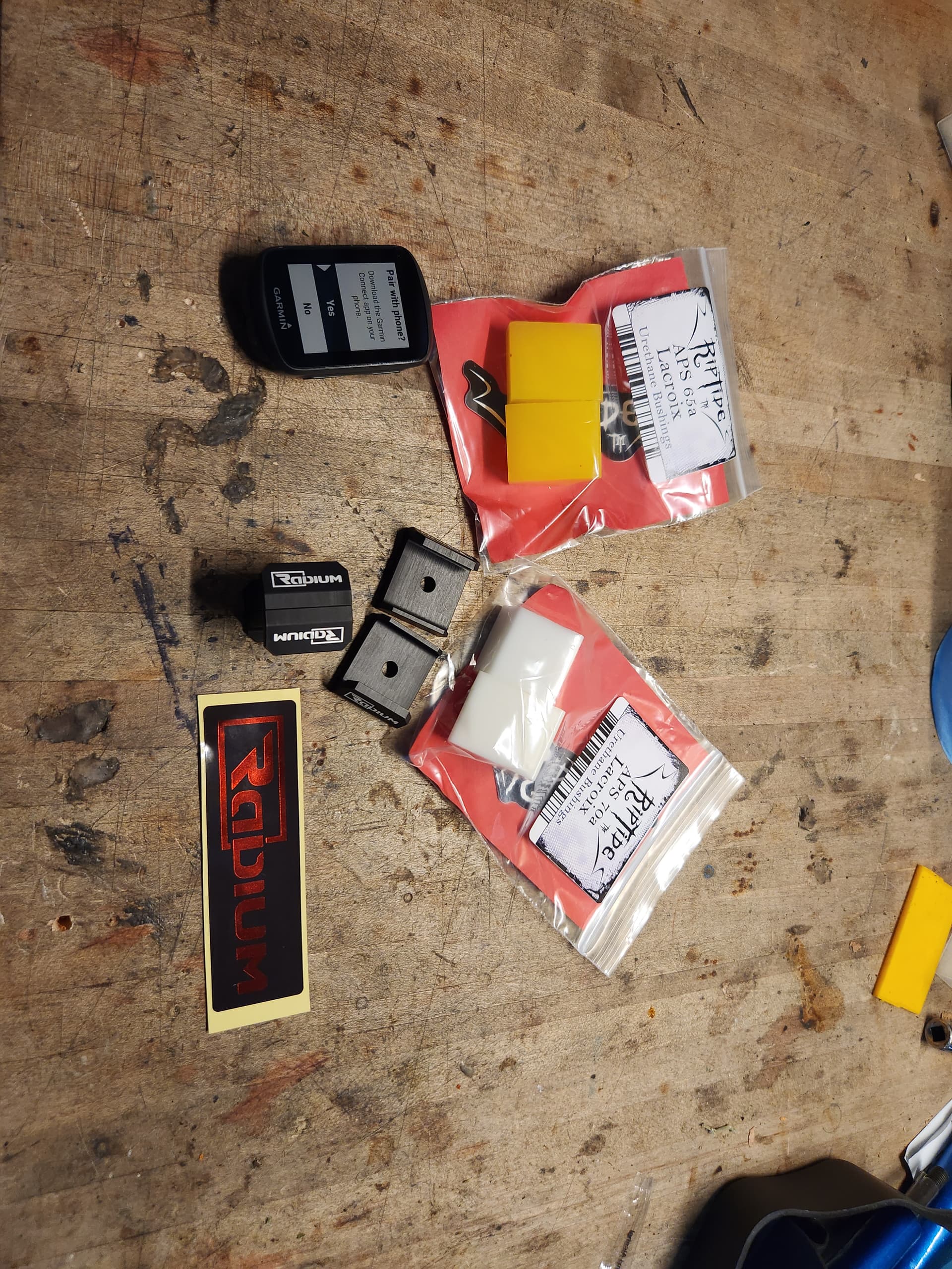

Looking forward to your impressions. I’ve been thinking about buying some Riptide bushings and making my own adapters for them.
Welp, I went and did a few miles around the neighborhood on the new bushings.
And I did not get the right set up. and I had not ordered the softer ones I need now… so annoying.
I have them on order now.
I went 90A Gray / 75A Red and it was not an amazing revelation and the best thing ever for me.
So I need to try softer upfront.
I will slap my green 80A in the back right now… but it was the front that felt really restrictive…
Which MBS bushings did you have in there originally? Looks like orange and orange? I have yellow front and orange out back in my Prototipo’s trucks currently.
I had tossed out the idea of you trying the white/green combo.
Which ones are you going to buy next?
Did the riptide red//yellow combo end up working out for you? I really like the stability of that setup, but the board doesn’t feel stiff.
The red/yellow combination is perfect! So happy with the new bushings. Thanks for the recommendation.
Carves very nice at slow speed, but still stable at high speed. Best of both worlds.

Somehow I left the white 70a out of my first order.
So I got gray 90a. Green 80a. And red 75a.
I have showing up Monday the white 70a and yellow 65a.
So I will be trying green white next.

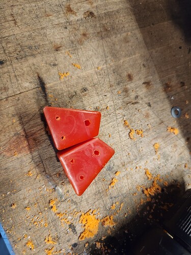

What I have now a total of 45 miles on is green in the back and Drilled out red in the front.
That set up is neat and makes me think the adapters were a good idea.
It may still be a little too loose.
But it did not try to kill me today…
So the gray 90 and red 75a combo was a bummer and super restrictive.
The green 80 and Drilled out 75a is quite carvy.
Probably more than i had before with red and orange.

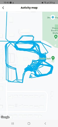

So I took the two older kids to the playground on the trailer with the Gravel Flux.
And while they played I rode around in circles and ended up with 12.4 miles.

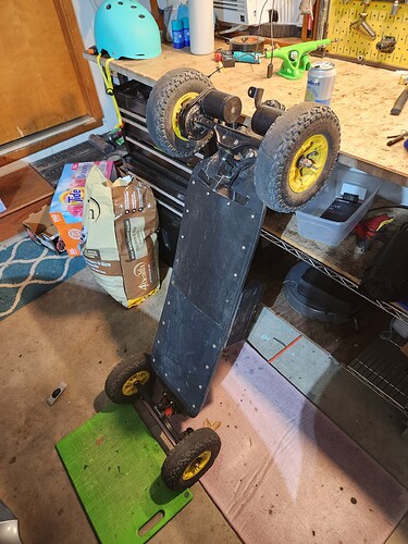

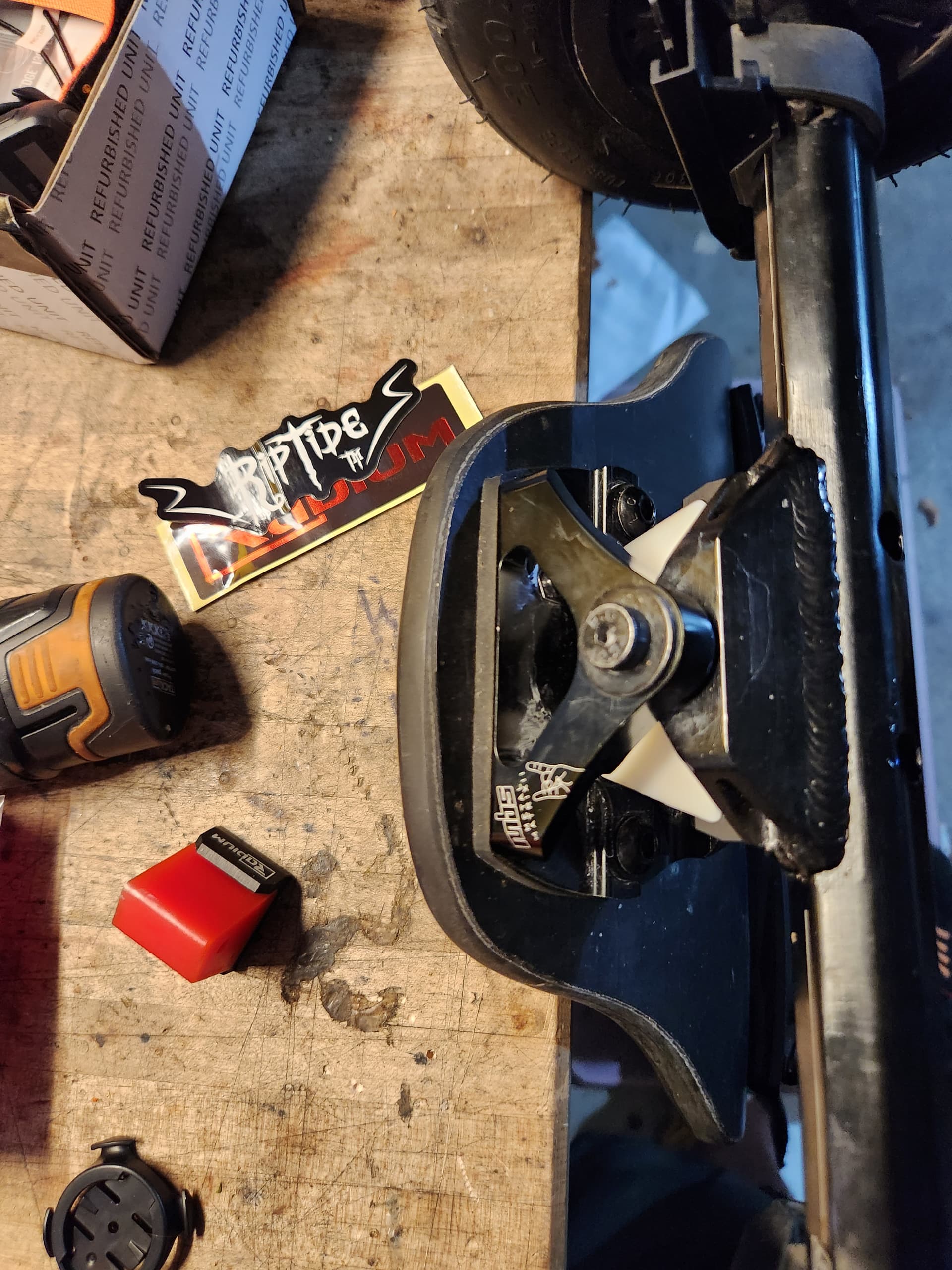

Yesterday I also got more riptide bushings and the second set of Radium adapters.
So the Flux is now on Green 80 and white 70.
And the gravel Flux is on drilled out gray 90 and Drilled out red 75.
I had to round off the edges of the Radium adapters for the 3DS hangers.
I haven’t tried the Flux.
The Gravel Flux I have ridden a bit. And I think I already like it better.
But I will try 80 and 70 on it as well.

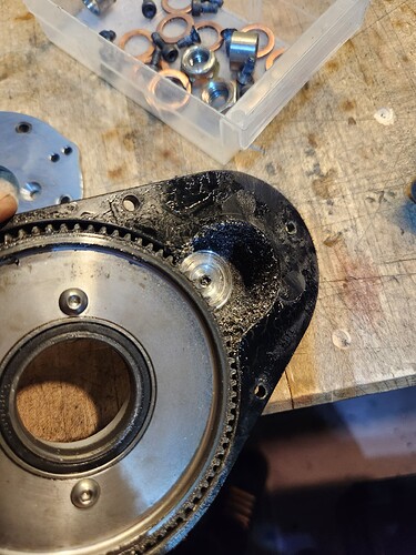

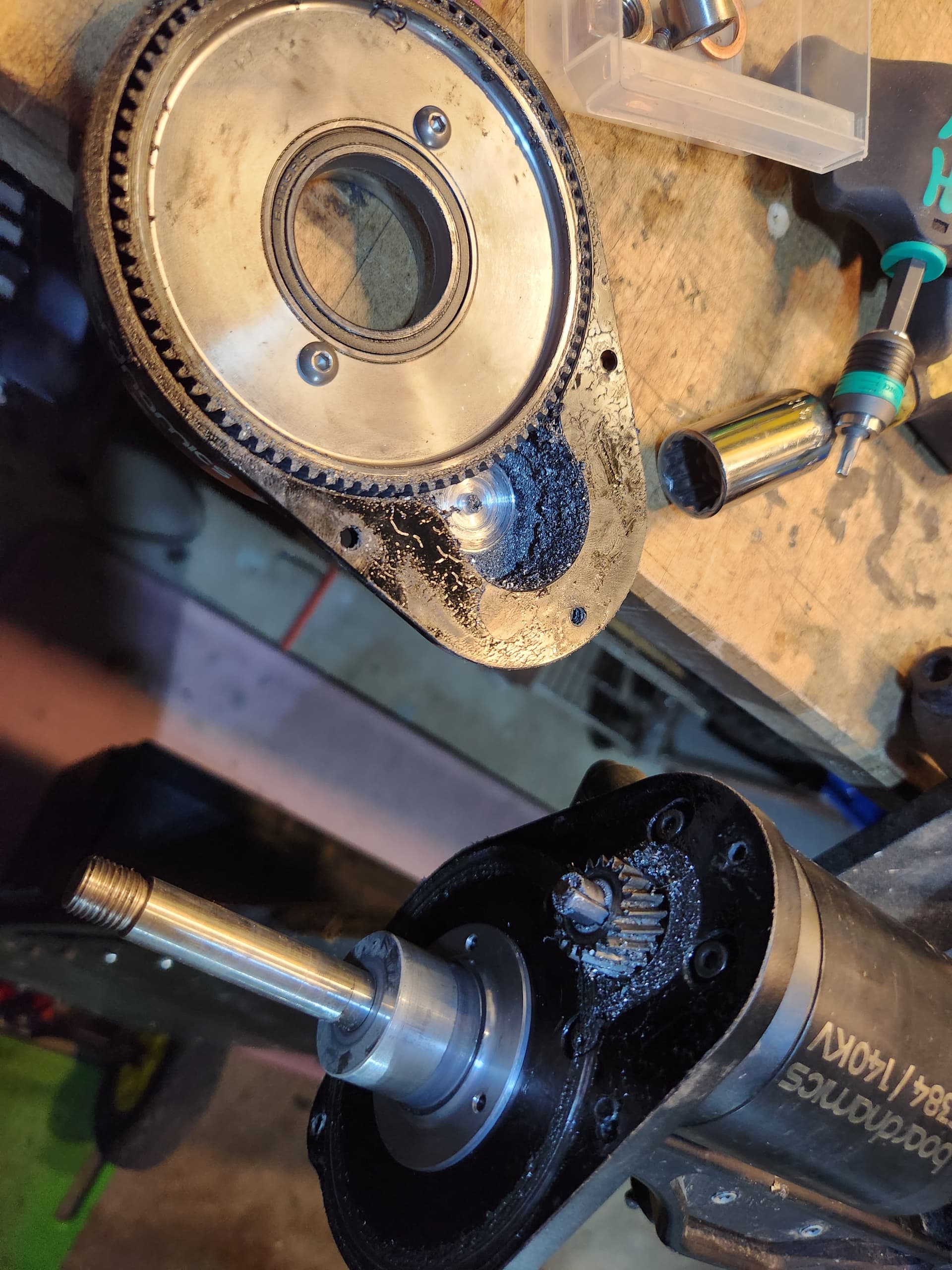

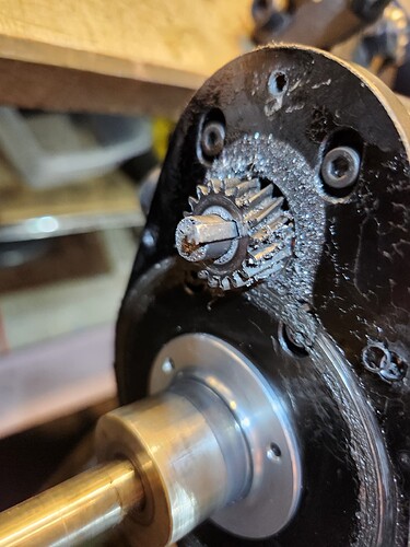

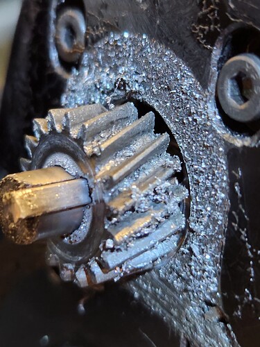

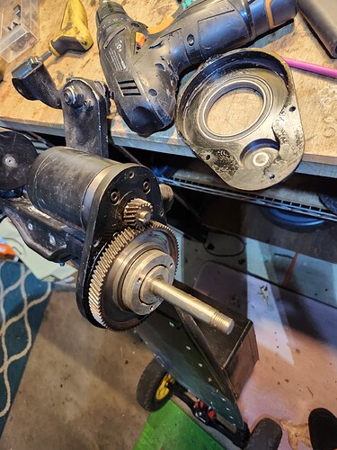

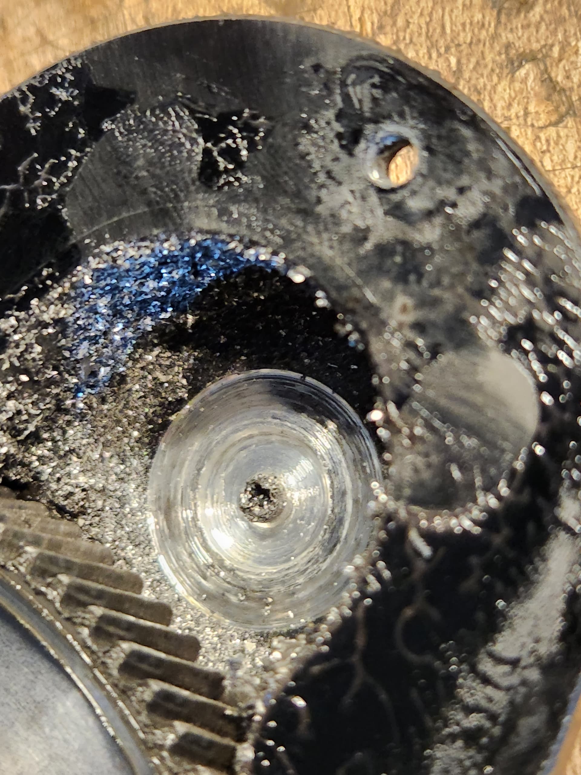

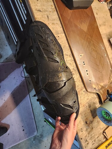

The other side of my BN AT drive decided it needed some loving…
Thank you skate gods for making this yet another gentle failure.
Funny noises happened and I rode home and there was no fall.
So all is good.
The right side that rerecently did this seems fine still so hooray for that.
On the plus side it looks like you can almost go with 10mm motor shafts now.:rofl:
