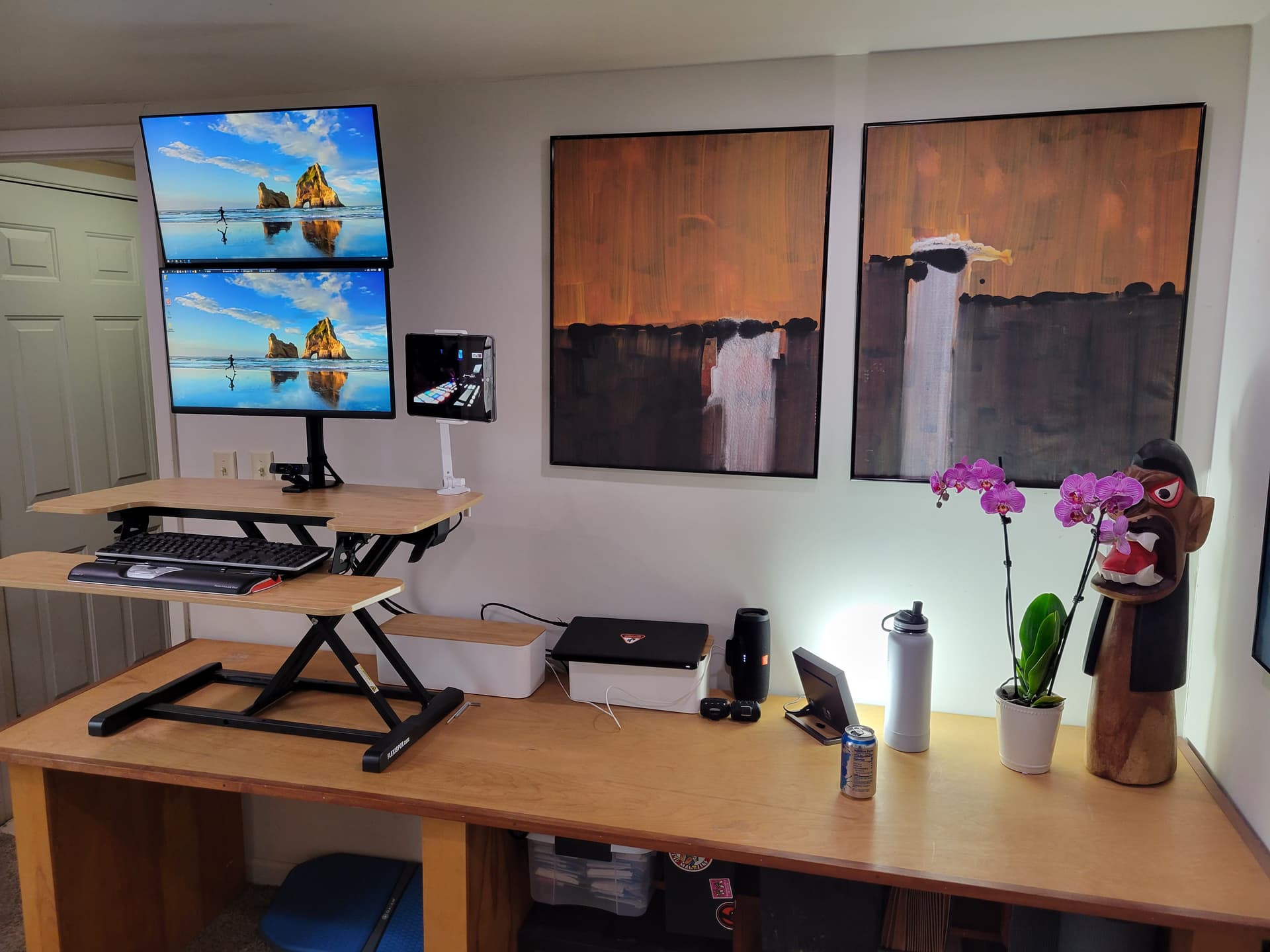

I also got excited about actually setting up my office space and set up a museum wall with the decks of the first 4 esk8s I got.
The Acton Blink
The Metroboard Micro Slim
The Evolve Bamboo GT
And the Wowgo 2S
The office is also a nice spot for stretching and doing my Physical Therapy exercises

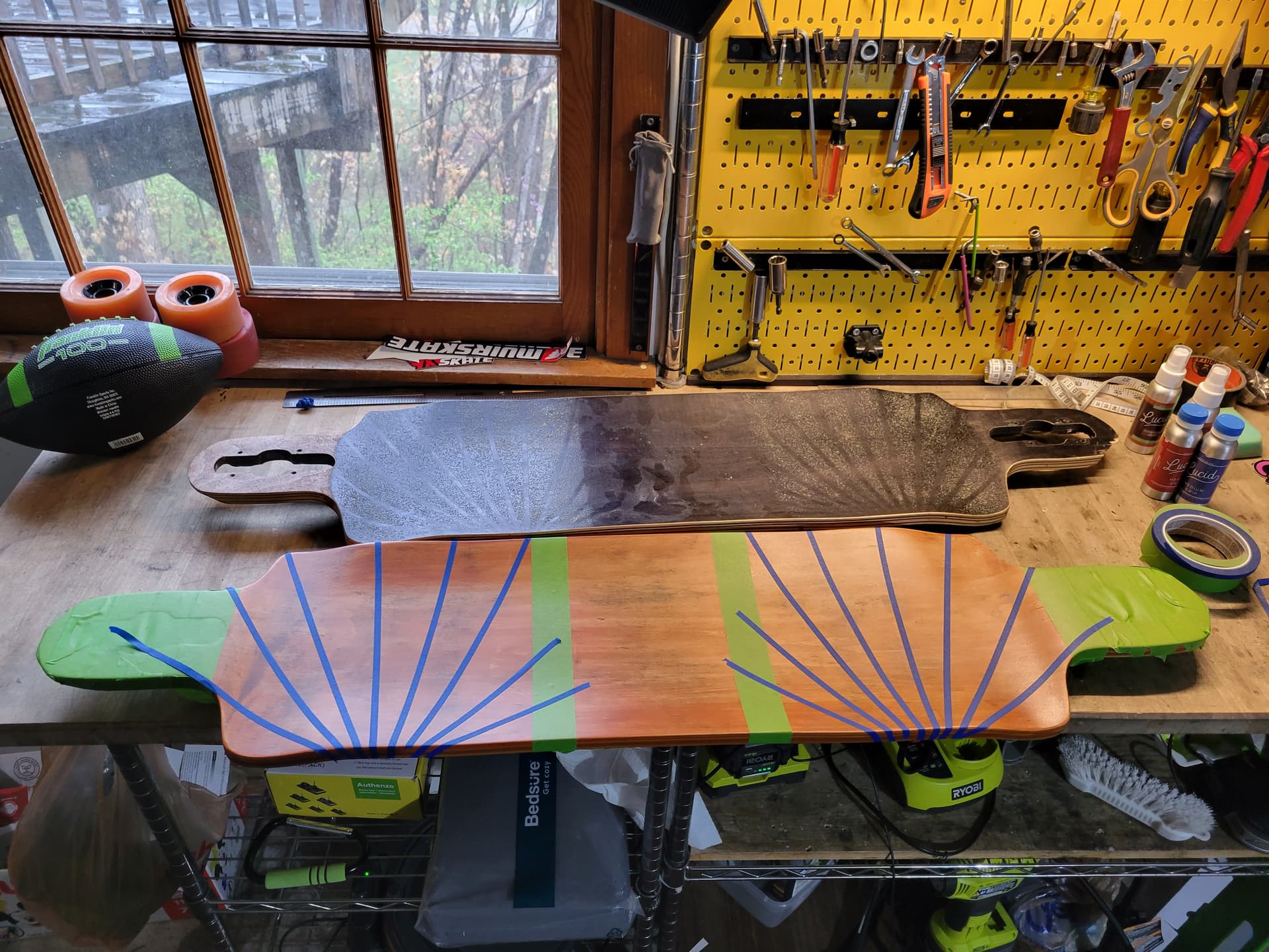

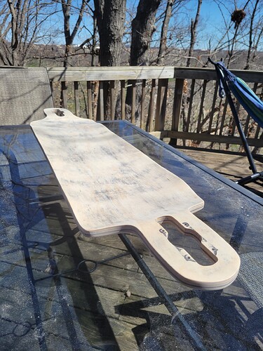

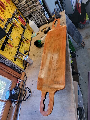

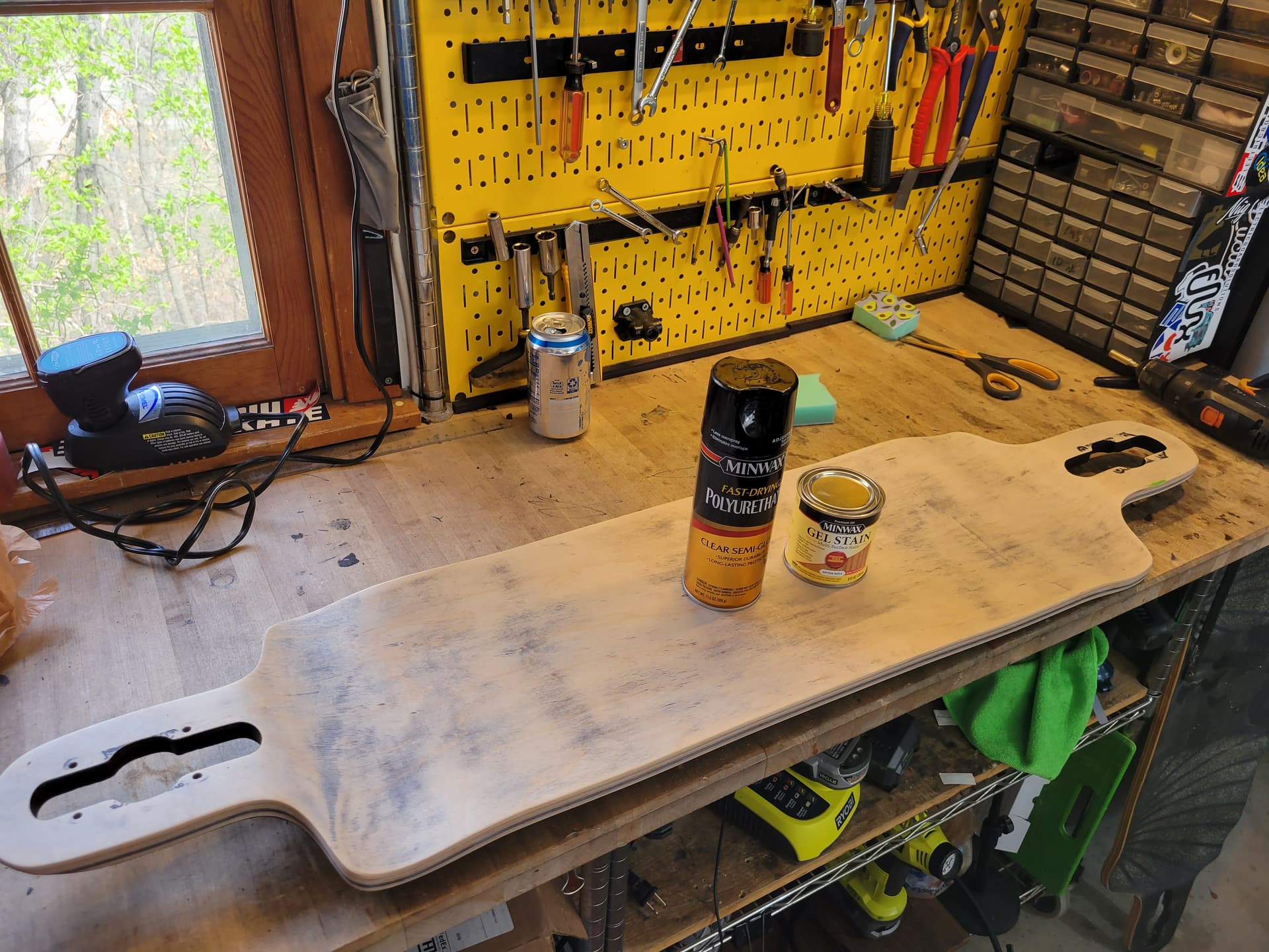

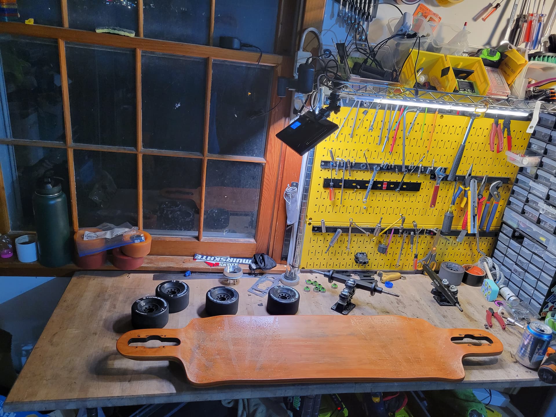

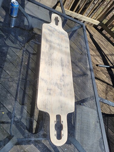

I think I left off where I was sanding the replacement Demonseed.
then I stained it and sprayed on some polyurethane…
I am quite happy with the stain.
pretty sweet to me.
So I then wanted to slap some Lucid on there.
so did that.
similar to recent times…
So now I was ready to slap parts back together.

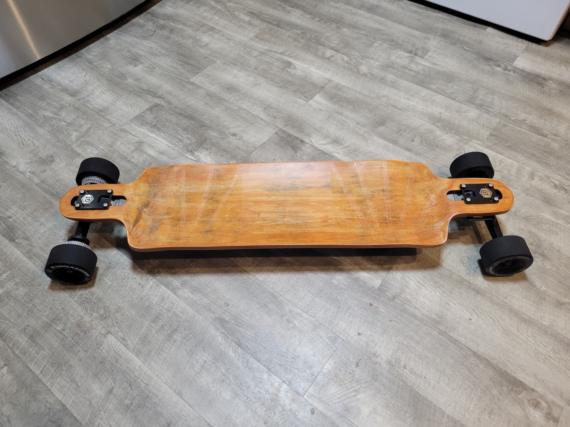

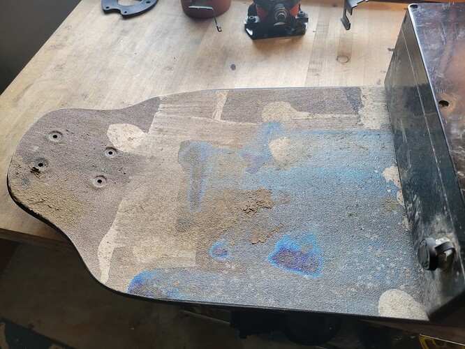

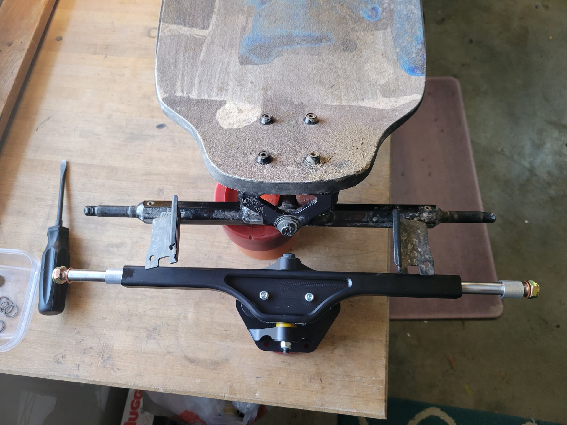

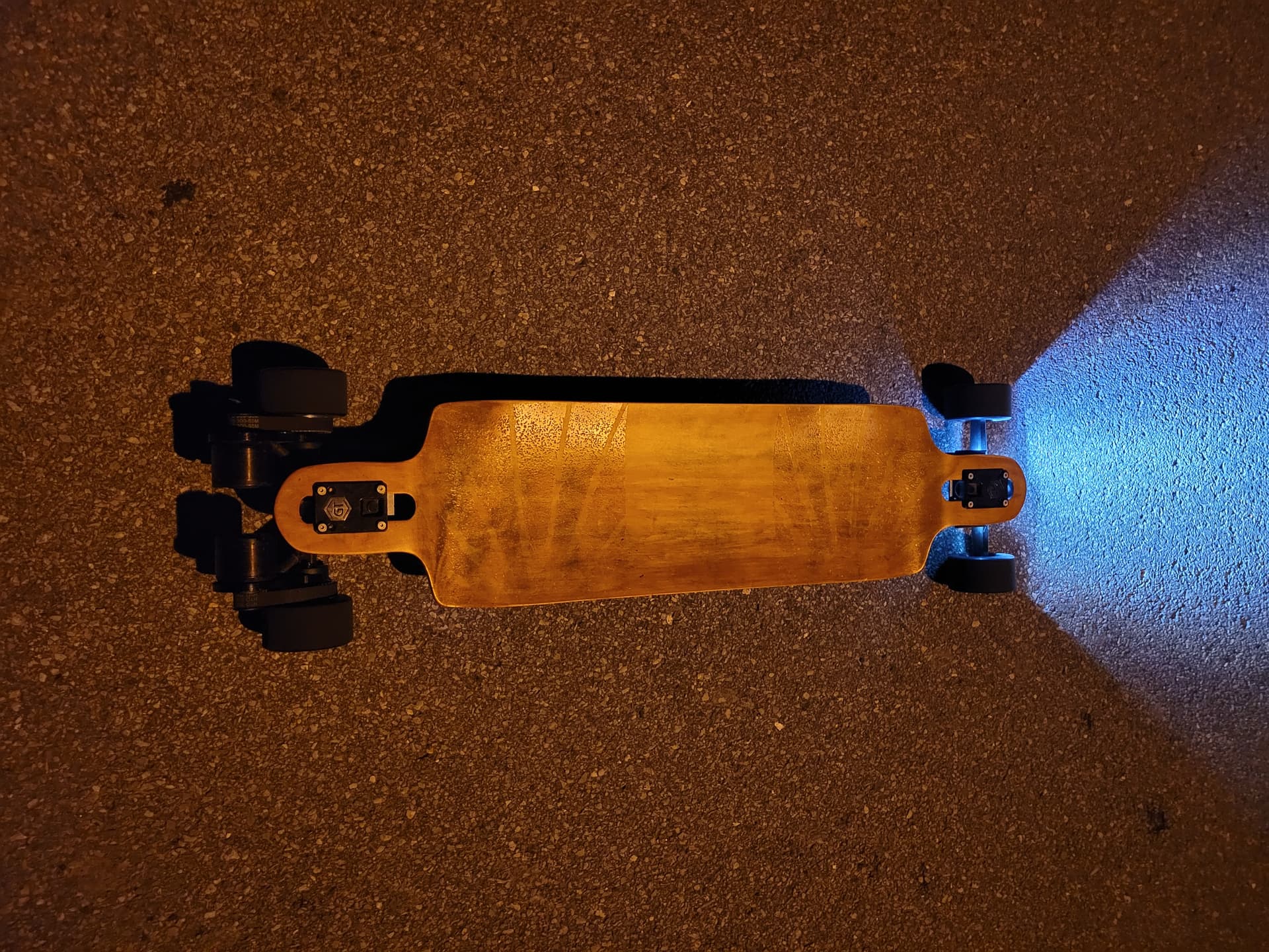

A few nights earlier I had decided I wanted to go from the 85 Caguamas, to the 100 TB wheels with the goal of mounting the trucks drop through and not top mounted…
I think drop through looked nicer…

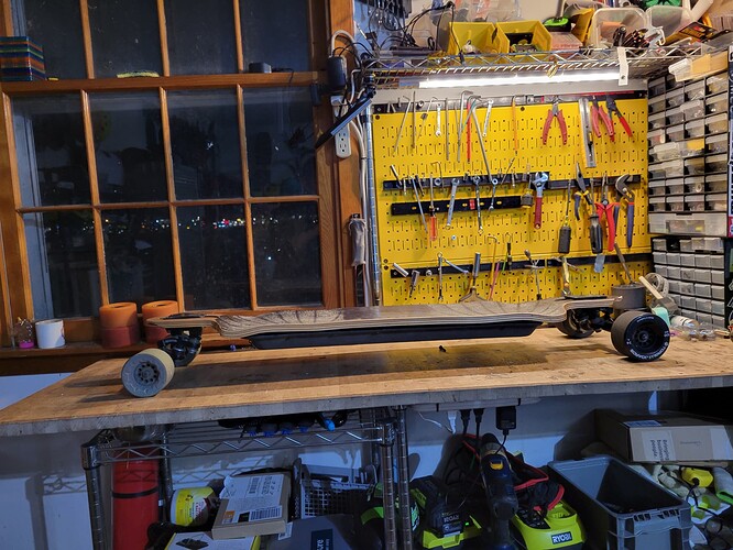

So I went on to slap it all together, and got it done and took it out late that night…
And despite the fact that I have slapped parts together a thousand times now… this thing was all fucked up and had to be rebuilt.
Clearance did not work - has to be top mounted…

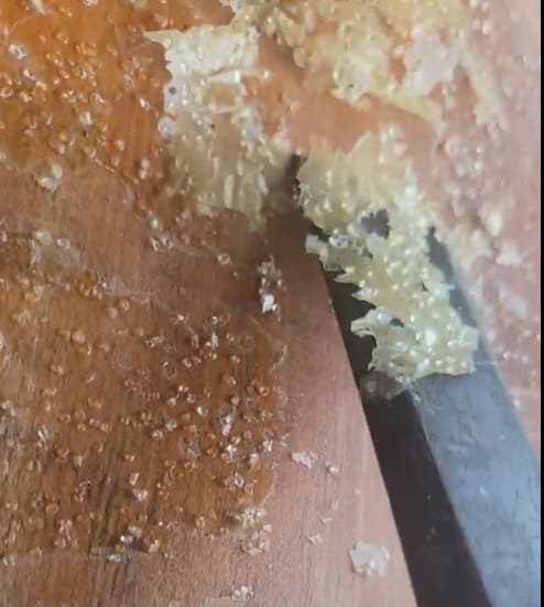

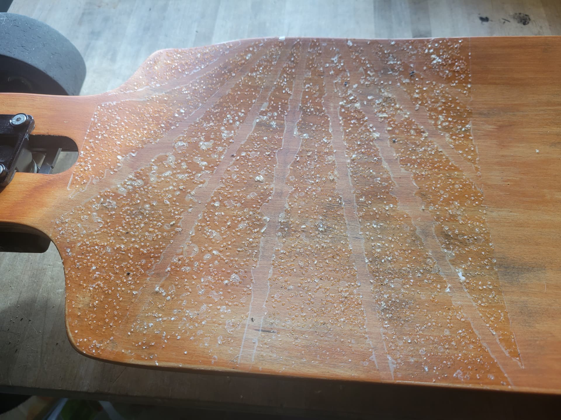

Lucid was pealing off - Previous coat of Polyurethane must be a problem.
4 of the 8 enclosure inserts were put in too wide. So I had to redo them…
So yeah.
The board I had Just rebuilt, needs a rebuild…
I’m super impressed that you are back to riding already after a spill like that.
So let’s rebuild the rebuild…

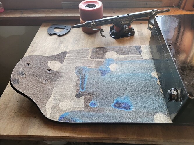

Scraping the Lucid off was easy, it really did not stick…
Next up was top mounting…
I was super lazy about redoing the inserts, drilled them out… put some plastic bonder in there, and new holes just next to them…

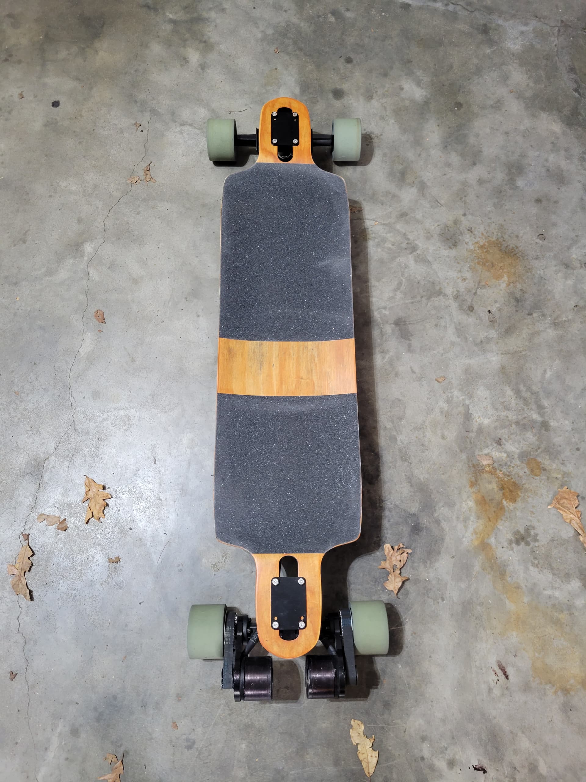

And I had just gotten some Jessup grip tape in the mail to have around and decided to just slap it on there so i could ride this thing…
oh, funny thing, started off with the more grayish Blue Caguamas, and realized it would look better with some that were more black to match the grip tape…
so yeah,
here it is.
I have taken it out on a few excursions, and have been riding it in front of the house while watching the kids.
And I really love this thing. It is so divey and so surfy, and I get so low on my carves and it is just so different.
It is the only set up that does not feel super stiff after riding the Pint X.
So, stoked on how it rides and how it looks.

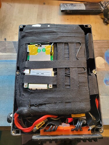

I do think I want to upgrade the battery maybe, from the 10s4P 30Q to maybe a 12s3P P42A,
Maybe, not sure.

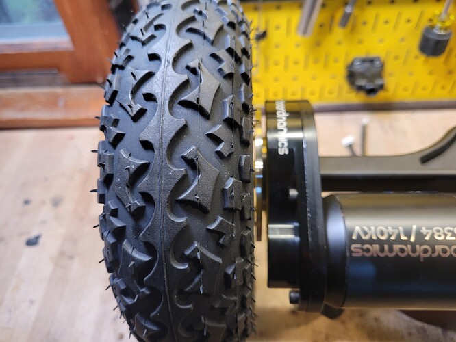

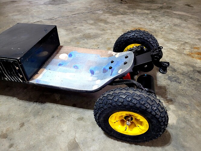

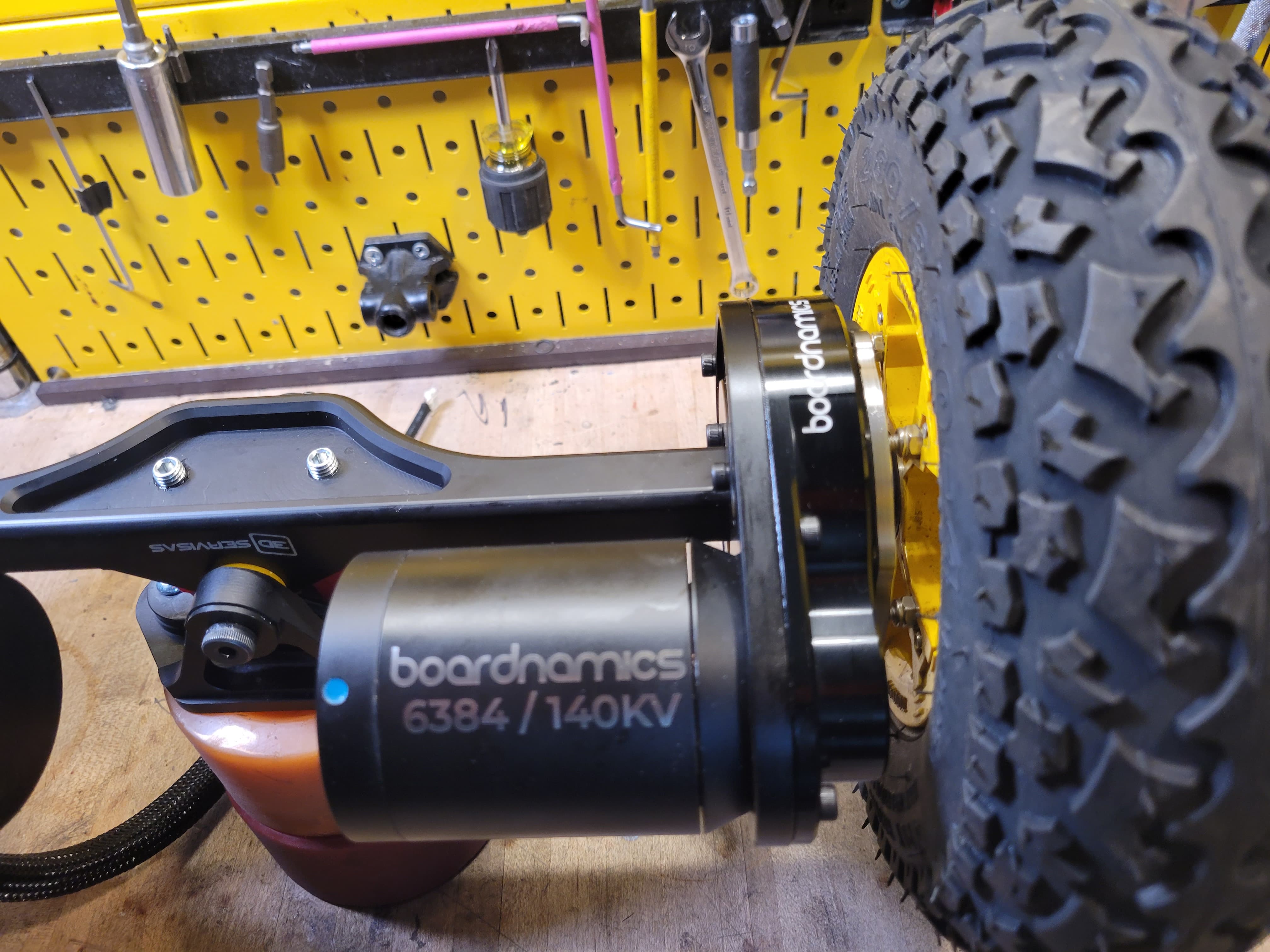

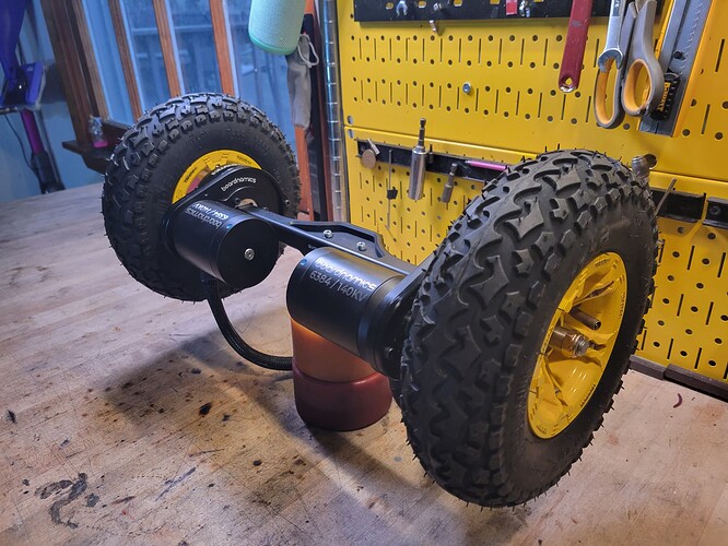

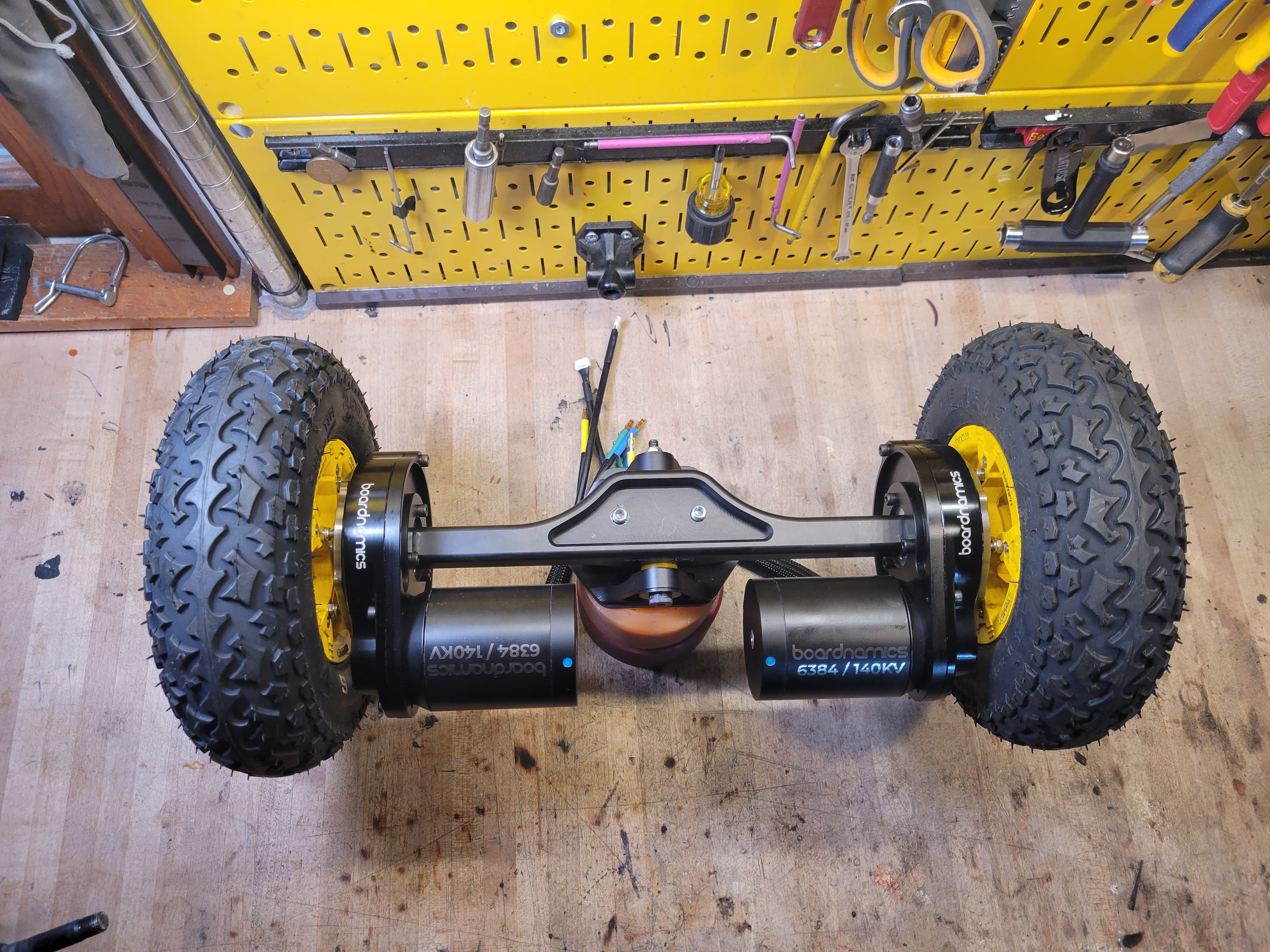

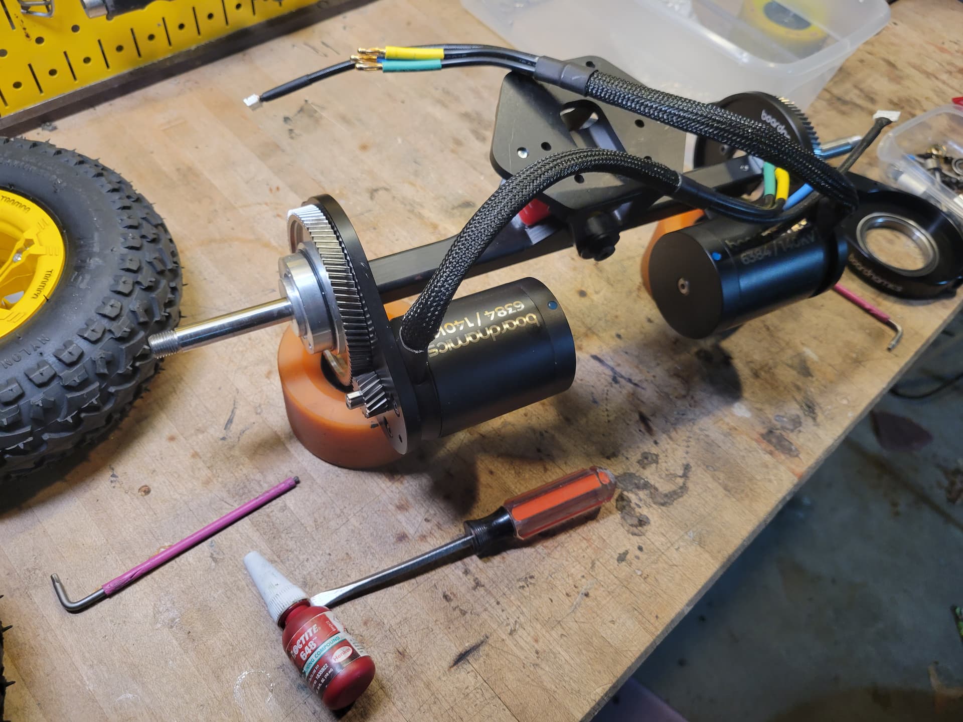

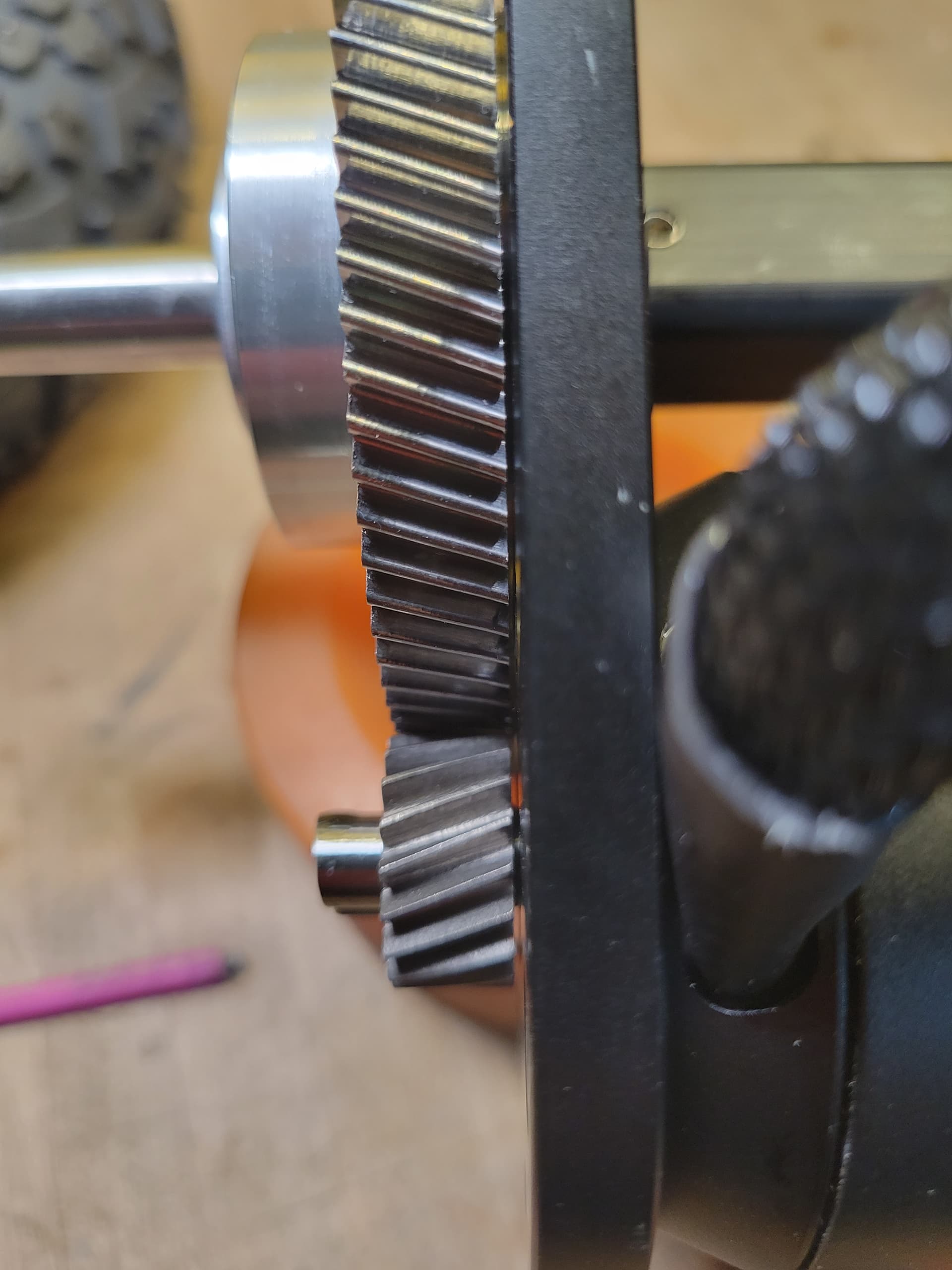

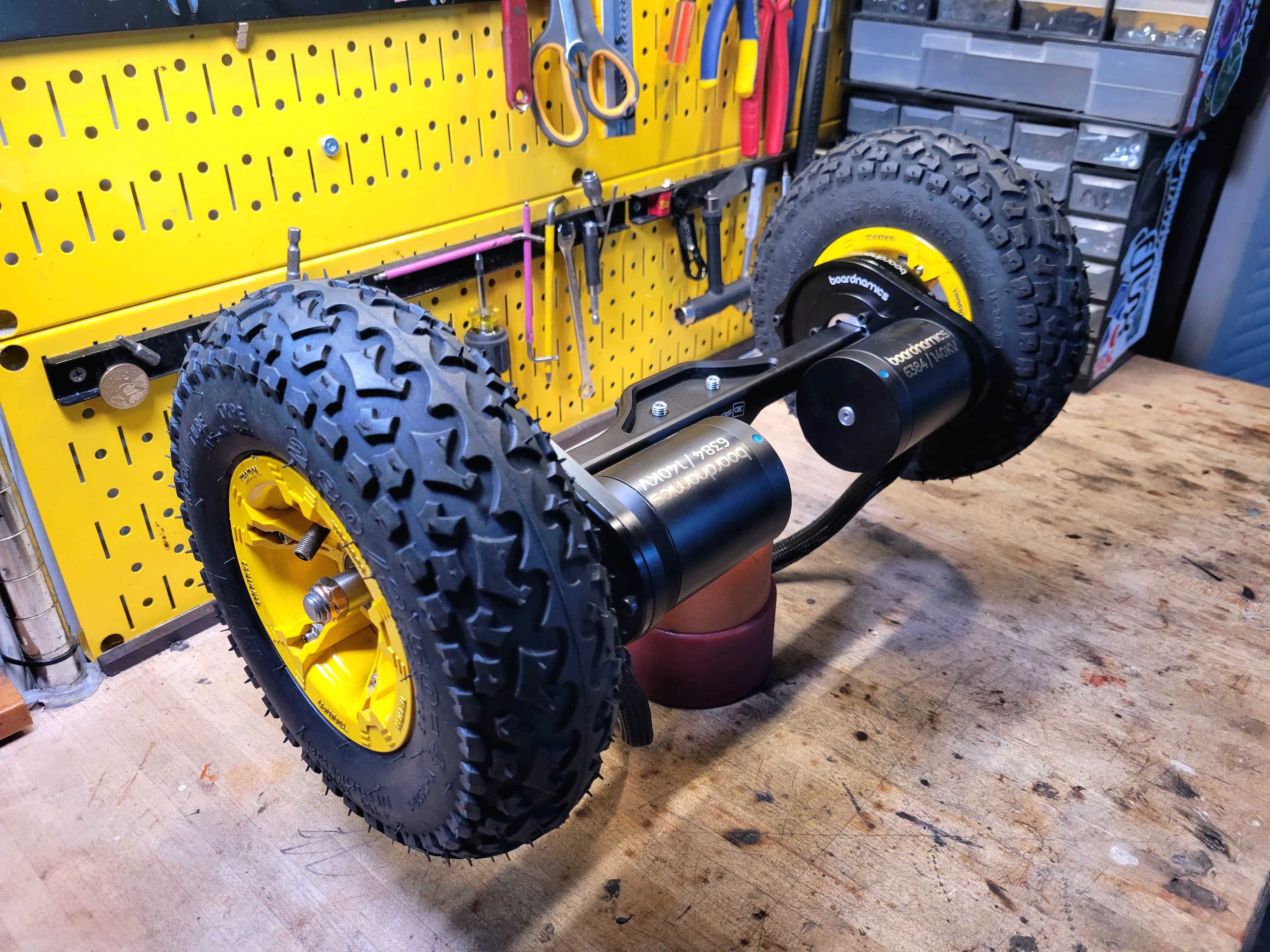

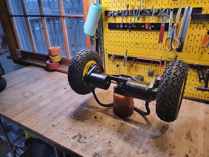

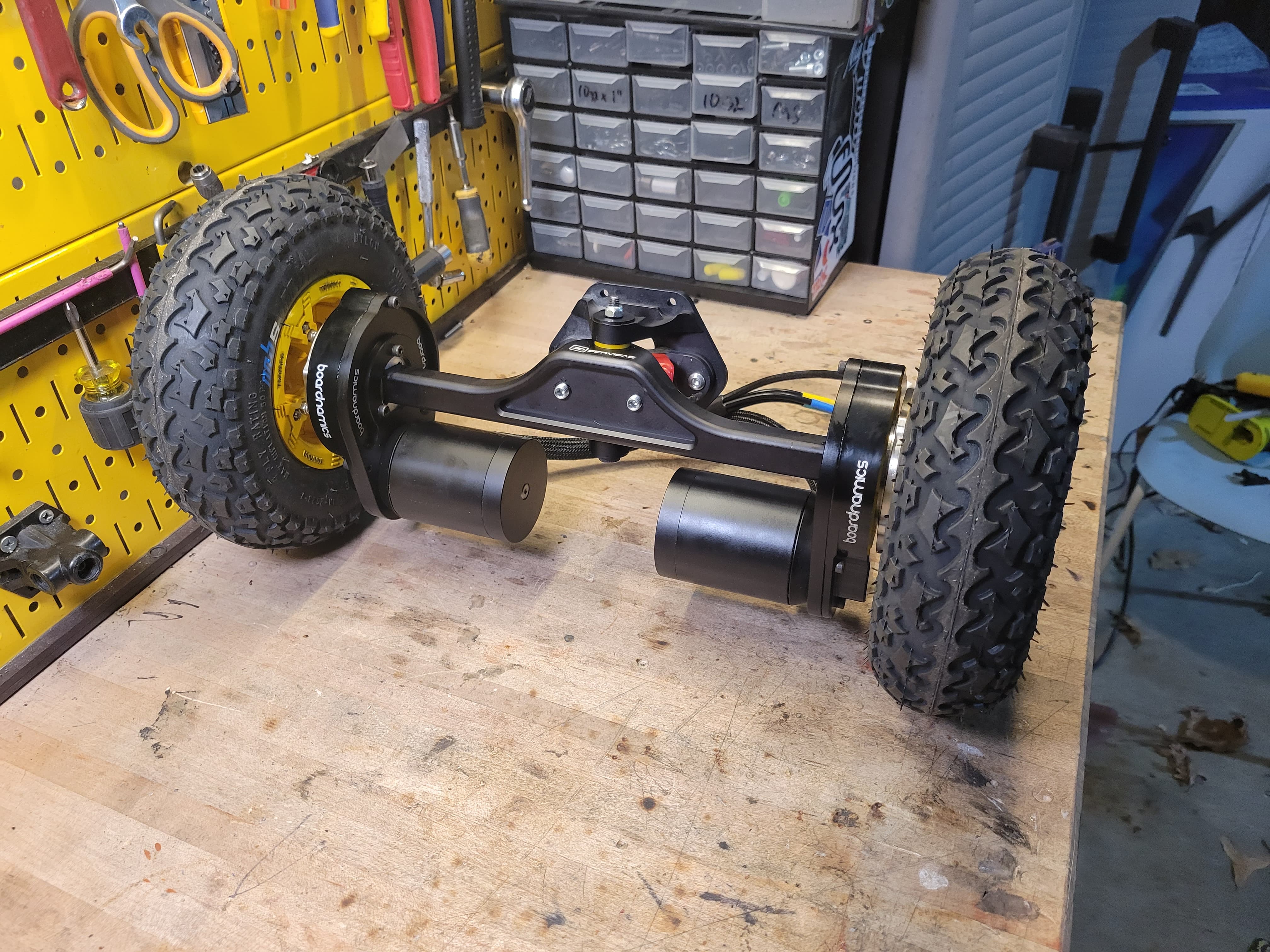

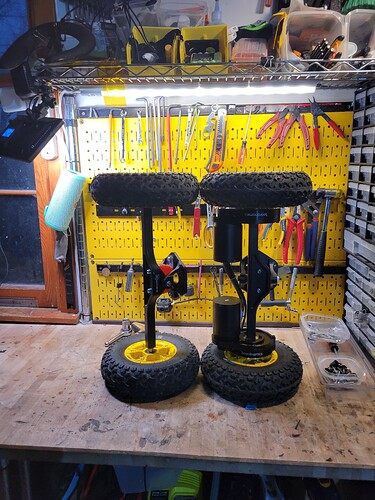

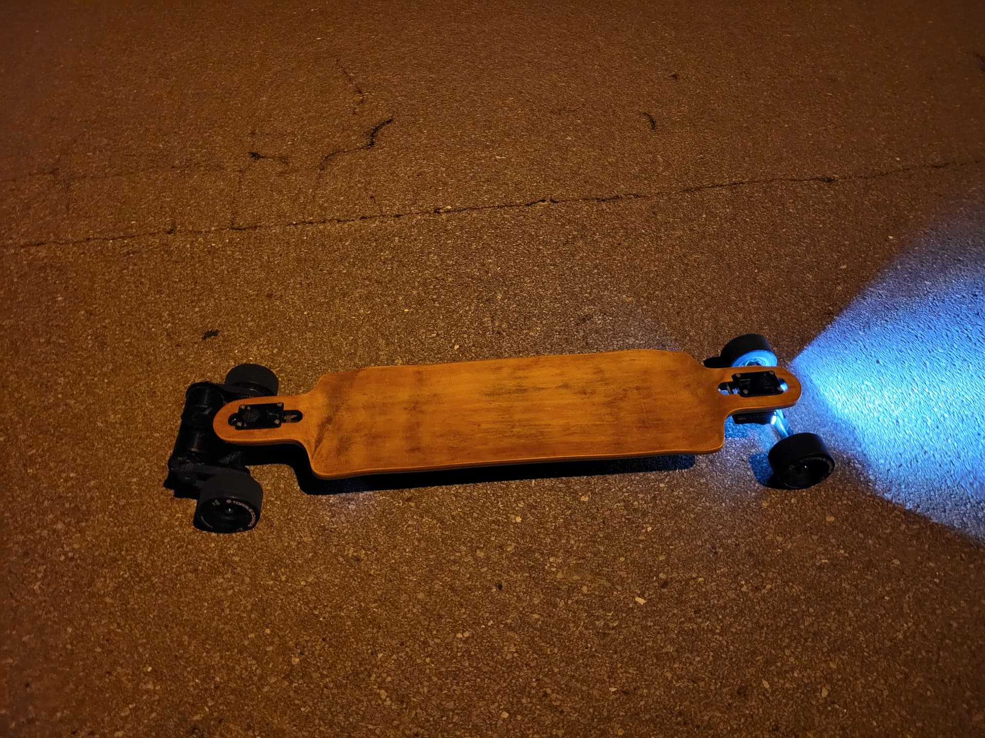

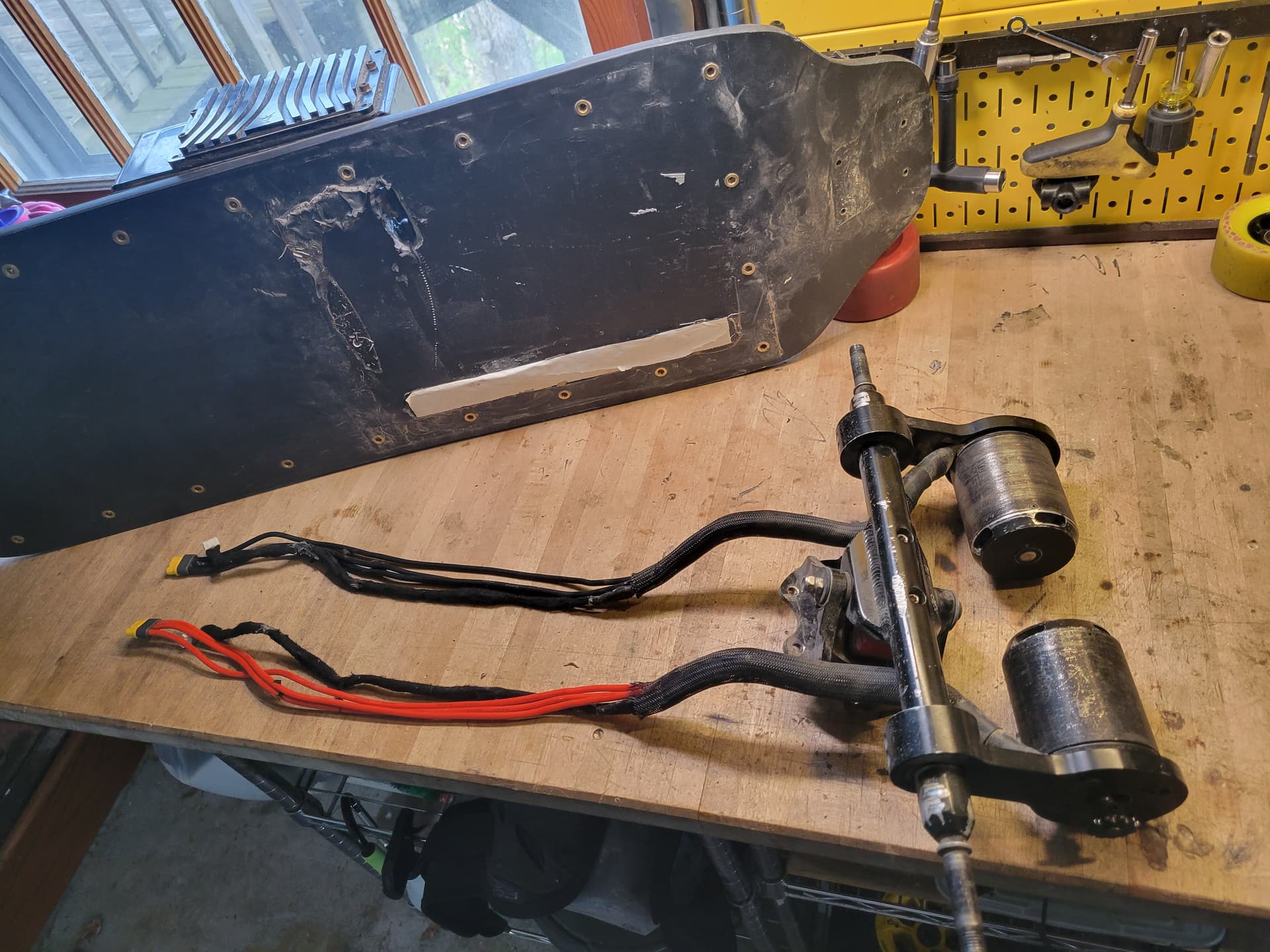

The Gravel Flux/Tow truck is on the bench.

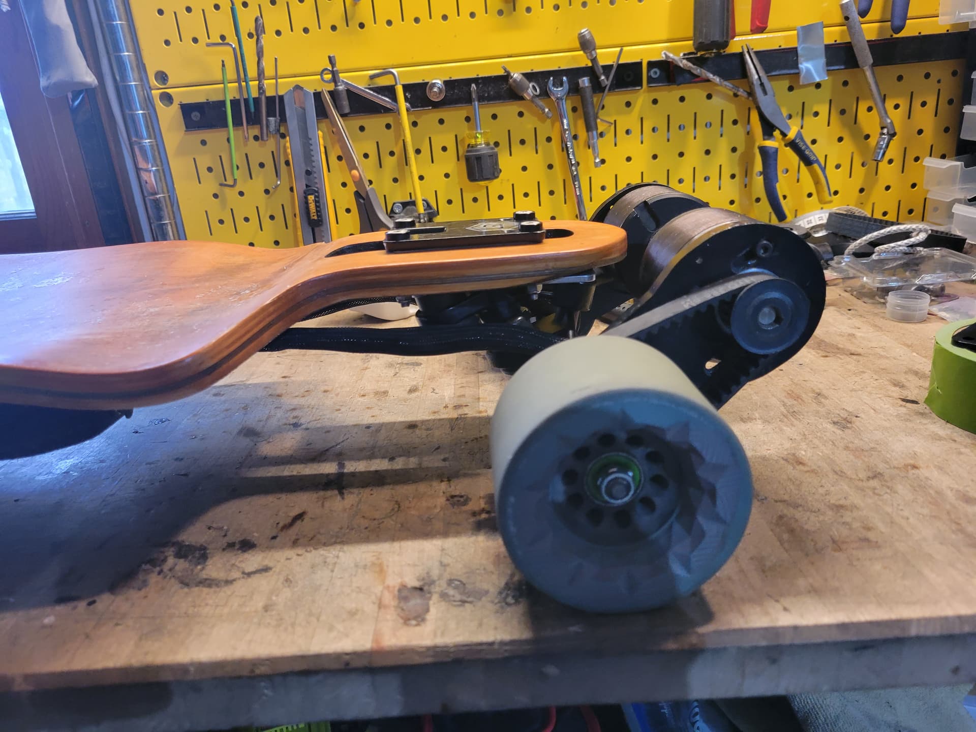

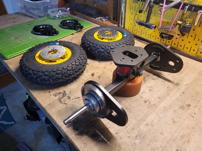

Getting new trucks, gears, and motors.
These are all really nice parts, and I am pumped.
I wonder how much the extra width changes the ride feel…

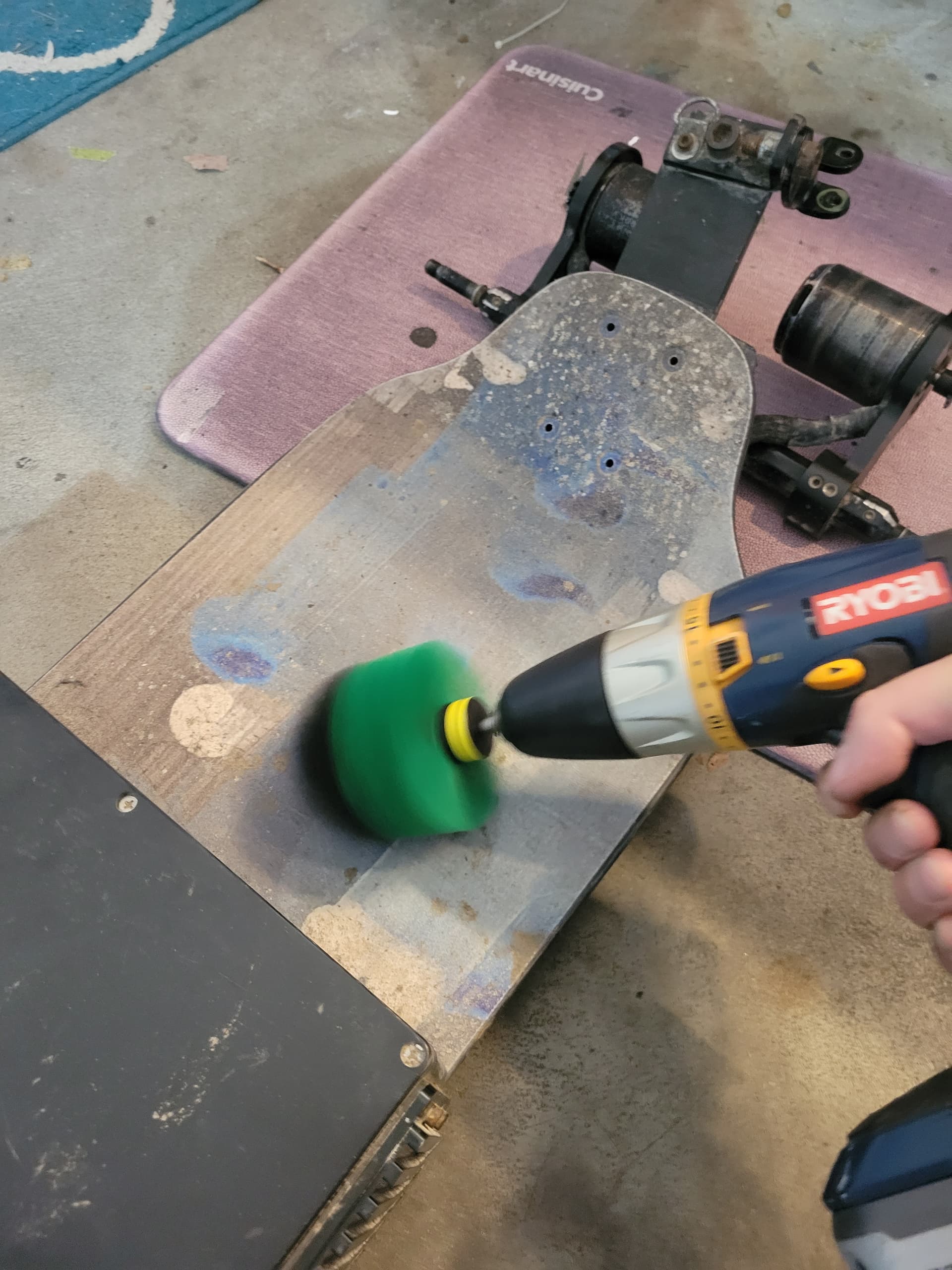

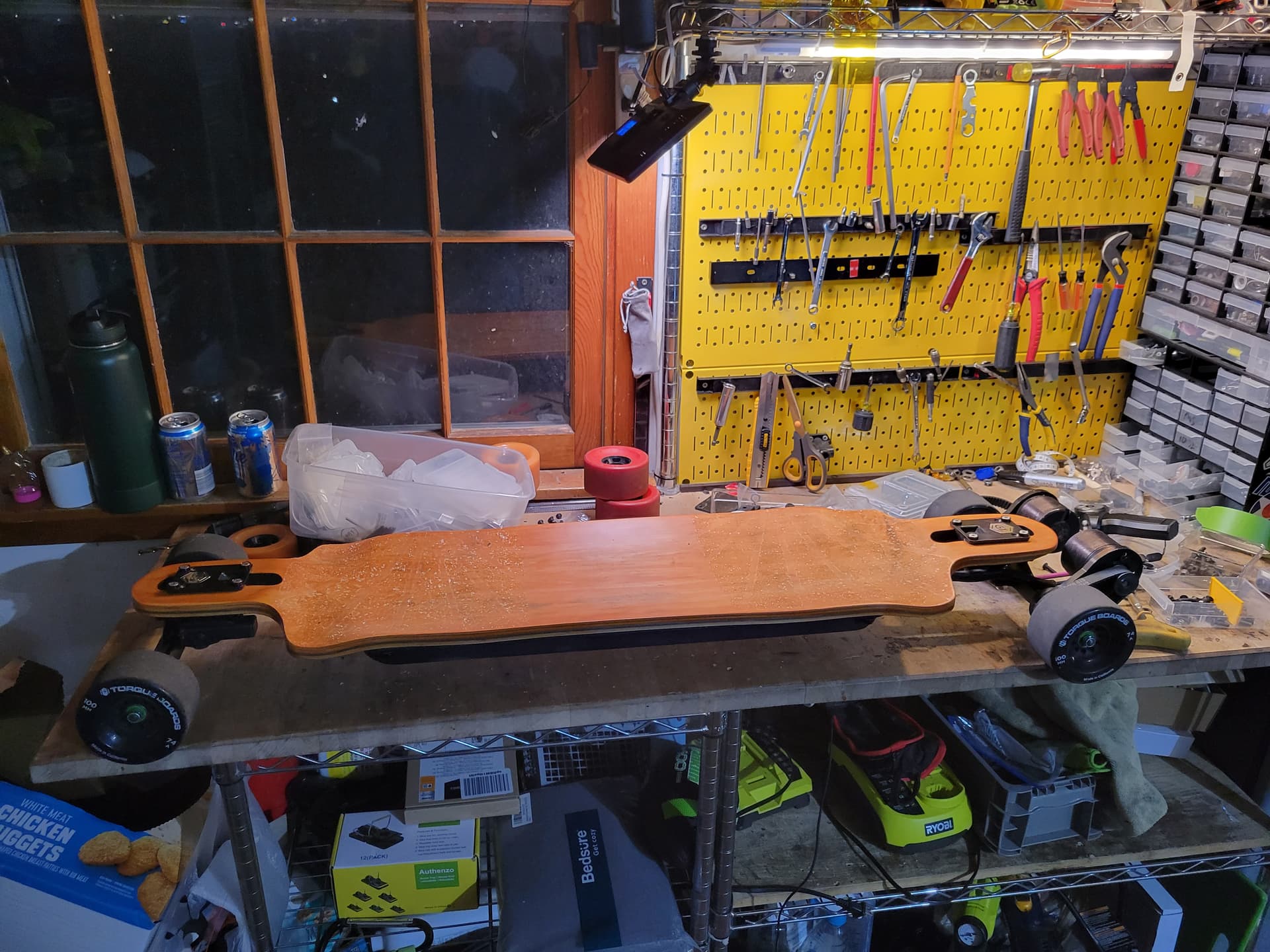

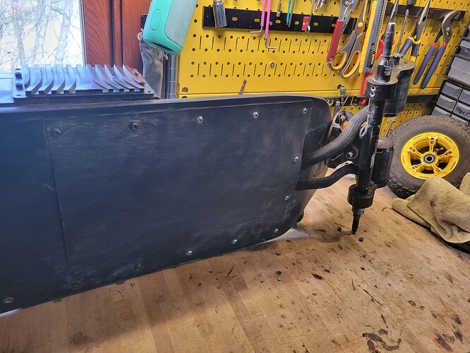

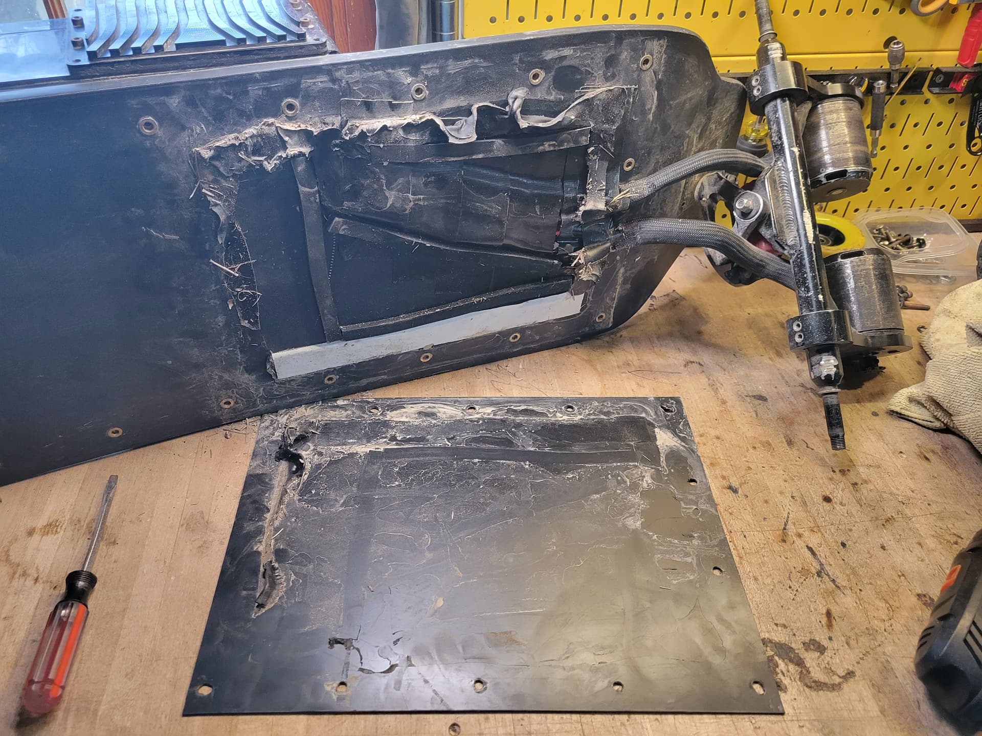

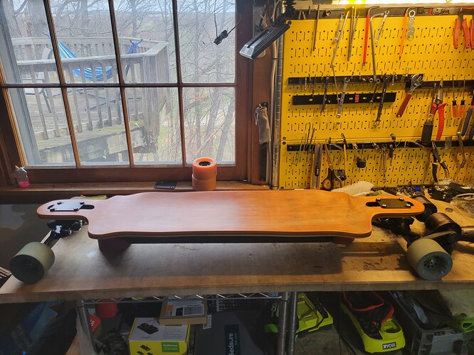

I got the deck decently cleaned up.
I had to take the whole thing apart due to my super clever and convenient extended wires set up…

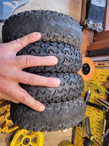

slapping new tires on the back.
I totally love how the BN gears come together.
such neat parts.
I don’t have it wired up, need to make cable extensions, but here is how it is gonna look!!!

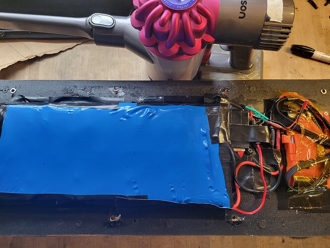

Get back to work on the Flux battery(long ways to go)
