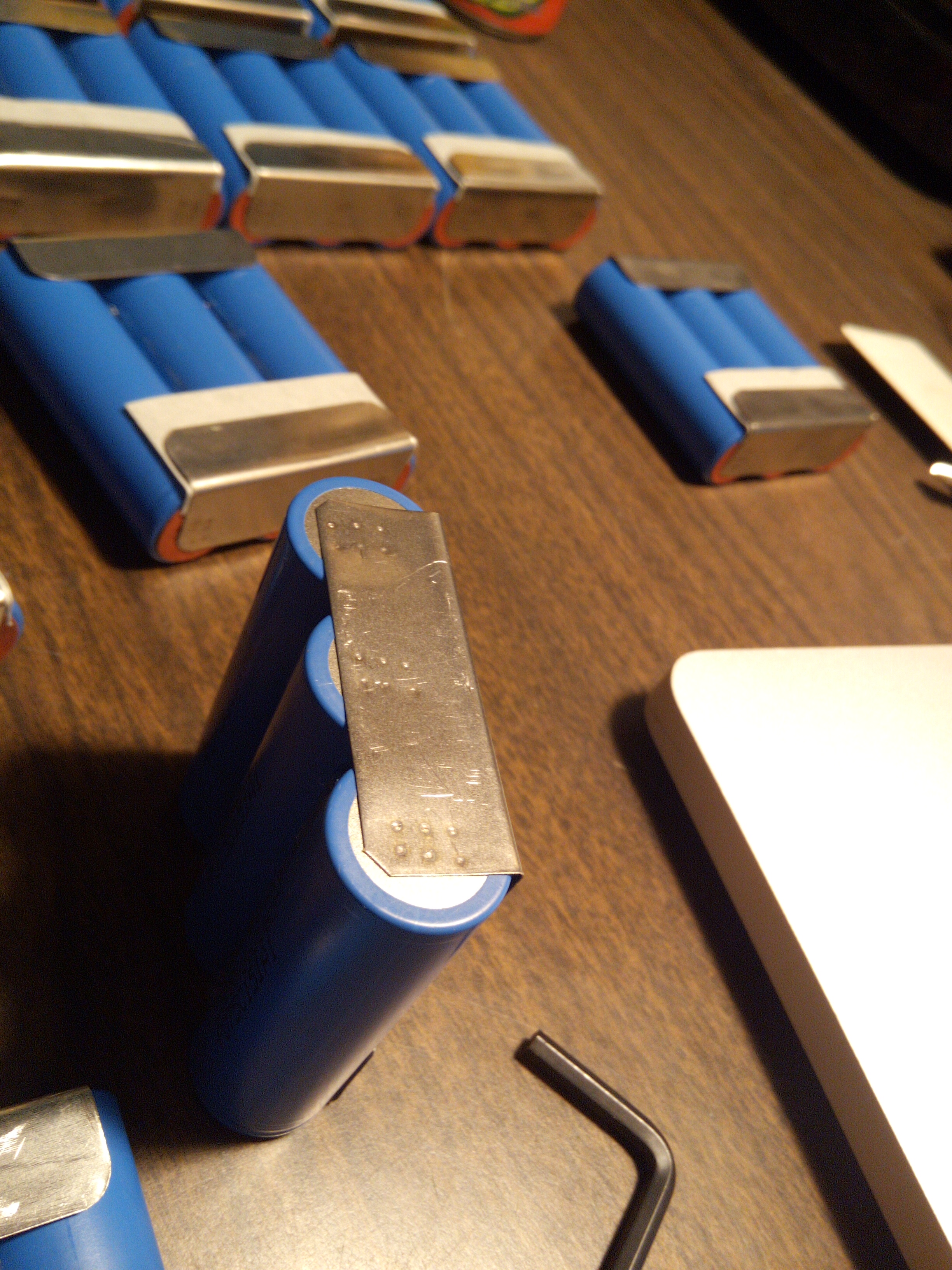

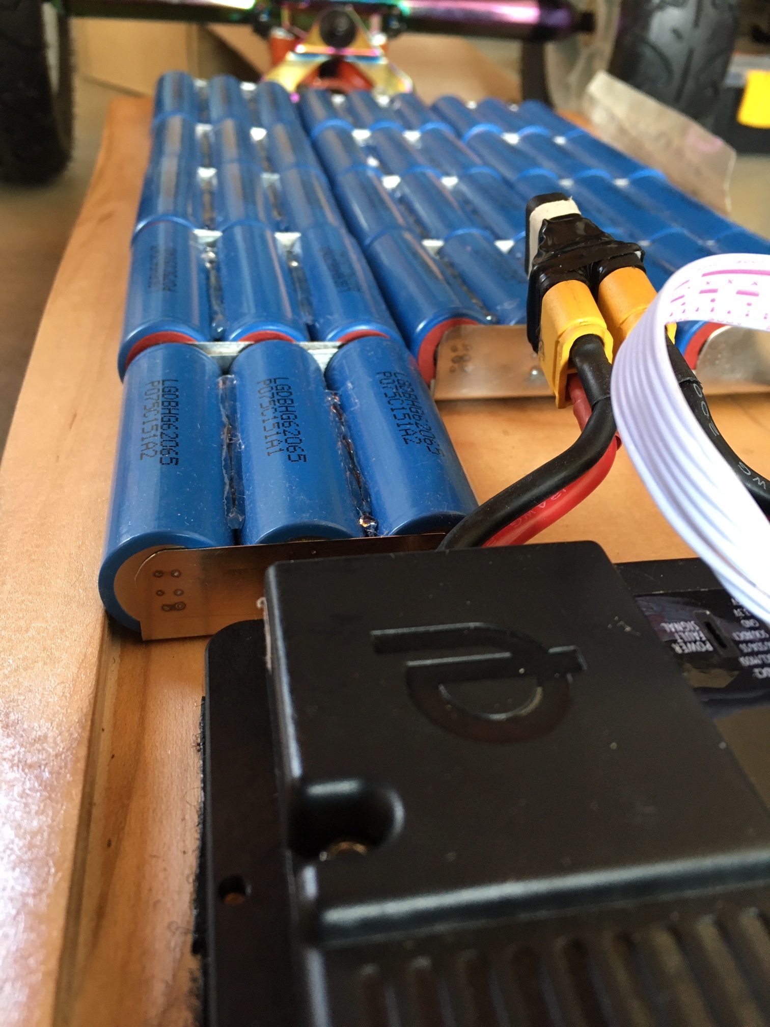

The cells arrived from @iamasalmon
So friggin close, should be able to just round off the edges to make it fit.
oh wow. you are going 13s3p…looks fun :smile:
Man that’s a tight fit, aaaaaalmost…
Got a router? Set up a nice straight fence, run this puppy over that edge,

This is not the project to learn how to use a router. I wonder how far you can just get with some sandpaper on a dowel…

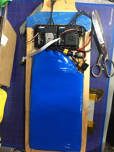

OK, some updates:

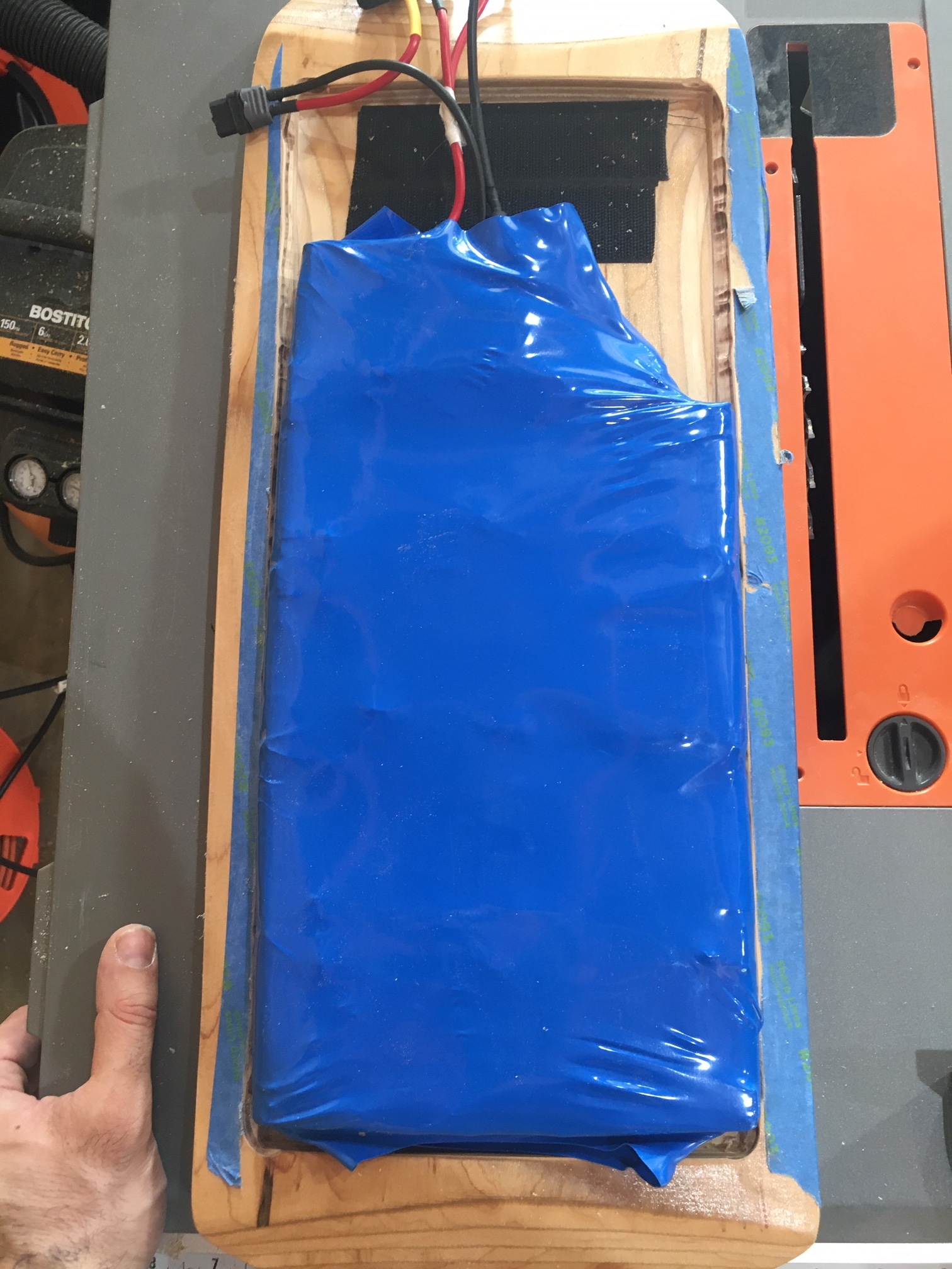

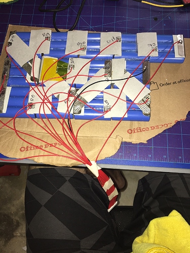

Built the battery: LG HG6 13s3p

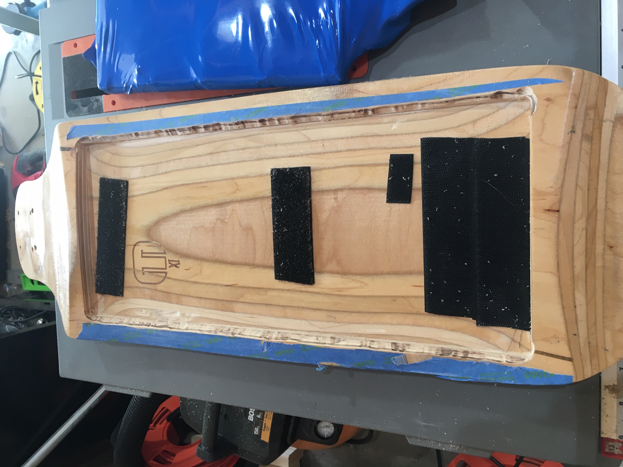

Next I routed out 2mm on the sides to fit the battery. I’m so sorry @rey8801to do his to your baby, it looks like total garbage–I know nothing about woodworking and didn’t have equipment to set up a fence so I just freehanded it =/

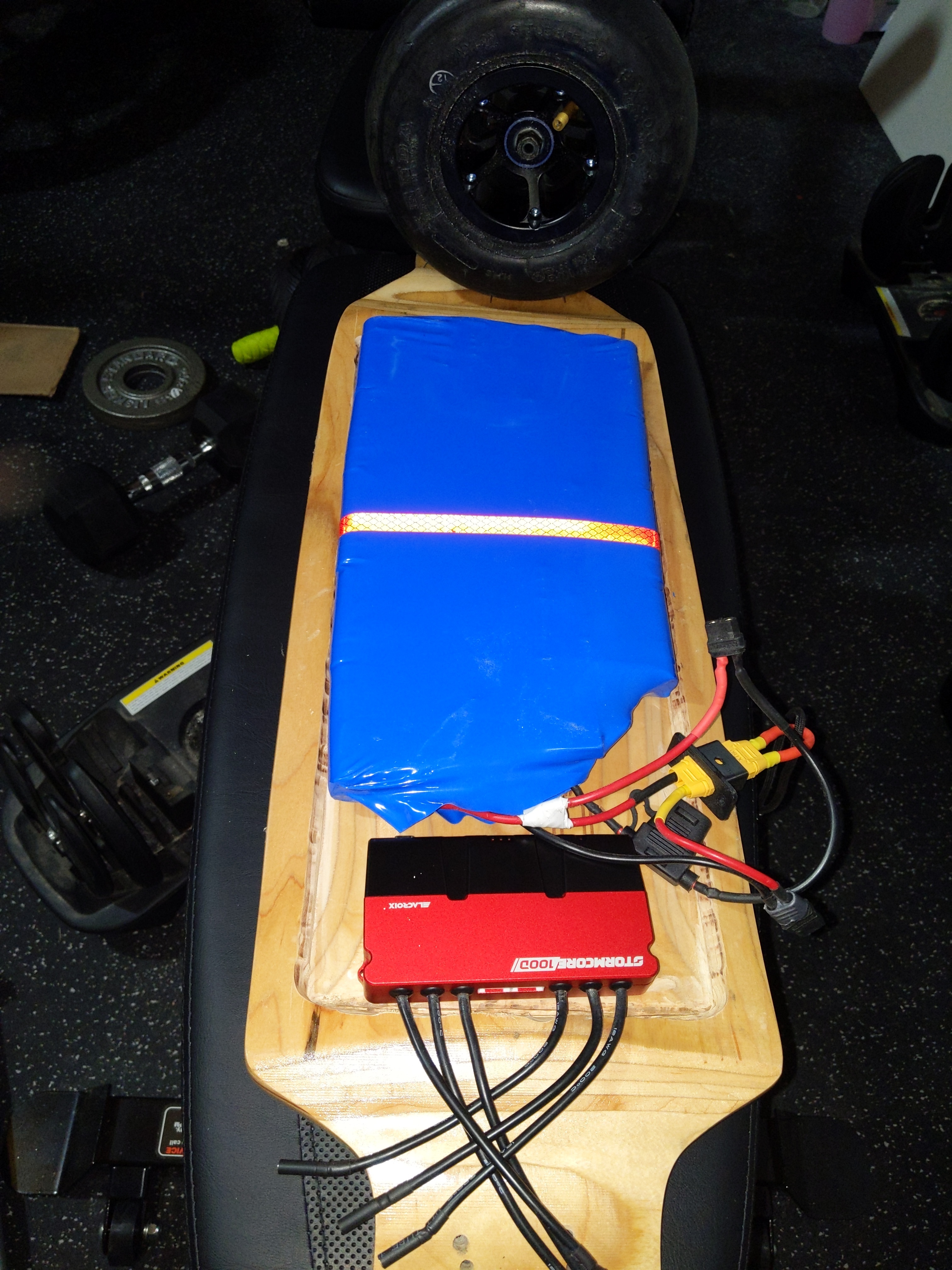

Routed a little extra out at the top to fit the ESC’s and vwallah, this is one SNUG TIF, but it should work out!

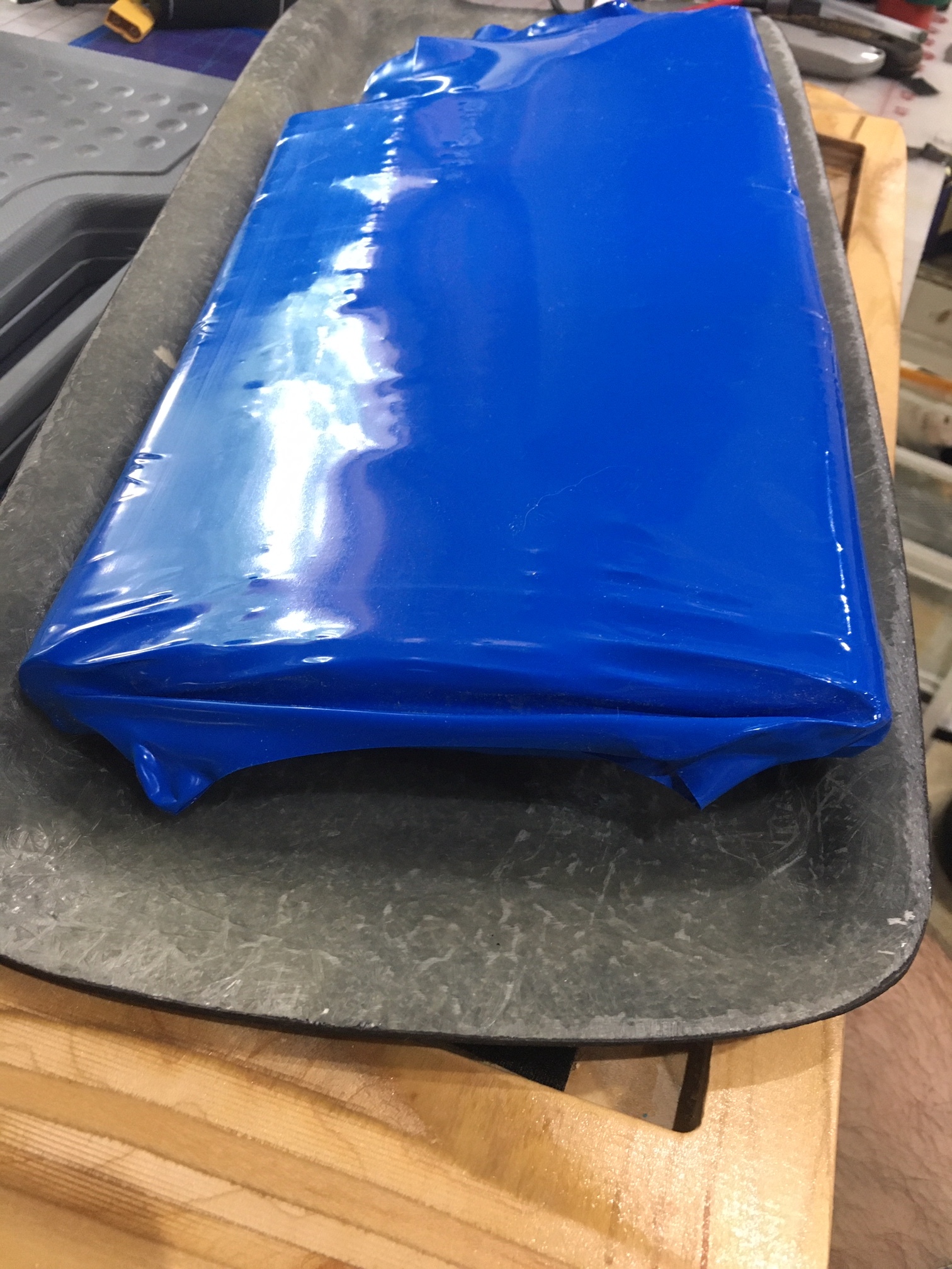

I already knew the cavity in the choo choo was too small but I didn’t think about the enclosure…

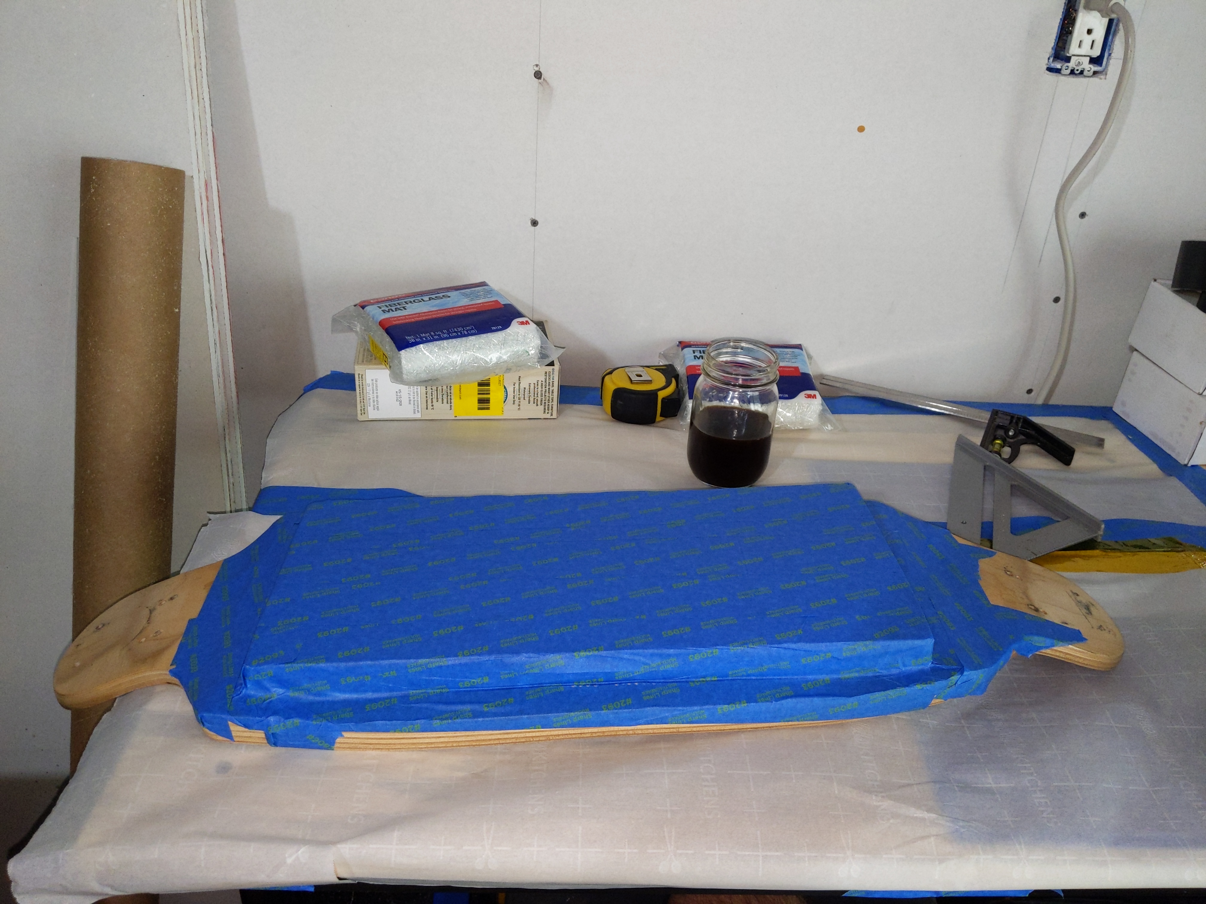

so that’s fucked…Now I have to make a new enclosure and I’m not sure how hard thats gonna be. Any ideas guys on something not too complicated? Kydex?
Not the worst routing I’ve seen around here, lol, should be fiiiiine…
I was looking at the pics, all excited at how TOIT it all fit, then…
ouch.
you already know what I’m going to say…
You’ve come this far…

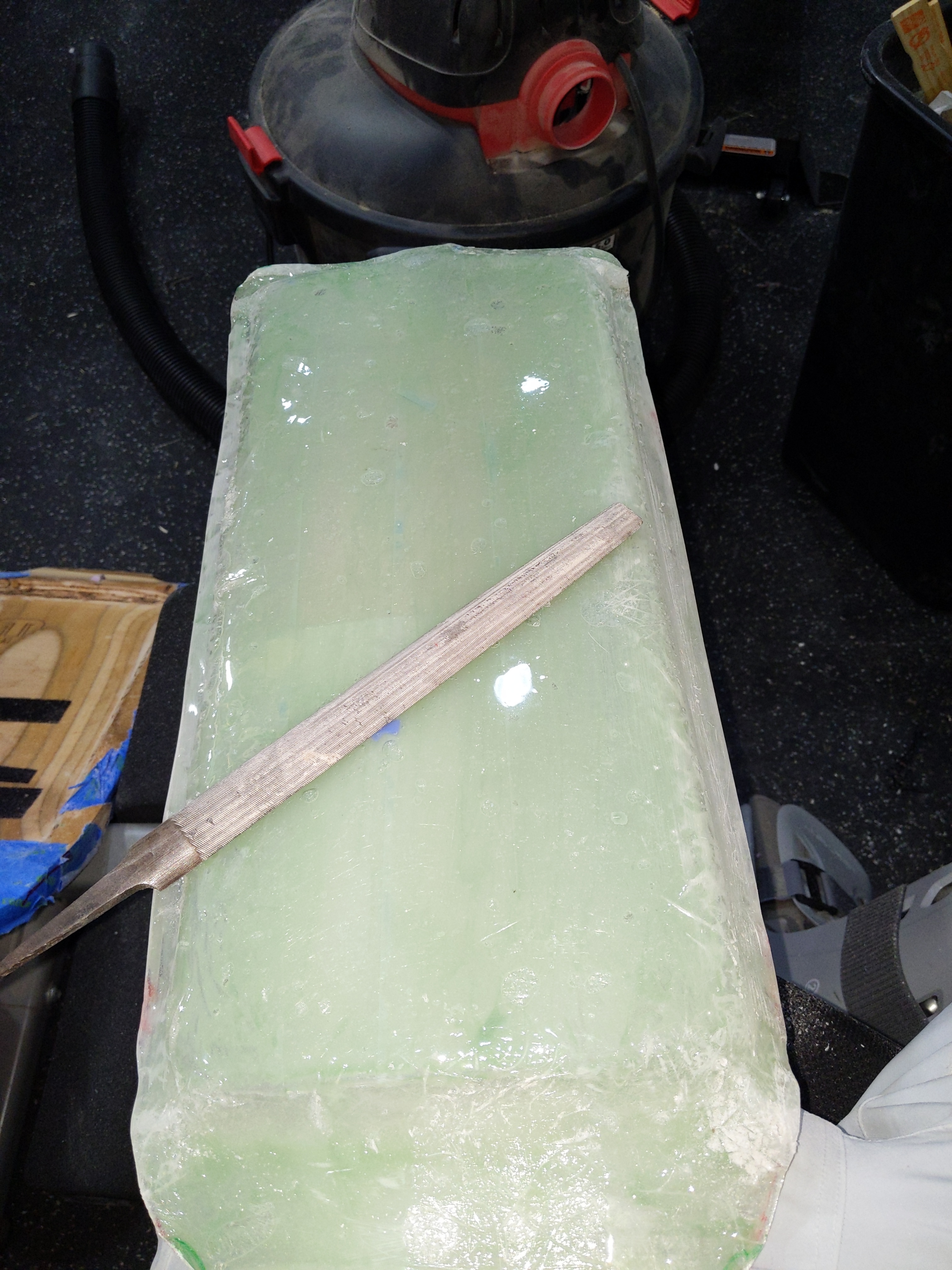

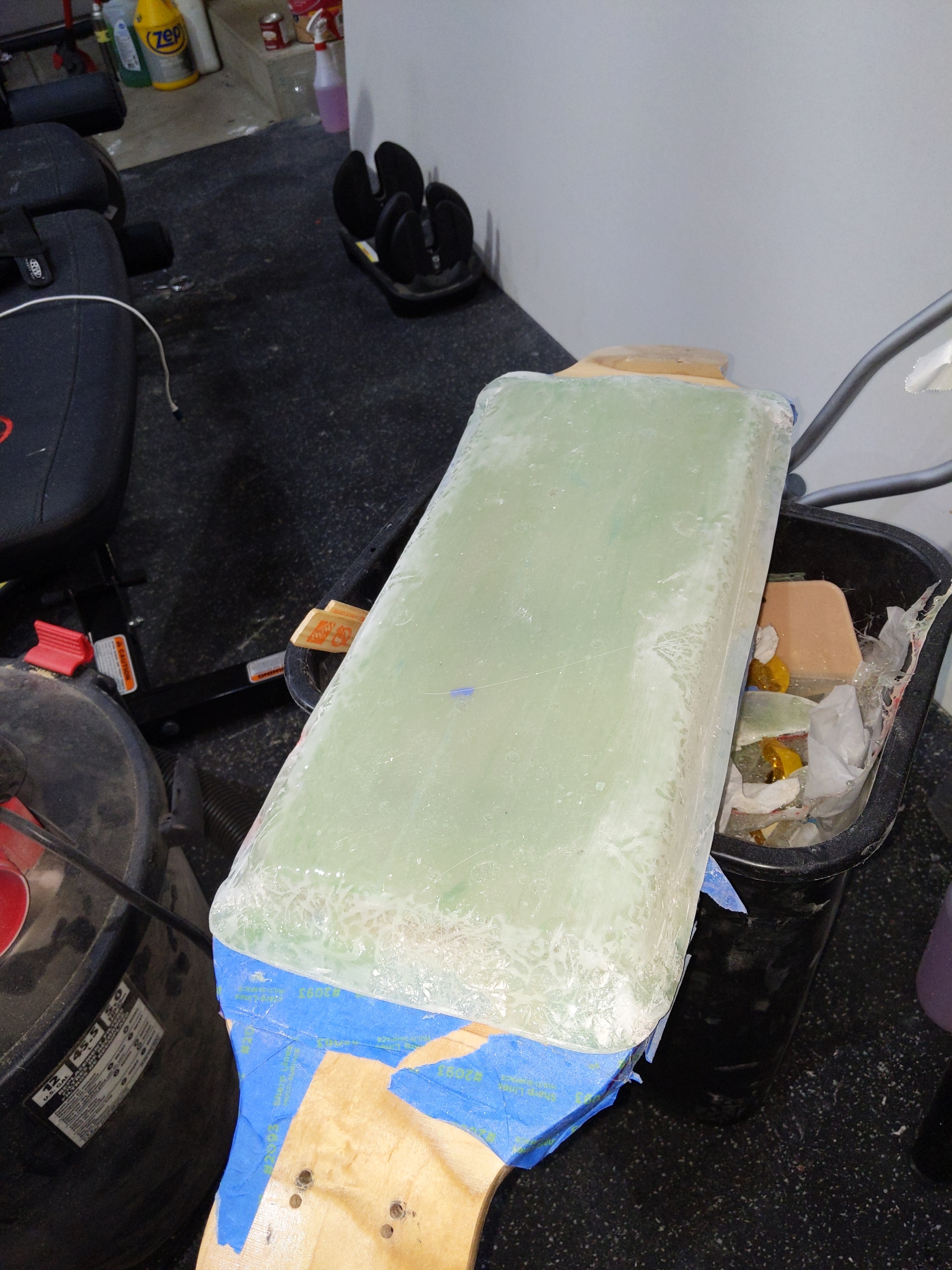

IDK bout this but we’re goin for it…
The rough shape is there…Its butt ugly but I’m gonna go with it! Lotta fuckin sanding goin on…
Progress…
