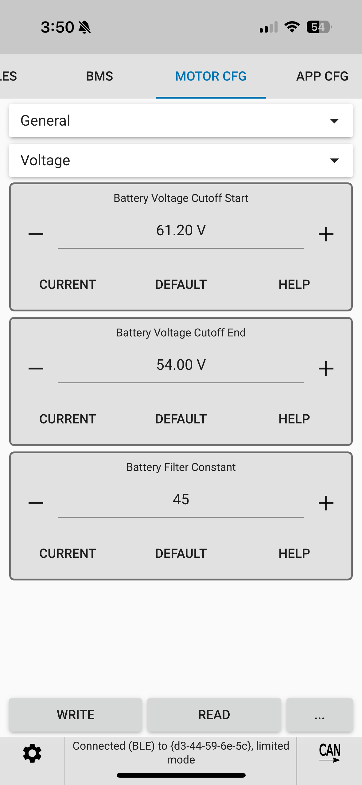

So what could have possibly happened? Here’s the low voltage cutoff settings on the x12. (I connected the Vesc to a power supply to check settings)

The low voltage cutoffs are for running the motor, your battery was drained by the ESC idling on. Since the esc doesn’t have an auto shutoff (see latching switch) it’ll just kill your pack. It’s like leaving your engine on and running out of gas.

Really? I has always assumed that the low voltage cutoff would also turn off the Vesc. Is there a separate setting for that, or is it not possible?
That doesn’t exist in vesc land. There are escs that utilize software hibernation (vesc auto shutoff) that’ll turn off after a defined time of inactivity. Those arent really susceptible to this kind of failure.

and as others mentioend vesc low voltage cutoff is about preventing the motor from drawing current. it doesn’t stop the idling electronics. which shouldn’t be that much of a draw, but some vescs have been called into question in the past as having a higher draw.
