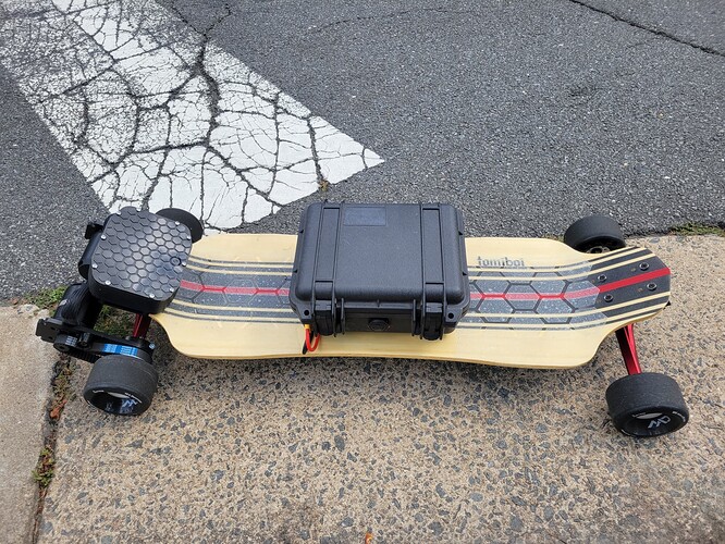

For some reason I’ve always liked the idea of putting urethane on a Mountainboard Deck. I think it’s partly aesthetics, and also the wider wheelbase when using RKP trucks (in comparison to a deck without angled tabs).
My build
Deck: Tomiboi 35in MTB deck
Trucks: Boardnamics 270 with adjustable baseplates
Motor mounts: Boardnamics xl with idlers
Motors: BKB 6384 190
Battery: 12s8p P42a, top mounted for ground clearance (also top mounted so I can easily swap this battery for my other MTB pneumatic build) #twoboardsonebattery
ESC: BKB Xenith, 3DS unibox
Anyway, I thought it would be cool to start a thread to see everyone else’s MTB build with urethane.
Let’s see em
