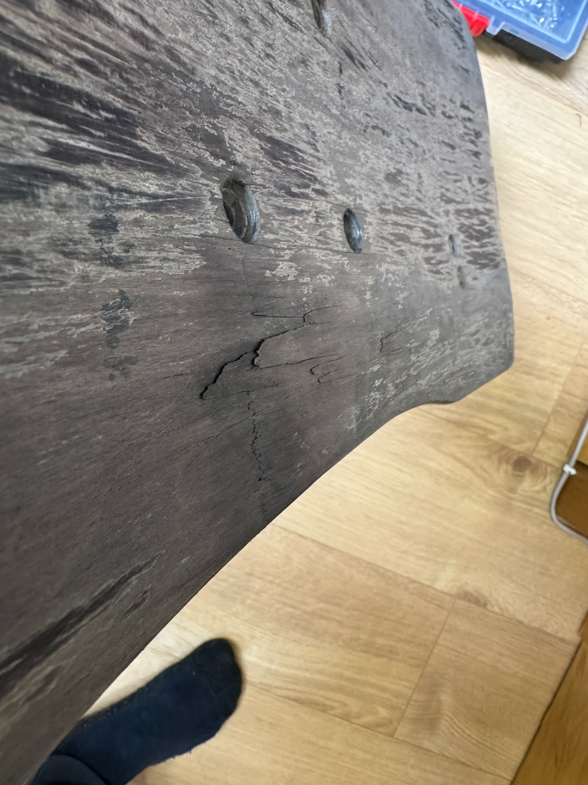

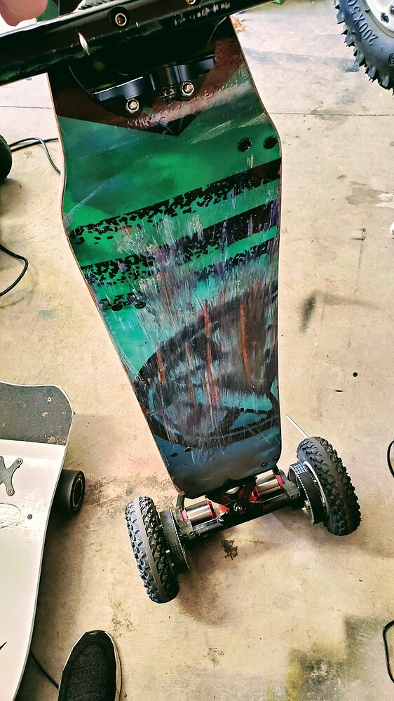

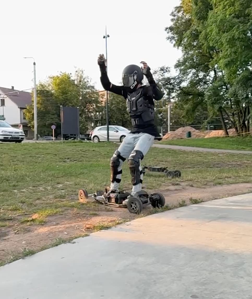

I’m looking for some advice regarding mountainboard deck choice. Some time ago I got into jumping and have been pushing the heights since then not planning to stop until I get stopped. My problem is I often bottom out my decks during jumps and am scared that with time it will damage the board, the battery in the box or even get caught on something when landing.
For context I weight about 70kg. Here are some videos and images of what the landing looks like:

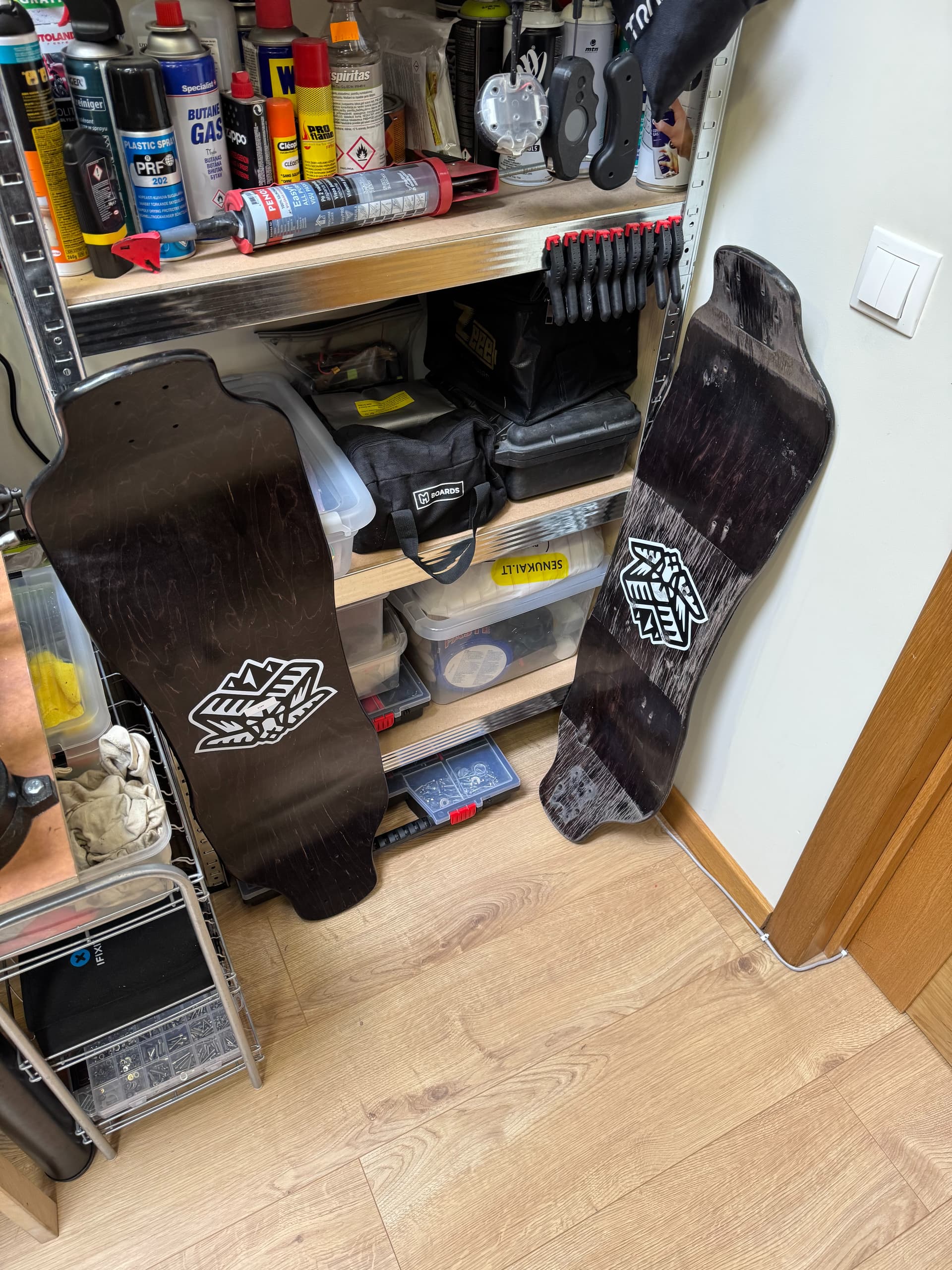

At first my 16ply 9/69 Trampa deck was fine, however at some point it started bottoming out.
I switched to Regular version of RammVoards MTB R1 (@Adstars), however I don’t like that it includes wood since I scrape it, ride in wet conditions and in general don’t trust to stay wood in one piece.

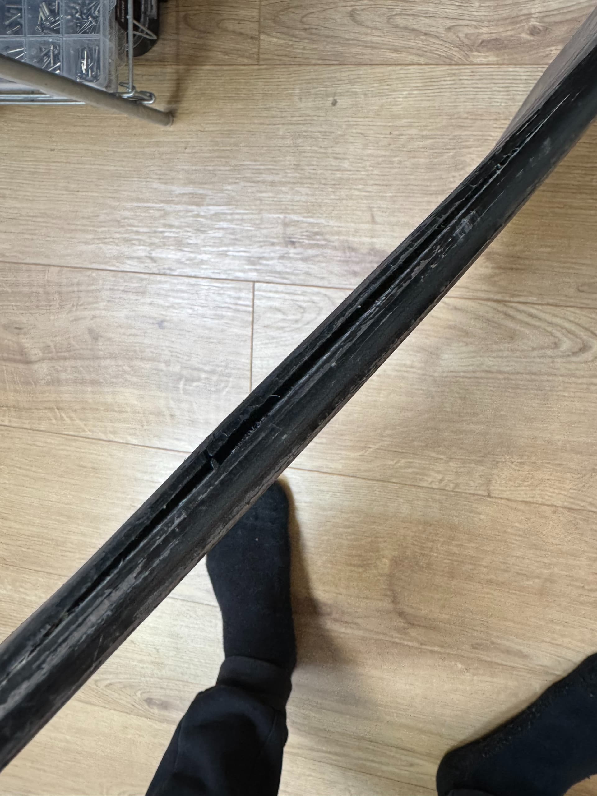

Some results from abuse:
I am looking for a deck that could handle jumps these can’t and also handle the future increases in jump height. As mentioned above preferably not including wood. I also like a bit of flex for that springy preload before jumps and for absorbing some energy when landing. But I understand I probably can’t have the best of both worlds.

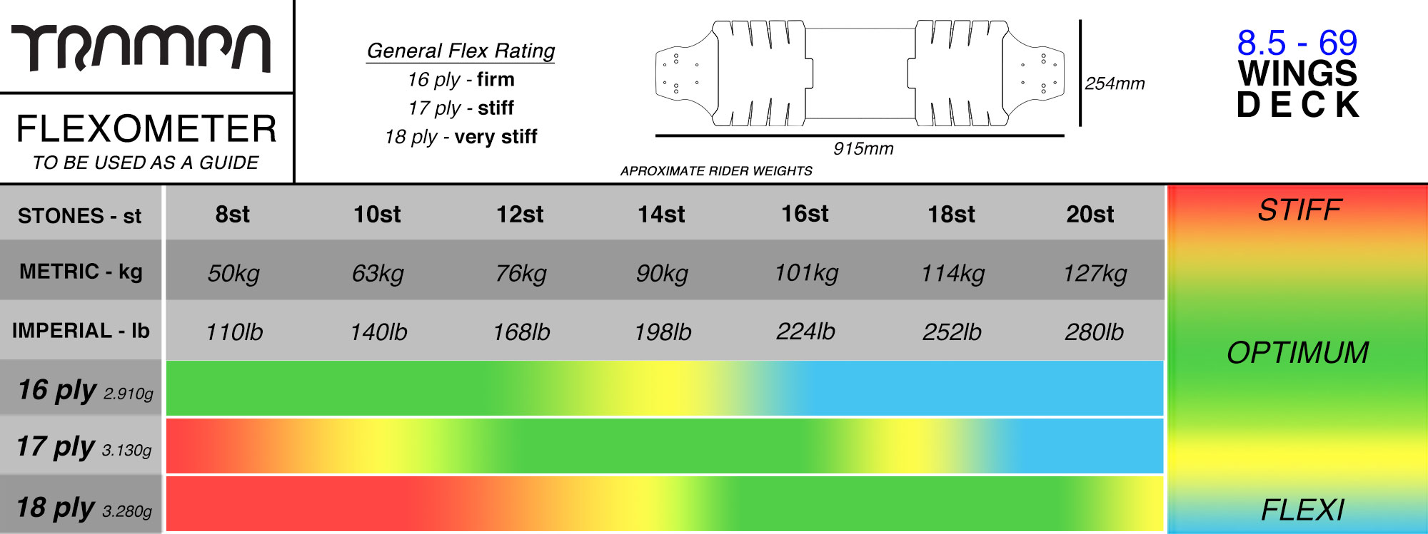

My eyes right now are on TRAMPA 35° 9/69 but in 18ply variant, since I like how my original deck held up. It seems to be of good price and the stiffest option available, however it’s hard to tell how the stiffness will feel and would it be good for my needs without trying it.

Weighing in between 190 and 205lbs before gear depending on how life is going. I don’t get as much air as you do since our old jumping spot is now covered in HOA dominated overpriced shitty housing, but I would always bottom out my Trampa deck too. Second for the Bro deck. My buddy weighs more than I do and jumps higher too. For me, the MBS Pro DWIII is perfect. Slightly longer than the bro which I like being on the taller side and it’s a little stiffer and shorter than my Trampa board so better break over angle and less likely to bottom out when landing a jump on flat surfaces like a caveman. Just don’t order the switch version because they’re almost out and I needs that deck.
Bro deck is the popular option. The new MBS agent deck looks pretty good too. My reccomendation is @tomiboi if you want a more custom option.

I’m on regular and it has a good amount of pop for me without bottoming out on drops. I’m 165lbs for reference
