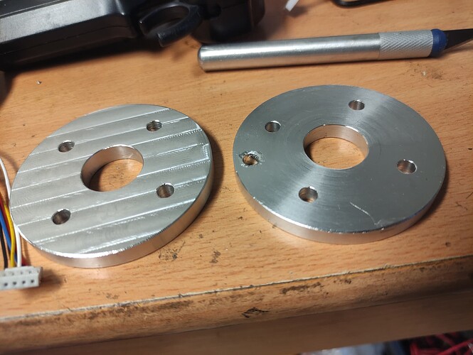

Got the Motors they are huge upgrades compared to my older Fatjay 6368. I noticed more torque and braking power.
The only downside is they are having too long shafts, I didn’t want to cut them off, so made 2 aluminum distance Pieces.

Having longer motor screws for this can cause some issues with durability. See if you can get some that are only partially threaded.
Or pop a bearing in that hole
