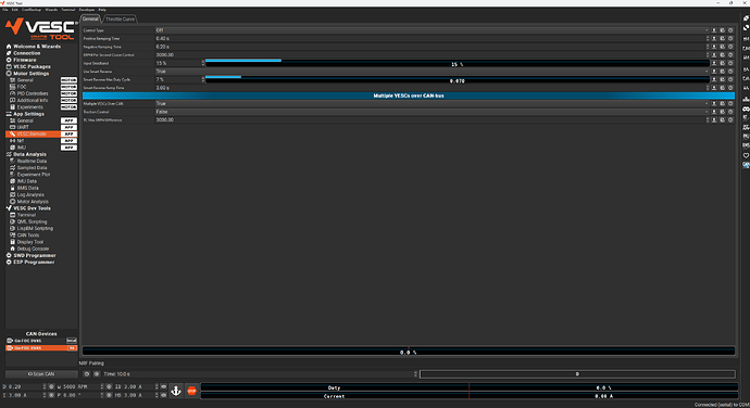

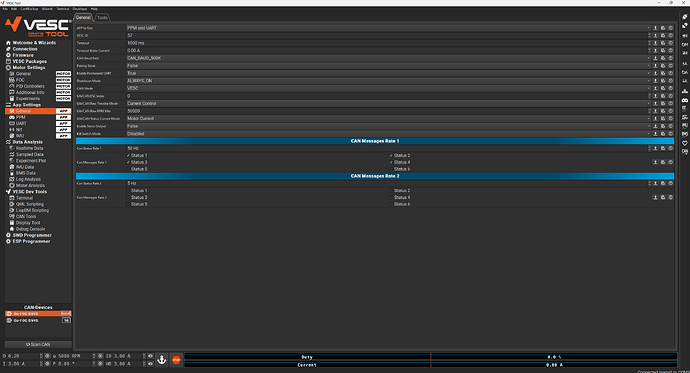

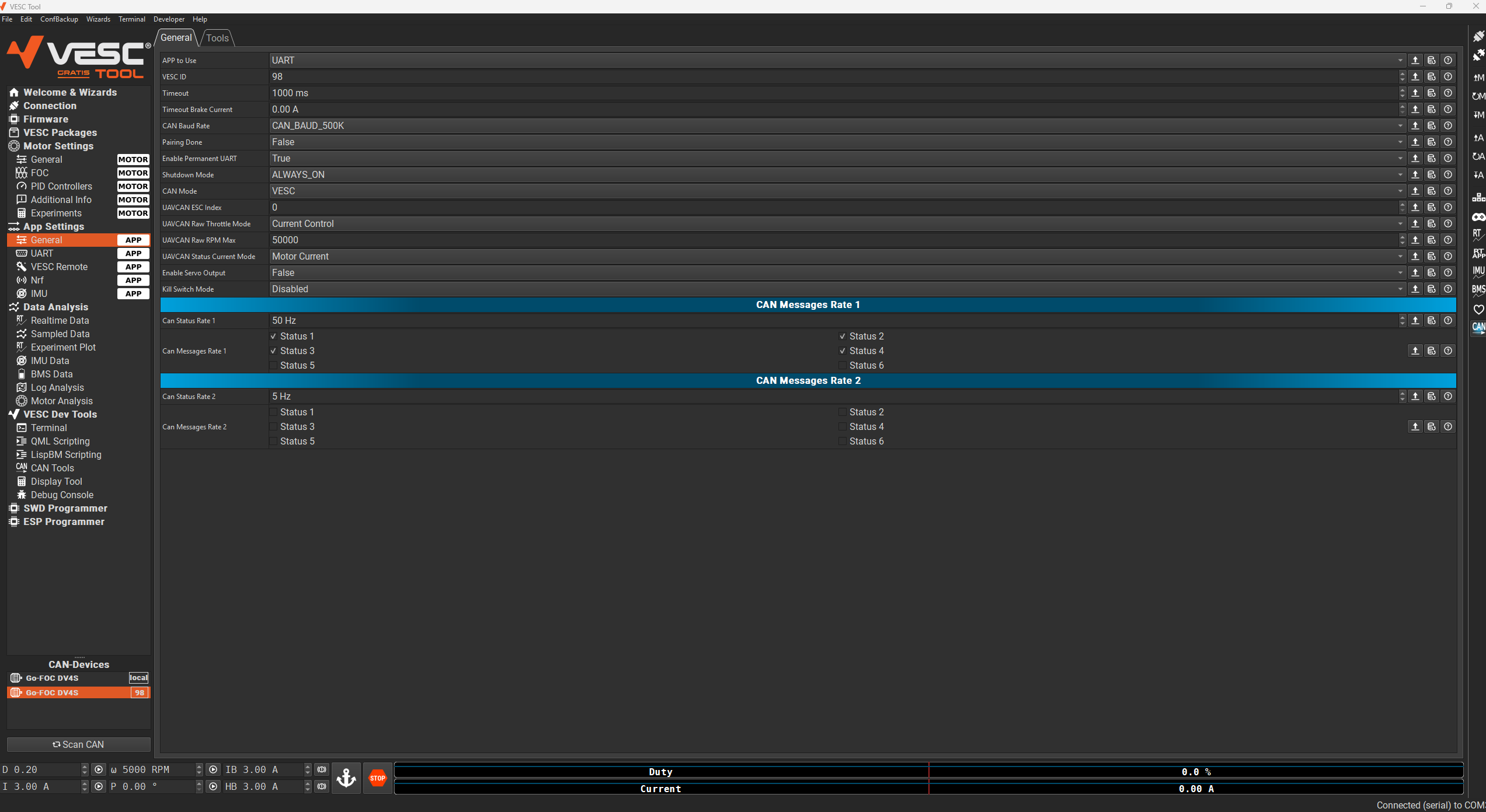

Anyone know what setting can be causing the motors to quickly go in reverse after hitting the brakes on the remote? Im using “Current hyst reverse with brake” for my PPM remote (flipsky vx1 pro) and idk why it’s doing this. Ill provide app settings for master and slave in replies. ESC is the Gofoc dv4s and motors are torqueboard 6355

I see its uart in the settings. Maybe try turning on traction control and set the control type.
it supports both PPM and UART depending on your needs. This was the setting ive used last summer as well with no prior issues

found my old vesc app and its settings from last summer. seems to be linked to the “positive ramping time” old ramping time was set to 0.6 compared to current being 0.4 seconds. Changed it and it now seems to stop throwing it in reverse. Not sure why that was causing the issue
