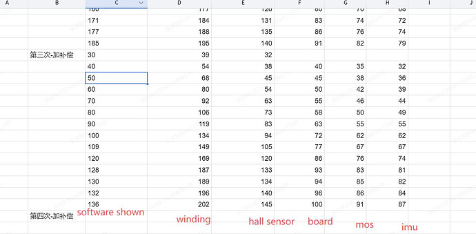

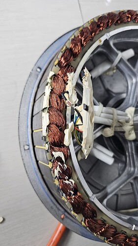

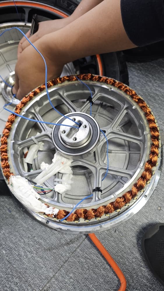

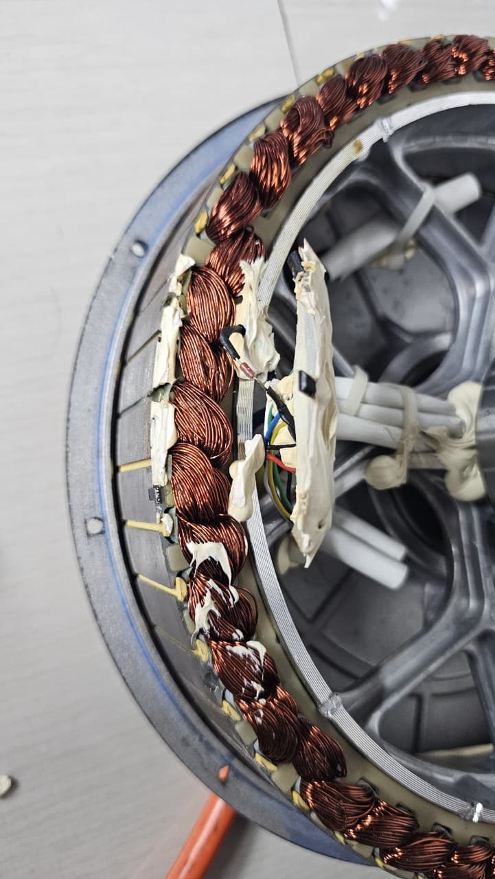

When Mark returned to China, we wanted to validate the temperature readings once more - after the changes were made and we found a couple findings:
The Temperature sensor mounted in the motor - was mounted directly on the copper windings. (This is the heat source, and therefore it would be the first thing to heat up)
As we were worried about the three items: Hall Sensor, Magnets, and Winding Insulation, we focused on 2 things:
  1. Validating the readings of the thermistor to ensure that the readings are true to temp.
  2. Run additional sensors at the Hall Sensor location and Magnets in order to validate the temperature differential due to material (plastic) insulation and air gap (to the magnets)
Our Findings:
- Winding temperature reaching 150deg C easily, however the Hall Sensor location was only reaching 100deg C, and magnets were only 60deg C.
Therefore, we ran the temperature test on the motor dyno in order to validate the temperatures at each region - as well as the temperatures on the control board, mosfets, and IMU to ensure that there are also no temperature issues on the control board. We ran the overheat test on the motor/control board until we eventually broke the motor.
Results:
- We have now validated and calibrated the temperature sensor readings, and have updated the sensor fusion in order to properly calculate the motor temps at the critical areas.
- As per the tests, a rider should be able to sustain 60-70mph for approximately 35-45 mins continuous before the P6 will tiltback to prevent any potential for damage or injury.

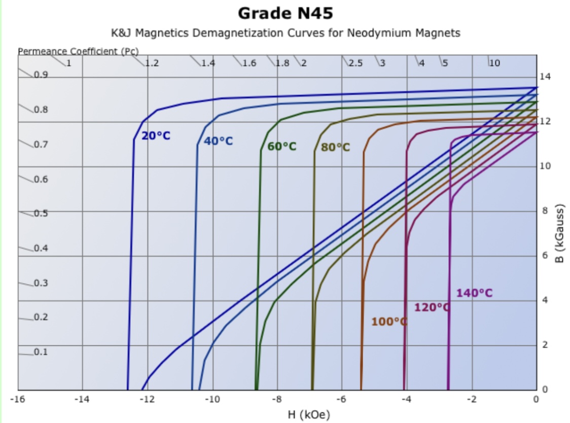

It would be impossible to melt the copper windings. Even at the highest kv windings are not the fail point. It is the magnets.
Keeping the magnets cool is essential to motor performance. At 80°c magnetic resistance can be 50% less than at 20°c. Which means you need more amps to get the motor to spin with half of the power. Thats why we have that limit. Also demagnetization is a factor, over time and use.

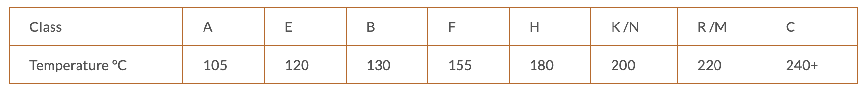

I have a 6384 flipsky on hand that begs to differ, with melted enamel. You don’t melt the copper, just the enamel coating melts and the copper shorts.
agree. it’s the enamel to be concerned with.
sample winding classes: (safe operating temps for the enamel )
which means they can be made pretty high.
Ah ok i misread that. Copper melts at +1000° So the copper wouldnt melt but that enamel, insulation and the sensor components could.
