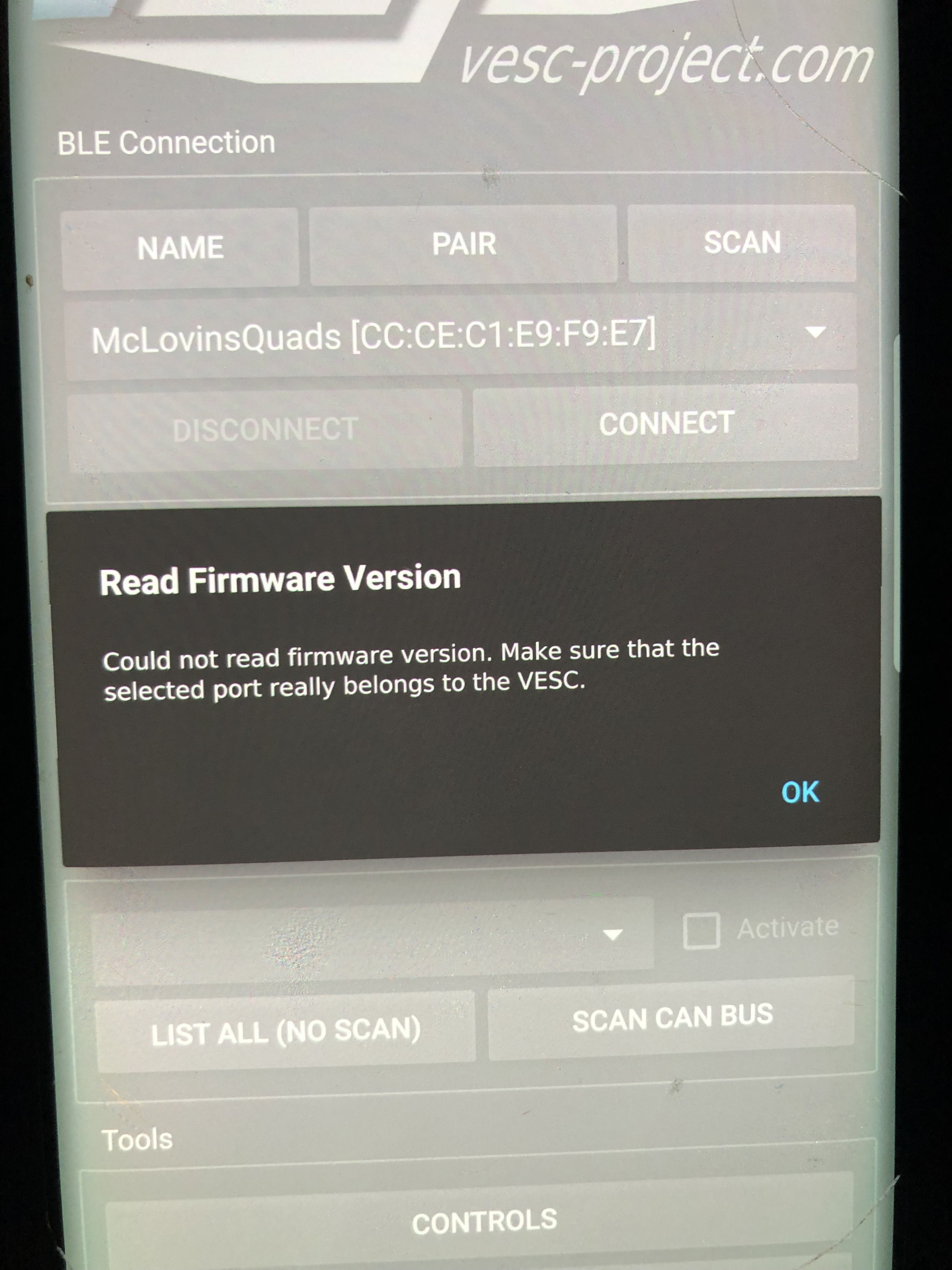

I was riding my eMTB trampa last night, having a blast and as I was slowing down my board sounded like something rubbing the tire. Looked it over while buddy was swapping his battery and thought all is good. Took off again and it was very noticeable, lifted the rear wheels and only one was moving. So I unplugged and gave it a couple mins and tried again with same results, so I swapped the rx wire to esc 1 and hooked up to the vesc mobile tool and got it working with just one motor. When I got back to my hotel I let everything cool down for a little while and then tore into it, didn’t see any loose or cut wires on the vesc side or on the motors (haven’t pulled them to confirm inside of the motors yet. I tried hooking to the mobile tool to update both vescs. Now I get a message saying make sure it’s the com port that belongs to the vesc. The lights flash blue and red for a sec or two, then solid blue. I don’t have my laptop with me to try and hook up via non mobile. Any advice?

Update! I have both motors spinning and I took a test ride around the hotel, seems to be working fine but no reverse, it tries to but something isn’t right. I ended up swapping my dongle to the opposite vesc and was able to connect to the app, did the fw flash, and set my old settings in. I think ima flash back to completely factory and just not worry about reverse. Then I’ll go out later and try to ride the batteries down
