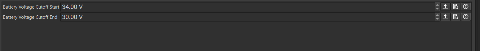

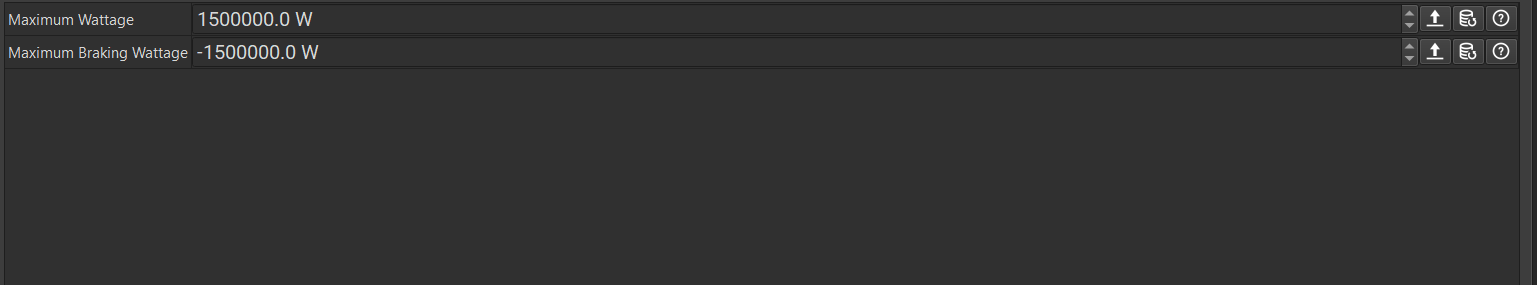

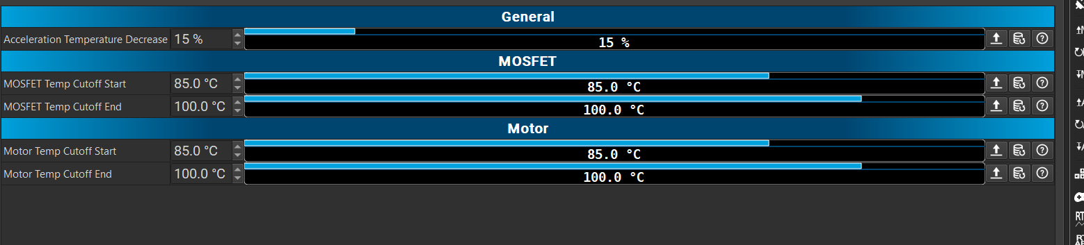

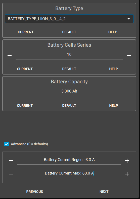

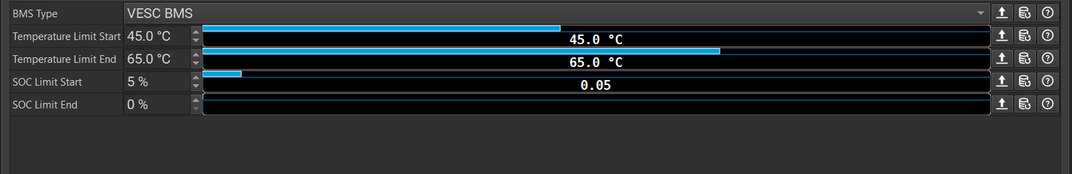

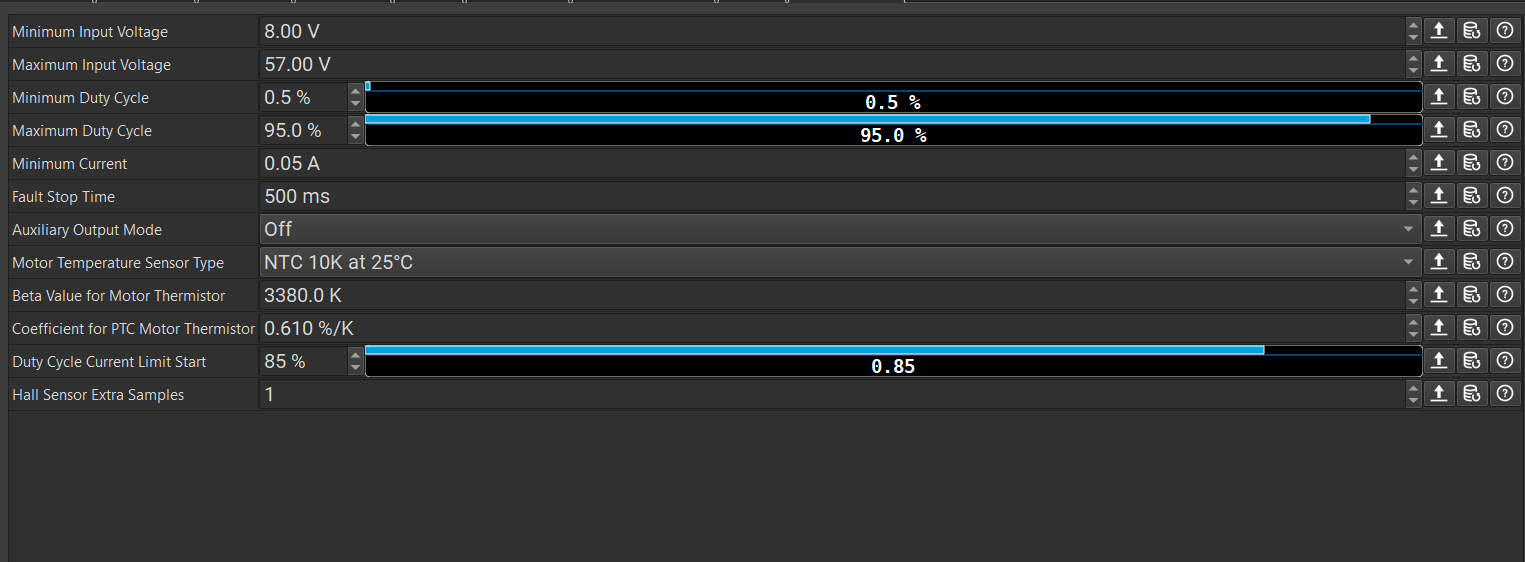

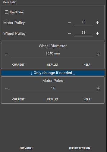

I’m pretty sure my settings are fine, but the settings I am using are
Battery Cells series: 10
Battery Capacity 3.3 Ah
Drivetrain setup: 80 mm wheels 15 teeth motor pully, 38 teeth wheel pulley.

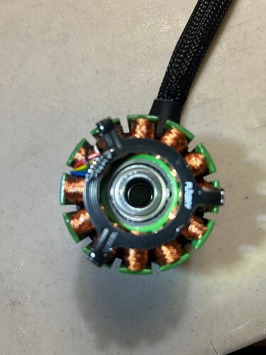

Also when I turn the motor by hand it does seem that there is some rubbing within the motor when it turns and I don’t know if that is normal or not. Furthermore when I connect use the remote to try and turn the motor the way the green light lights up does seem to correspond to the input from the controller so it seems like that’s working. Finally I went in with a multimeter and measure the resistance of each motor ends and I got .3 ohms and from what I’ve seen online that’s a high value
maybe bad soldered connection if the motors are new they should not rub… does it make a sound when it rubs or is it just physical resistance… pictures of gear and all your settings will really help

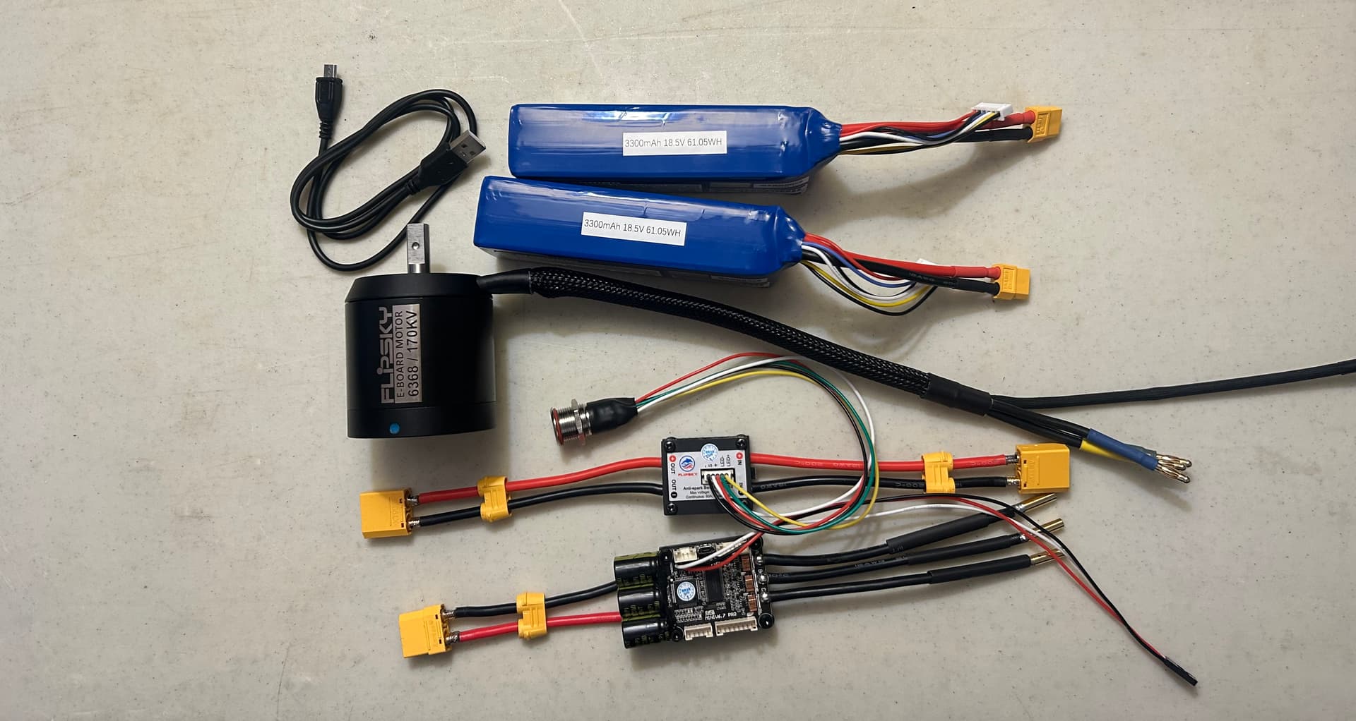

Its just physical resistance, honestly I described it as rubbing only because I didn’t know how else to describe it. Also here are some pictures of my components and settings.

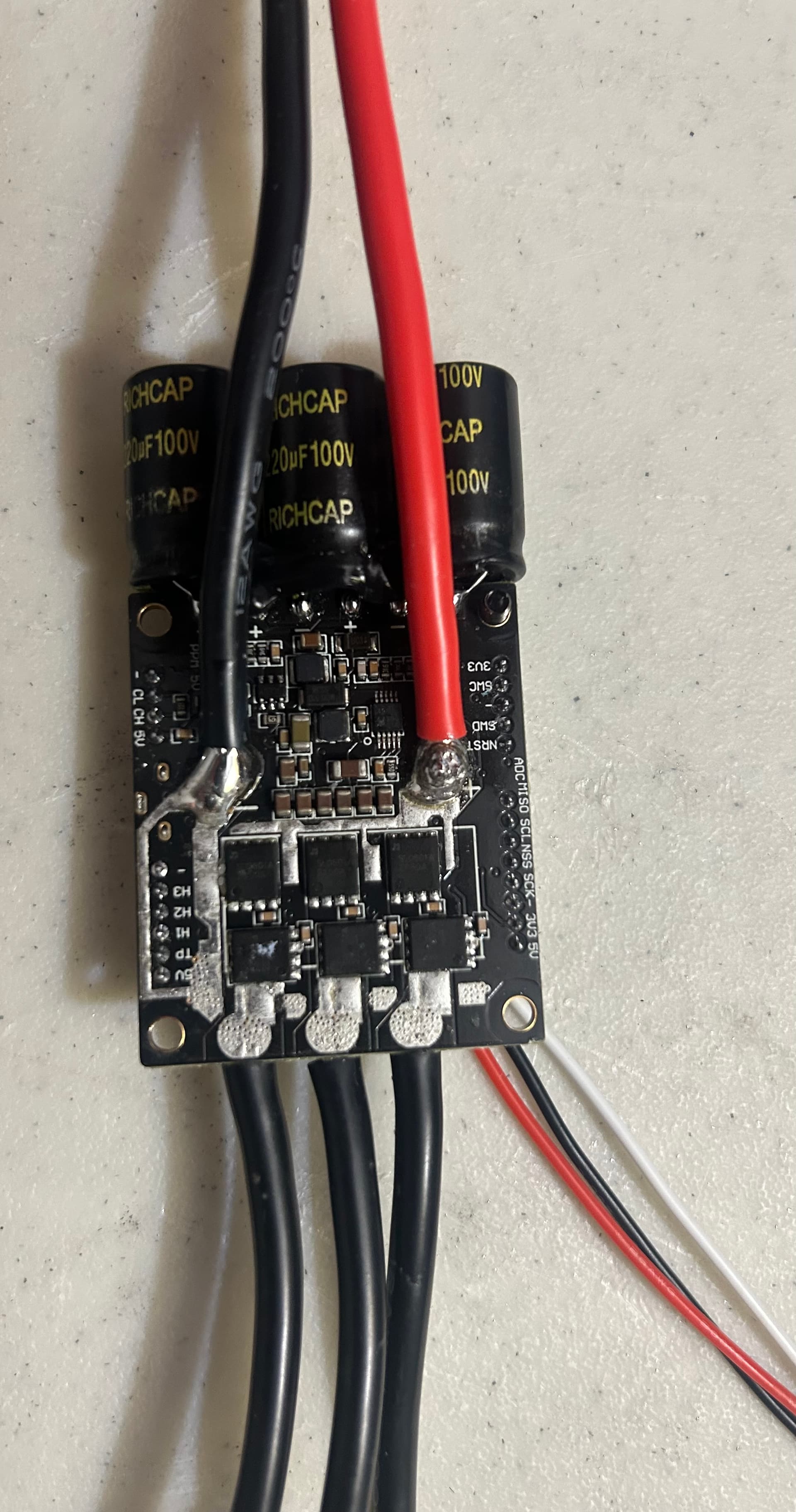

btw the solder point on the + side of the esc looks a little weird because I had already soldered a wire into it for the Bluetooth module but I took it out once I encountered this problem.

All components
Settings

could you redo/resolder this side

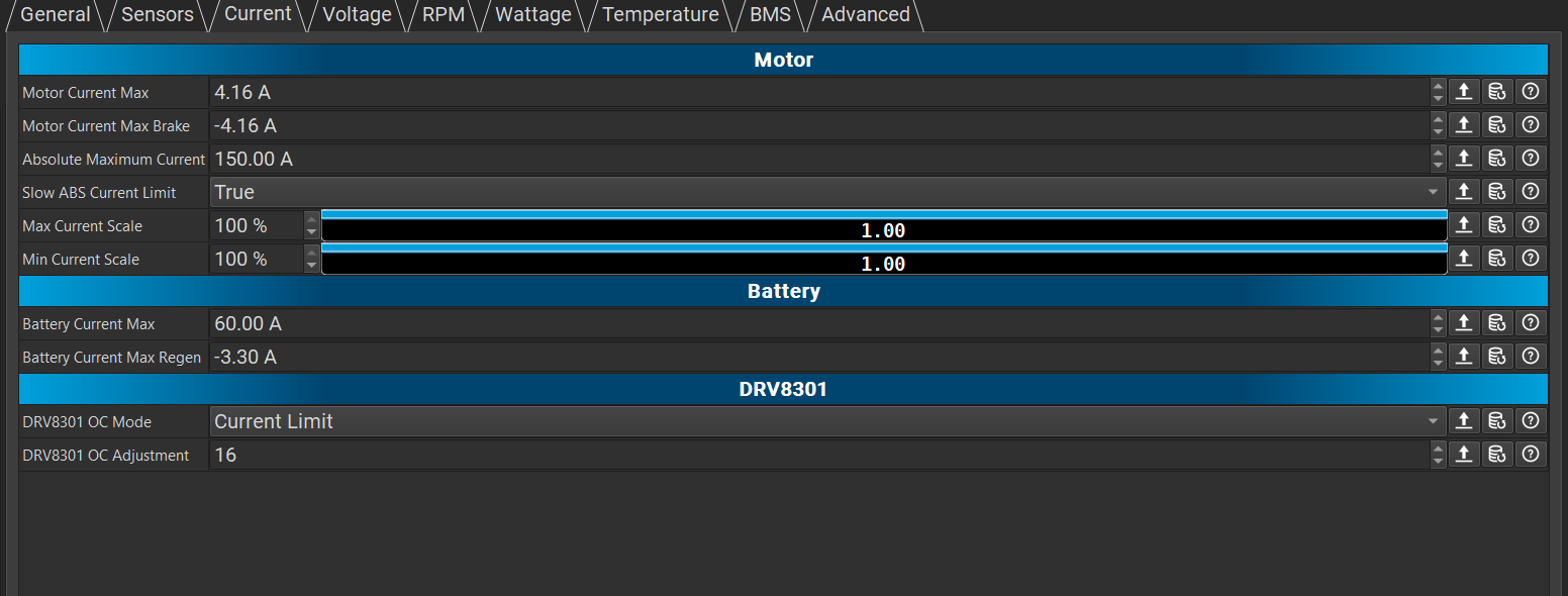

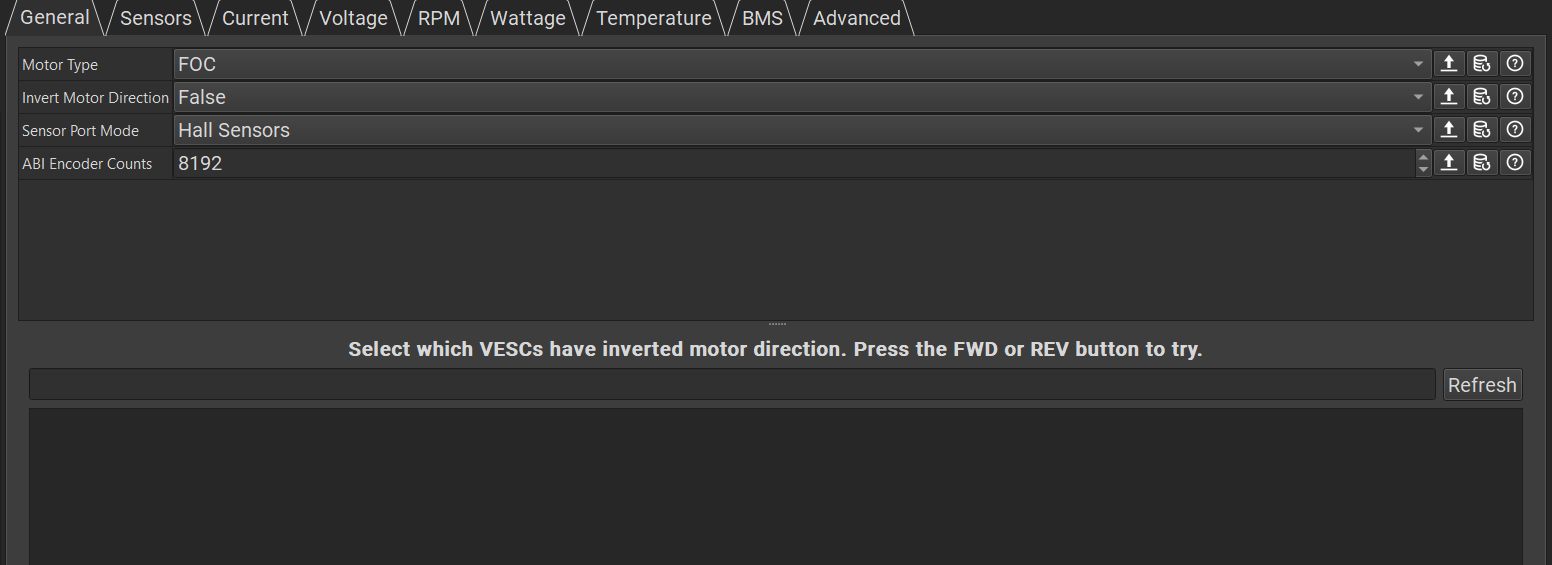

there looks like their may be some setting issues also
Yeah I definitely could resolder that side and I was going to replace and resolder the bullet connectors anyway just to rule that out. Do you know what the setting issues are and how I can fix them?
I would check settings when setting up the motor.
Make sure you’re choosing the right size/weight motor as the defaults will be based off that.
I would also check your sensor wires to make sure they are okay and not kinked or anything.
And I second @trancejunkie on the + terminal but I also would check the -
If anyone has a reference photo of the back that would be awesome, my brain is thinking there’s a lot of extra solder around the pad, around the bottom of the Jst and i’m just not sure if that’s right, but I haven’t used one of these exact vescs before.

I’ve been trying to find a reference photo for the back of the vesc online too cause some of it did look weird to me too but I can’t find any. However on the front of the vesc there looks like there is some extra solder right above the word mini that isn’t on any of the reference photos of the front that I’ve seen but idk if that’s affecting things

Try upping the detection current. I usually use like 30 amps, 4 might just not be enough for that size motor?
Although most of my experience is with vesc6, not vesc4

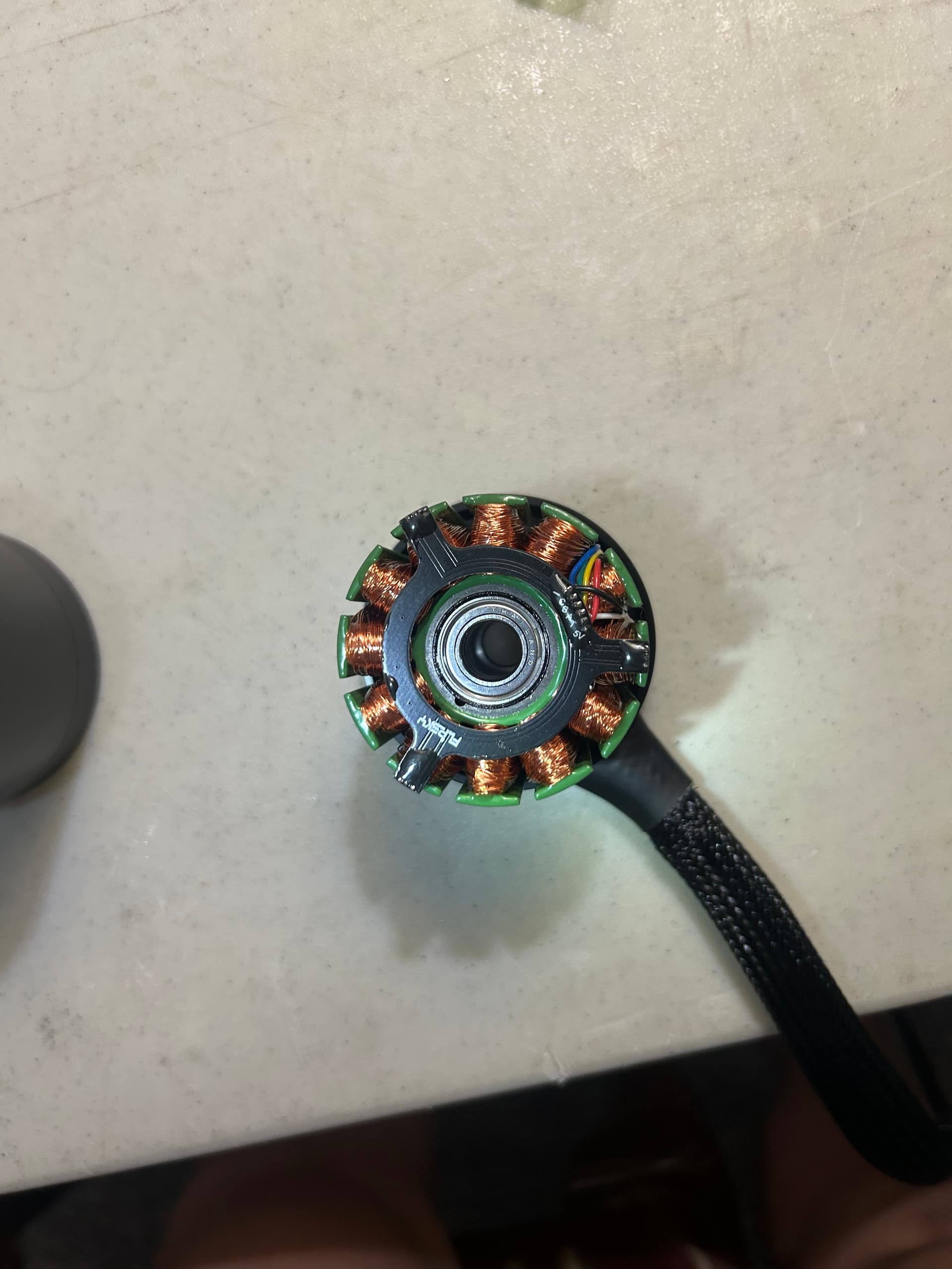

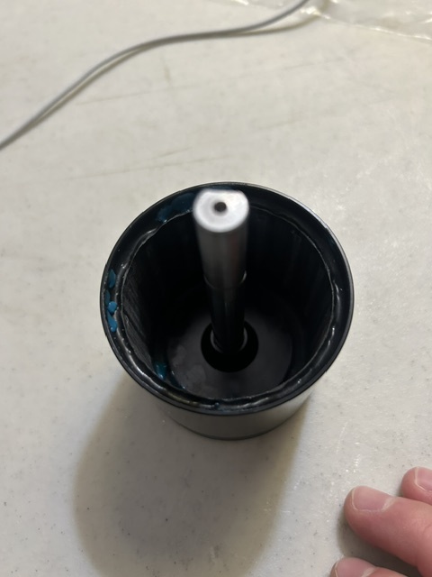

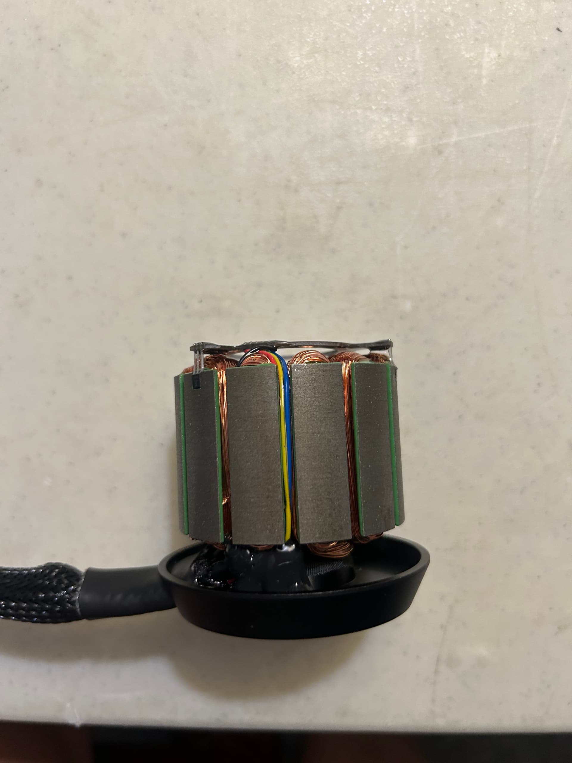

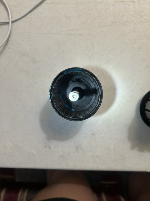

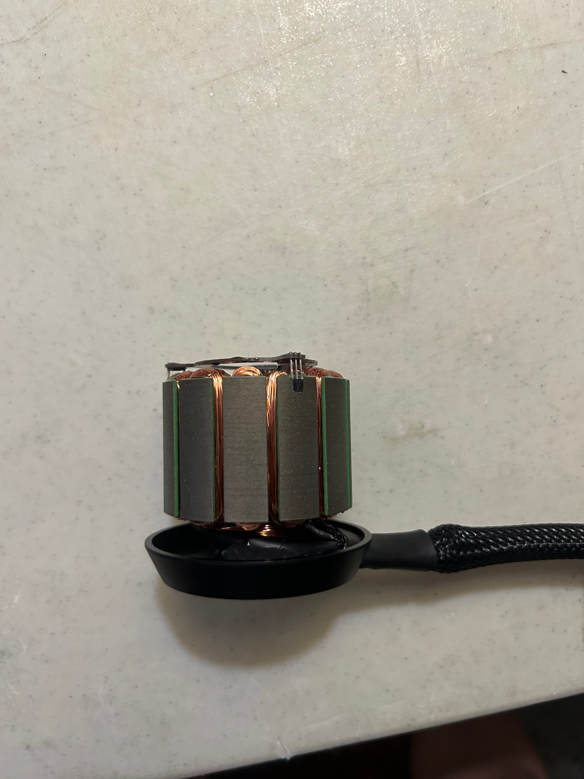

I took the motor apart and nothing looked off so I’m guessing the resistance is just due to the magnets but here are pictures of the inside and a video of it spinning by hand. So now I’m assuming the problem is within the vesc.
https://youtube.com/shorts/cZKPgmbthhA?feature=share
ya the poles will do that. u can use the corner of a rag to prevent crash when u put it back together dont let it pinch ya :smiley:
