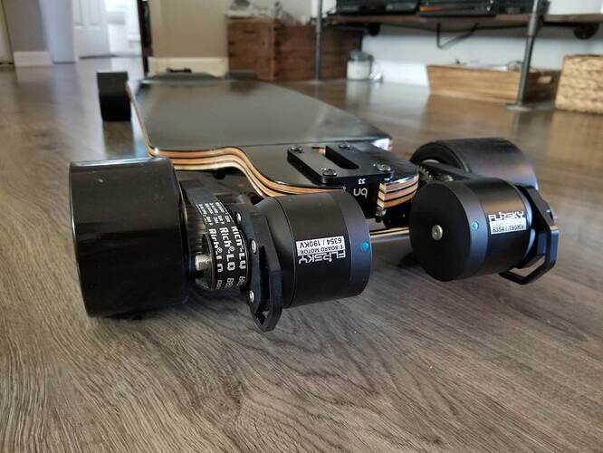

Here’s a photo of that kind of DIY solution:
0091ef6f63a2b8ecaaff01dfb7795b3fc308fd3e_2_666x500
Another option is to use a very short motor mount — but this version does not allow for a crossbar.
Here’s a photo of such a mount I previously made for 50xx motors.
The same type is currently available in the shop for 63xx motors.

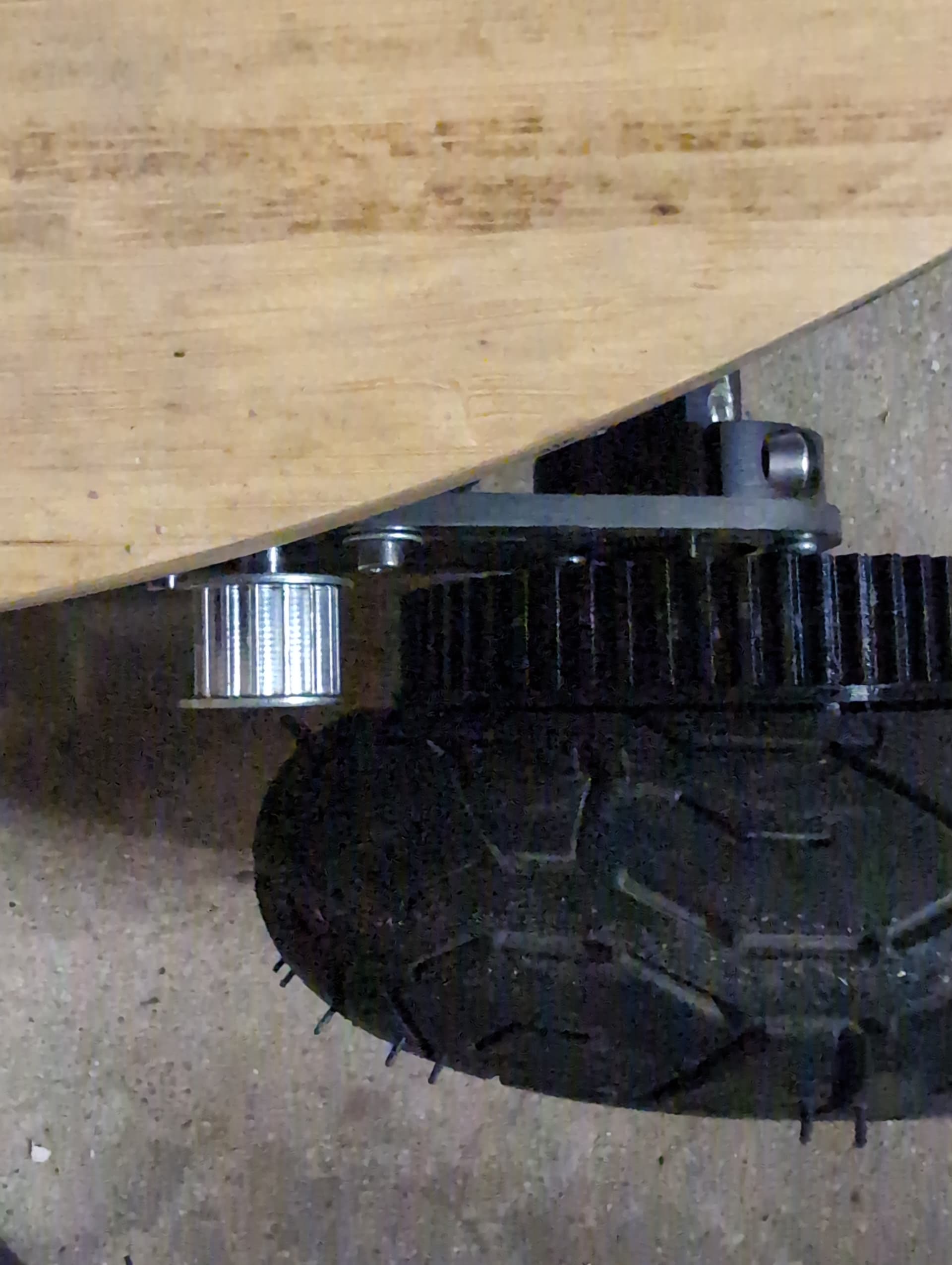

Personally I don’t enjoy the look of motors sticking out the back very much so I need to find a solution to be mounted forward facing under the deck.
Crossbar is a nice feature but currently I am not sure if I even want to go for a dual setup.
The short ones thus are probably the best option mounting wise but they don’t offer the possibility of using an idler - or do they? Issue with a short mount is also that with a 60T pulley there is almost no space for the idler to sit.
Right now I have roughly 72mm center to center distance but that means the motor pulley is almost sitting right next to the wheel pulley
Just had a look at your images again and how do you keep the belt from slipping at the single drive without an idler? That is the biggest problem on my current setup when braking

I use idlers to prevent belt slippage, but in that case you need to choose a mount with idlers and install the motors rear-facing.
