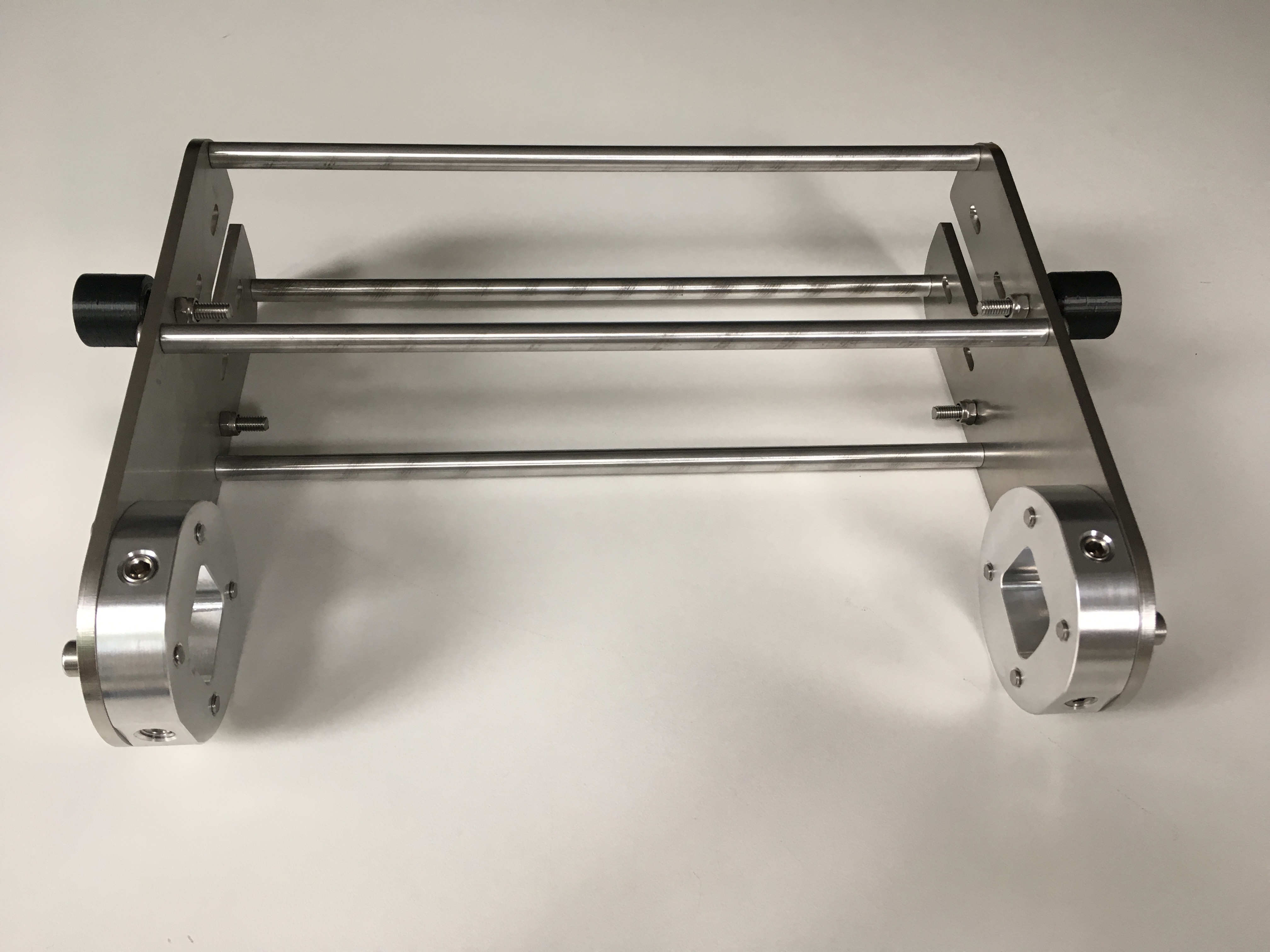

I’m an engineer from Germany and I developed a dual motor mount for Trampa spring trucks. Looks like this:
- truck adapter ring and rods from 7075 aluminium
- motor plate from stainless steel
- fits 63 motors up to 10mm shaft
- adjustable mounting angle
- dual idlers for high gearing reduction

But latest prototype looks like this:
Changes from there to the final version:
- length of the motor plate reduced by 10mm
- motor plate a bit thinner
Some more pictures of the mount:

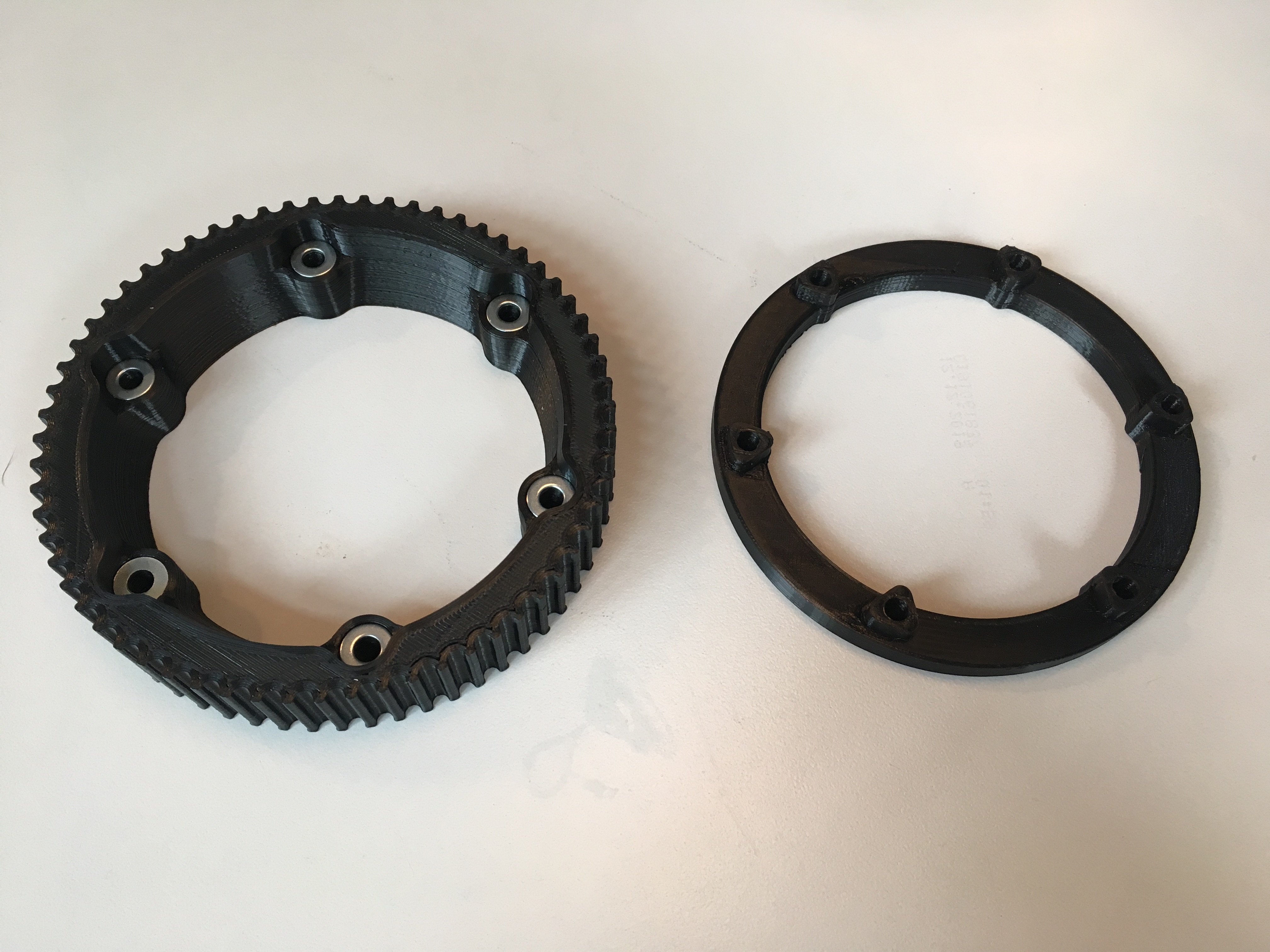

Also I designed some pulleys for the Hypa wheel. Looks like this:
Details:
- variable size (everything from 64T up is possible.
- 60mm M4 screws to use with the original nuts
- meant for 15mm belts but wider wouldn’t be a problem
- printed with PLA+
The files for the pulleys will be available on thingiverse soon. If you need someone to print, I can to that for you

              The plates on your mounts look very thin what’s there thickness?
              The thickness is 4mm. I tried 5mm but this is overkill, too heavy. Many people use these cutouts after the adapter ring to save weight. But for bending this is the weakest point, so you want to have as much material as possible. These cutouts are not the smartest move imo. If you use one solid part you need it to be thicker because of the the mounting at the truck and the grub screws. Trust me this part is rock solid! (There are even commonly used mounts with thinner plates)
