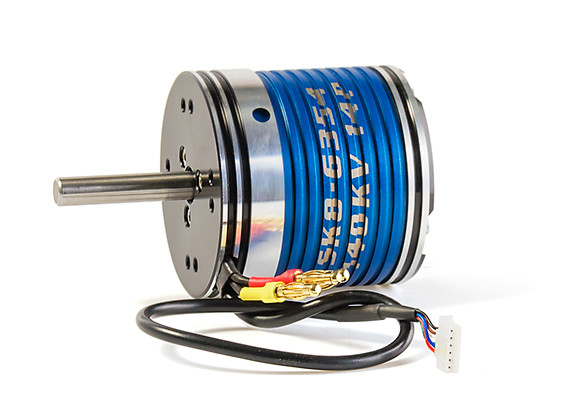

There is also 6354 size in 140kv which is actually perfect for my needs (to get around 30kmh and good torque).
So these are gooooood? Considering shipping those are almost half price than the Maytech, given the quote I got from them to send to Spain so… not sure if the Maytech worth the extra cost… :slight_smile:
Maytech are also sealed, Turnigy aren’t… it would be nice to have sealed motors since they are intended to be used on an AT board that will get dirty and won’t be running always on dry paths…

Actually I bought 2 SK8 for the price of 1 Maytech…I am happy with them so far…If you want more responsive torque from them, just lower positive ramping to 0,1 sec and go to throttle mapping and put 20% to increase torque at the beginning of the acceleration…Do not play with the breaks on the mapping…Remember to start slow, get used to the settings first…Always use helmet…

To see what motor is best other than just someone’s experience with durability run the motors on the vesc tool and get the true kv and the electrical resistance which reveals what motor is better in that it will stay cooler. The only other variable being the iron losses which can be compared running at top same speed comparing the current draw. If ur not comparing these things might as well base what’s best on your favorite color.

The TB6380 is a very good motor.
You might want to go Sk3 then. Our resident drinker of backyard sink wine beats them hard and puts them away wet and they hold up really well.

If you ride sensors then sk3 are not for you but are pretty much indestructible at some high amps. If @b264 says the tb6380 are a good sensored option then they are because he hammers his stuff in all weathers. For the same reason if @mmaner recommends the maytech then they are a good choice too. Literally put it down to size/kv/availability and price and pull the trigger.
