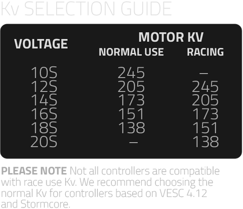

I always followed the radium suggestions
Kv-SelectionGuide_480x480
Which has worked well for me so far but now we have guys like @zero_ads pushing a tonne of amps @21s through 205kv making a whole bunch of power at seemingly stable motor temps.

That table from radium is just a guide. It’s worth noting that Jimmy and Poast run way higher rpm than these motors are rated for. Anything over 12k rpm is generally not recommended.
Generally speaking higher kv motors can handle more amps because they have thicker gauge copper windings. That said, the he high rpm’s these motors reach result in a lot of iron losses. So efficiency tanks as performance increases. It’s not uncommon for Jimmy and Poast to push 40, 50, 60 wh/mile when they are pushing the race boards.
I run 151kv at 21s and generally see 28wh/mile, but I also don’t rip like Jimmy and Poast.
Long way of saying, go high voltage and choose a motor kv that works with your gearing and desired top speed. There’s a lot of flexibility here and you probably won’t be unhappy with whatever you choose from 150kv to 200kv

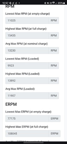

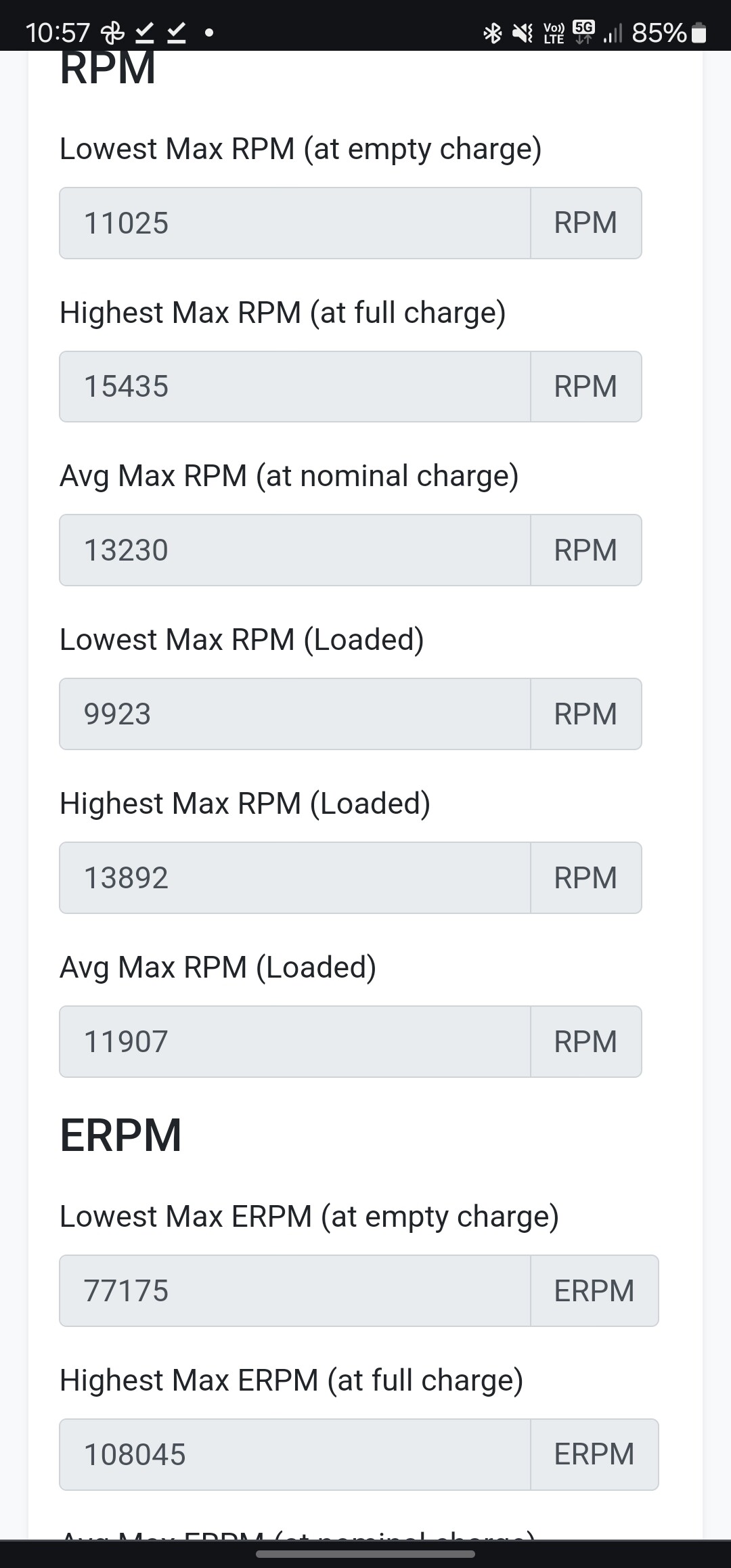

So consensus on these kinda figures
21s-4p 175kv 4wd
Not too bad?

I should need less amps with 175’s id be happy if I could get around 110-120 into them maybe.
Hmm I would assume you’d want more amps on 175 due to loss of torque in the wheel size.
I’m running 110 @16s on the rears at the moment. 14-67 on the brp’s. Would be an extra 2kw at 21s and more gear reduction. I dunno I would have thought it’d go pretty well.
What kv are you running right now 175?
Oh I think I misread this as 175mm wheels in a way to compensate for top end.
I was saying that at 11/12 67 gear ratio you might not have enough top speed. But if you’re just doing short track stuff you should be fine.
