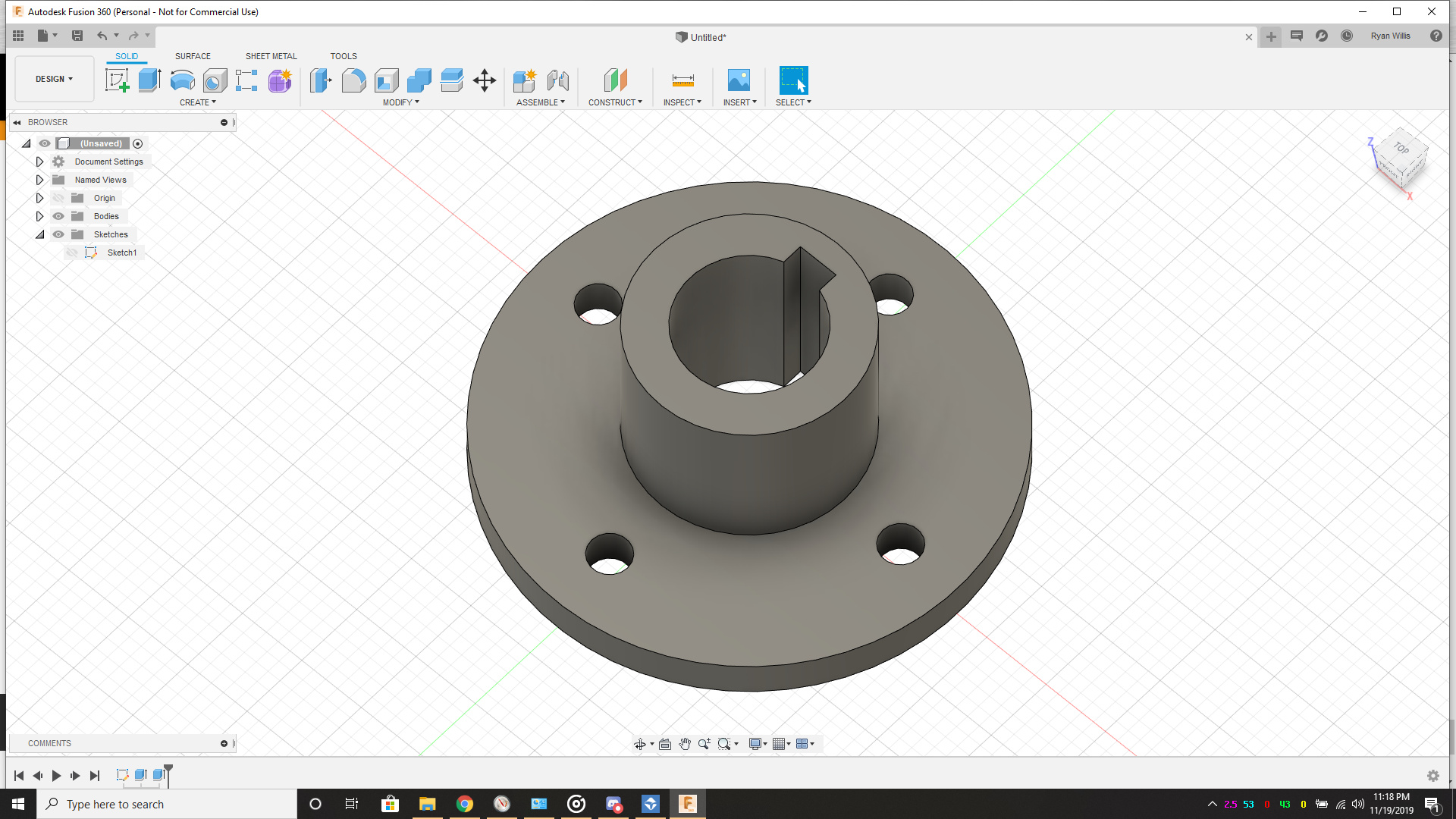

The other thing I can think of is to make the back plate of the can (or at least part of it) out of something stronger than aluminum. A steel piece shaped like this:
tightly press-fit onto the shaft with a key or other rotation-preventing mechanism, and then screwed to the can. That would greatly reduce the tendency for the bore to get wobbled out and loose over time.
The whole design flaw is that of using a small diameter, hardened steel shaft in a shallow, soft aluminum bore. If the bore was deeper than ~1-1.5*the diameter of the shaft, there would be no problem.
If the bore were something with a significantly higher yield strength than 6061(E.G. steel), then there wouldn’t be a problem.
If the shaft were to have a big mushroom end to spread out the pressure, then there wouldn’t be a problem.
