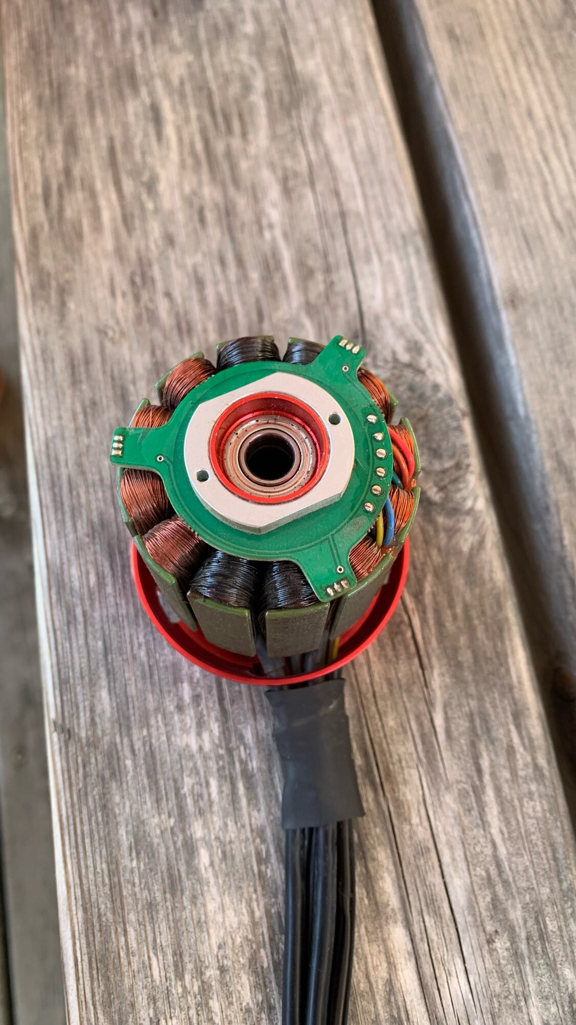

After several rides (125km), the board suddenly wouldn’t start from a standstill on a ride. (metr logs showed no fault and motor temps below 50degrees). The only solution was to switch the board on and off several times. After I did that, the right rear engine stopped working. After further inspections, one of the windings turned out to be burnt. Motor never went above 50degrees.
I assumed this was a manufacturing error. Without any problem I ordered a new one and installed it.
Now after again 100km the right rear motor burned again. I had just left home. After 1km of driving I wanted to leave from a traffic light. 3 motors were spinning but the rear right was on full brake and couldn’t turn. When I felt this I immediately released the throttle but I clearly saw smoke coming from this motor. I checked immediately the meter but each motor was at 40 degrees and I could easy hold the motor, The can was not hot at all. Only the winding itself is burned

I think if enough current is passed to short the motor it would also ruin the esc. I bet it’s just the motors. Maybe u can dissect the winding and see a possible short location against the case
Would do this. Also you can actually rewind the fried winding with fresh copper and check if it maybe happens again. Some copper wire is a lot cheaper the a whole motor. You just need to measure the gauge and count the windings.
That winding is cooked and even if there’s no short within the winding, which it doesn’t look like and seems a whole phase shorted, the insulation is burnt toast n won’t be long till shorts again if even possible to wind with such cooked stuff.
well you would obv. replace the copper, not use it again.
I thought u were saying use it again
Yeah no that would be a bad idea, sorry if I came off wrong. Fixed it now.
Can you locate where the windings started to burn our? Maybe there was a mechanical damage of the windings. Too long mounting screws could cause this for example.
That’s a good point. I’d check the mounting screws too. And the connector and wiring on that side.
I mean, I had a loose connection on one phase wire burn out a coil. So maybe something similar ESC side could be causing that.

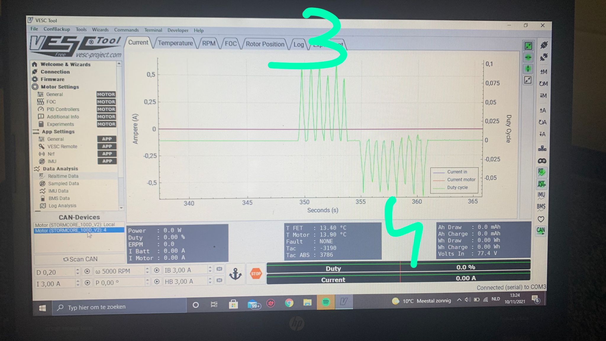

TROUBLESHOOTING DAY
To show the problem I shooted this video (CAN connected):
Front motor is making the crazy high pitch noise.
I checked the realtime data graph, when I turn each wheel the same direction.
Vesc 1 and 2 is the good stormcore
Vesc 3 and 4 is the “bad” stormcore that has already burned out two motors. Motor burn was each time on side 4.
In the graph you can clearly see that side 4 has a negative duty cycle when turning in riding direction.
After doing again motor detection the graph is again how it need to be. And the motors are spinning normal how it need to be and the high pitch noise is gone.
I am looking for suggestions on how to solve this problem.
Both stormcores have already been slave and main. It’s always the same stormcore with these problems.
Firmware has been re-flashed several times.
