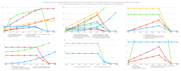

@Chricious-- i ran a simulation for you comparing a 50kv (0.32ohm) direct drive vs a 200kv (0.02ohm) motor with 4:1 gear reduction (same battery voltage, same motor current), both sustaining 25mph on a 10% slope…
^notice:
  • the same size same copper fill 200kv motor has 1/16th the electrical resistance of the 50kv direct drive motor (200kv has 1/4x fewer turns and 4x greater cross section wire than the 50kv)
  • in the bottom left chart, purple line – vehicle thrust is the same for both vehicles
  • in the bottom middle chart, green line – ohmic motor heating drops from about 250w total with the 50kv DD to around 16w with the 200kv 4:1 reduction
  • in the top left chart, green line – electrical to mechanical efficiency is far higher with the 200kv
  • top left chart, blue line – motor current is the same – 20a with both motors
  • top middle chart, yellow line – electrical wattage is far lower with the 200kv motor than the 50kv direct drive motor for the same mechanical wattage output (red line, same chart)
  • top right chart, yellow line – the 200kv motor torque at the same motor current is 1/4th the torque of the 50kv motor, but the 200kv motor is spinning 4 times faster with 4 times the gear reduction, so you get the same mechanical power to the wheels either way
  • bottom right chart, purple line – battery current is less with the 200kv 4:1 reduction than the 50kv direct drive
graphs
