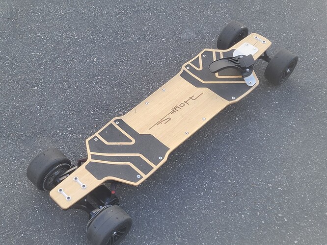

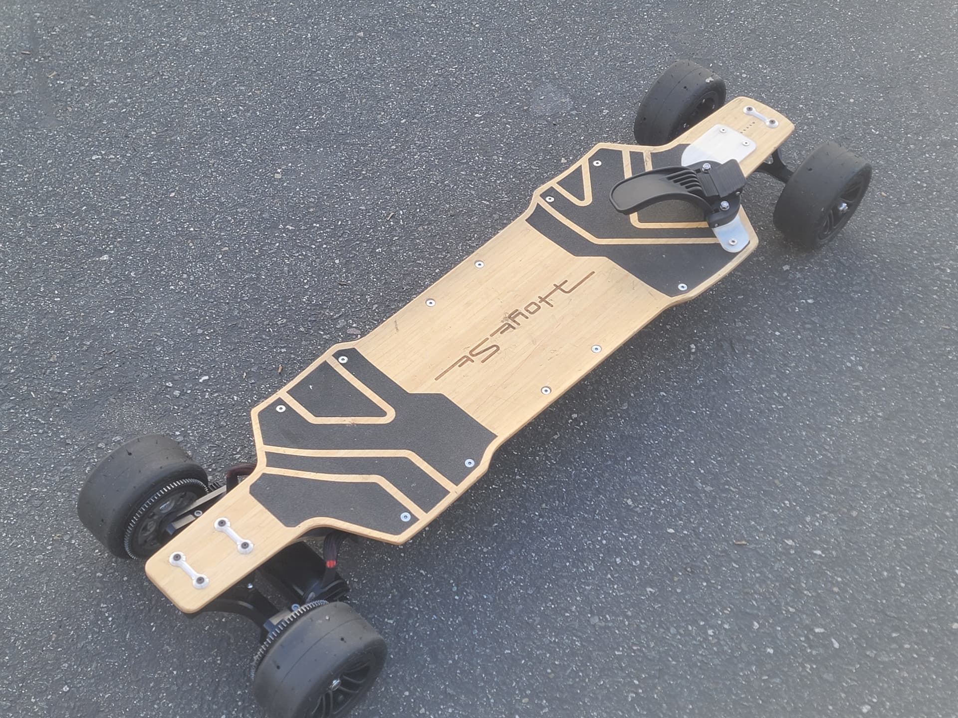

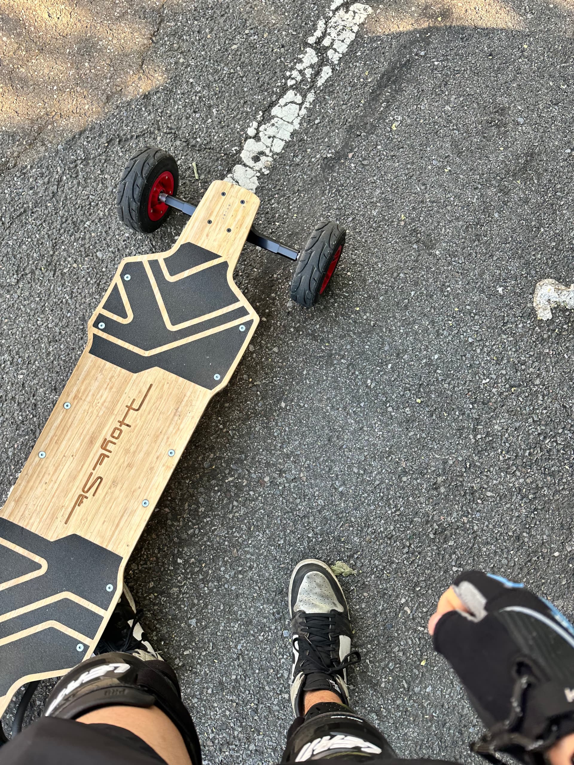

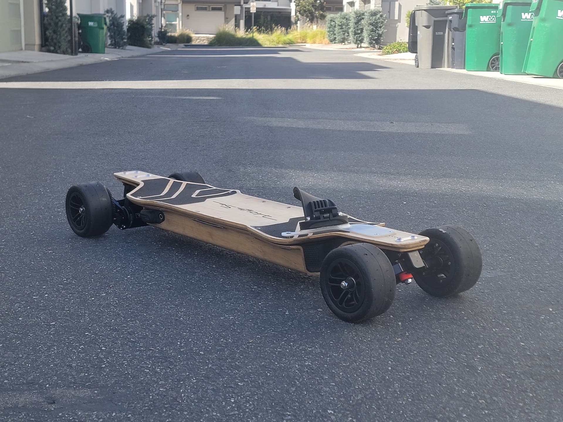

T-minus 4 days before TEF1 in Sonoma and after a fat chunk of laying it off until the ever-so-fashionable last-minute timeframe, here she is:

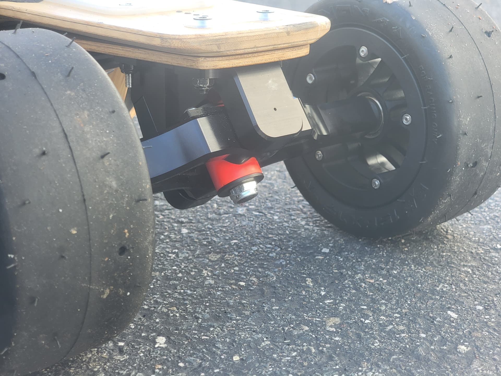

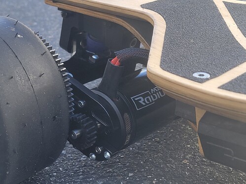

  • Hoyt St Cascade - 16s9p P42A, MakerX D100s
  • Radium 6485 205kv
  • 19-78T open gear drive
  • TitoSystems Duality Trucks (210mm front, 240mm rear)
  • MBoards Supernovas on Tomiboi Hubba Hubs & Linnpower LP Adapter Plates
  • Tomiboi Toe Clips on custom 3D-printed adapting mounts
Not entirely done yet: some few screws short and a FAT ton of fine-tuning to do tonight at Long Beach intro, but well on track to be ready to send it at Sonoma!
Massive thanks to everybody involved:
  • @Titoxd1000: trucks are second to none, and on top of that, for all our in-person chats and intro sesh with test-riding your demo boards (also not for putting up with the constant pestering of noobish questions / more or less testing patiences :sweat_smile: )
  • @gtonthat: for letting me steal the dadbod + Radium motors for this build
  • @andyzhang: for the spur gears from the trade
  • @HAIRYMANJACK: for loaning the Supernovas, Hubbas, and LPs for the race! Also for offering to help at intro with fine-tuning
  • @Dinnye: for staying up late on the other side of the globe to reteach me everything to do with trucks and bushings so that I can find the best place to start on my current setup (spoiler alert: first try of bushing choices per your suggestions and HOLY-)
Will proceed with any in-depth threads or footage regarding the various steps undertaken going into this build after this Saturday’s race. Until then, here’s to not dying at Intro tonight :slight_smile:
What motor mount do you use?
They’re Tito’s short mounts

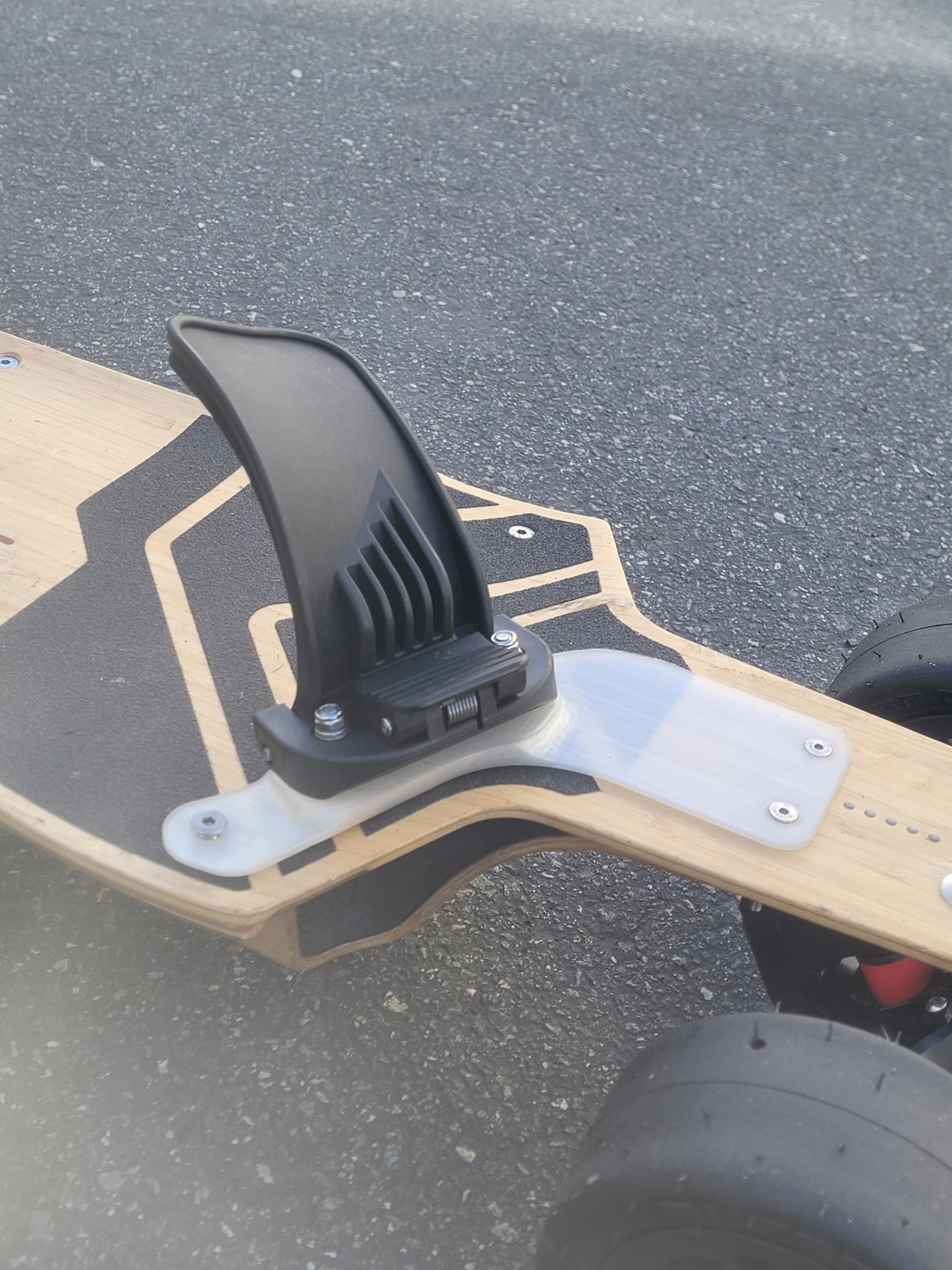

Looks great, I really like that tomiboi foot hook adapter.
Slightly different setup I’m running 300mm Tito’s and poast gears which aren’t available anymore or as of this moment running radium reacher 6384 which is more then enough and d100s running 160amps per motor and novas 7 for the mean nyc streets top speed I’ve hit on this setup was 48mph downhill here in nyc love this setup

Do you find the 7” nova sidewalls mushy or squirmy at all?
Is that 3d printed? I’d be so scared of it breaking :sweat_smile:

Replaced rosa trucks (kingpin) with dualities (queen pin)

No feels great actually I ride them at 30-35psi with hubba hubs it’s good

It is, but it’s connected to various mounting points on the deck it looks like… not just the two front truck screws. Gives me more hope it’ll be ok.
Thanks! @gtonthat made a rule in return for allowing the dadbod loan that I can’t mod the deck in any way. Had to get creative to work around that :slight_smile:
Yep, PLA+ ftw. Didn’t let up on me all night and that’s before upping to PETG I got on standby. Though I might as well go PETG anyways cuz next print iterations will fine-adjust toe clip placement to better cup my foot and avoid stabbing up into my ankle
