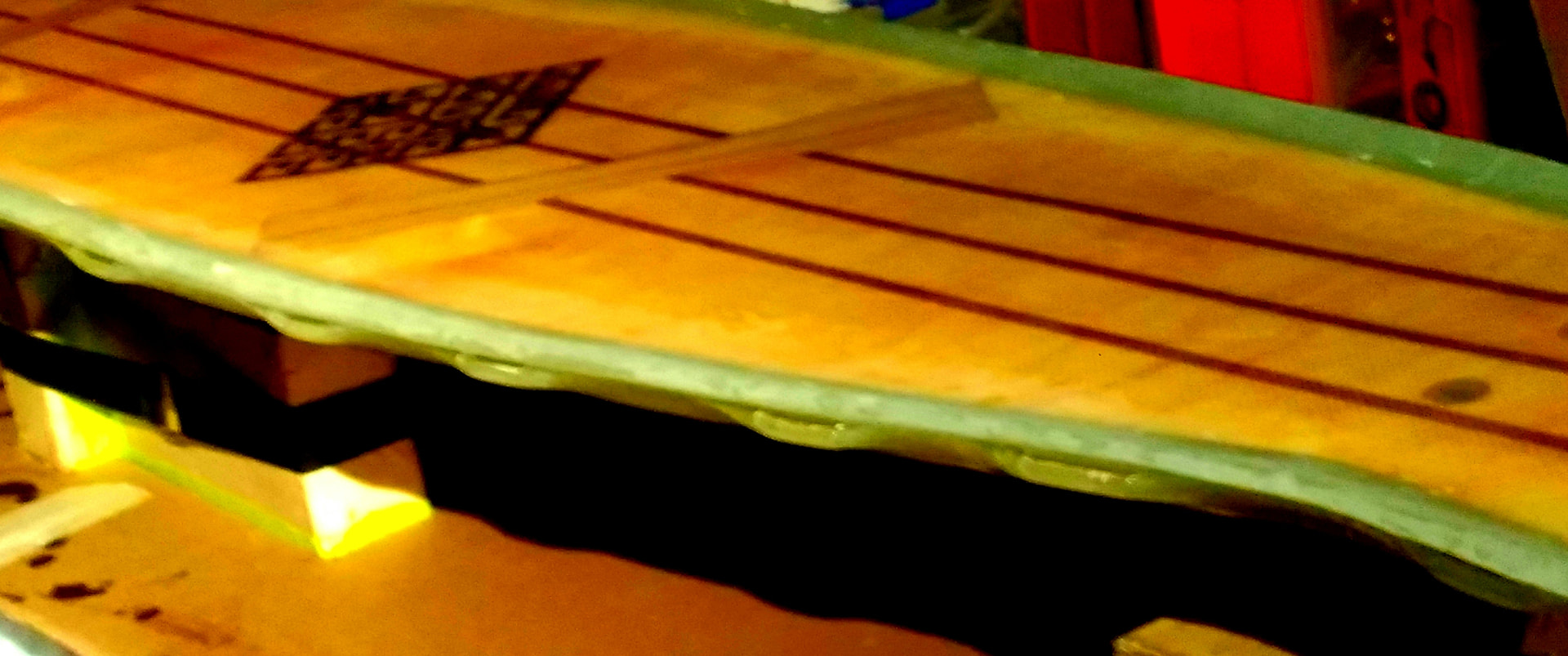

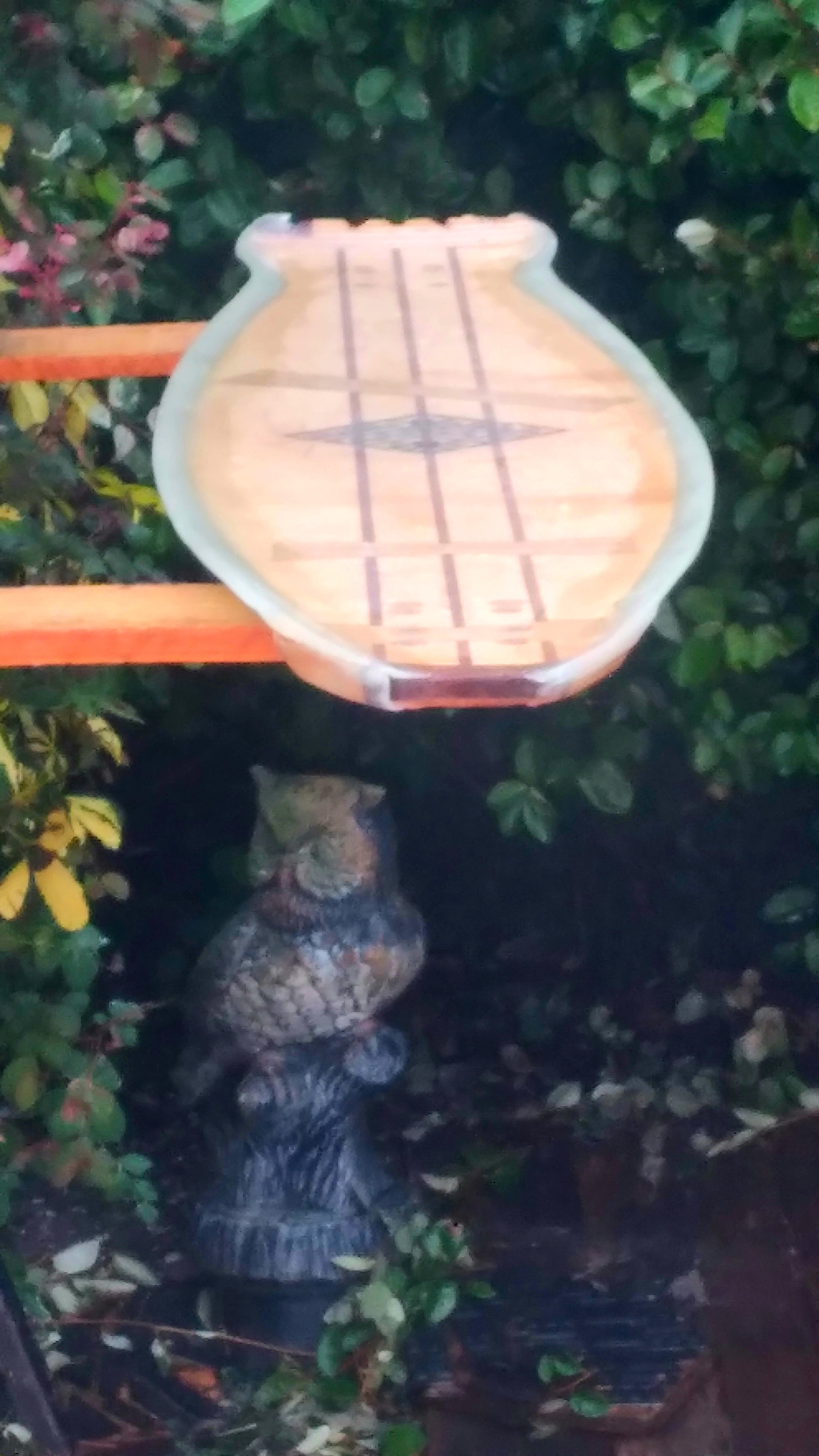

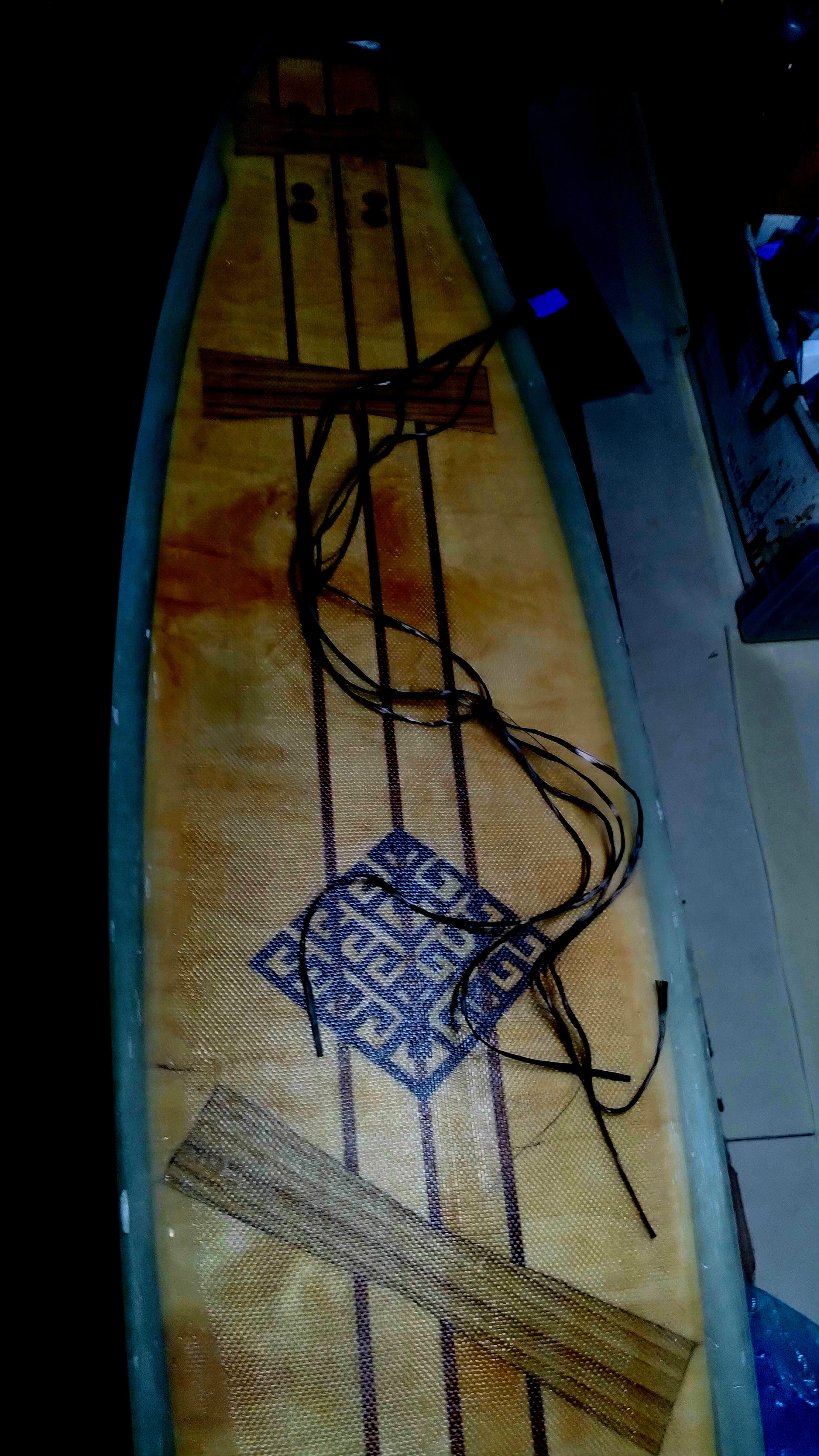

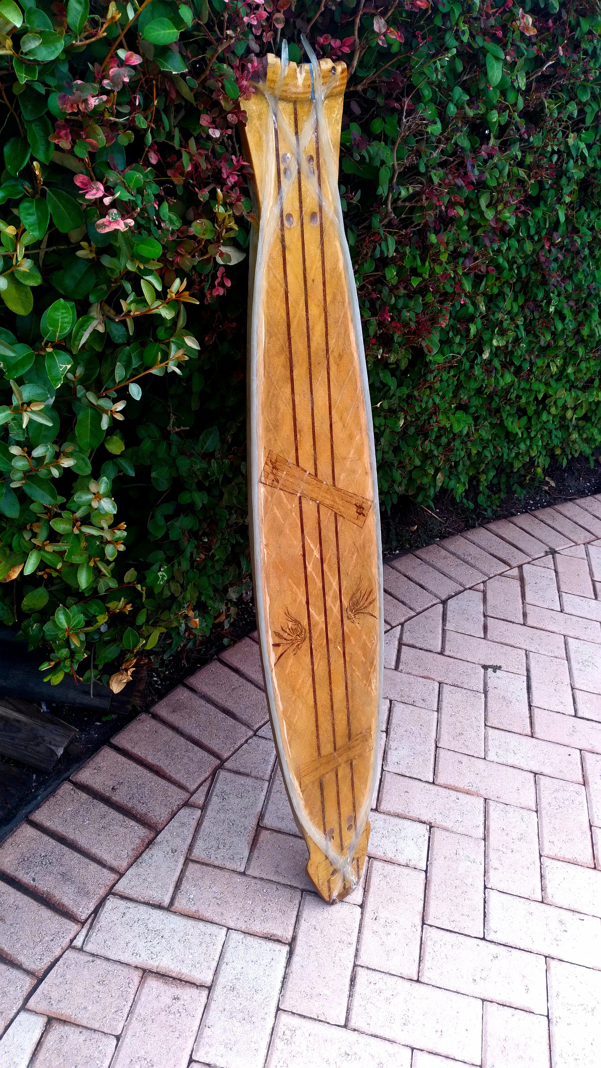

This surfboard laminating epoxy is pretty impressive. I regret not switching to it earlier.
The non bio version is 19$ less for a 3 quart kit.
System3 ClearCoat epoxy resin is slightly thinner, but this RR epoxy wets out fiberglass nearly as quickly. The SYS3 CC was my former favorite Epoxy for laminating as it was so thin it would penetrate cedar through 3.7oz E cloth deeply, but it is also a very pungent epoxy. Very expensive epoxy too.
The Apex brand budget friendly epoxy I had been using for years previous is significantly thicker, and the resin is blue with the ‘optical brighteners’ designed to make white surfboard blanks ‘pop’.

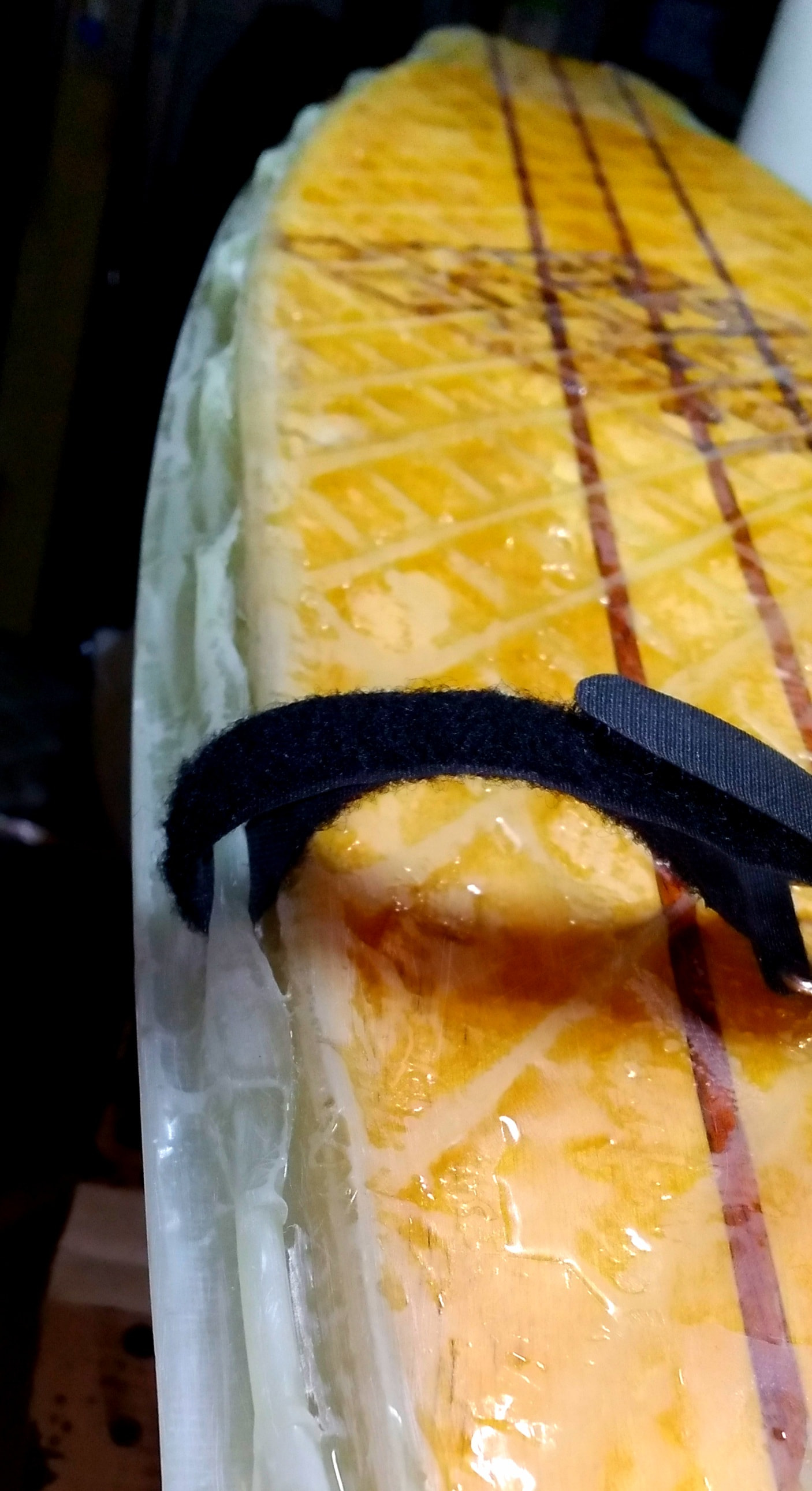

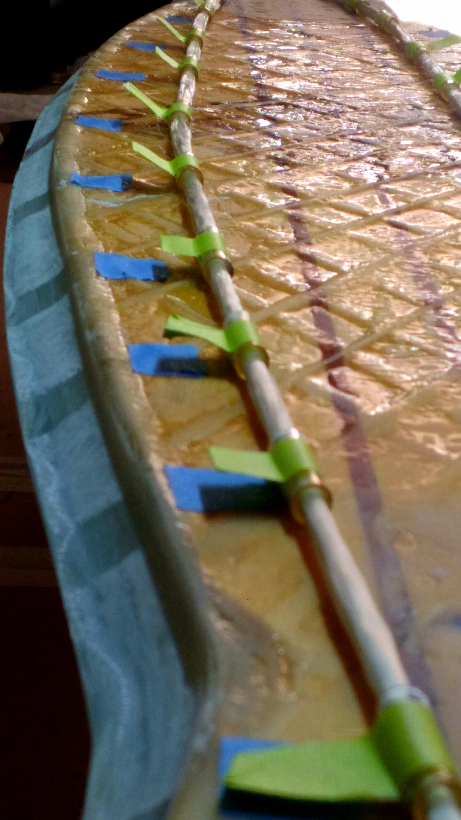

I am not seeking a showroom perfect mirror glossy finish, and epoxy tends to ‘fisheye’ when the final layer is applied if there is any contamination, and often even when there is not any as if it is electrically repelled.
I have not noticed this epoxy attempting to fisheye, when I know for a fact that the Apex epoxy would have.

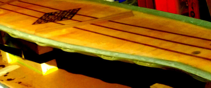

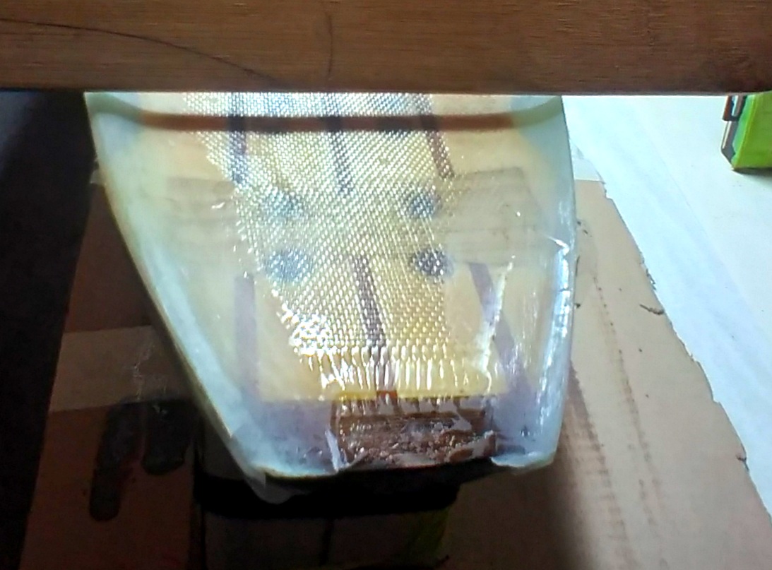

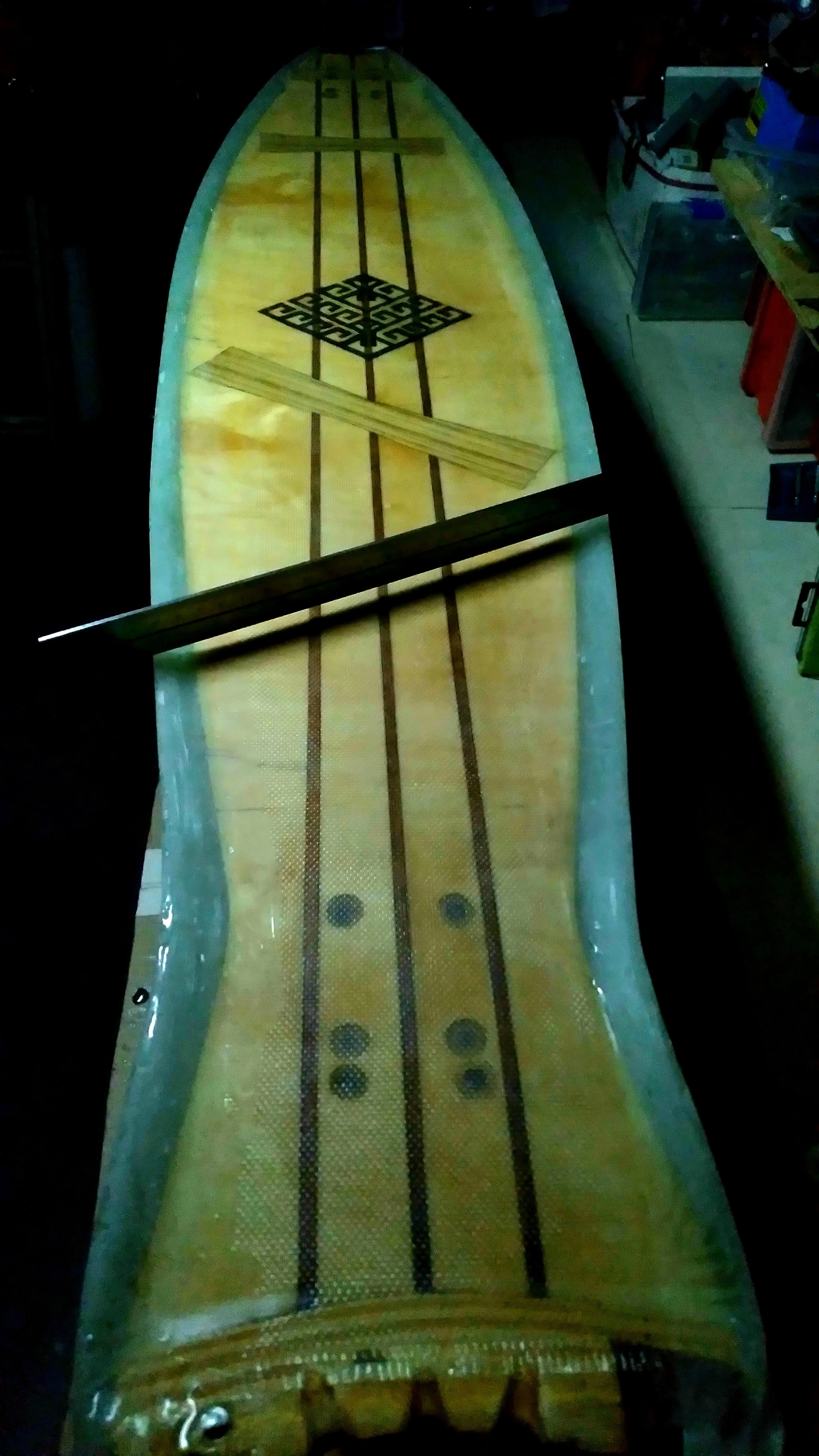

The Woven Roving strands don’t go perfectly clear, but I am getting far ‘clearer’ results with this RR epoxy compared to Apex epoxy, which also likely translates to stiffer and stronger too.

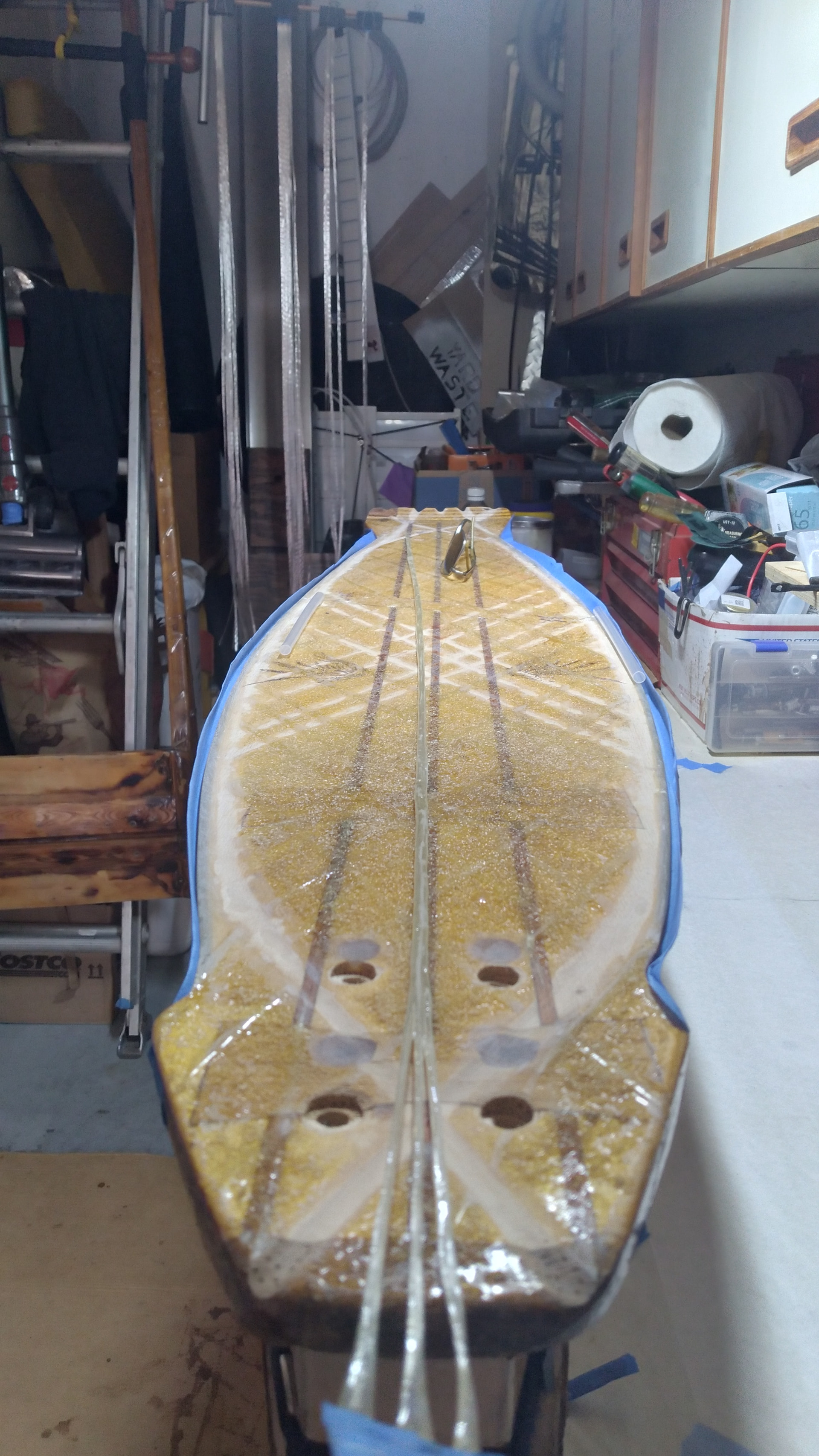

When fiberglass has a lot of time to absorb humidity it can make it far more difficult to get it to fully saturate, and the cloth weave might forever remain visible.
This happened to my Mini and Midsize which both are encased in fiberglass as well. This same Shitty Bondo brand fiberglass that comes folded in a rectangle from the hardware store is now on the Guppy’s deck and did go perfectly clear with this resin research epoxy, and has been in the same hot humid Florida garage absorbing moisture for a year.

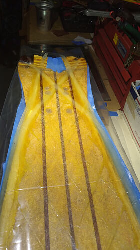

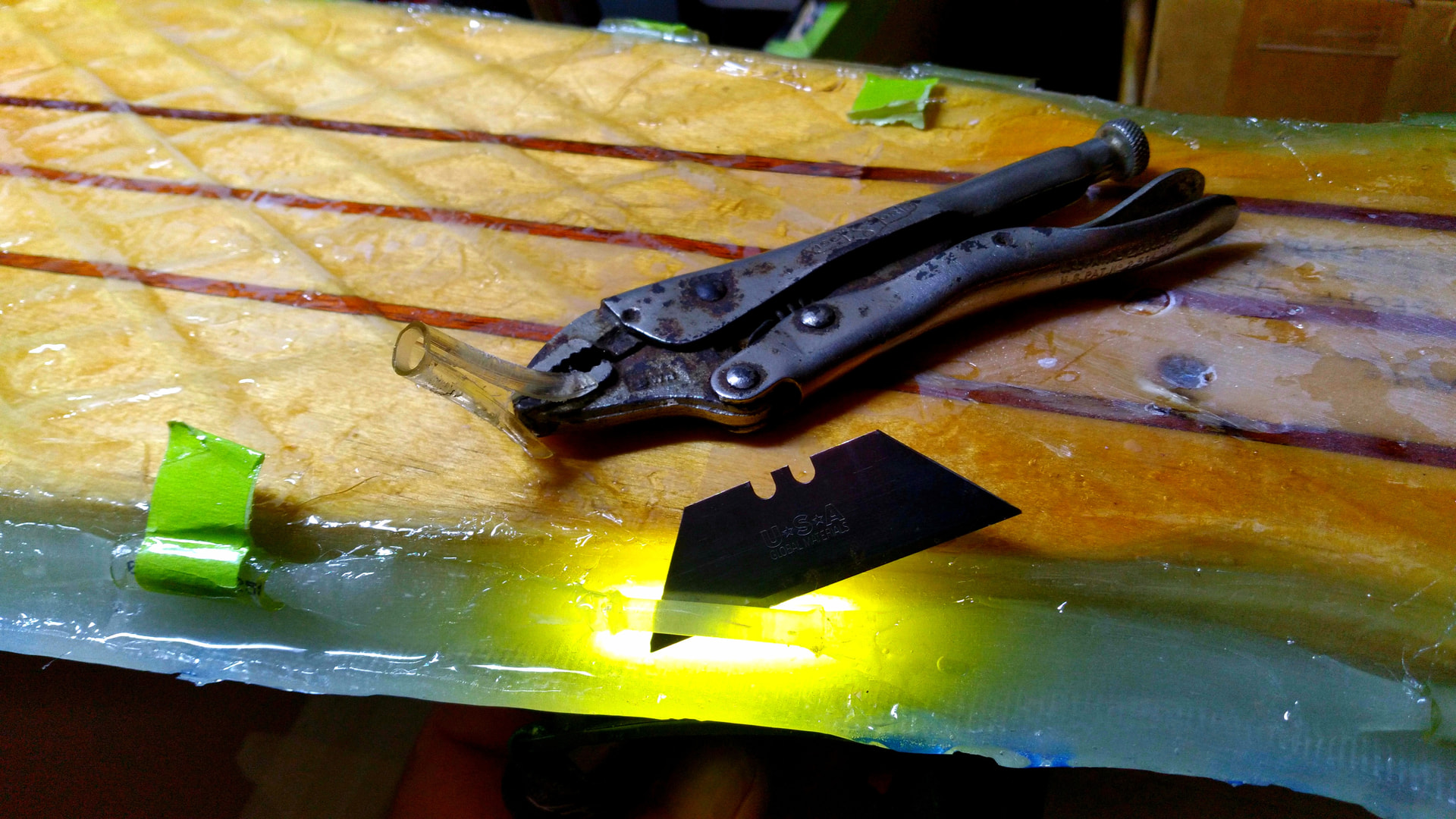

My Giant foot shooting mistake was aided by the fact that I labelled my Hardener in Blue marker, and my Resin in a red marker.
With Apex epoxy, the resin had a blue tint, and the hardener was mostly clear when new but darkened with age and humidity more towards the red and any drips down the sides of the bottle turned even more of a dark amber closer towards red, So when I went to mix a second batch of epoxy, and went to add 44 parts of hardener, I grabbed the red bottle, which had the resin, and did not notice until hours later when I went to pull my plastic and saw anywhere Where I used epoxy from that second batch, it obviously had not cured.
I wound up turning even the properly cured epoxy to dust too as I did not trust that i did not get unhardened epoxy under it.
So I mixed up the colors and mixed 100 parts resin, with 44 parts of resin instead of hardener, thus shooting myself in my foot as my self destructive sub conscious often demands, unfortunately.
So that mistake is a sticky dusty mess now in my past and the guppy will ultimately be better for it. It will be Stiffer, stronger, and wider than it would have been if I did not make such a rookie mistake.
