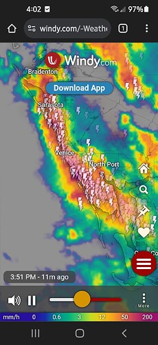

Awesome thunderstorm time.
Loud!
I am not sure of the appropriate response.
I think I hear interdimensional maniacal laughing.

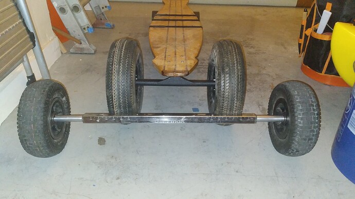

These 987 gram hand truck tires, don’t really self center on my rims very well, like my rims need a bit more diameter
The tube’s valve stem , also seems to be a bit tweaked, like I perhaps need to dremel a bit of clearance on the half moons of the rim.
I got to stick a finger in behind valve to push and center it so I can get the pump onto the valve.
While these tires are intended for the chariot/kayak axle, they do not bite my deck at full lean, though it is close.
Ill try to get them centered better tomorrow and get them hot underfoot, and hopefully de-wobblifyied, and balanced.
First impression of the Pico tires underfoot was wobbly, especially while slow speed turning.
At a slightly higher straight line speed, I could feel the imbalance. I only added balancing weights to one tire so far.
I swapped them to chariot, then wanted to check and lower psi to 12-15, but couldn’t reach back of valve to push it down enough to get a tool over on top, so left them @ 25ish, loaded Fiona and split.

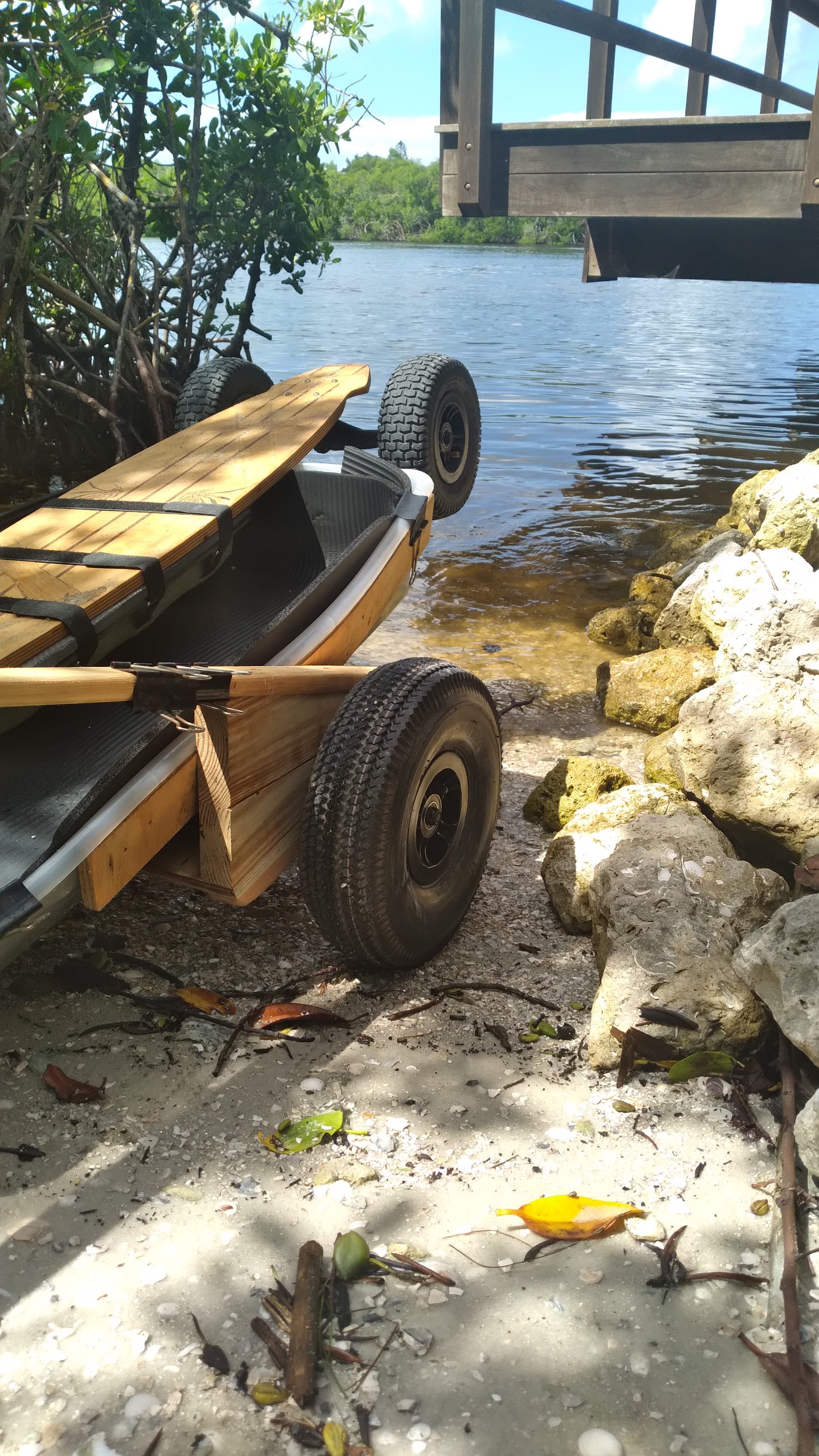

The chariot now easily free rolls better than the skate.
I could feel some tire wobble through the handle at near max speed and worse at one lower speed range, and see the tire wobble, but not the basket.
The chariot’s first set of 200mm x50 scooter tires were worse in terms of basket harmonics.
On the shell trail, the chariot basically floats atop effortlessly, and presents so little drag on the handle, I had to let out a chuckle.
With the heavy rain yesterday, I could have easily gone a lot faster than ever, over the shell trail.
I’ll make an effort to improve the wobble/offcenteredness, and balance after getting them hot for several more miles.

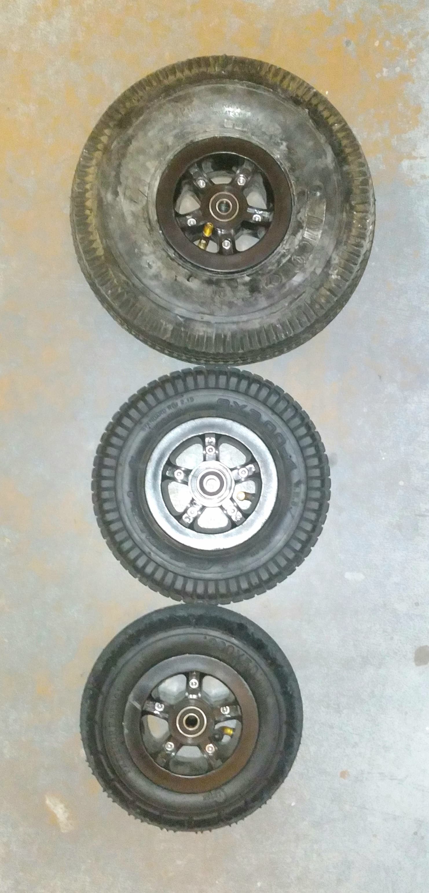

I would bet that you will find even better results with the pressures closer to around 10 psi.
I want a life like Fiona’s!
At 10 PSI, I can still move the rim within the tire.
In fact, this PSI seemed to best way to trial and error and center the rim within the tire, at least thats how I achieved the best result, so far, on the one worse tire. Pumped both to 20psi, and while there is some centerline wobble, the out of round seems to be much reduced.
These tires are likely not fit for esk8 duty, it is as if the two halves of the mold were not joined very precisely on one of them.
There is a lot of beige waxy crap all over the tires whose removal has proven stubborn.
I can’t hear them over the turf tires and urethane, at speed. The radar sign was relocated at the bottom of a slight decline, and with a tailwind towing, we hit 23 mph with about a 50% battery.
These tires are likely quite old.
The return trip across the shell trail, I saw the sharper edge of these tire’s squared contact patch left a line in the softer parts of the track, at least at 25psi+
I did use a carbide burr to round the edges where valve stem was getting tweaked by the rim, and modified my hand pump nozzle to fit within, a bit better, but pushing the valve from opposite side of rim is still required to attach pump nozzle deep enough and raise the lock.
