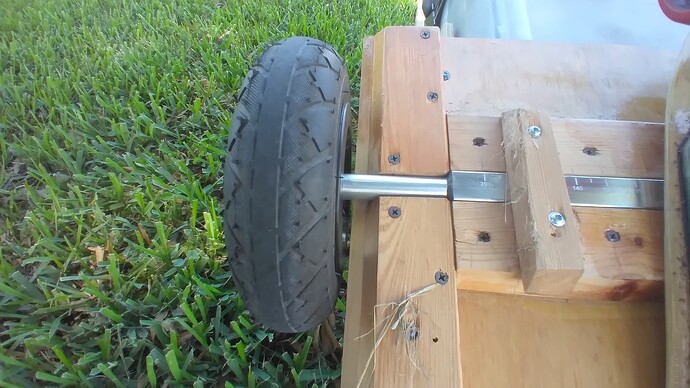

Did a little chariot tuning.
I extended the dual yoke about 18", and used an Marine Teak flagpole as a wider dual handle.
The top ball of the flagpole acts as a great offset handle, which allows me to position Fiona out in undisturbed air, with an unobstructed view forward, off to my right, which she really seems to appreciate.
We did a test run around the block, and Fiona decided she was not getting out of the chariot, while I put away all the tools and cleaned up.
I should likely have not ordered these 8x3-4 turf tires, and tubes for them.
I hope my rims are wide enough.

The plastic underbed box/basket in which she sits is destined for replacement with something with taller sides.
The hanger is so wide at 26.5"/ 67.3cm.
It is really stable, and the longer yokes now also adds some stability as does wider handle.

World’s cheapest Vevor branded analog mountainboard rims.
44.70mm wide
95.82 mm inner diameter
10 mm wide lip
came with
200x50 clever tires
6000-2rs bearing
installed.

The 8x3-4 turf tires looked all asymmetric and lumpy out of the box.
The ‘flat’ part of the tread had a V in it, the apex closest to the red and green stripes.
I mounted them using existing corn starched tubes and inner tires, trying to center them as best as possible, kneading the side walls, adding psi in short bursts up to 30.
I was unimpressed with the wobble and out of round. I loaded Fiona and went cruising.
The Noise of the tread is not nearly as loud as feared, but I could feel the chariot wobbling and bouncing again, and see the wobble and out of round, at speed.
Fiona seemed a bit disappointed.
I took them apart again, and lightly cornstarched them again, and reassembled again, slowly adding pressure and kneading, but this time, using my urethane wheels spinning 30 mph to get Pneumie wheels going as fast, then moving edge of urethane to pneumie rim instead of tire and getting even more rpm’s and centrifugal force. Lose some PSI, knead, add some PSI, spin to max speed again.
It seemed like every time I did this the wobble and out of round lessened a bit more.

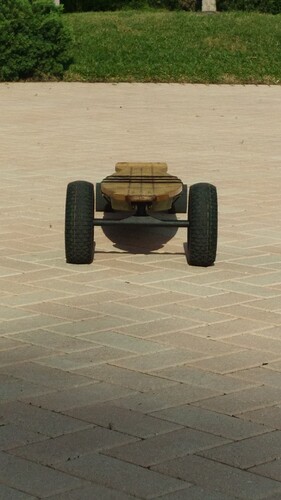

I put my weight on the chariot, then said F it, and pulled 10S enclosure and rear truck from midsize, and installed them on the long cruiser.
Holy eee crap, I forgot how much fun this board is. I only powered it with the 350 watt 83mm hub motors before, not these 400watt -90’s. I went several miles warming them up, carving progressively harder, and the wobble and out of round kept diminishing as the confidence and fun started soaring.
I stopped then removed tubes again, rotated them within the tire, reinflated and spun them up past 30mph in ~5 psi stages to 35. then reduced them t 18 PSi and took them for another spin.
Joy.
The little wobble and out of round remaining, are acceptable, and I can’t feel them underfoot, at least upto 24mph.
How ridiculous is this?
With the enclosure much further away from rear truck, and front truck, and at an angle to oncoming air at speed, The airflow through the heatsink fins must greatly be increased, as even though I am going way faster, the heatsink stays cooler than going slower on my kayakable midsize.
