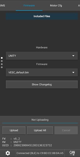

For fun today I flashed 6.0.2 UNITY f/w onto a NOS Unity.
Initially over USB it claimed it was 5.0.3 & that 5.0.3 is the update. So to make thing interesting connected a VESC Express™©® connected over CAN, connected my phone app over BLE then registered a server on veschub.vedder.se & finally desktop tool to the server as a client.
While I was only a couple of ft away I guess it could conceivably handle a remote connection for some reason - remote Frank assistance?
Anyway I digress, upload then commenced of firmware et voila, we have 6.0.2, it was fast too.

I recently flashed VESC 6.02 on a new FocBox Unity for my Nazare build.
I am running the SKP 6485 Motors in Silent HFI and I have had no issues with the VESC 6.02 & FocBox Unity set-up.
Hope this helps!
Mine has been running great for like 500 miles now
