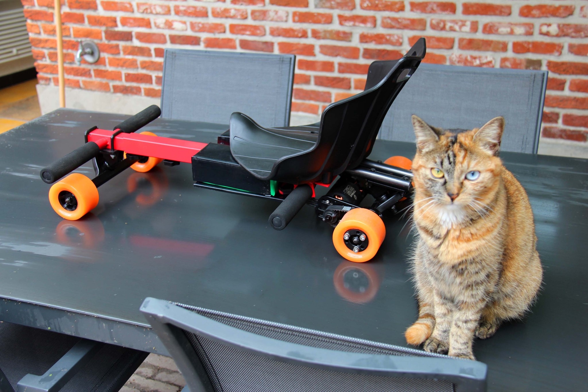

So I opened Facebook today and saw this in our Belgium DIY group. Now I want to build one too ![]()

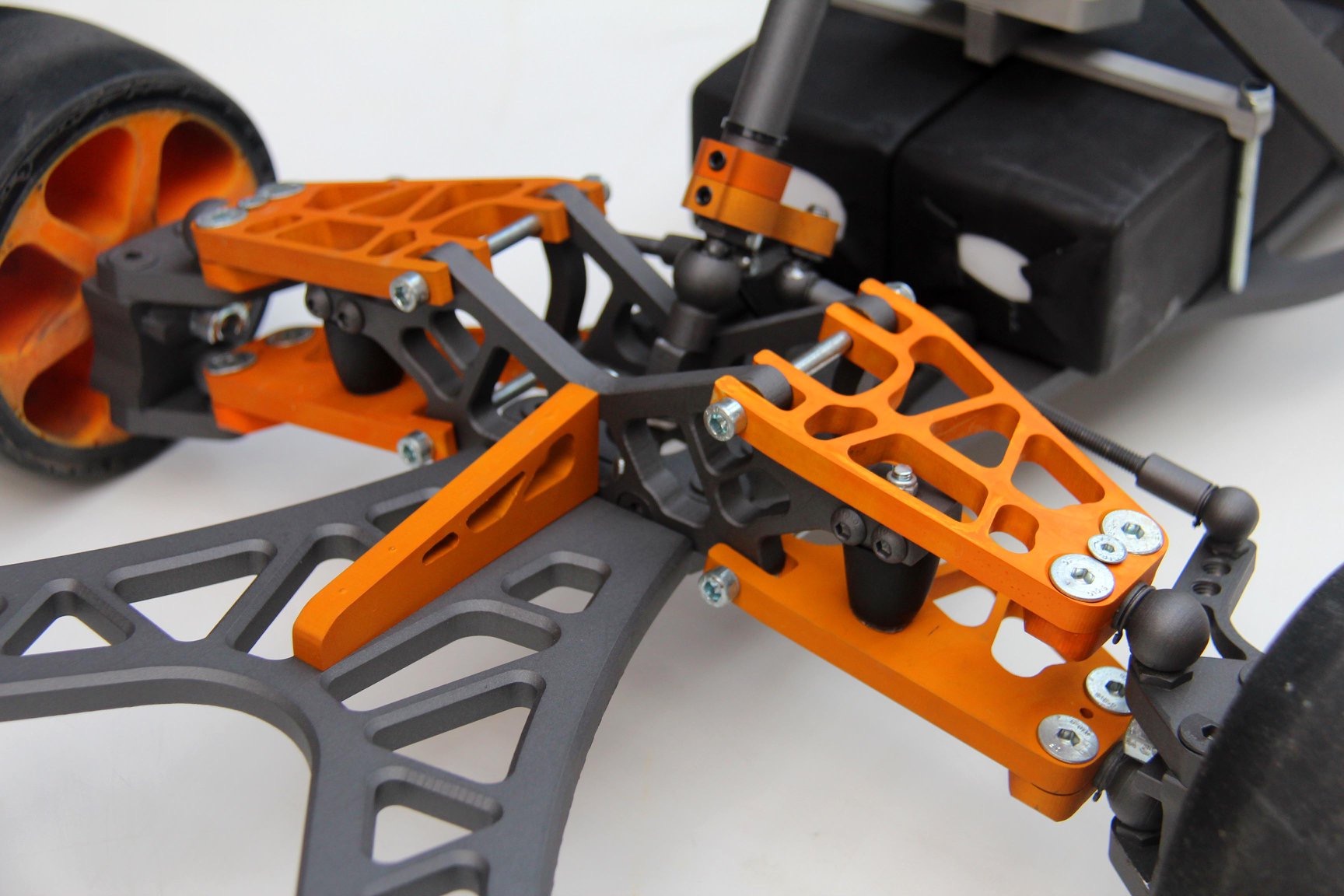

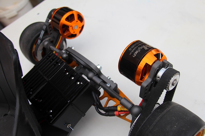

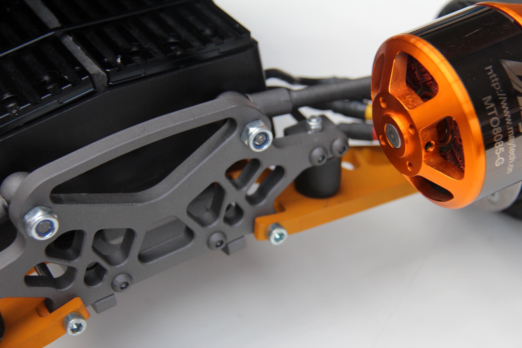

Crazy to see that he is using the same parts we use. He is running maytech 8085 on maytech 4.12 100A vesc.

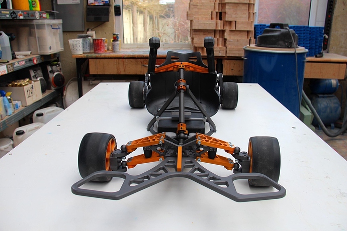

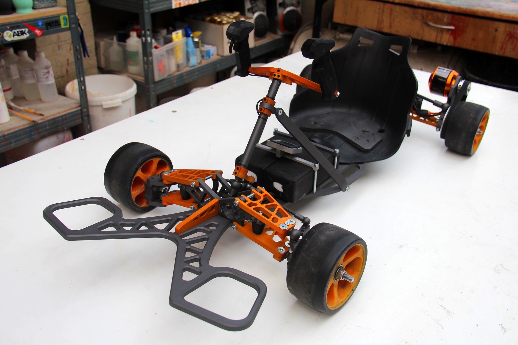

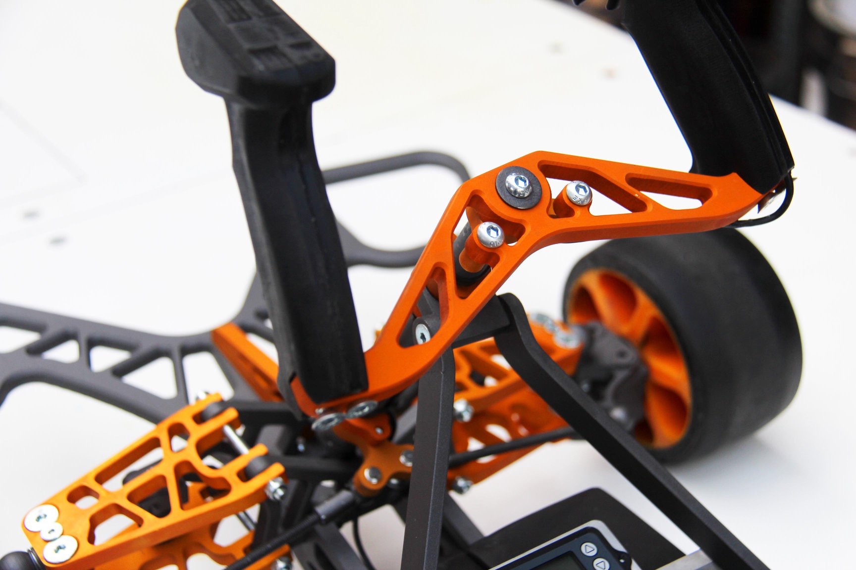

It is fully custom cnc by himself with 8-10mm aluminium. Wheels are also custom molded rims with PU

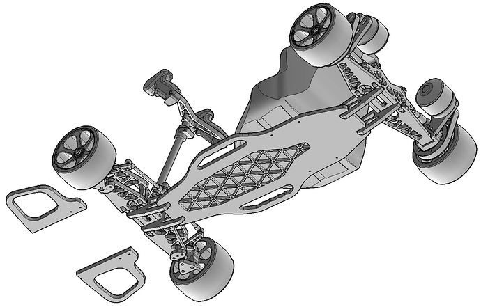

I translated his story: In this part I show my creative project where I between all over 2 years am doing, and all 4 versions have made.

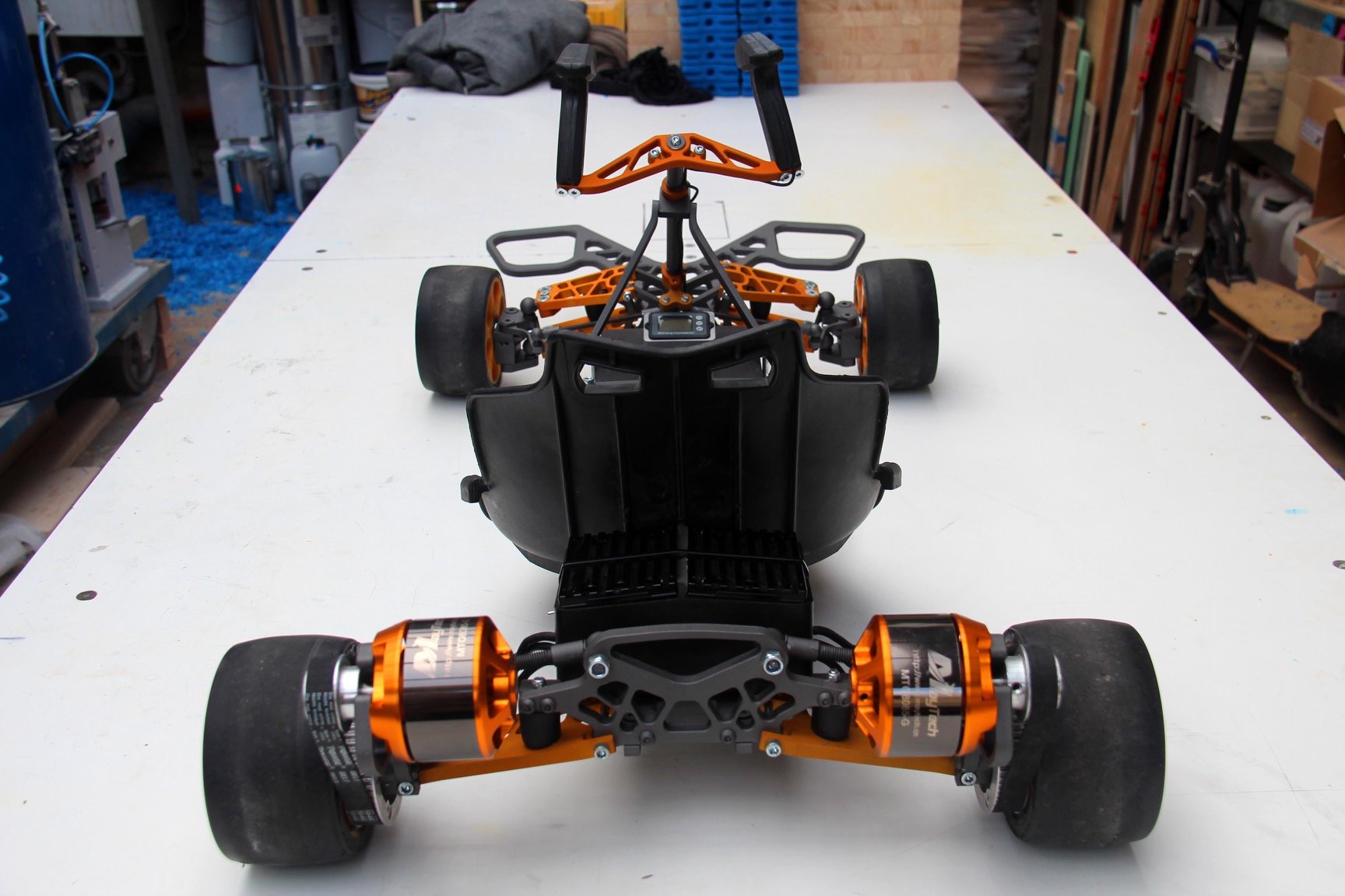

a Super powerful micro-Kart! Beast weighs 18kg, has a capacity of 2 times 6500w, and Bolt with lots of convenience 75 + km / h as on acceleration is set in terms of transmission. Range of 35-40km you’re Super low to the ground, and is therefore Super stable, so acceleration, brakes and bends. All parts themselves are designed, CNC machined, and himself anodized aluminum of 8-10mm thickness. : D also the electrical system 100% custom made! Self wheels / wheels are fully in molds with very tough giethars and polyurethane rubber made.
The last annex is a short film of one of the previous models in action! Bottom I have an ISO grid from milled, purely for fun and looks. Meanwhile, I have with the karts all over 1200km driven, so it is absolutely shown that the electrical systems / transmissions very robust. In this part I show my creative project where I between all over 2 years am doing, and all 4 versions have made.a Super powerful micro-Kart! Beast weighs 18kg, has a capacity of 2 times 6500w, and Bolt with lots of convenience 75 + km / h as on acceleration is set in terms of transmission. Range of 35-40km you’re Super low to the ground, and is therefore Super stable, so acceleration, brakes and bends. All parts themselves are designed, CNC machined, and himself anodized aluminum of 8-10mm thickness. : D also the electrical system 100% custom made! Self wheels / wheels are fully in molds with very tough giethars and polyurethane rubber made.
