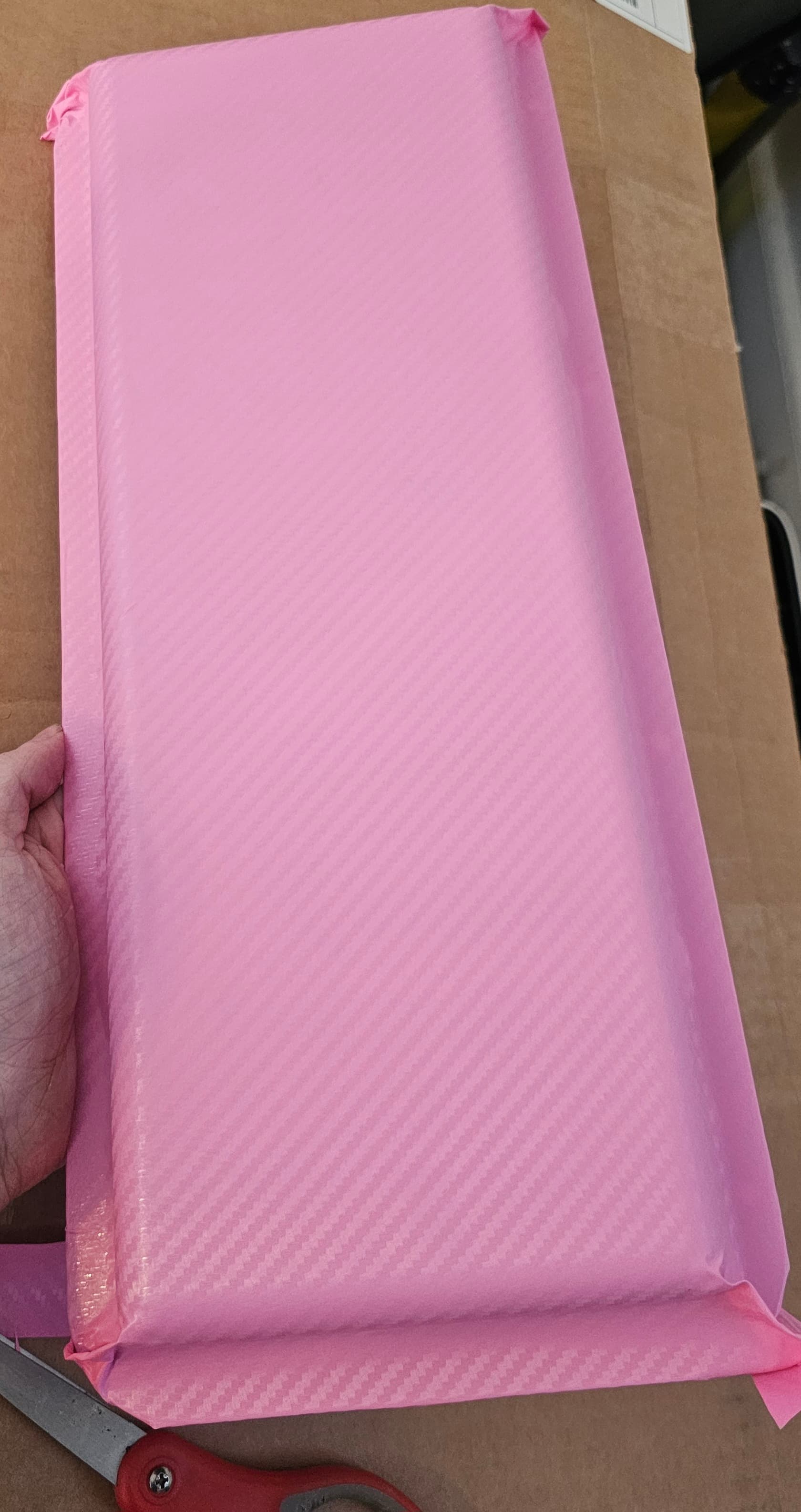

Let’s work on making it a bit pretty. (Originally I was going to use a bustin enclosure, but I ended up needing more power/bigger battery)
Top view. I want to replace the griptape, but hate to hide bustins logo.
Bottem view looks great. I’ll need to zip the motor wires to bash gaurd, but I’ll reduce them for next year.

I wonder how this deck compares to the Sportster.
The Sportster has the sweet drop of that locks you in!!!
Is this one shorter?
I would love a nice drop, but opted for something a little different.
This one is shorter than the sportster by about 1.5".
I was also thinking the drop may be a problem with the mounts…

Doesn’t look like a lot of articulation here…
One of the reasons I’m not a fan of these trucks. I might just put some DKPs on.
Hopefully they will come alive when they are moving.

Have you had a chance to ride them dude?
Yes! It rides okay, but these mlr 3 links just don’t cut it for my needs. Will try with srb 3 links % Dualitys.
