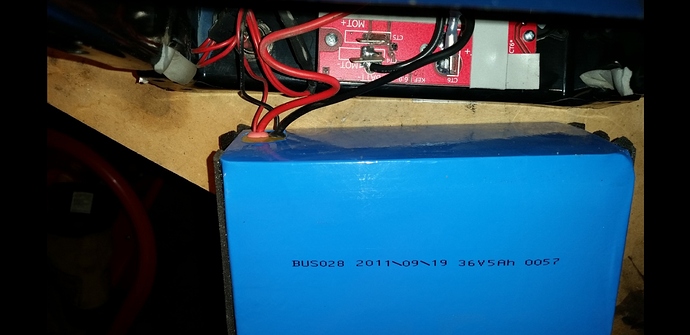

Hi All,
First post - not sure if this belongs here or in the prebuilt forum. Stoked to find this place. I’ve got a mid length (36 inch) metroboard that will be up for a battery replacement soon (it’s third battery in 9 years) and I think I’m going to need something custom. See pic below - I’m currently running the 36v 5ah standard metroboard ‘brick’ battery. The enclosure and deck are literally the only original part - I have constantly upgraded over the years with Ilan’s awesome backup support but now I see he has gone to a whole new style of board. I would like to upgrade to a longer but lower profile enclosure. Metroboard used to do a slim enclosure but they only used a single layer of cells with limited range and I reckon I have enough height / room for two layers. The board also sometimes cuts out on steep hills - I.e trips the circuit breaker that’s built into the power switch. Not sure if a better battery would fix this but it definitely happens more as it gets older.
In terms of space I have 16 inches from the back of the front truck to front of the motor, So maybe 13 or 14 inches useable. And 8,5 inches wide at the front, 9 inches wide at the back and 9.5 inches widest point.
I have no idea where to start. I’ve had the enclosure off heaps of times, replaced circuitry, battery, receivers etc but that’s about where my skills run out and it’s always been with pretty good step by step advice from Ilan. Does anyone know of someone who would build a semi-plug and play type enclosure and battery upgrade? I think building a battery might be a bit beyond my abilities and I also have no clue about charging, drivers, amp ratings for that motor etc etc.

@b264 is the shortboard expert, it looks to me like you could fit a decent sized battery in a slimmer enclosure on there for sure. What voltage and P size is it? I would have to guess something like 10s3p or something but not sure
That’s actually the same enclosure Brian uses on a lot of his boards. I had one.
I think you can fit a 10s5p of 30q in there and a single smaller esc.
That’s a 10s3p in the same enclosure.
We can definitely get you hooked up with a 10s5p 30Q battery or similar if that’s what you are looking for, if you can get exact dimensions and pictures of the interior I can tell you what other layout options you have
It’s the enclosure I posted above.
Ah yes apologies I haven’t done a profile or anything. I’m in Western Australia. I have no idea what a p size is but I’m sure Ilan could tell me. I’ve sent him an email asking for any specs I might need to custom build a battery so I’ll see what he says. I did dig these pics out that might help but I’m trying to go longer and thinner if I can rather than replace this one with the same thing.

Also just dug up this info out of an old email. I must have got this info from Ilan last time I was trying to find a battery in Australia:
36V 5AH LiFePO4 Battery that can handle 5C continuous discharge (meaning at least 25 Amps continuous/50 Amps peak). The physical size of the battery is 180 mm long x 70 mm high x 100 mm deep.
