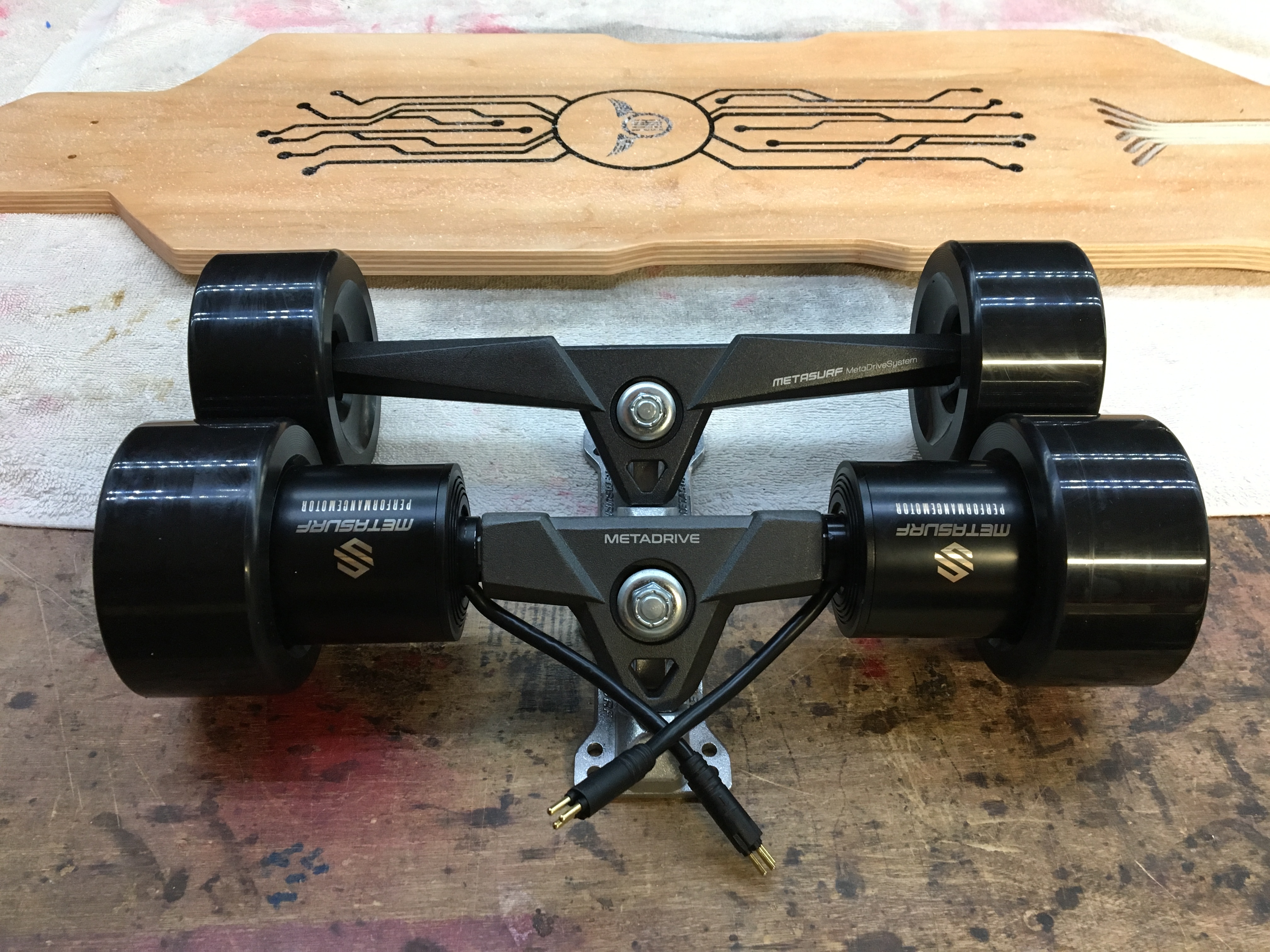

The Meta Drive
Meta Surf Meta Drive on the bench
Meta Surf. they sort of came out of nowhere, much like the rest of this industry. Except this time they were really not expected because I’m much more saturated in esk8 now than I was just last year. Who are they? Where did they come from? I don’t have all the answers for that, but i was able to acquire a set of their drives through an active community member who was thoughtful enough to grab them for us while over seas. They also seem to have a presence in San Francisco. I think what caught my attention the most, however, was that they are allegedly running their complete boards at 13S voltages. The highest end boards, including mine, typically run 12S, which is 44.4v nominal, as opposed to the 48.1v of 13S. OF course they also mention using FOCBOXes on their website and say they are swappable in minutes, so who knows what we’re actually dealing with. Somehow I doubt there are any Enertion products anywhere in this.

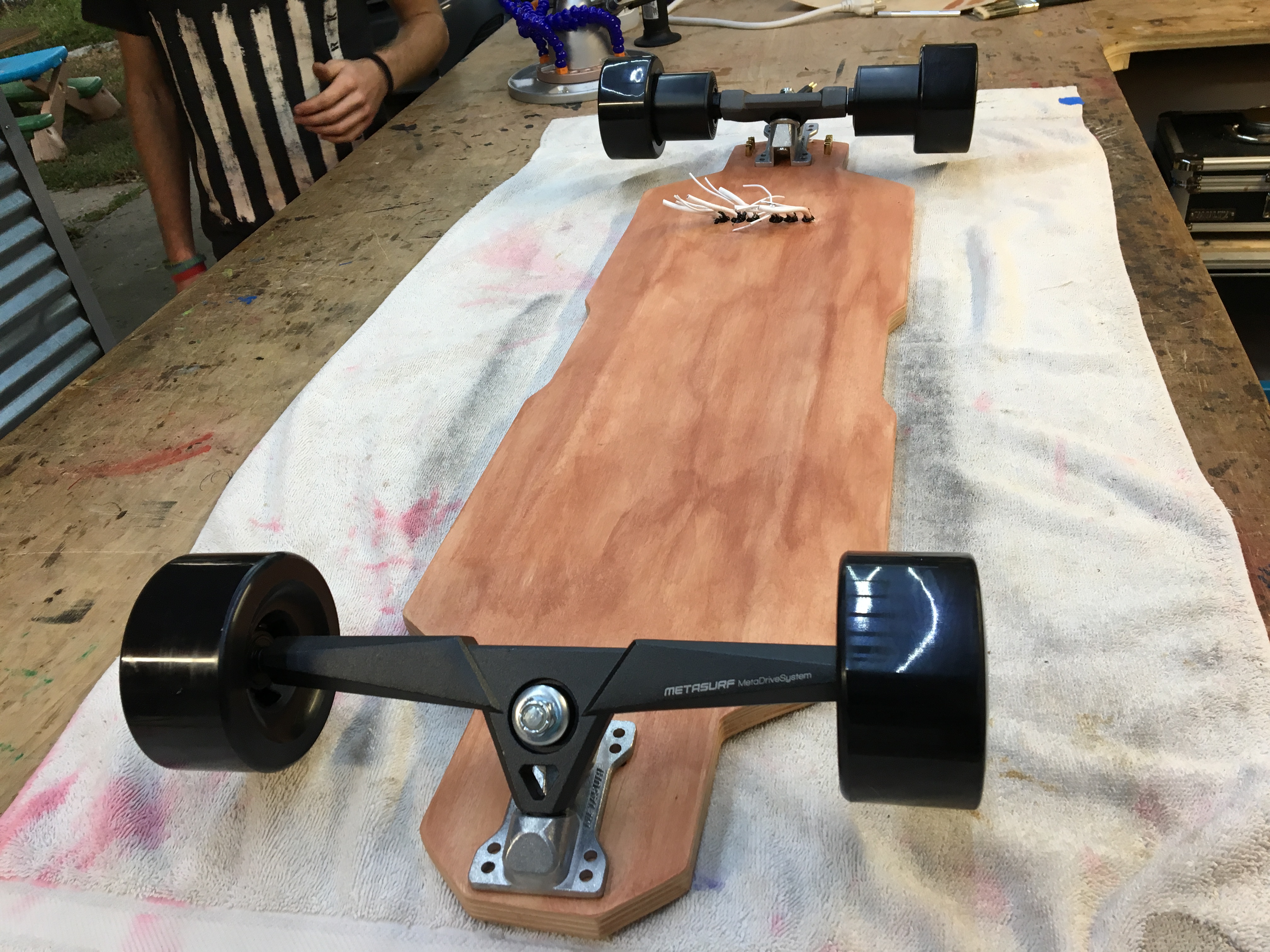

My first impressions were that it was polished, pretty, and probably going to bend almost immediately. The axles are just incredibly long. The stance is wider than an Evolve board (take your pick, they all run the same trucks) and is still only using 8mm axles. Now before you say anything about evolve not having to worry about bent axles so much, keep in mind that Evolve isn’t shaving the aluminum down and leaving several inches of bare 8mm axle so they can slide on a direct drive motor. While digging around the internet, I was able to find a few images of bent and broken Meta Drives, however i don’t think going deeper into the discussion about how flimsy they are is going to help anyone. They practically sag just sitting on the shelf.
The Meta Drives on one of my Witchblade GT decks, which is 10″ wide. Wow.
Something more interesting about them, however, is the complete lack of sensors. Unless their ESC is magical, there will be no stutter free start. It’s possible that running these at higher voltages on an ESC that can do true FOC may mitigate some of that, but its not likely going to be anywhere as pleasant as sensors would. No matter how you slice it, if you don’t know where your flux is in relation to your coil, you’re going to have to guess. That guessing makes your board seem stuttery and less polished on launch. At the time of this writing, there were no complete Meta Surf boards available for me to try, so all of my impressions are gleaned only from their drive system.
In spite of that, we decided to strap them to a Bustin Maestro and see how they run. Due to the lack of a matching ESC, we strapped a well known system that works with hub drives rather well in both with and without sensors: a Koowheel ESC from an earlier model. The Koowheel runs a pair of hub drives with sensors at 10S, and was able to detect and run these Meta Drives rather well. But since we don’t have the intended ESC, or the intended 13S voltage, and no damned sensors, we’re going to be lenient regarding their performance.
That said, the performance was actually rather good. If you can get your mind past the idea that the axles on the rear truck are actively bending every time you stand on the board, it doesn’t feel so bad. The usual ride around the block yielded pleasant results. They have a lot of bottom end torque once they start rolling, but not much top end, which is typical of a lower KV motor. For Sunday cruising, this would be a decent drive system. Assuming you don’t mind waiting around for axles to bend. And you don’t mind accidentally footing the wheels because the stance is so ludicrously wide.
