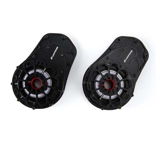

im joking, but
Have you inspected the belts themselves? You can tighten the belts all you want, if theyre already shredded then theyre gonna keep slipping.
Try replacing the belts.
