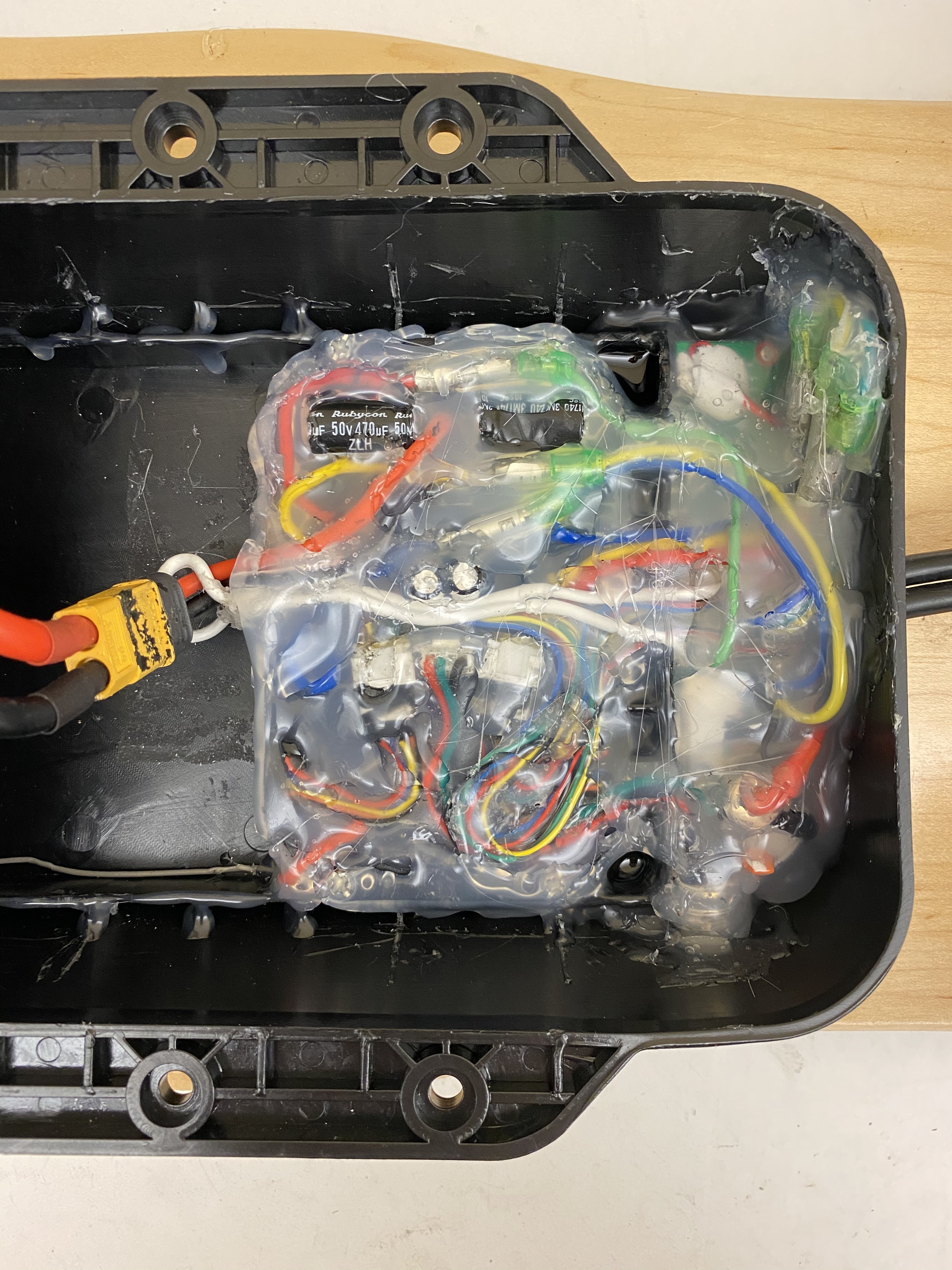

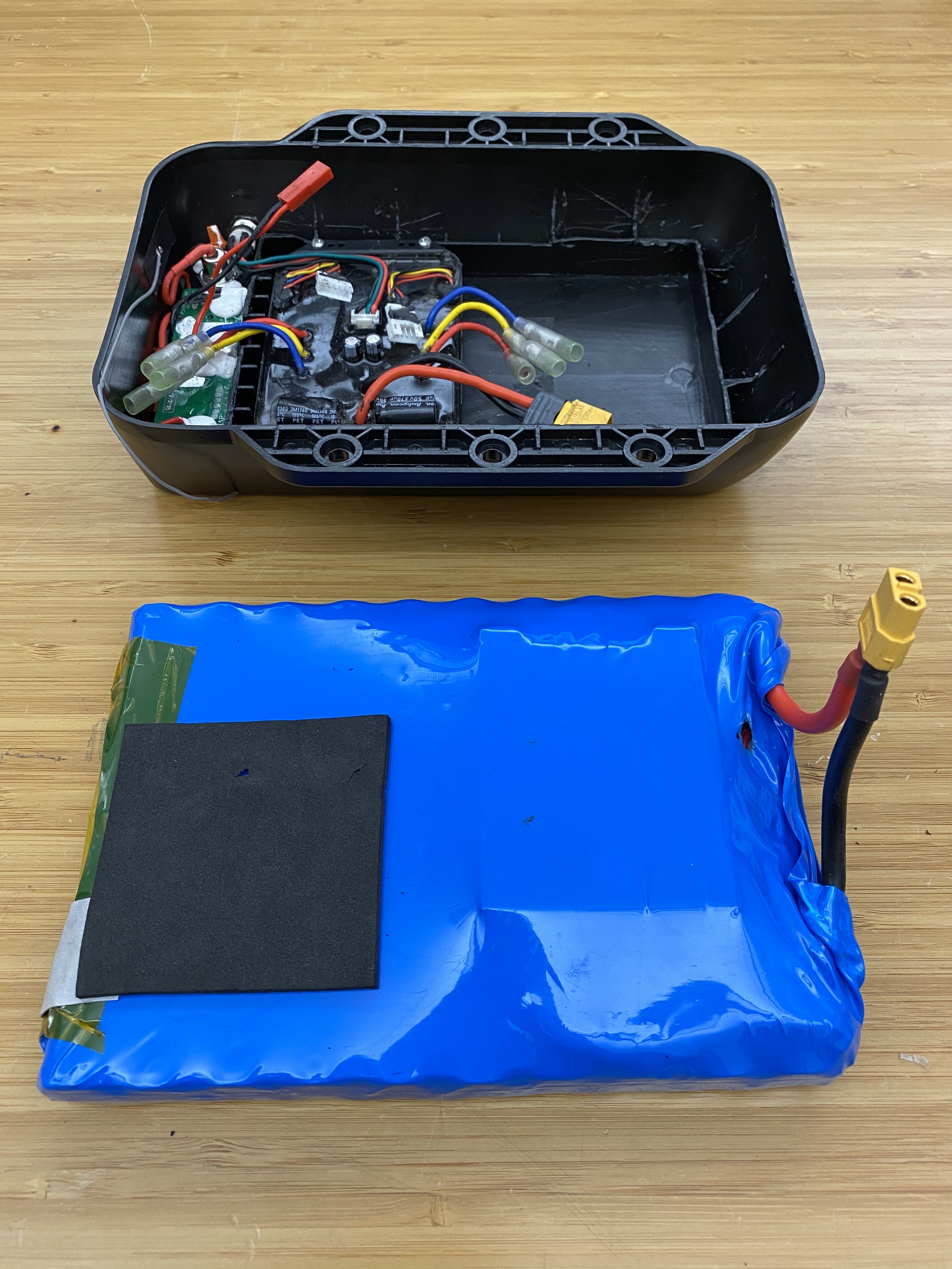

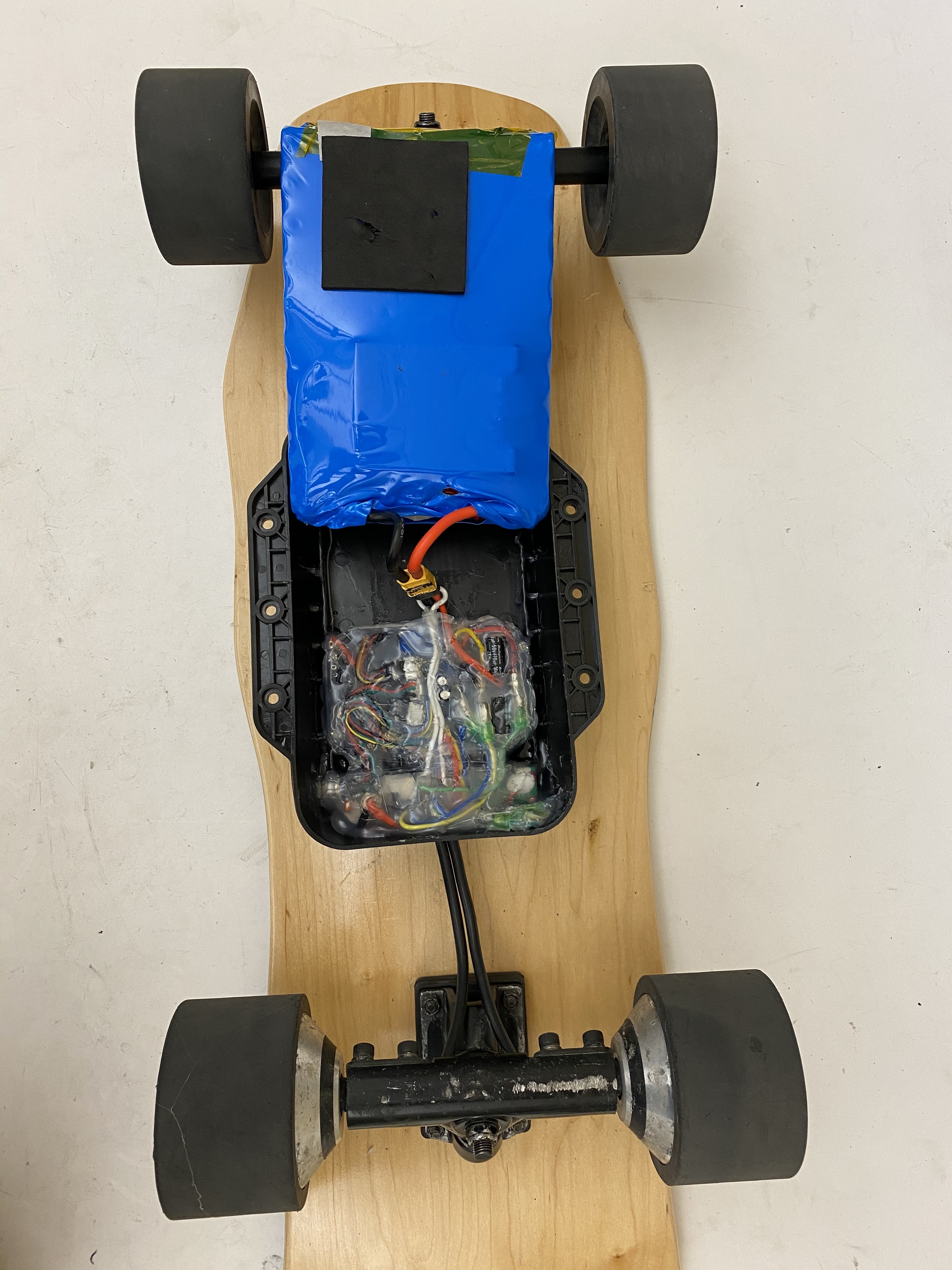

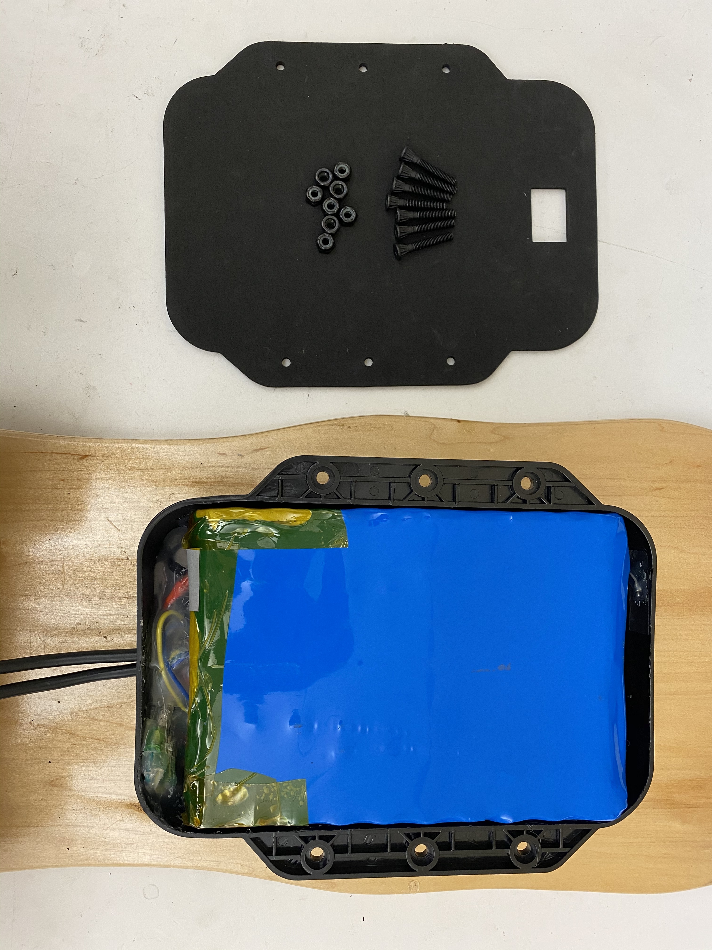

The real reason is that I am also trying to fit ESC and BMS, all in here. :see_no_evil:
Mission accomplished:

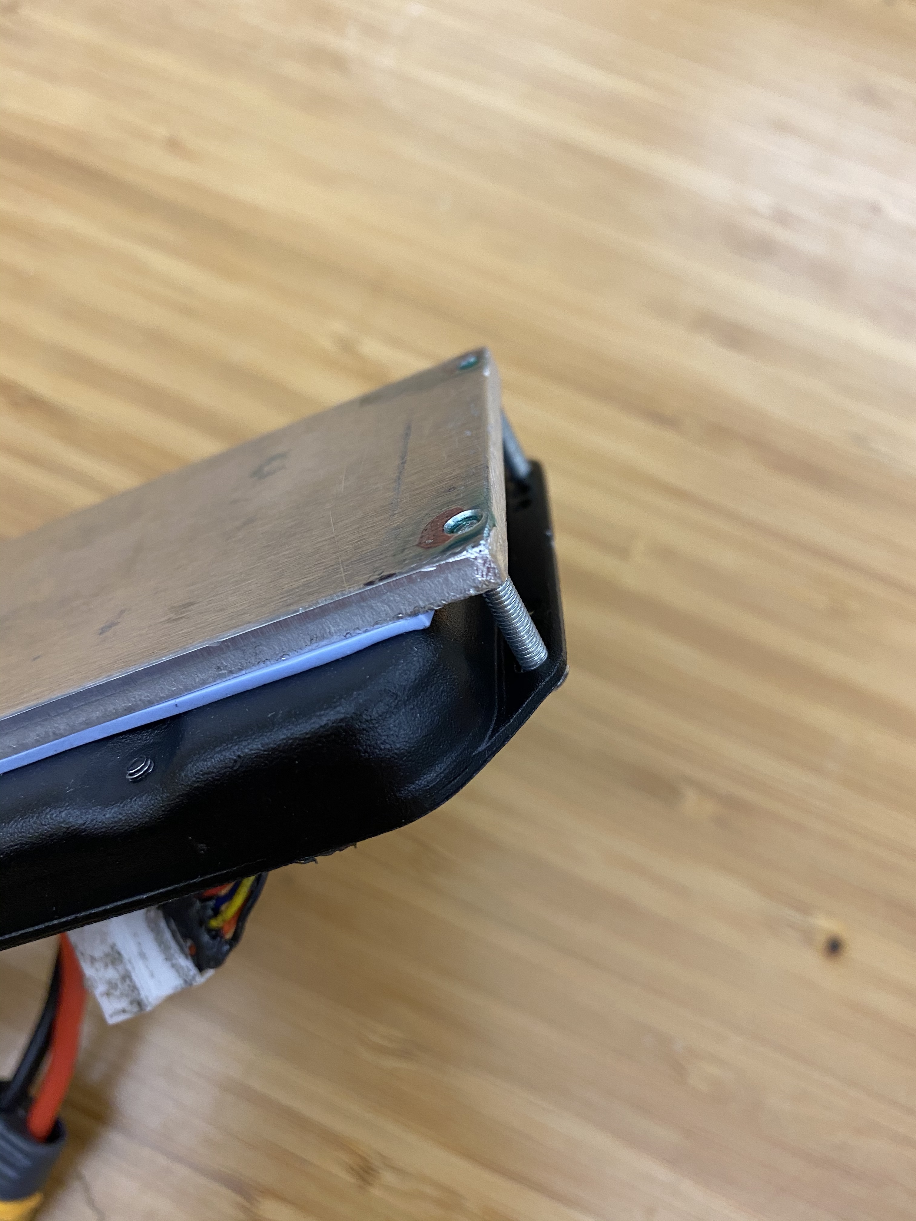

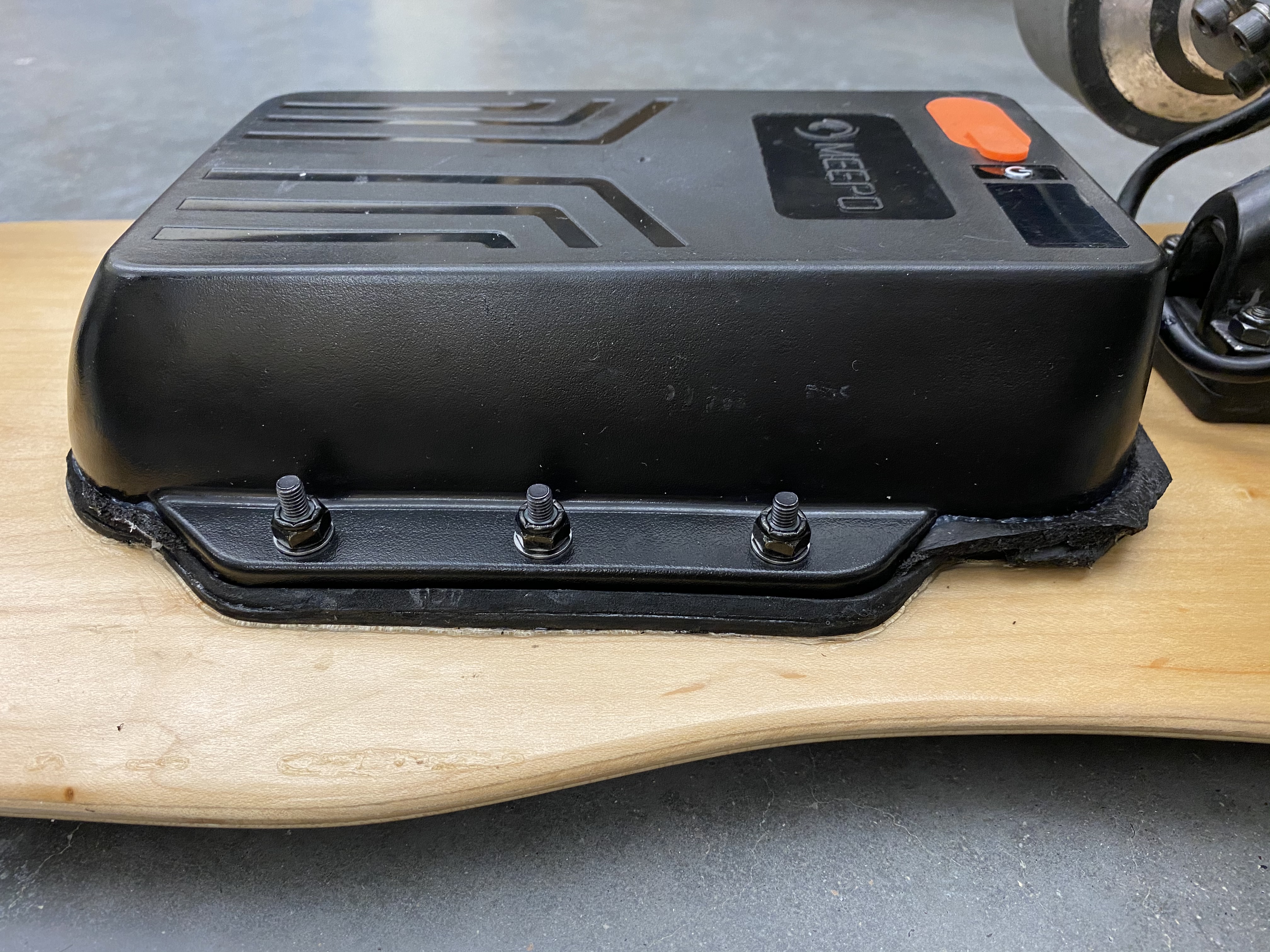

Cut up the enclosure to make space for the battery and thermal padded the shortened heat sink onto the ESC.
ESC fitted.
Dropped it in and used a ton of hot glue to make sure no cables are rubbing anywhere… yeah, I totally overdid it and then did some more.

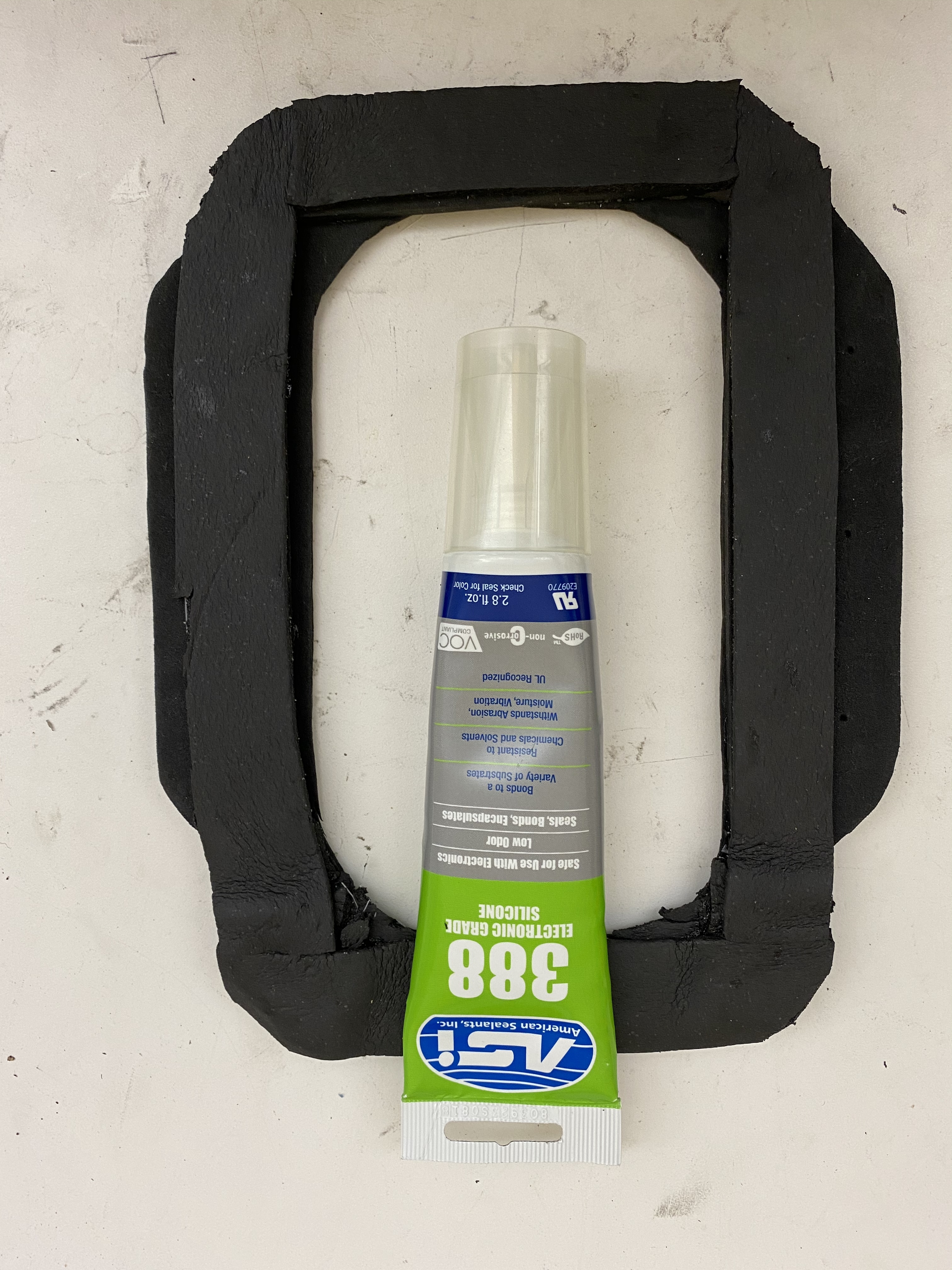

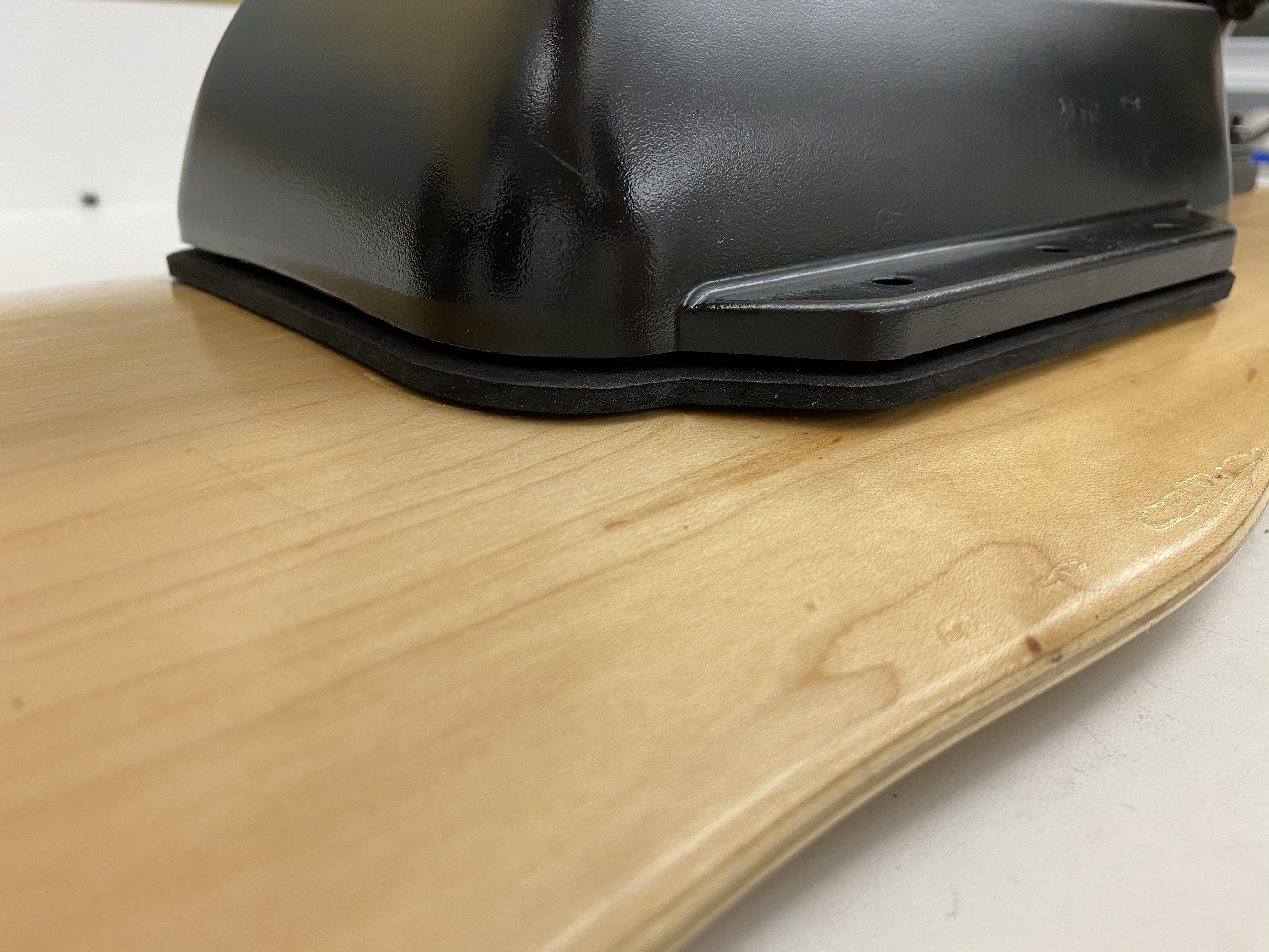

Making a thick enough gasket was challenging, but it should be waterproof now.

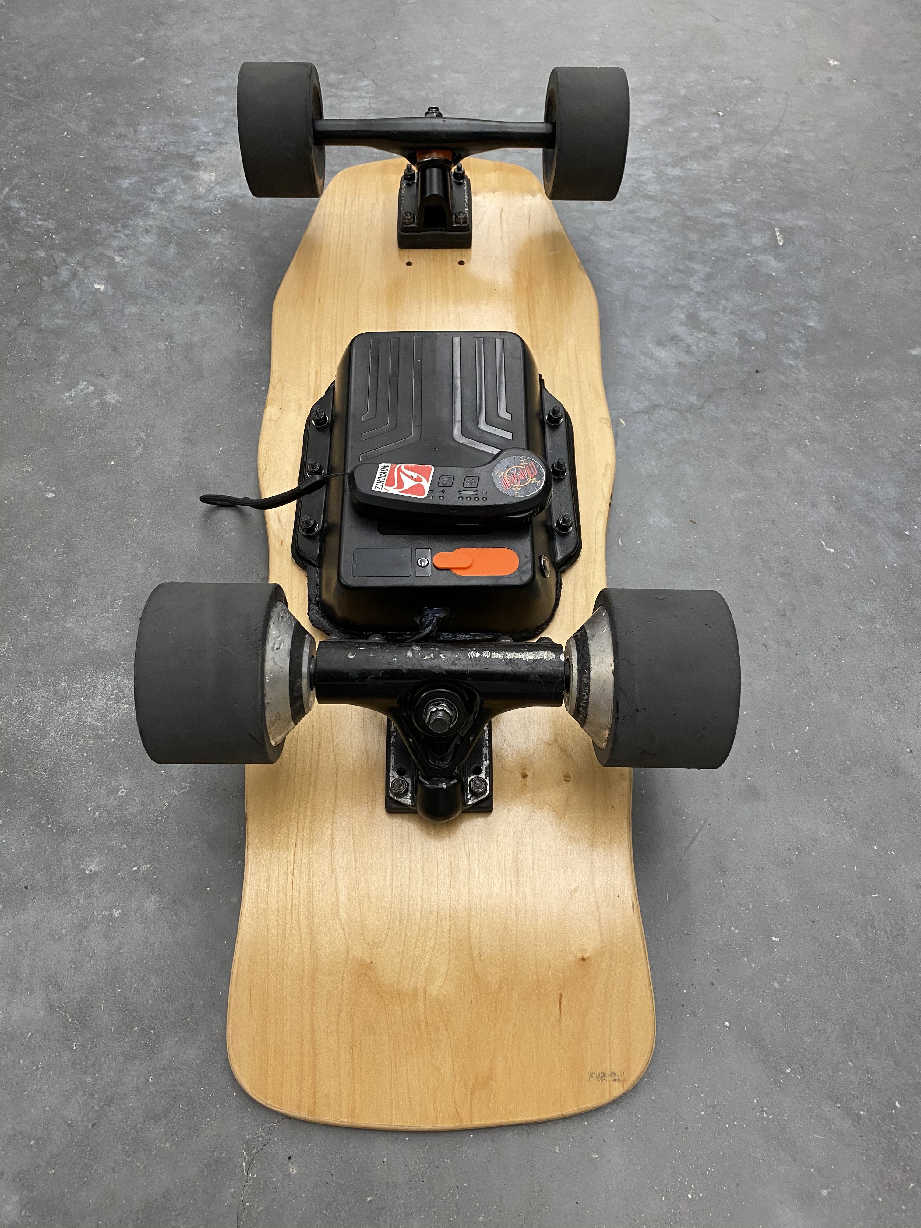

Build finished.
qed.
Merry Christmas!!

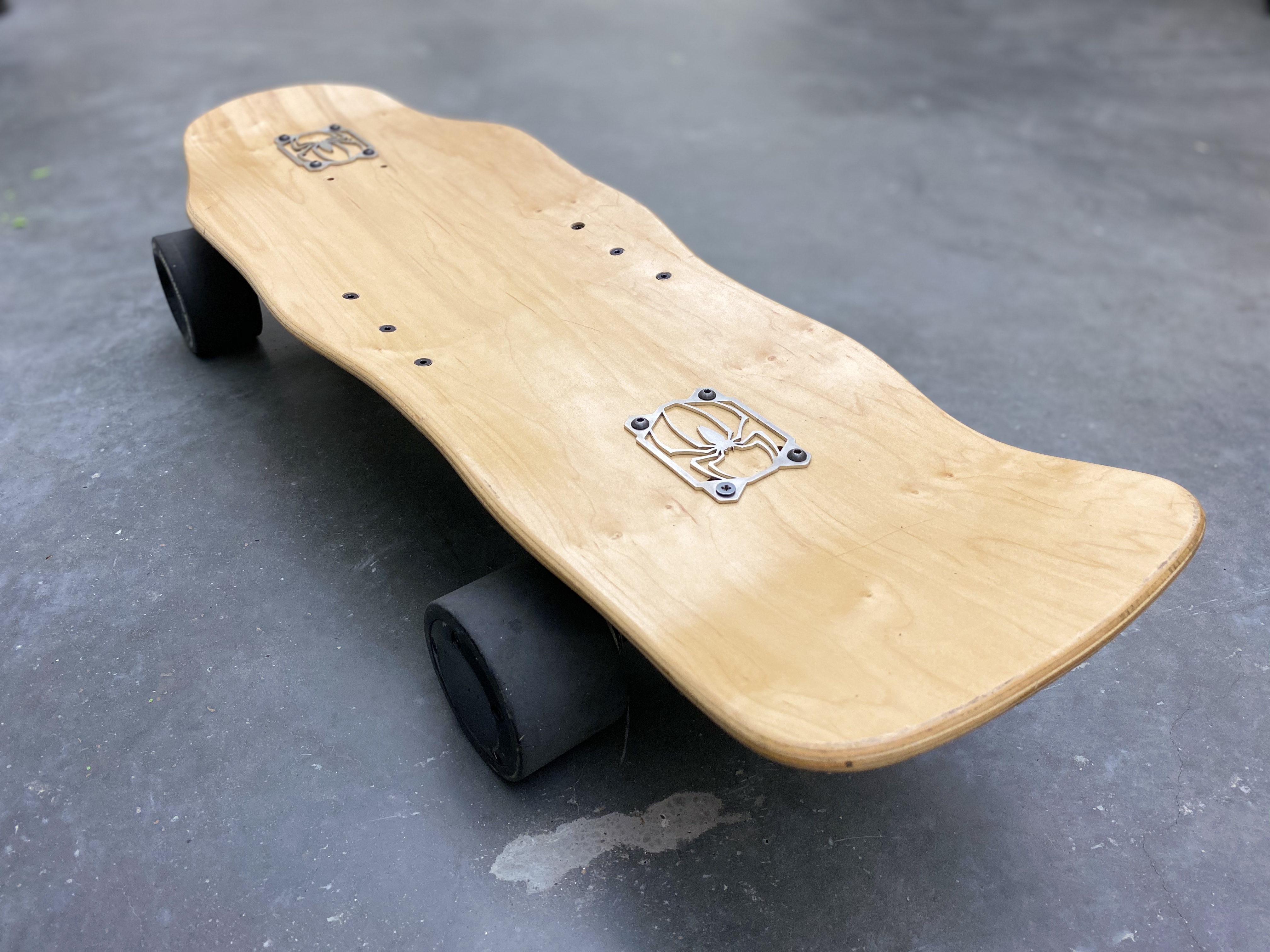

How does is feel? Looks great!
It actually turned out way better than I anticipated!
Even on the slowest mode it has enough torque to make you wheelie if you’re just standing on it, but does not go faster than what’s safe on this thing. Perfect for beginners.
On full speed mode it actually has decent acceleration all the way and gets to speeds beyond what feels safe on such a short board.
It manages right turns at speed well, feels stable and the kick tail is just awesome for really tight turns.
When you pick it up on the front trucks, it feels just like it was designed to be comfortably carried around.

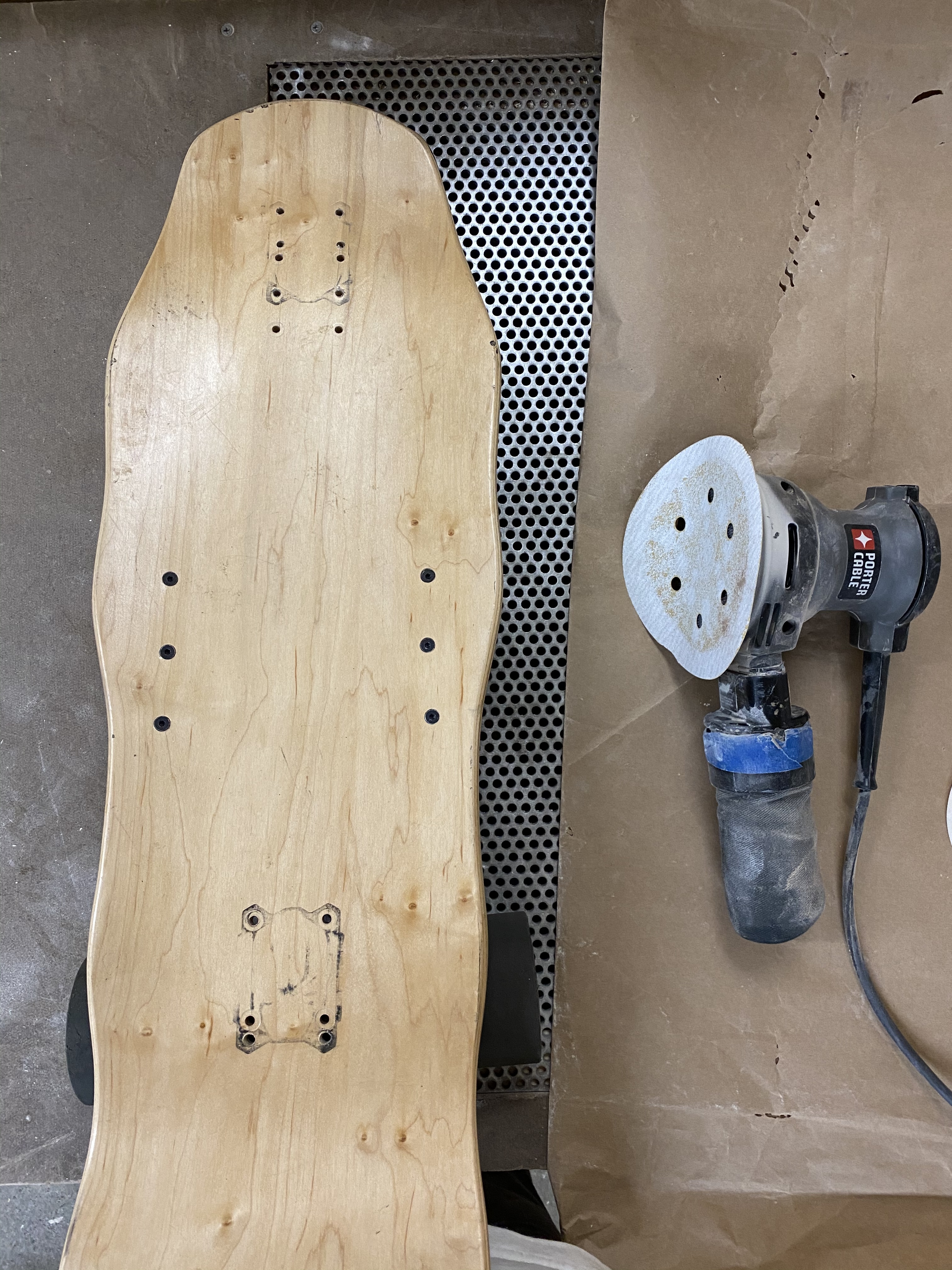

I really love the deck, too. Just ordered glass fritt to finish the top. Thinking about cool designs.

Didn’t measure - but it was 2 rows of 10 18650 cells in parallel with a dickyho BMS on top.
Haha, yeah, it was like 2mm too tight, so it needed some modifications and gaskets… it was a pain. Not recommended. But if you need to fit it all in here - you can.
