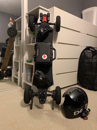

Hey all, been browsing the forums for a while now, and finally started working on my first DIY.
I wanted to set up an eMTB I can use for my daily 10mile, all season commute as well as hitting trails, jumps, etc.
So far I have bought:
MBS Pro 97 Warren Complete
Boardnamics 4.6 M1-AT Gear drives
Boardnamics BN6384 170kv Motors
Stormcore 60D+
Originally I was thinking of doing a bottom mount battery, because I am not a fan of the clunky top mount boxes, but for durability/waterproofing/ cost sake I think I am going to go with the smallest top mount I can manage. Any ideas for a compact battery setup that can get 15mi/25km range? I am currently leaning toward getting a 12s4p 21700 Molicel P42a pack built, and machining some sort of good looking enclosure for it once I know the dimensions, but it is hard without seeing what kind of configurations batteries can be built in. Any builders have any advice/ suggestions for where I should go with this? Thanks!

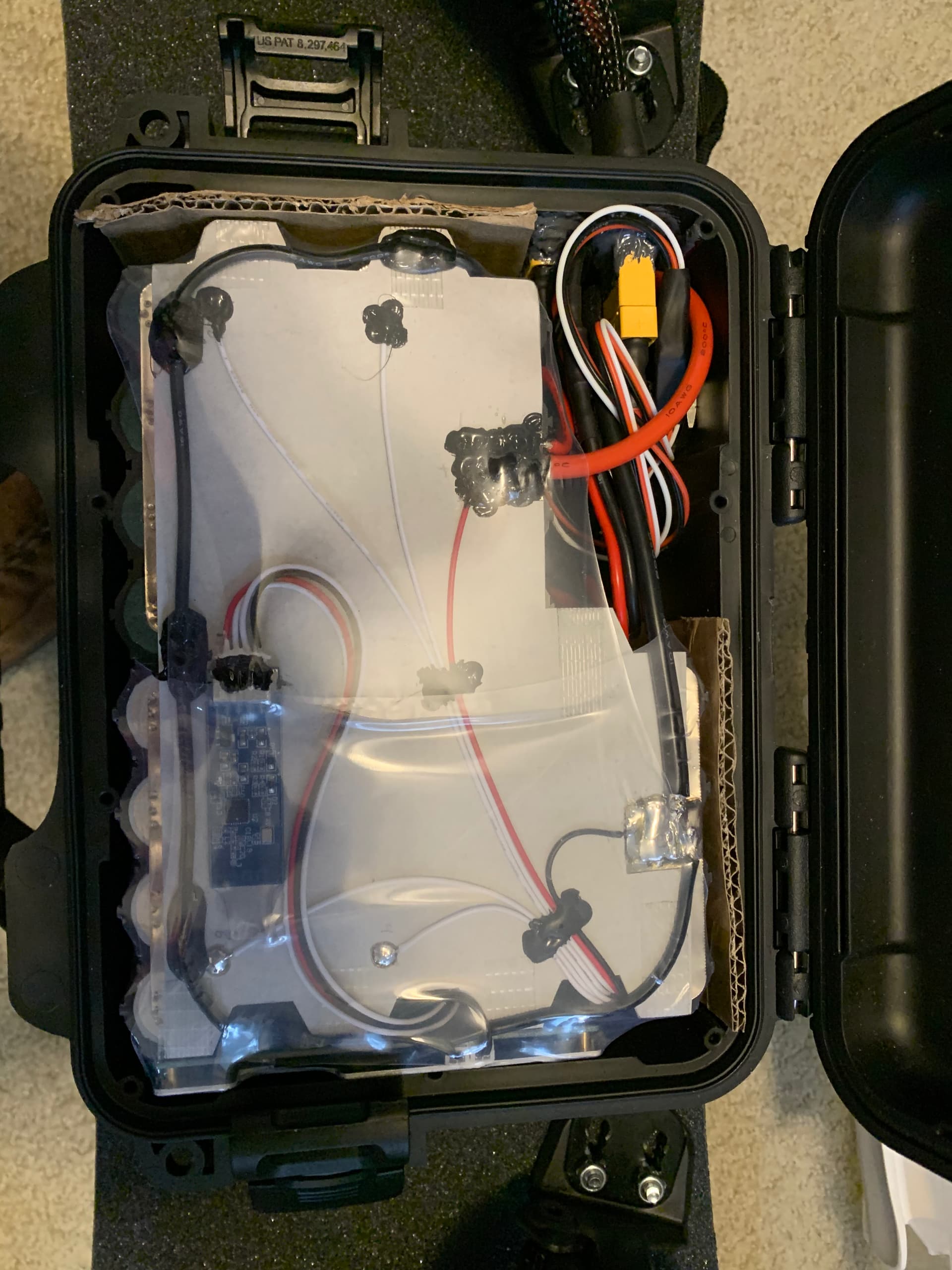

It’s a tight fit but it does go into a Nanuk 904, which has 4 feet with hollow centers which make it easy to mount

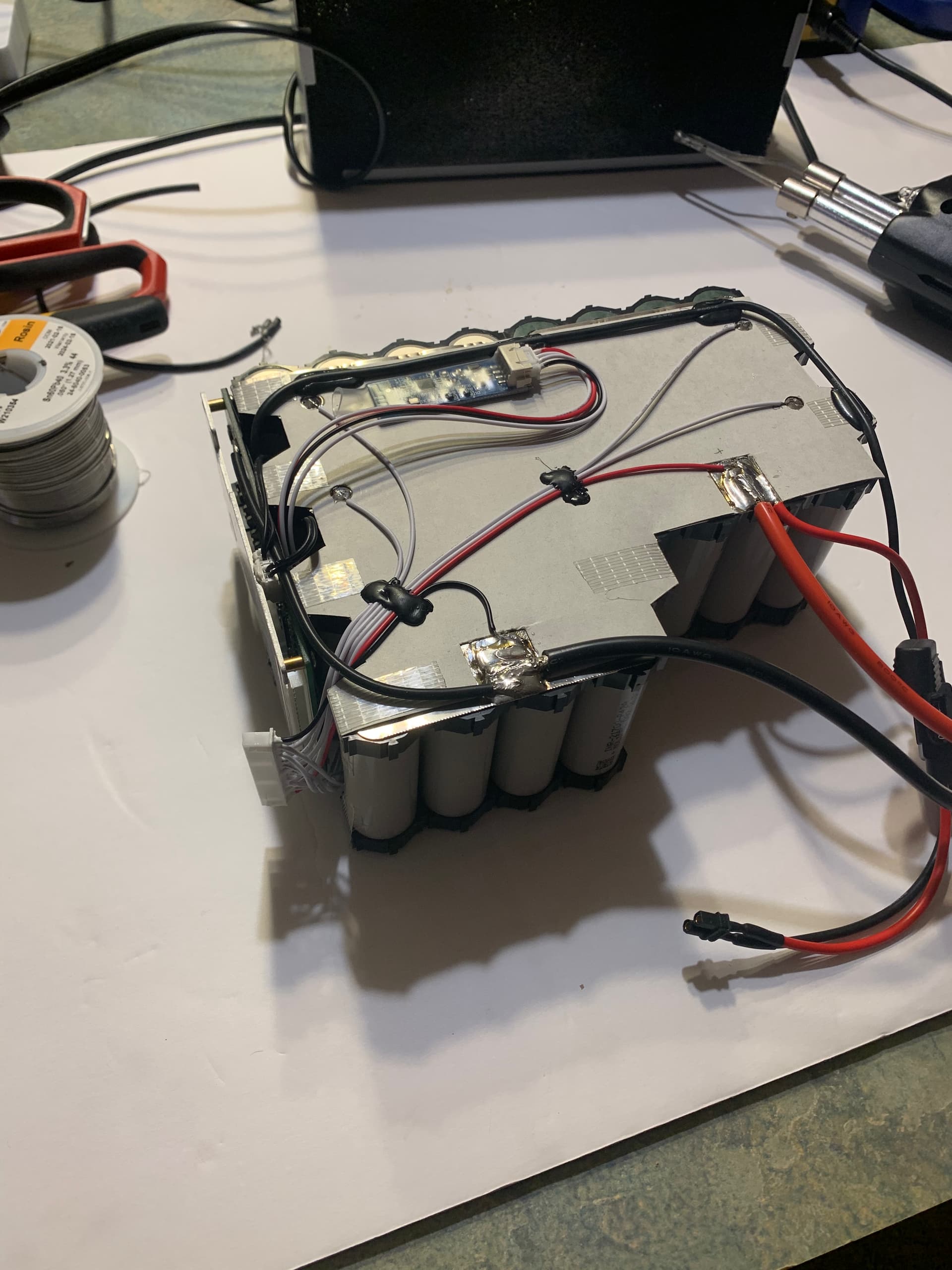

I’ve got a couple of lighter weight packs that I’ve made for EMTB. One is 12s4p p42a and the other is a 12s3p 30T pack. The 3p one is super cute.
But I just rotate them in the same peli1200 that I use for the 12s6p p42a Apex NGB pack.
That looks like exactly the size I am after, did you build that pack yourself?
Yeah, 12s4p LLT and FS smart antispark
