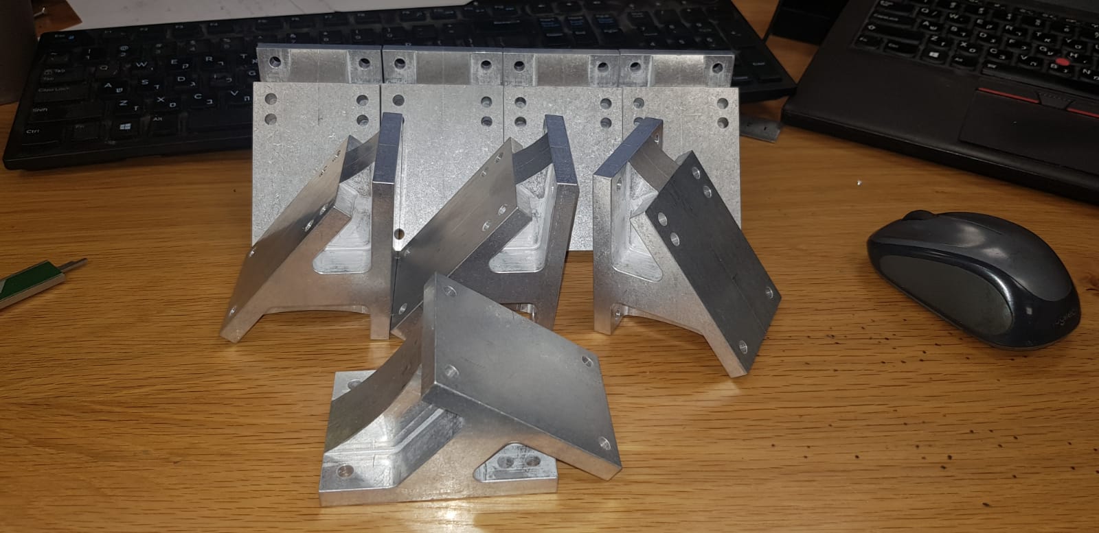

Love the animation. Don’t all these obstruct the screw path? can’t get the screw in?
I guess a wedge piece of wood would do the trick for cheap, with the caveat that you’d need to use wood screws to attach deck to riser and to attach truck to riser. Need to assess if it’s strong enough.
The truck bolts, the wedge bolts, explain a bit more. I’ve been drinking and am not visualizing properly in my mind.
Just the truck bolts that butt up next to eachother?
The mounting hardware, deck to riser, and riser to baseplate. Not much room in there for screws, nuts, screwdrivers, etc. I might be an idiot though.
I figure the ones from deck to riser will have the bolts on the inside of the wedge and you could use a crescent wrench to hold the bolts.
The deck to baseplate would be tricky but if you put the bolts in before assembling the wedge to the riser plates, they’ll be in place. With no room to use a tool on the bolt head, I considered just using hex head bolts and a crescent wrench from the side.
I’m definitely more concerned about the skinny side of the wedge. Not a lot of play room there. I can increase the height of the wedge without affecting angle but it makes the whole ride higher.

Did someone try these aluminum welding rods?
If these work as shown than you can do a simple 4 piece laser cut of sheet aluminum and assemble/weld to a wedge.
Probably the cheapest option
For those who are thinking of other materials other than a solid chunk of aluminum. Don’t.
@moon we are counting on you now. I’ll get a set if you are making a solid 1 piece.
mild steel should be fine, eh? Easy to weld unlike aluminum. Is that the 3dservisas one?

Took me some time to dig this up but I made a set of these designed for 3d printing back when I was first getting started.
I used ASA-X but nylon might work too. Used them for about a year with no problems, upgraded to metal ones from the guy @Linny mentioned. I can ask him if he’s making more if you want.
Ah nice! So you’re the one who made these, brilliant work my friend.
What’s ASA-X? Pardon me asking haha
Thank you! I went through a few iterations, the thread for that is still somewhere on the old forum.
ASA-X is basically ABS with much better layer adhesion and UV protection. This makes it noticably stronger, though you shouldn’t expect the same from it as metal of course. It’s generally more expensive too.
