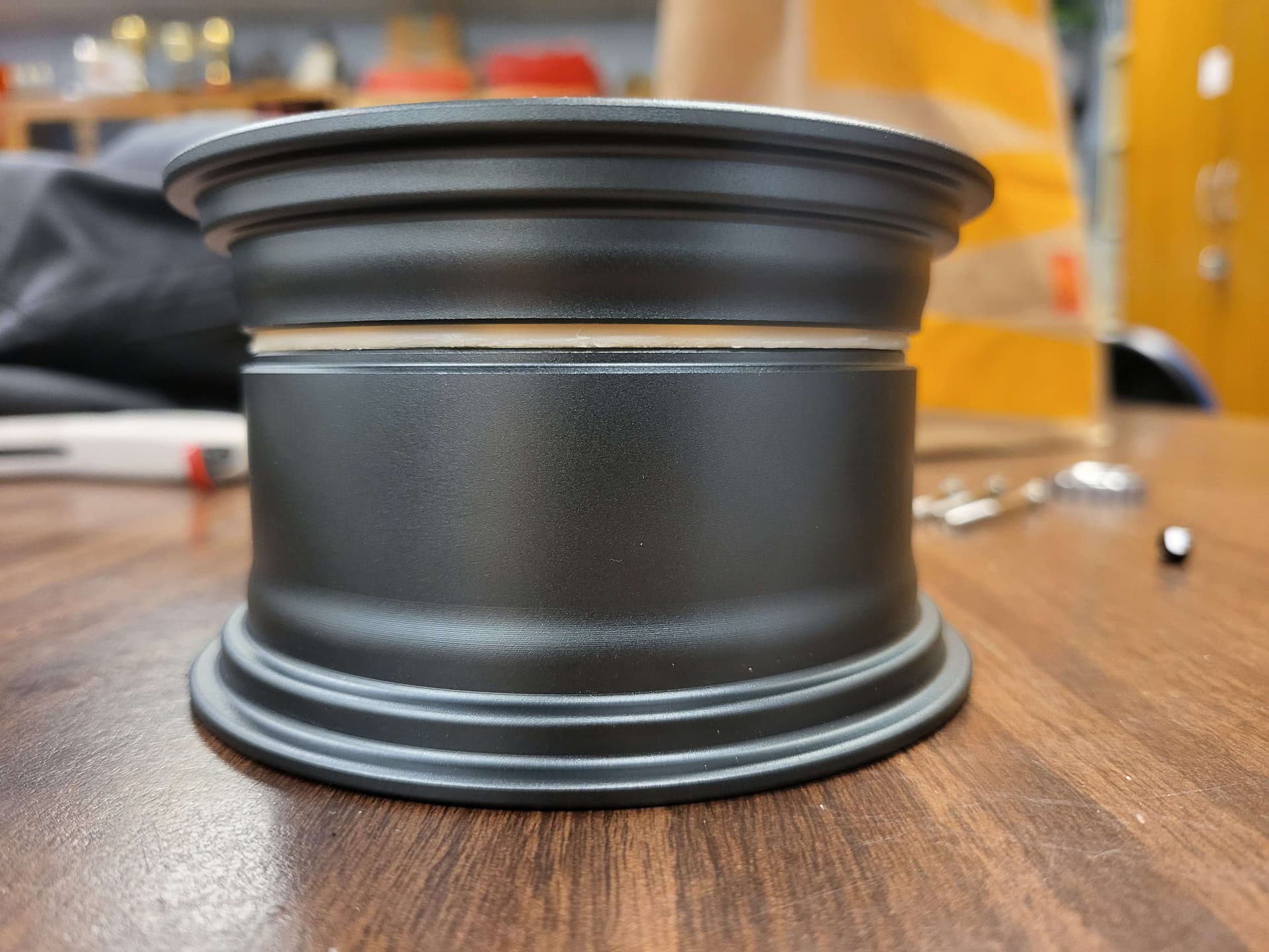

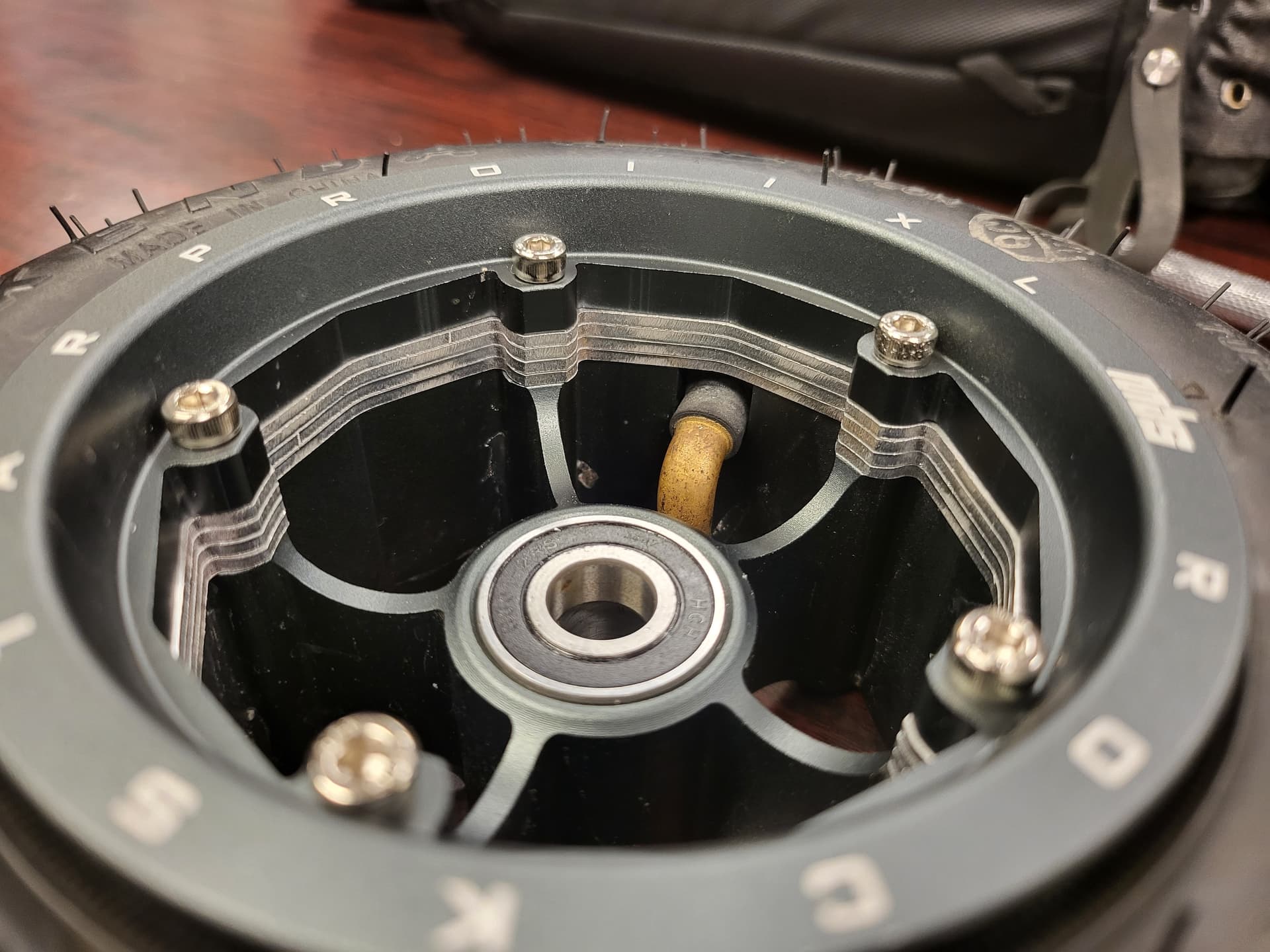

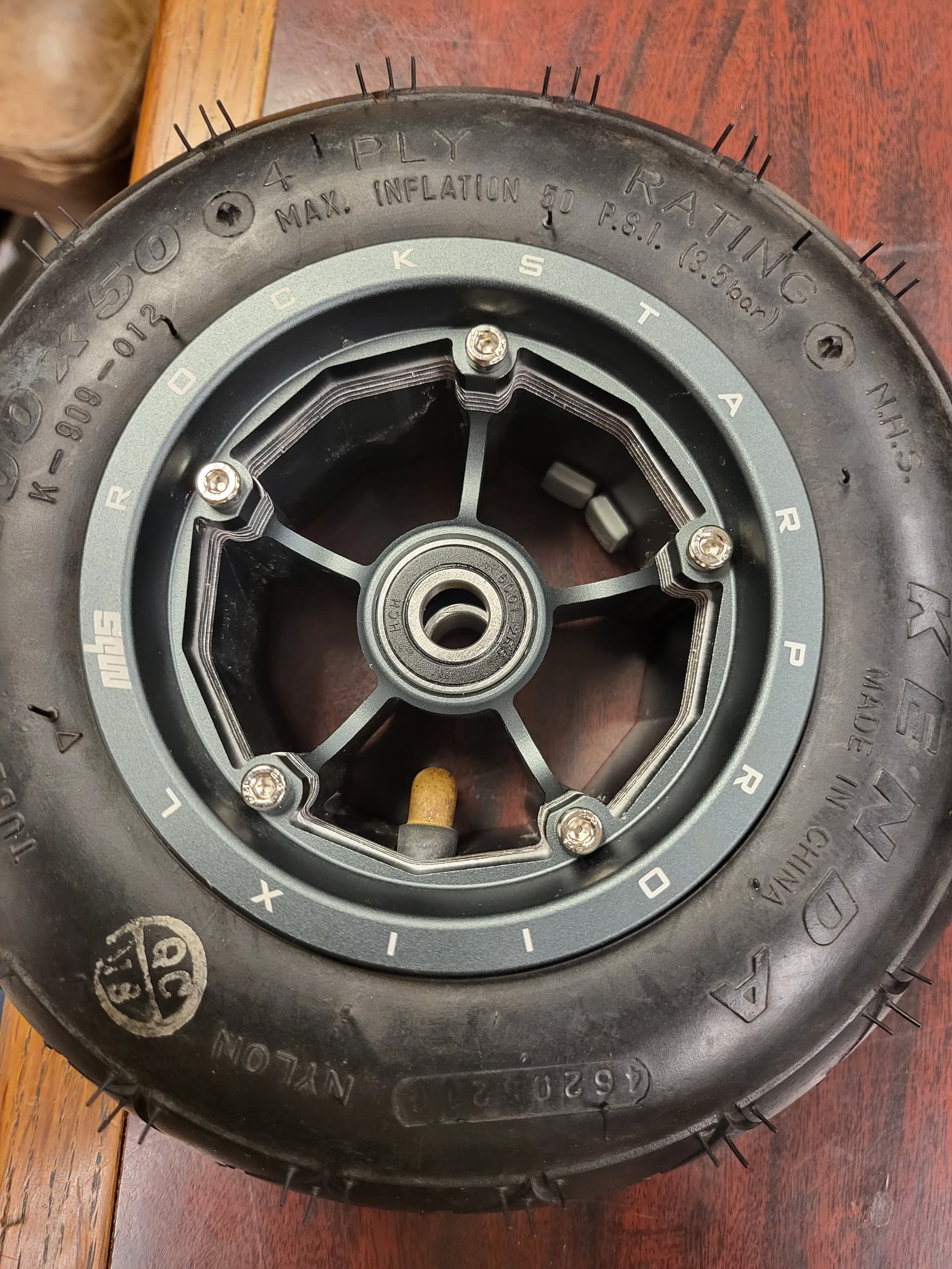

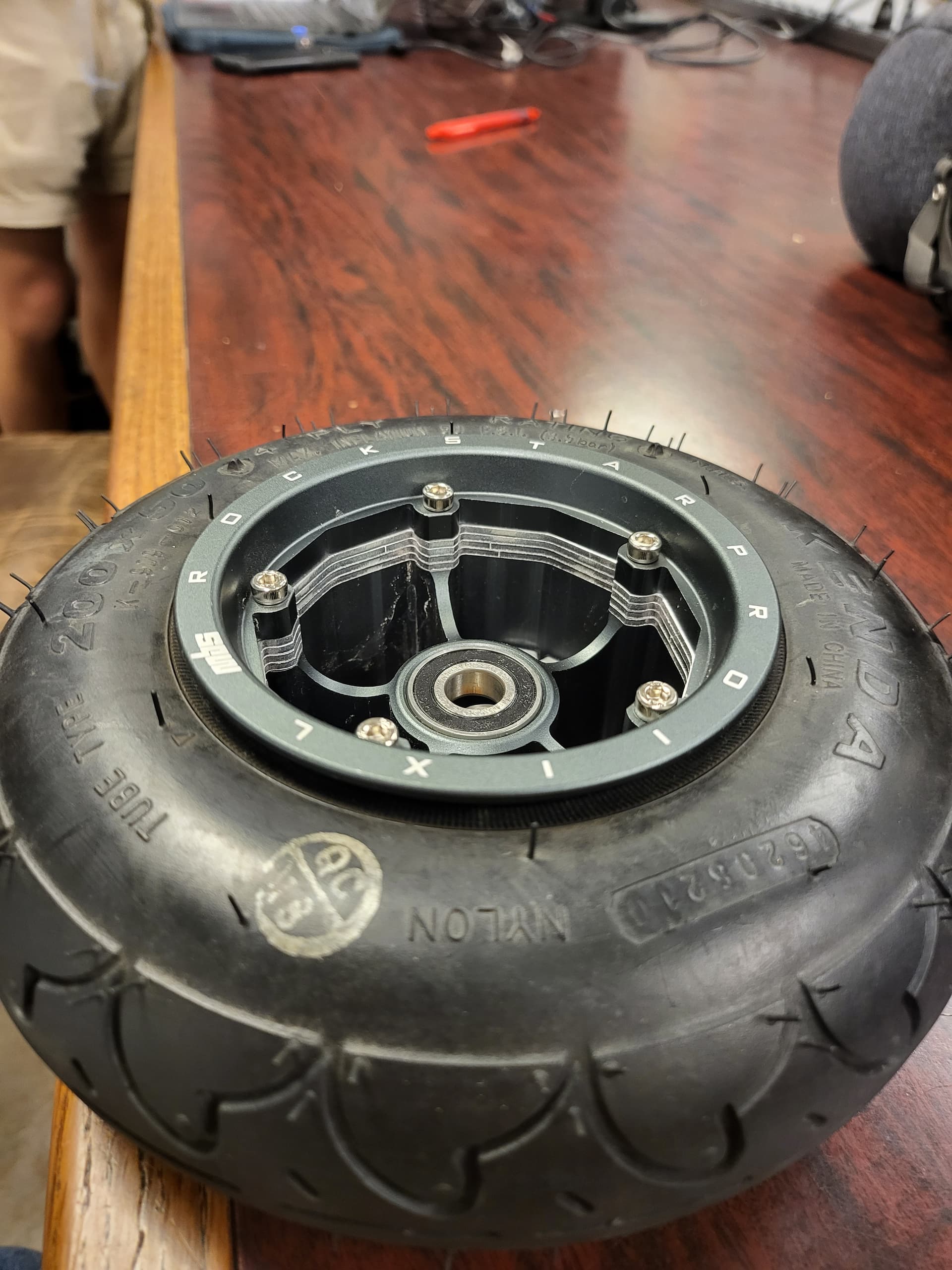

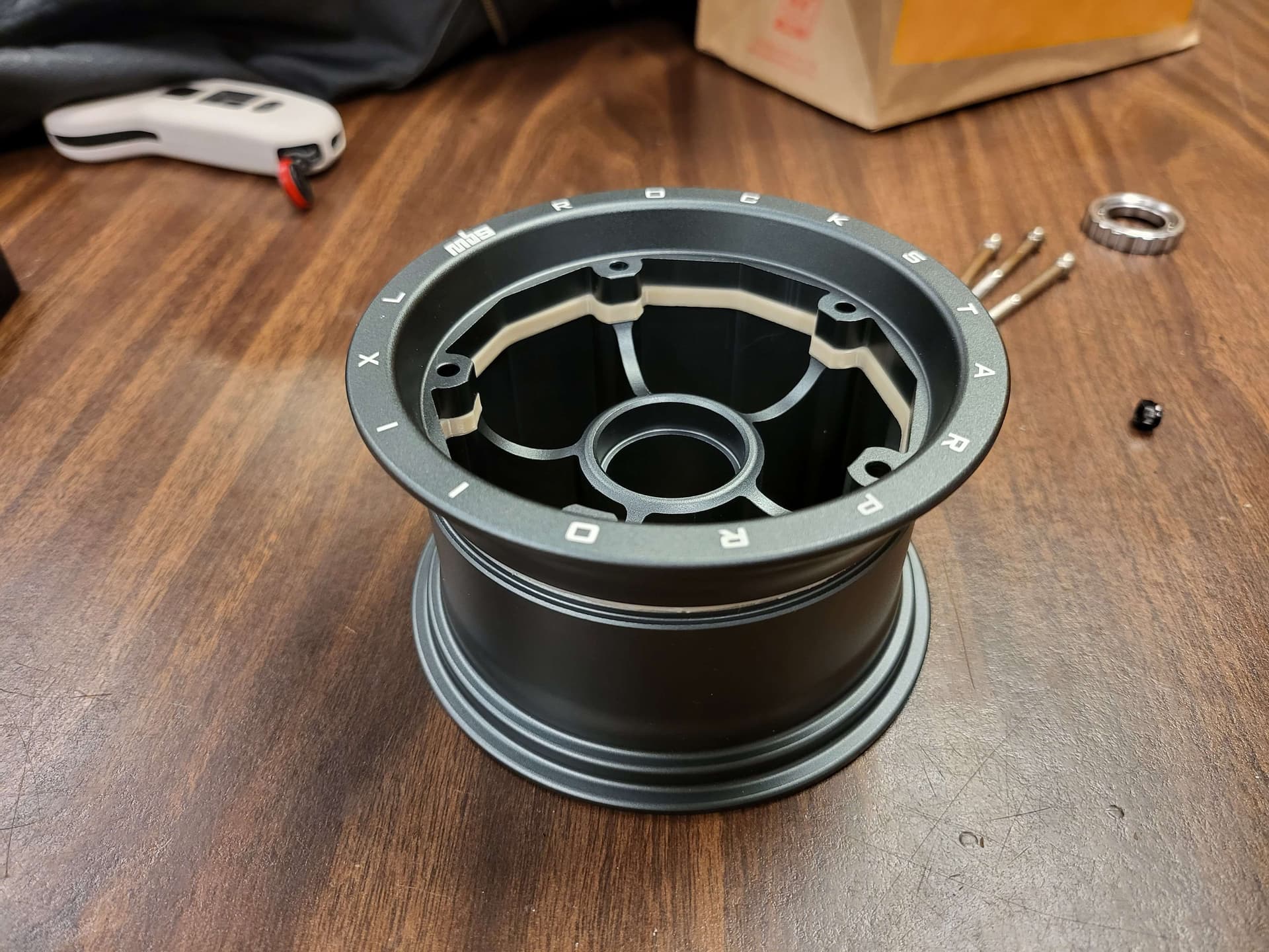

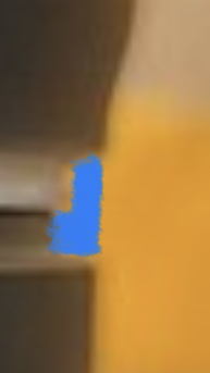

I finally got around to prototyping these, and have them to a point i’m comfortable selling to those of you interested. These are going to be lasercut metal shims of ~2mm width to fit between the front and rear half of the MBS Pro II XL hubs. These can be stacked to achieve effective hub width increases of up to 8mm (Longer is possible, but requires difficult to find bolts). As a result of the design of the hubs and the way that both bearing seats are on the back half, increasing the hub width does not interfere with the bearing spacing, meaning it’s incredibly easy to do. Increasing the hub width also fixes the non-center valve stem positioning as stock. The images below showcase a prototype 4mm spacer made in PLA, but the actual end product will be done in aluminum in 2mm thicknesses.
