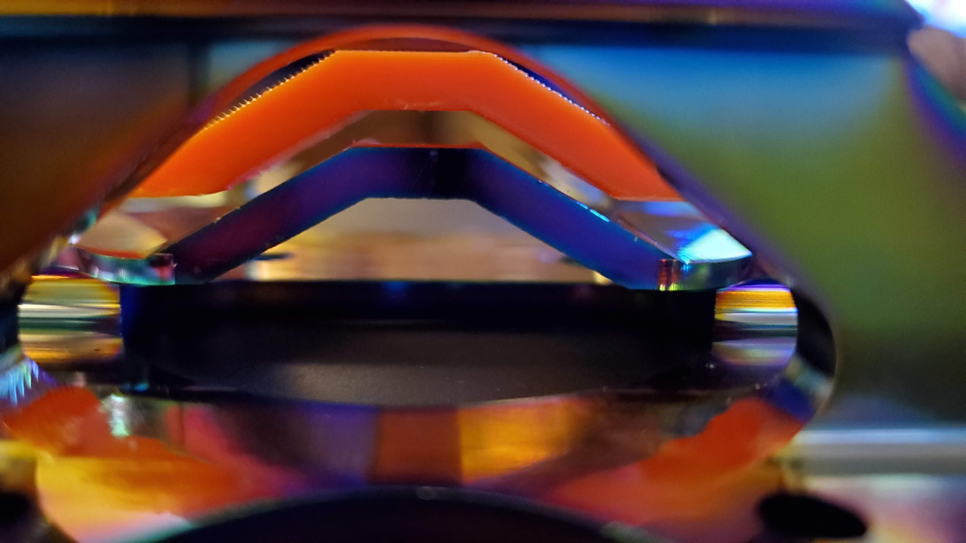

I know this topic has been out for a while, I was wondering if it would be possible to get some dimensions/drawings of this part ? I’d like to try making it for myself to solve this issue with my Matrix IIs
If they don’t get back to you, I modeled it as well. Hasn’t been online in a few years
Looks like I won’t be getting that anytime soon. Would be up to try to 3D print that part of yours however if you’re still keen to share :slight_smile:

Here you are:
Matrix 2 Baseplate Bar.STL (32.8 KB)
Nice Jason nice, thanks for modeling this - looks like the original part.
Haven’t been able to dig up @RhythmX to offer to sell the product advertised here. IIRC Radium has a Riptide bushing adapter for Matrix II & there are a few pieces left of Moon’s adapter in the UK so there is still demand to improve on Matrix II stability (esp. high-speed/jumps).
It doesn’t show up in the image above (MBS Matrix II Truck Mod - #7 by RhythmX) but importantly the design improvement is a lip to stop the top of the shock block sliding laterally when cranked down…this is the secret sauce & it would apply to whether you are talking about a shockblock or a Riptide bushing
