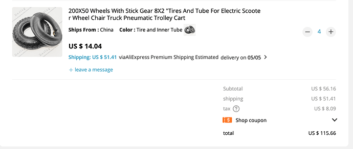

Ordered these for my next batch.
Whoa yallls, anyway to get this shipping down or is this just the new COVID standard?
